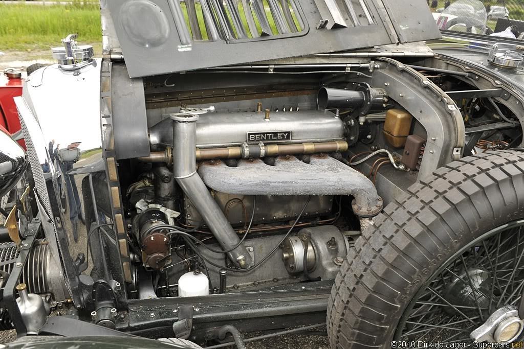

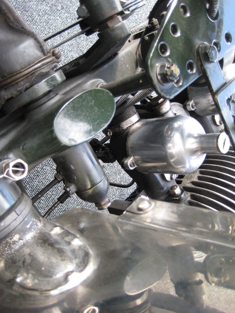

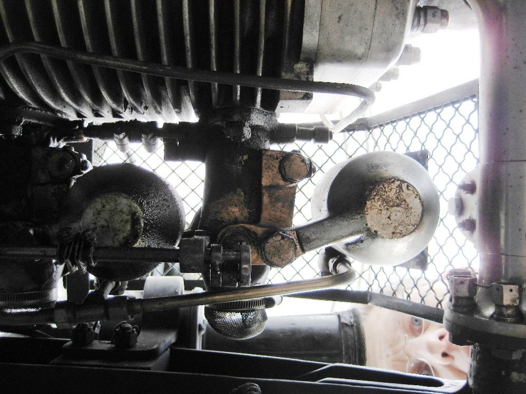

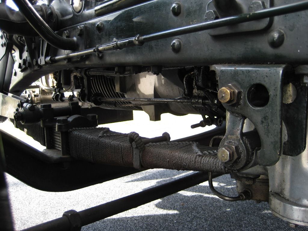

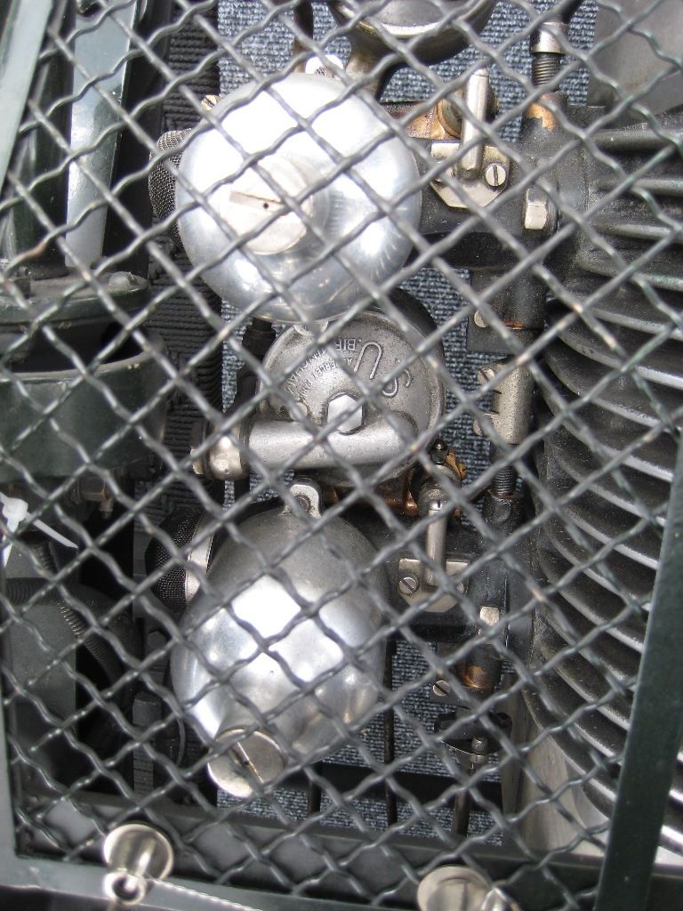

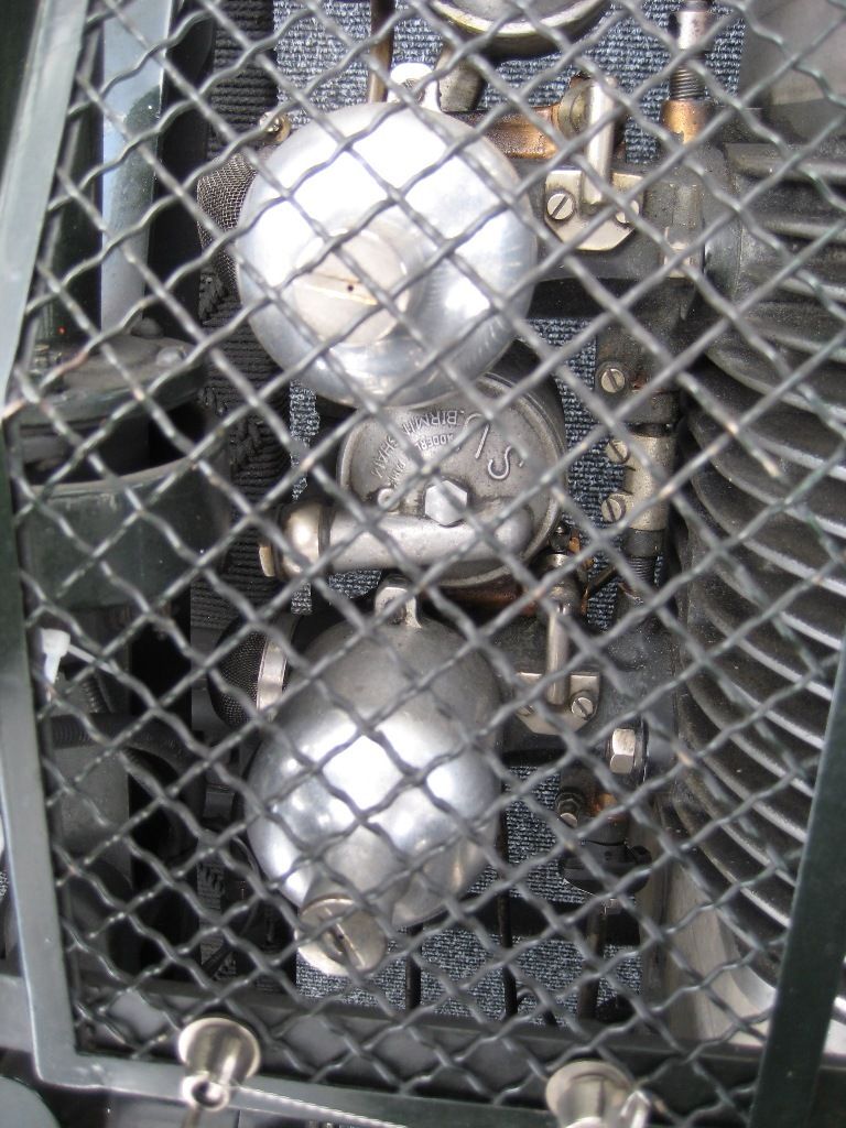

Malc2 Posted April 4, 2015 Posted April 4, 2015 (edited) Limey P, Nice work, wheels look great, I'm going to use your method for mine. Re ref for blower carbs, at Goodwood a few years ago I took these with mine in mind:- Edited April 4, 2015 by Malc2 1

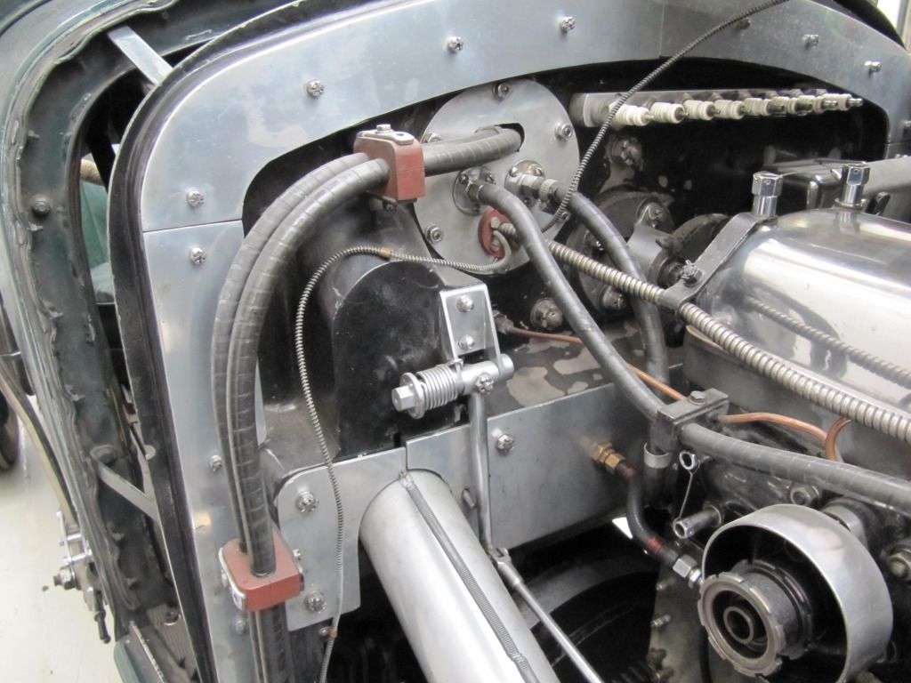

Brandy Posted April 4, 2015 Author Posted April 4, 2015 (edited) Malc, you're a star! Those are PERFECT! You wouldn't happen to have any of the left side of the engine and rear of the bulkhead would you? I've written to Ralph Lauren in NY to see if they have anything available of the actual car...can't hurt to ask....... I'm beginning to think that the lines I was asking about earlier are low pressure oil lines. On some cars they are all copper, without the flexible rubber pipe. Here's my logic - The oil reservoir on the rear of the bulkhead appears to have a line running rearwards, towards the dashboard. There is also a large round "pump like" handle in the centre of the dash - I'm thinking that it is a hand operated oil pump to get extra oil to the extremities, maybe just for cold starts.....any thoughts? Meanwhile progress has been slow. I've been working on bulkhead details before fitting it to the chassis so not much to show at the moment. Ian Edited April 4, 2015 by limeypilot

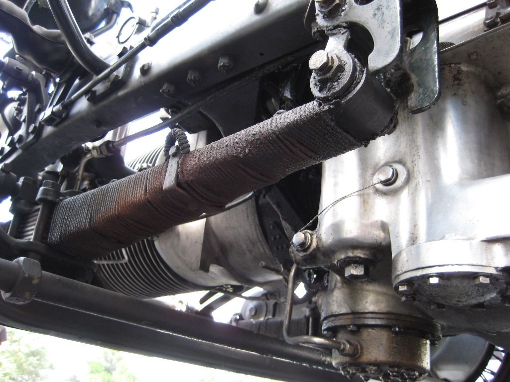

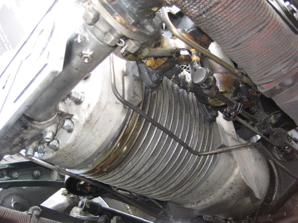

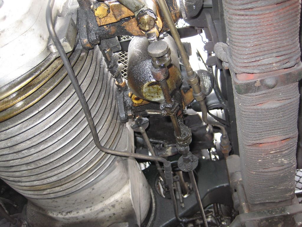

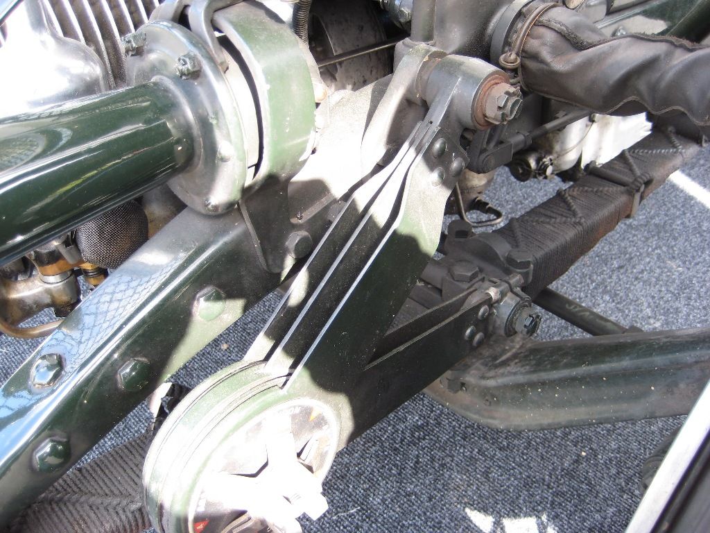

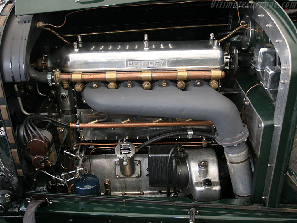

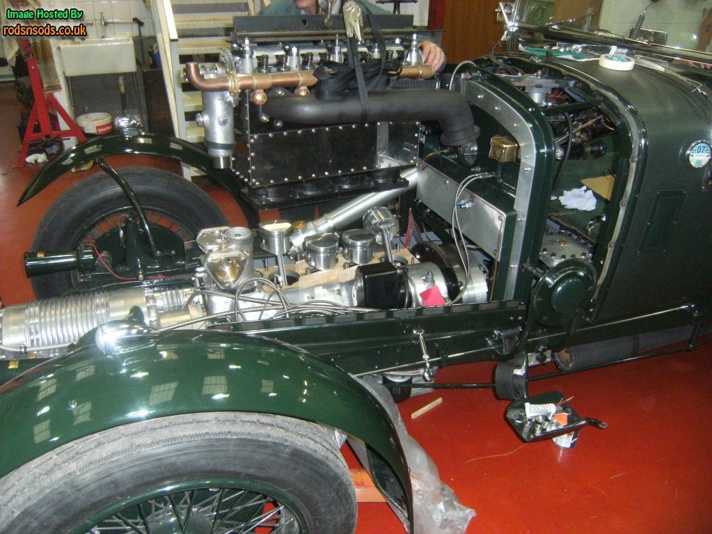

Malc2 Posted April 4, 2015 Posted April 4, 2015 Your welcome guys. Funnily enough no one takes any pics of the LH side of the engine, including me....! This is all I have collected from t'net. Malc 1
Brandy Posted April 4, 2015 Author Posted April 4, 2015 (edited) Thanks again, Malc! One or two of those I have seen, but there is some very useful new stuff there too! Not much in the way of progress lately as I've been concentrating on the bulkhead details. That is done as far as is needed at the moment, which means the next milestone has been reached - the bulkhead has now been fitted to the chassis. I also spent much of this morning making the clamps for the intake plumbing from the blower.... I'm pleased with how that's turned out, especially as it was one of those "I'll do it later" (ie. how the hell do I do that?) jobs, now thankfully out of the way! I used thin plastic strip wrapped around the trunking, then carved 12 small pieces of 1mm square rod to represent each end of the screw clamp and glued those in place. 0 .4mm aluminium rod was added for the rods, and more resin nuts - I only added the 3 at the front of the clamps, and one under the tie rod. Starting to look like something now! Thanks for looking in, Ian Edited July 16, 2017 by limeypilot 3
