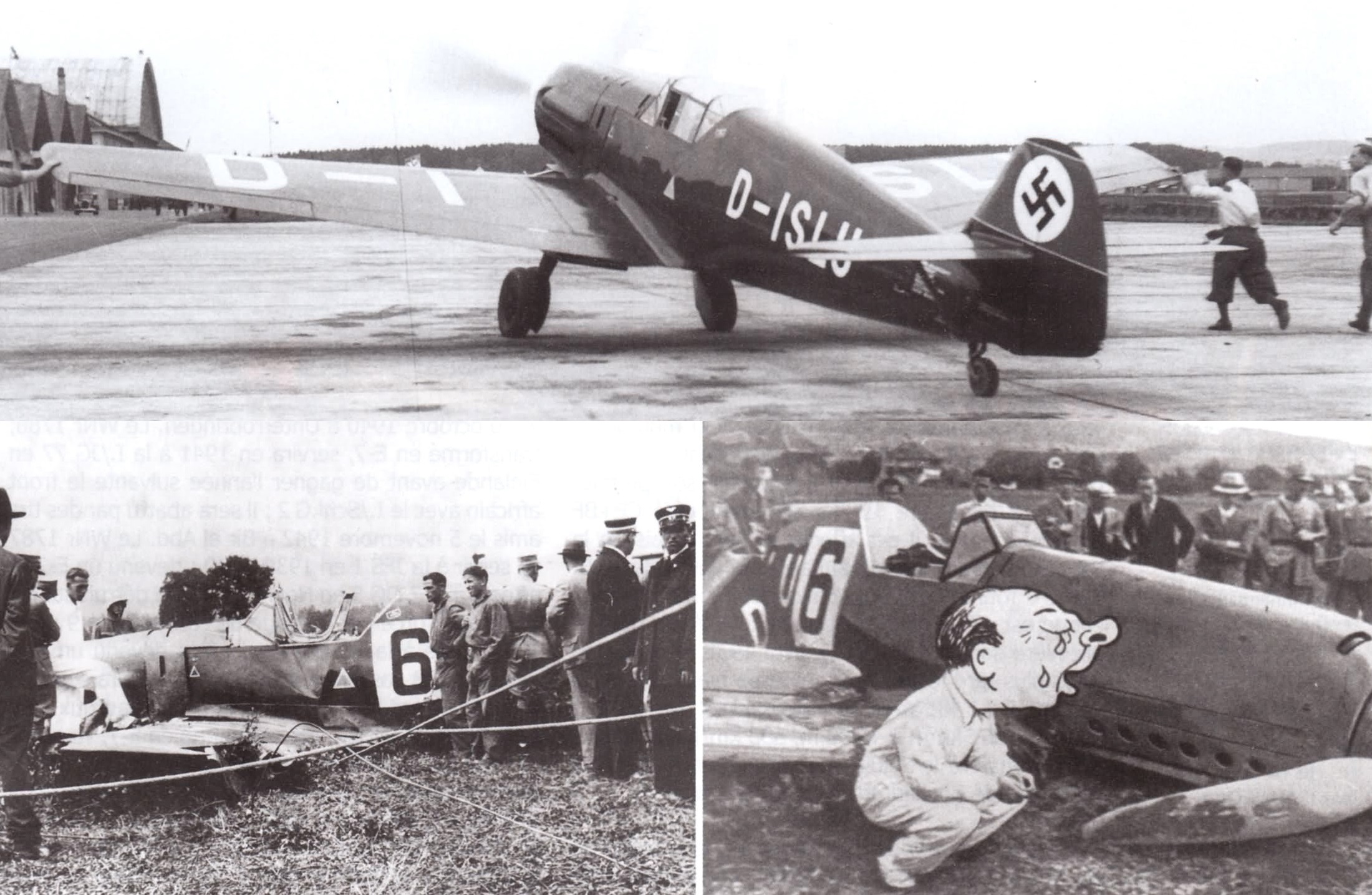

TheKinksFan Posted December 10, 2023 Posted December 10, 2023 I don't know if my question qualifies as stupid, but I try to do my best. AZ Model will soon release a Bf 109 V-13/14, and I'm a sucker for anything in red https://www.modelarovo.cz/wp-content/uploads/2023/11/AZ7870_kamo.jpg What kind of kind of canopy did the V-13/14 have? Did it have the same as E-1? I will always get masks if they are available, and could get ones that have already been released, if the clear parts are the same.
Jochen Barett Posted December 10, 2023 Posted December 10, 2023 (edited) Judging by the pictures that canopy looks a lot like an early E canopy. https://www.digitalcombatsimulator.com/upload/iblock/9f6/qz961da5owbiroffmwxhh652g59isv5a/Real.jpg and https://www.asisbiz.com/il2/Bf-109D/Bf-109D/images/Messerschmitt-Prototype-Bf-109V16-6D-ISLU-Ernst-Udet-crash-1937-01.jpg and https://www.modelarovo.cz/wp-content/uploads/2020/12/Me109-V14-E02-Series-Prototype-D-ISLU-WrkN1029-Black6-Flown-By-Major-General-Ernst-Udet-At-IV-International-Flight-Meeting-Dubendorf-Zurich-Switzerland-1937_11f-s.jpg But who knows what's in the kit (and which detail I just missed)? Edited December 10, 2023 by Jochen Barett 1
