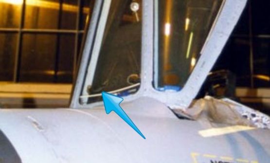

robvulcan Posted September 26, 2014 Share Posted September 26, 2014 I know they are famed for being patchy but its amazing how even on this focused area of the airframe how many shades of grey there are, They must have used a mix of Humbrol, Halfords, Testors, Xtracylix, MrColor, Vallejo, Precision Paints, "Matched" Colours to get it that right lol. (No wait its trick of the camera) haha. Is she missing a few Rivets too or is she kitted out with tiddly winks. I saw this kit yesterday on the shelf for 22.99 and the 1/32 Hunter for 26.99 ,,,, Agony of choice Link to comment Share on other sites More sharing options...
eng Posted September 26, 2014 Share Posted September 26, 2014 "Is she missing a few Rivets too or is she kitted out with tiddly winks." Are you referring to the fasteners at either end of the dark coloured antenna on the upper surface of the glove? Looking at the pic these are countersunk washers which are used to spread the load of a countersunk screw over a larger area, or can be used when the hole on the panel becomes worn through repeated removal and installation of fasteners, especially on regularly removed service panels. Nice to see so many shades of grey, don't think I'll fret too much over how accurate my colour choices are in future. Eng 1 Link to comment Share on other sites More sharing options...

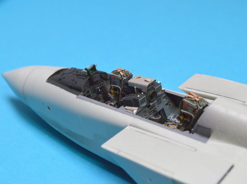

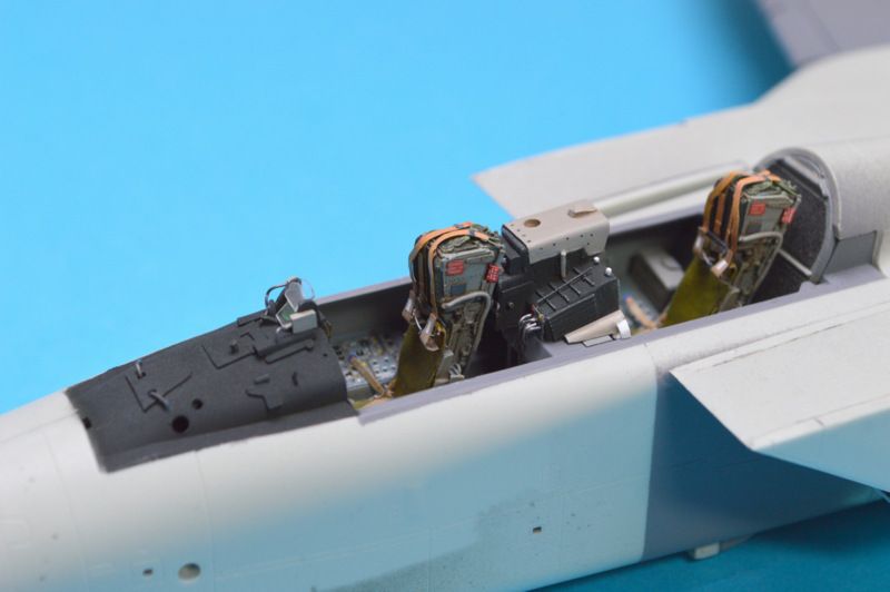

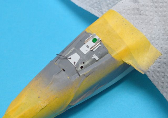

general melchett Posted September 28, 2014 Author Share Posted September 28, 2014 The cockpit coaming is now pretty well done, just need a bit more detail on the HUD mounts and then it can be sprayed and weathered. Finding good photos of the forward end of the coaming was difficult but after a lot of searching I managed to find a few. I've seen a lot of conflicting info about the inspection holes for the foot brake accumulators and demist pipes, some say there weren't any, some say one hole, others two, no demister pipes (though how the system was fed is a mystery), no plates, etc...but the photos I found seem to indicate that these were all present, at least on the IDS, ECR, GR4 and F3 so I can't believe it wasn't the same for the GR1A. Hard to make out but you can see the pipe appear to disappear into the framing on this GR4, http://en.wikipedia.org/wiki/Aerial_refueling#mediaviewer/File:GR4_VC10.jpg GR4 from our walkaround section, you have to strain your eyes but it is visible on both sides... Same here on a German IDS, F3 bottom right photo...... you can see the pipes angling out to the screen frames. http://www.tornadosig.com/f3t-walkaround-ze256.html And finally the best close up shots of an Italian ECR, this page seems to take an age to load, (well for me anyway), but worth it as it shows everything clearly...... http://www.modellismopiu.it/modules/newbb_plus/viewtopic.php?mode=viewtopic&topic_id=22966&forum=49&start=170&viewmode=flat&order=0 So I went with the detail as it adds a lot more interest to the otherwise bland coaming area...Revell included nothing at all ! The holes and plate seem far up the coaming. This is due to Revell cleverly making the screen longer so that the forward end forms part of the fuselage making blending a lot easier ! The HUD glass, g-meter and AOA indicator will be added after painting.... Checking that nothing fowls the wind shield... Cheers all, Melchie... 10 Link to comment Share on other sites More sharing options...

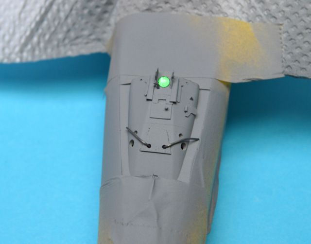

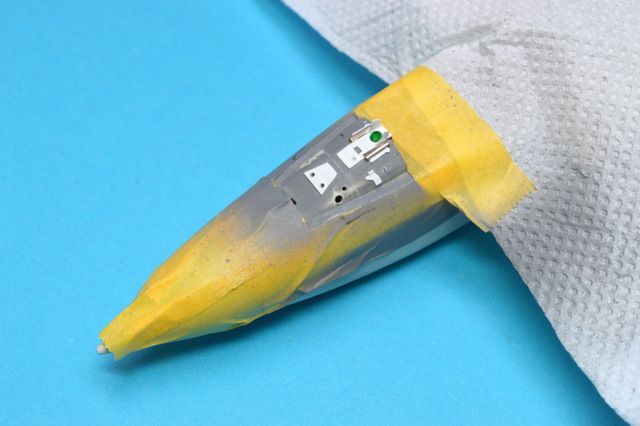

general melchett Posted September 30, 2014 Author Share Posted September 30, 2014 (edited) Thanks folks, glad you like it... The HUD is now finished....AoA unit and g-meter fitted. For the green lens I used the silver backing plate of a 2.5mm Little Cars lens and gave it a couple of coats of Tamiya clear green. To add depth to the piece I laminated the lens between two .5mm pre cut pieces of card which is sunk slightly into the top of the unit. The HUD glass was made from two pieces of .5mm clear acetate cut to shape and dipped twice in Klear. Don't forget the switch panel to the left of the HUD on top of the coaming. Cheers spike...I haven't included it as the GR1A's at that time didn't seem to have them fitted as seen here in a scan taken from the Verlinden book, (first part of the book is a walkaround of an RAFG 2(AC) squadron GR1A which is handy) The CRT and CRPMD wiring looms have been added now, the CRPMD ones don't follow the complete route down as very little will be seen once the seats are in place, the CRT ones will have more added once the seats are in place... Also added the black covering material fitted to the rear bulkhead, more detail is needed here. Following on from wasacops comments about the seat strap layout, (much appreciated), I've updated the seats accordingly using buckles from a generic RAF set. The seats have been dry fitted to ensure their height and distance from the instrument panels are correct before gluing them into place..... The final bits of plumbing are in now just a bit of final detailing and weathering and then I can crack on with the undercarriage bays..... And I thought this would be a quick build !!..hmmm , .....well at least Revell were kind enough to give me the basics to work with, Cheers all..................now off to mow the garden to the accompaniment of some Joe Satriani..........much more relaxing. Melchie... Edited September 30, 2014 by general melchett 11 Link to comment Share on other sites More sharing options...
