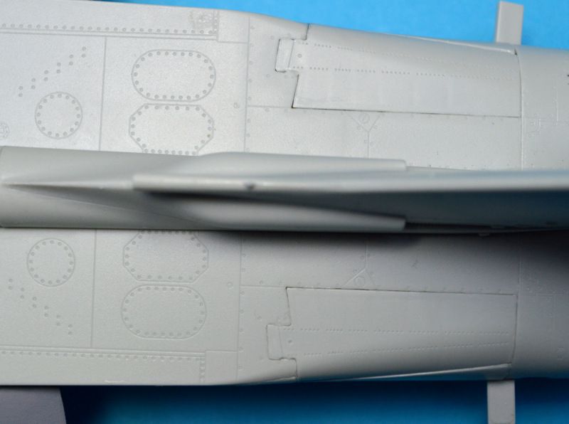

Is it me or is that bulge at the base of the fin between the intake and exhaust far too prominent?

As for the base of the fin, yep that is something that I am aware of too, (just working up a list of things at the mo) and will address very soon.....It seems that the section is just too fat and has a prominent bulge which looks odd. The real thing is flatter though I don't think it'll be too difficult to get it right......
Here's the real thing taken from the walkaround section.......you can see it's definitely flatter with a more subtle top edge.....I have a feeling that the front section is more bulked out too !
And other shots of the area......the area is quite prominent ...

And here's Revells version....just looks wrong !.......

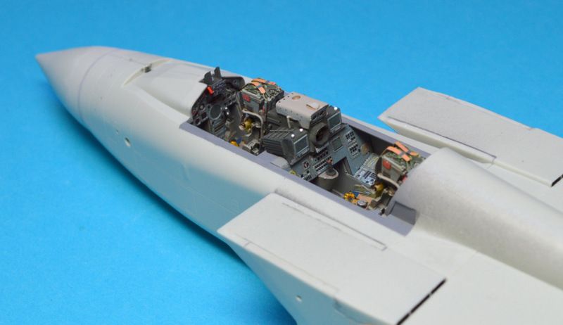

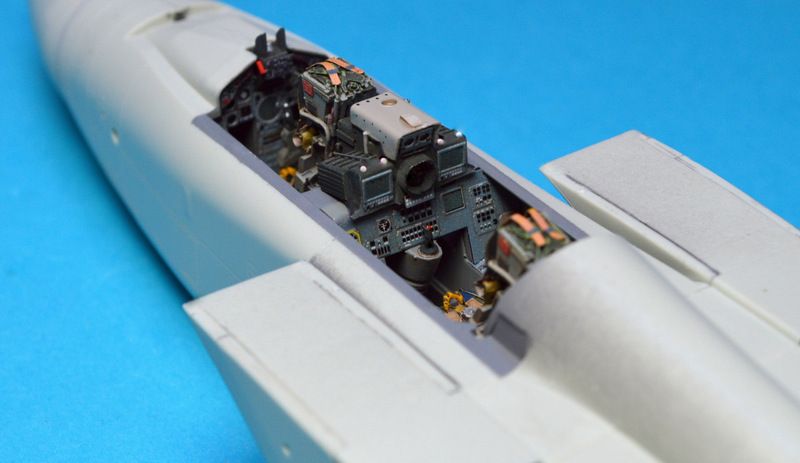

Managed to finished the basic cockpit and everything's been put into the tub, nothing glued yet as I need to and a bit of plumbing first and be sure that it all fits ! You can't really see it but I fitted a 2.5mm green lens into the CRPMD binacle which gives a nice representation of the unit... Hopefully I'll get on with the undercarriage next and as usual there's a fair bit to cram in there....
The bulkhead behind the rear seat has some material covering it, (reminds me of plastic groundsheet material !), so I'll try and replicate this using either crushed aluminium foil or crumpled wt n dry paper. The climate control system tubes need tan/pink coloured hoses fitting too, I'll probably get hold of some 1mm perl hosing from Little-Cars at the next show..

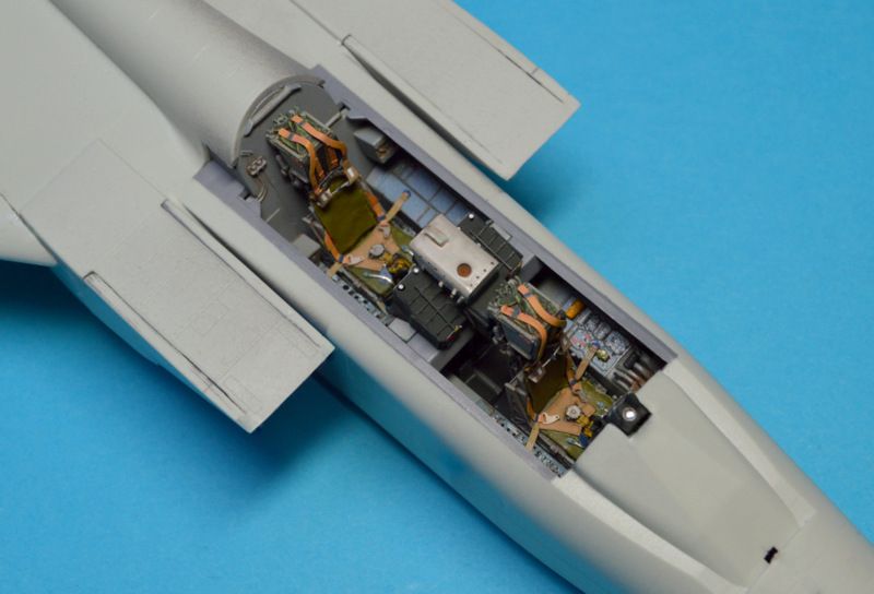

Love the seats General!! However it looks as if there are 4 shoulder straps per seat! The ones you have hanging down the sides with the QRB fasteners on the seat pad don't exist on the Mk10 seat. Sorry to be the bearer of bad news!!
Link to comment
Thanks again guys, Al yep, you're right..no excuses really. There's nothing quite like taking data from the original and some companies are definitely better than others for this though most have some error or another which is to a degree understandable, it's really about to what degree it is. Apparently Airfix were at Cosford taking measurements of the Valiant and yet they still managed to get some basic things wrong seemingly relying more on inaccurate drawings for some reason, though their later efforts seem better for this. The less said about certain far east companies the better, but I'm really surprised at Revell with this one. Having said that none of the errors are insurmountable and for me just makes the building more fun in a perverse way...
Link to comment
Thanks Wasa, no problem as I haven't glued the seats in yet I can adjust them............this is where the collective specialist knowledge comes into its own !
The straps I thought had the QRB fasteners on actually seem to be part of the large triangular seat 'strap ?'....I'll just tuck em into the lower piece as per the photos,

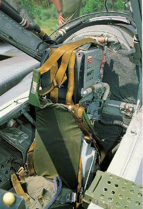

Here's a scan of an RAFG GR1A seat photo...

There are only two qrb fasteners on the tornado seat straps which are on the shoulder straps. The lap strap ends are a rectangular metal loop through which the crotch straps fit and the qrb fasteners go through the crotch strap loops and into the qrb therefore holding the driver or passenger onto his/her rocket powered armchair. The straps you pointed out in your photo are in fact part of the parachute harness. The lower strap in your photo is one of the crotch starps and shows the loop the qrb fastener goes through. HTH
