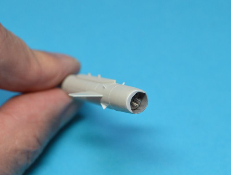

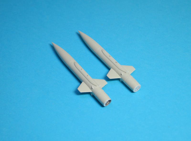

spike7451 Posted October 6, 2014 Share Posted October 6, 2014 Scoots, to be honest I've got two spare BOZ pods so may well do another in the unloaded config so I have the choice. The few photos I have of RAFG 2 squadron GR1A's only show the pods loaded. Cheers.... Here you are mate; (Cant remember where I got them from credit to the owner of the images) 4 Link to comment Share on other sites More sharing options...
general melchett Posted October 6, 2014 Author Share Posted October 6, 2014 Great stuff spike, thanks for that, that's the money shot.........love the 'scart' socket !! 1 Link to comment Share on other sites More sharing options...

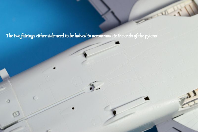

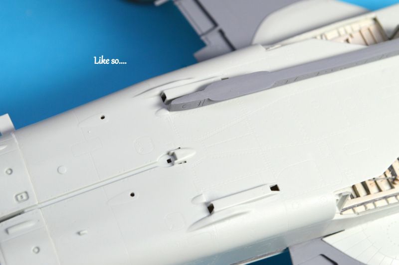

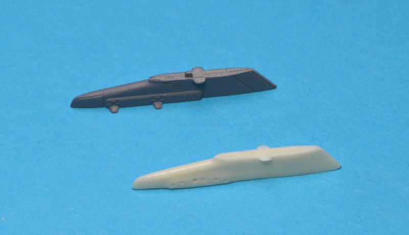

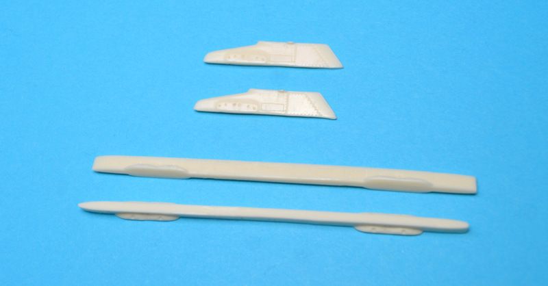

general melchett Posted October 6, 2014 Author Share Posted October 6, 2014 These are the new resin replacement pylons necessary for the GR1/4/A as mastered and cast by Shaun.....lovely, if you're making an RAF variant these are a must have... The two shoulder pylons as fitted to the GR1A, (the central pylon wasn't generally carried on the GR1A due to the TIRRS reece equipment, though apparently once the equipment was decommissioned on the GR4A's they could be fitted ). As you can see the MACES bulges are moulded in and the pylon is shorter than the IDS versions, the two small bulges on the rear fuselage underside need to be half removed..there were no cut outs at the rear of the RAF pylons as per the IDS aircraft. Outer wing pylons are also very different from the IDS version above, And primed .... The shoulder pylons are handed with the correct outer detail and plainer inner surfaces......IDS one above, (upside down...you can see the small cut out at the rear left) I'll probably have an extra 1500 ltr tank on the right hand pylon and will therefore need to detail the underside of the left one as it's quite complex. My thanks to Shaun for the pieces... Melchie... 2 Link to comment Share on other sites More sharing options...

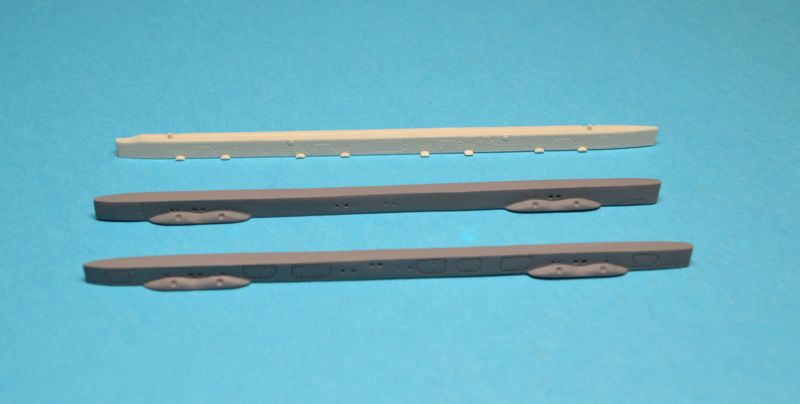

general melchett Posted October 8, 2014 Author Share Posted October 8, 2014 Finished detailing the undersides of the pylons....this needs to be done as a lot of surface is visible even with a 1500 Ltr tank fitted and they just don't look right without it. Takes a fair bit of time but with the use of some decent reference photos, a fresh scalpel blade, selection of micro drill bits and a micro chisel the work is made considerably easier...... Once cleaned up they were primed ready for fitting to the underside.. 7 Link to comment Share on other sites More sharing options...
