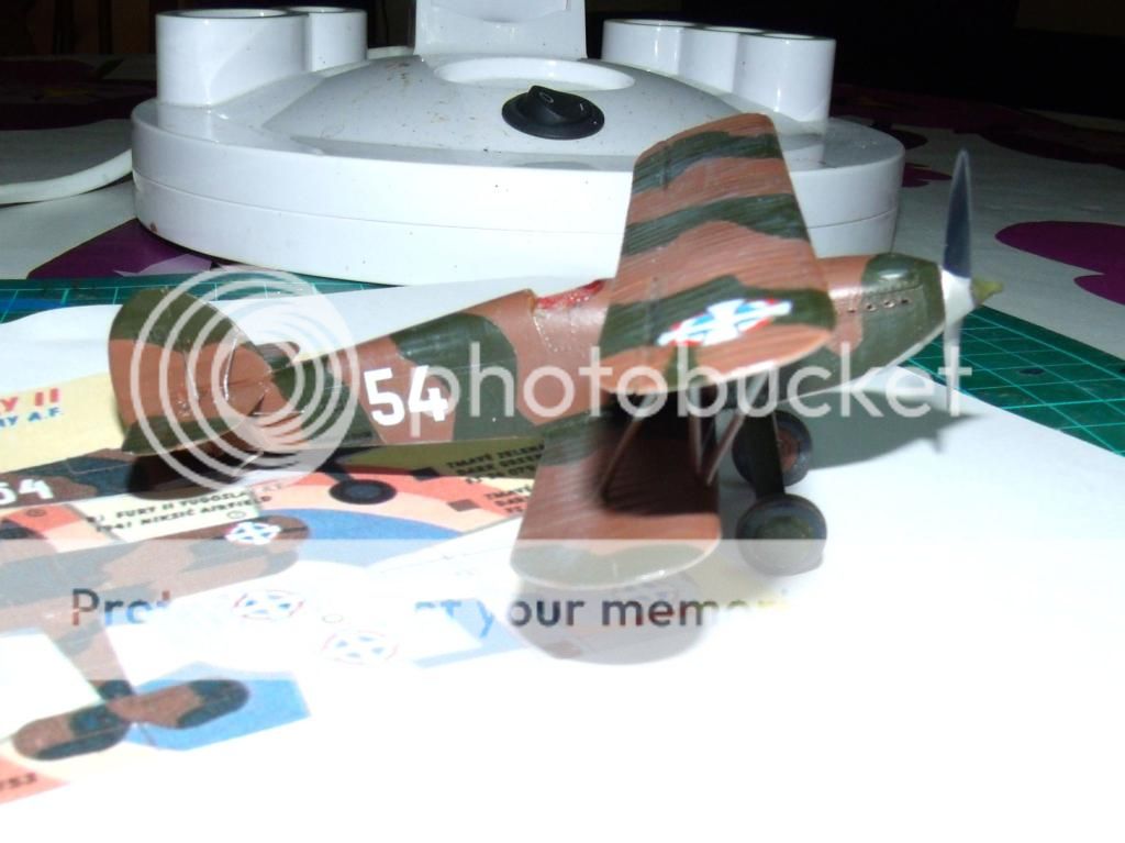

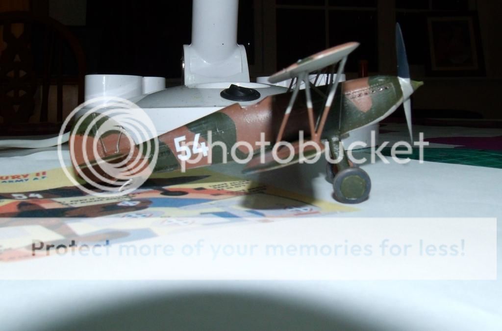

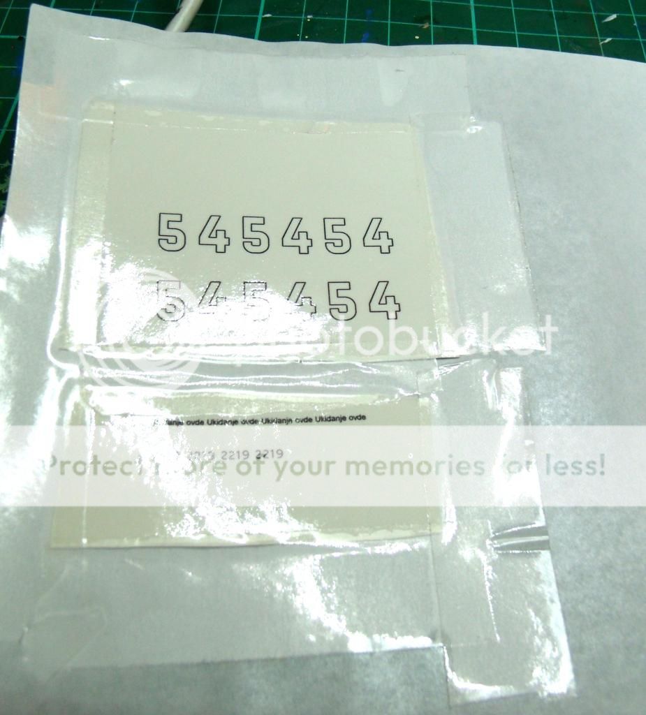

Mitch K Posted September 21, 2014 Author Share Posted September 21, 2014 A bit more progress: here are the home-printed decals, the white identity numbers, some serials and an effort at the lifting point markings. The identity marks are on solid white decal paper, so will need very careful trimming to get right. The shine doesn't make photographing any easier! Here she is with the ID numbers and serials on, plus propeller, wheels and wheel centres. The latter are a pig of a thing to work with: they are too large a diameter for the recess, and need sanding and scraping extensively to fit satisfactorily. Also, pushing them in and popping them out to check the fit is fraught because the curved axles are pretty delicate. The propeller colours are pretty much a S.W.A.G. The photos look like the props were painted, possibly with aluminium dope, and the backs of the blades might have been black (as per a museum example I've seen). The spinners varied, some seem to be all in camoflage colours, some with the body in aluminium, some with the tip. It's varnishes, a touch of shading and the windscreen to add and she's about done. The irony is I've managed to build this quicker than Airfix can send out a replacement unarmoured windscreen for my Hurricane! 2 Link to comment Share on other sites More sharing options...
