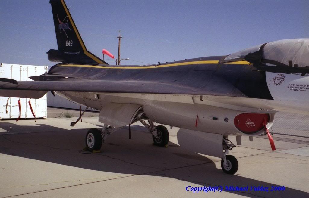

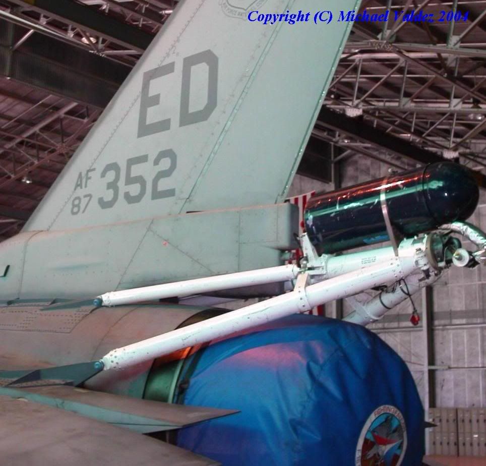

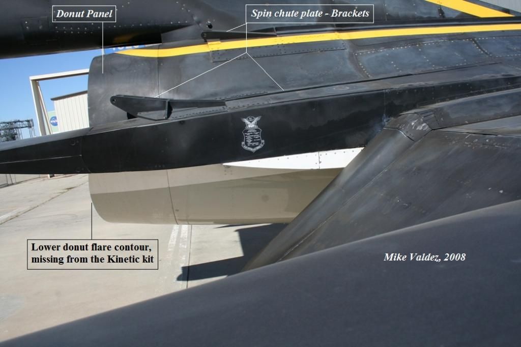

Mike V Posted February 14, 2015 Share Posted February 14, 2015 (edited) Looking good, but I already see a problem. Why did they leave the donut panel on the fuselage? The lower curve contours are missing from the trailing edge. Interesting. Can't wait to get my sample and check the shape and contours against my refs. Any word on the decal options ?I hope that decals for the NASA livery are included. I doubt it, Even if so, the kit will need to be upgraded with the spin chute bracketing to be correct. Ship 1 received the Spin Chute mod in mid 83. Edited February 14, 2015 by Mike V 1 Link to comment Share on other sites More sharing options...

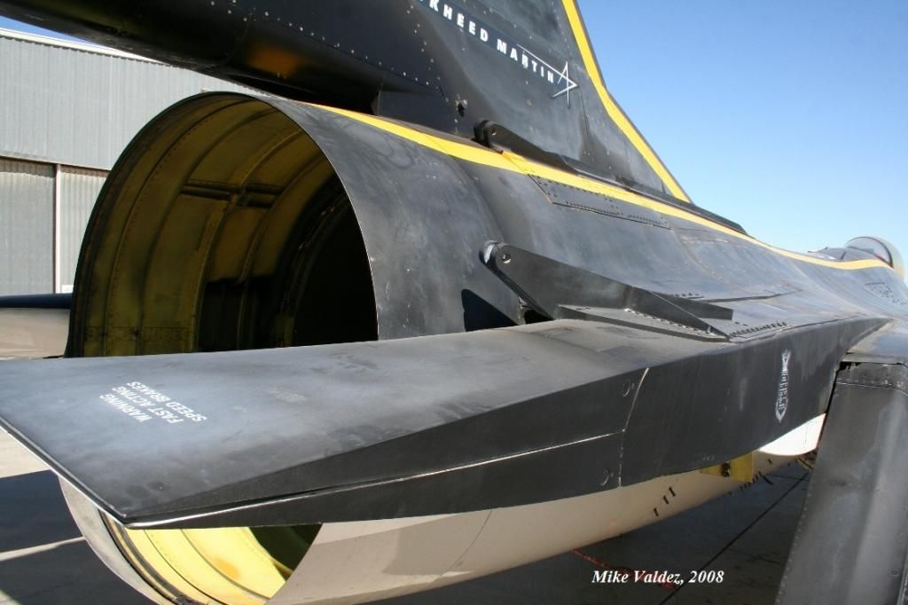

Pascal Posted February 14, 2015 Share Posted February 14, 2015 Looking good, but I already see a problem. Why did they leave the donut panel on the fuselage? The lower curve contours are missing from the trailing edge. Interesting. Can't wait to get my sample and check the shape and contours against my refs. I doubt it, Even if so, the kit will need to be upgraded with the spin chute bracketing to be correct. Ship 1 received the Spin Chute mod in mid 83. Hi Mike, What is the donut panel and where is it located ? The spin chute bracketing can be made from strips of plasticard. Will require some trial and error but it will make it an interesting and original project. Would you be so kind and do a tweaks list on what needs to be changed to convert the kit into an early and a late single seat F-16XL ? As for the decals : an excellent decal designer did a wonderful NASA decal sheet that has lots of meatballs, logos and swooshes some (was it 20 ?) years ago. Jennings, can you help us ? Link to comment Share on other sites More sharing options...
Mike V Posted February 14, 2015 Share Posted February 14, 2015 Donut panel installed without the engine. This is not the norm when the Engine is out of an F-16. However since the XL was stored outside, the donut and bathtub panels were installed fully. The XL's donut panel is the same as the Pratt F-16A/C donut panel. The spin chute bracketing can be made from sheet strip stock, but you need to note the layout and the angles of the main mount brackets. The brackets angles just need to be close, unless you plan to make and install a spin chute assembly; then the proper angling is crucial. As per: I'll be making a list of tings to correct and add to make either the early non-spin chute/non Heavy Weight Gear F-16XL Ship 1 and the Post 83 Mod, with the Spin Chute and Heavy Weight Gear mods. Still need to see the kit though. NASA XL Decals would be great, but need to be done correctly. CE did a nice job on their 32nd decal sheet; one of the few ares they did well in on their 32nd XL conversion. Mike V Link to comment Share on other sites More sharing options...
