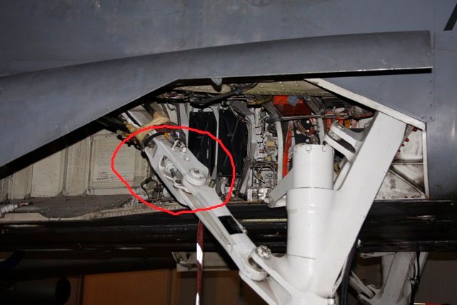

Does anyone happen to have some photos of where the "remove before flight" tags fit on the undercarriage links? Presumably they are on some kind of locking pins on the retraction arms?
I'm not fitting any of the aperture covers and their assogiated tags, just on the three legs, the nose pitot and the underwing pylons; I don't want it to look like a Christmas tree.
The undercarriage pins go through the drag brace part of the assembly about half way, like here
With the map, although the MASS flag is on that side of the cockpit i've seen aircrew put all sorts of maps and paper work on either side so having the map there isn't to far from the truth. This build is totally mad its sooo realistic its brilliant
