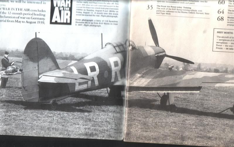

Dave Fleming Posted September 3, 2020 Share Posted September 3, 2020 On some early Hurricanes, the strip join over the outer and inner wing sections appears to be a lighter shade than the surrounding camouflage. What are people's thoughts on this? Link to comment Share on other sites More sharing options...
MilneBay Posted September 3, 2020 Share Posted September 3, 2020 22 minutes ago, Dave Fleming said: On some early Hurricanes, the strip join over the outer and inner wing sections appears to be a lighter shade than the surrounding camouflage. What are people's thoughts on this? That's intrigued me for years - I've put it down to an effect of light catching it at a slightly different angle to the rest of the wing. Could well be wrong though. Link to comment Share on other sites More sharing options...
Troy Smith Posted September 3, 2020 Share Posted September 3, 2020 On 03/09/2020 at 09:53, Dave Fleming said: On some early Hurricanes, the strip join over the outer and inner wing sections appears to be a lighter shade than the surrounding camouflage. What are people's thoughts on this? the joint strip has not been painted at this point. Hurricanes were painted as bits, then assembled. note also the masking tape still on the canopy I forgot to post this before, but I ran across a fascinating piece of wartime art "Assembling a Hawker Hurricane Elsie Dalton Hewland (1901–1979) Manchester Art Gallery" https://artuk.org/discover/artworks/assembling-a-hawker-hurricane-205190 what is of note is this superbly detailed, note the visible serials She also painted this Assembling Hawker Hurricane Aircraft: Swinging the Compasses and Making Test Flights https://artuk.org/discover/artworks/assembling-hawker-hurricane-aircraft-swinging-the-compasses-and-making-test-flights-7172 on two of the planes. Which, (as I just looked this up and hadn't noticed) show unpainted wing joint strips, which I think should be written as primered, but not top coated HTH PS, in the top pic of MW336, note immediately obvious are the as yet primred grey, (or unpainted?) tailplane fairings, more noticeable on the colour pic of KZ295 here. Also visible is the canopy masking. HurriKZ295tropproductionline by losethekibble, on Flickr 7 Link to comment Share on other sites More sharing options...
Dave Fleming Posted September 3, 2020 Share Posted September 3, 2020 Lovely paintings. So often these sort of things are ignored by modellers, but the artists were painting what they saw and it captures details that B+W photos don't - even if the coloursa are 'off' we can interpolate what the artist saw. For example (A little off topic perhaps) this one from the IWM collection shows that the RN operated Vought Kingfishers in USN colors and Temperate Sea Scheme. https://www.iwm.org.uk/collections/item/object/21848 back to the joint strips - what colour do we think? They look brown/buff in the paintings, so Zinc chromate yellow (Too dull?)? Hawker's buff primer/interior shade? Link to comment Share on other sites More sharing options...
