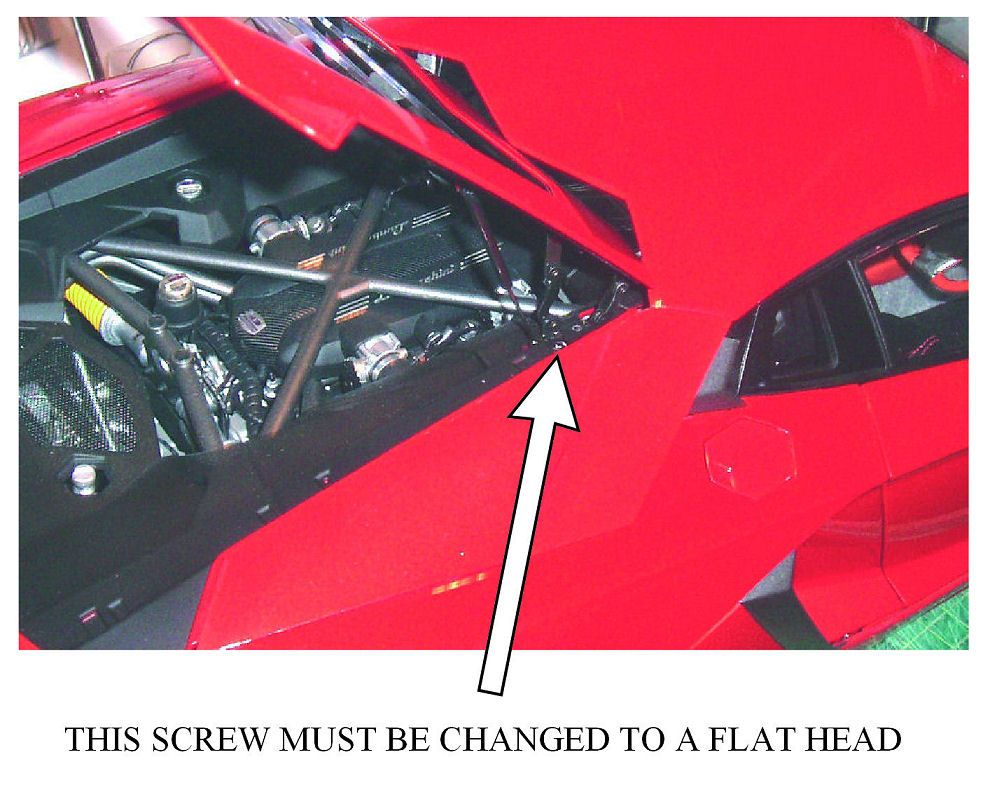

rjfk2002 Posted December 30, 2014 Share Posted December 30, 2014 Roy- This was an incredible build and inspired me to tackle my own. I have gotten all the way to attaching the rear body to the frame (step 28) and ran into the tail gate issue that you had - the rear lid/tail gate is not level with the roof. Which screws did you swap out the round head for flat? Was it the screws holding the hinges to the rear deck? Any help would be much appreciated. Given how fiddly the parts are I'm afraid to guess and check. Rich Link to comment Share on other sites More sharing options...
roymattblack Posted December 30, 2014 Author Share Posted December 30, 2014 (edited) Indeed, the tailgate screws shown - round heads - are the wrong ones. Being round, they protrude and hold the tailgate up. I swapped them for the short flat-heads. I can't recall which ones - It was just a case of comparing the size/shape. There are loads of spare screws once finished, so don't worry about running out. Here's mine completed with the removable rear: http://www.britmodeller.com/forums/index.php?/topic/234967507-pocher-aventador-all-done/ And here - 'on the road'...: http://www.britmodeller.com/forums/index.php?/topic/234967608-aventador-on-the-road/ Roy. Edited December 30, 2014 by roymattblack 1 Link to comment Share on other sites More sharing options...
rjfk2002 Posted January 4, 2015 Share Posted January 4, 2015 Thanks Roy. I swapped the screws out and still have the gap. I even gave up on the screws and glued the hinges to the rear deck lid yet it is still not flush (though better than when I started). I'm going to attempt to take the sides off and see if maybe the rear deck is sitting too high. Would welcome any suggestions you or anyone else have! Link to comment Share on other sites More sharing options...
roymattblack Posted January 4, 2015 Author Share Posted January 4, 2015 (edited) Hmmmm.. After I changed the screws around, my tailgate fitted nice and flush all round. Did you change ALL the screws - including the ones holding the strut bottom to the top of the bulkhead? That one caused the biggest problem. I've taken a picture of my tailgate area and highlighted the troublesome screw although it isn't too clear in the pic. It's the screw that looks a bit recessed. The tailgate strut is fixed to the body by an 'L' shaped bracket, that is fixed by a screw on the upper surface. THAT'S the one that needs changing. Roy. Edited January 4, 2015 by roymattblack Link to comment Share on other sites More sharing options...
rjfk2002 Posted January 4, 2015 Share Posted January 4, 2015 Thanks for the clarifying picture. I am using the flat head screws for that L-bracket (with the piston) and flat head screws to hold the hinge to the body. I took the screws out holding the sides to the cabin (A on the bottom and the hidden N screws for anyone else following) and now its pretty flush. I think that was the other problem - when I screwed the side panels into the cabin it must've warped the body slightly. Now it is almost completely flush! Thanks for your help. Link to comment Share on other sites More sharing options...
