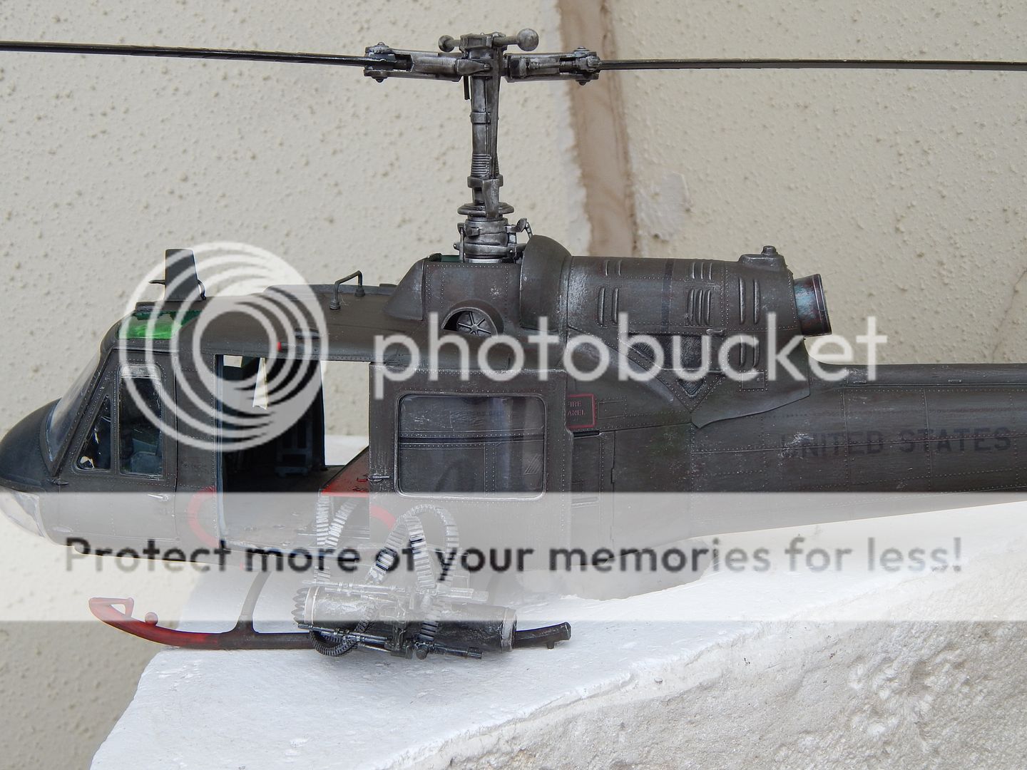

georgeusa Posted June 3, 2014 Share Posted June 3, 2014 Tiger, I know this sounds strange, but when weathering Vietnam and up helos, I try a very light overall dry brushing of Testor's metallic silver over the surface. It tends to dull things down overall, while highlighting details. This is on a 1/24 Revell Huey. See if it works for you. Link to comment Share on other sites More sharing options...
