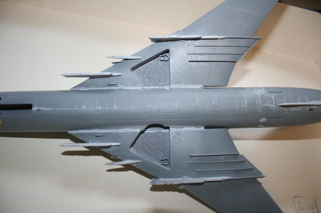

Muzz Posted May 29, 2014 Author Share Posted May 29, 2014 Thanks for all the comments. Some major progress, the wings are on, some fit issues funnily enough but shouldn't be too difficult to overcome. I had removed the locating tab from the lower wing section as I had already identified this as a problem. This produced a thinner locating tab so the wing could be moved around within the locating tab to get the best fit. This worked to a point, I'm pleased with the starboard wing but the port side didn't work out quite as well, I used CA to fix the wings into position and by the time I noticed the port side wasn't quite in the best spot it had set in place! However I've put a strip of thin plastic along the gap and the joins have been given a covering of Mr Surfacer. I had also added the nose ring yesterday and this is now blended into the fuselage, again using Mr Surfacer 500. 2 Link to comment Share on other sites More sharing options...

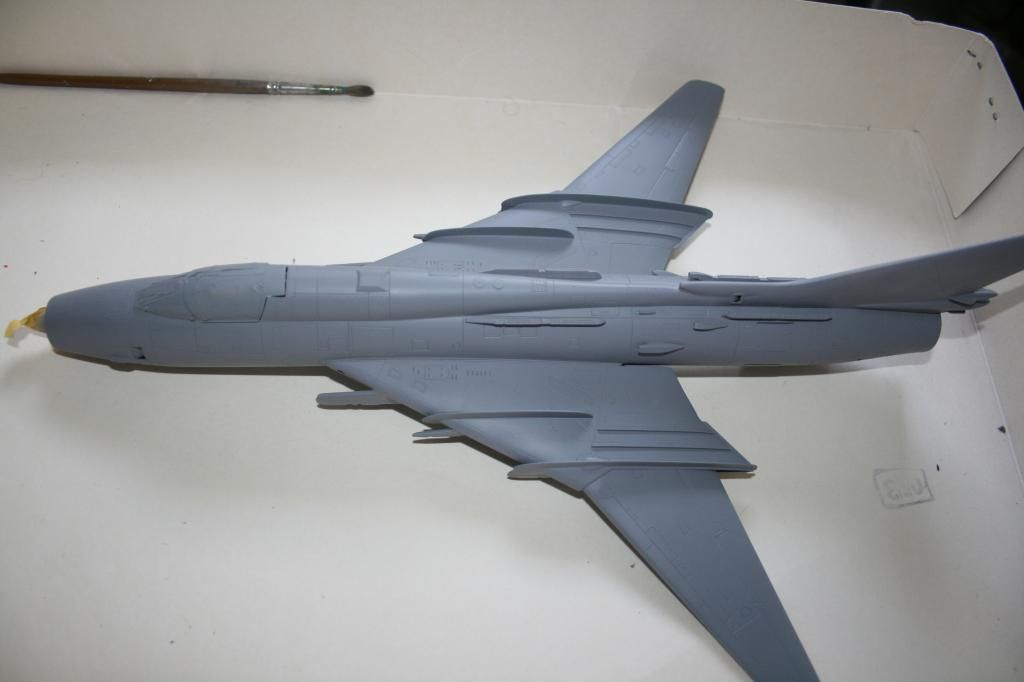

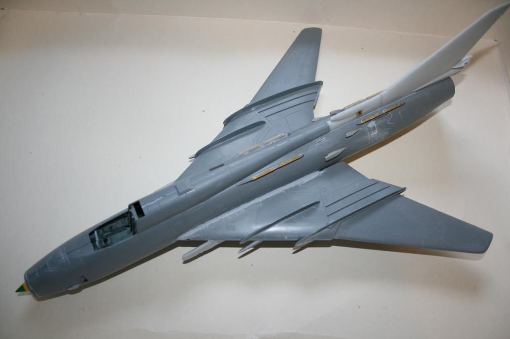

Muzz Posted October 14, 2014 Author Share Posted October 14, 2014 Cheers guys, not done much with this recently but I do have some updates.......... Primer coat on. Link to comment Share on other sites More sharing options...
Tomjw Posted October 14, 2014 Share Posted October 14, 2014 Looking good. Might have to get one of these kits. Tom. Link to comment Share on other sites More sharing options...

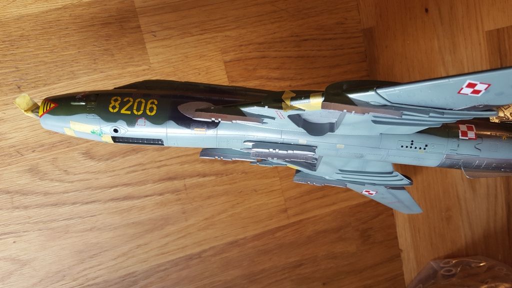

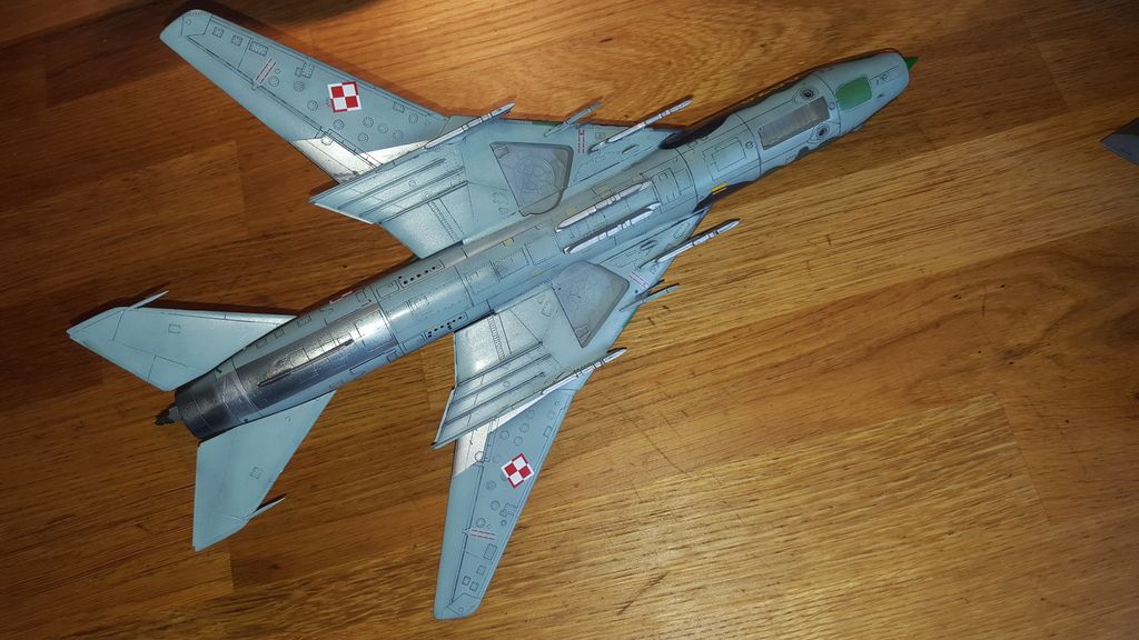

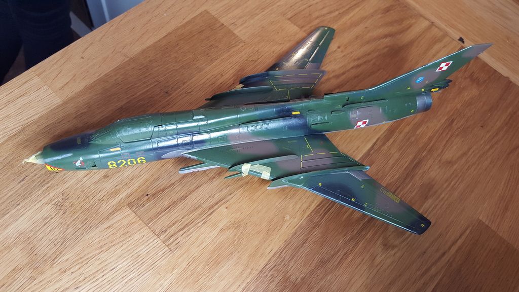

Muzz Posted July 27, 2015 Author Share Posted July 27, 2015 Can't believe it's been 10 months or so since my last update on this! Lost my mojo with it but it came running back a month or so ago and got a lot more done. You'll have to excuse crap rushed photo's taken with my phone the jump in progress but this is where it's at now.......... Masked up bits to add some bright green then it'll be a matt coat. 6 Link to comment Share on other sites More sharing options...
exdraken Posted July 27, 2015 Share Posted July 27, 2015 he's back! nice to see THAT update! looking absolutely stunning! any plans for armament? Eduard, Aires, Upnorth, and Advanced Modelling do really really nice bombs and missiles... think about it! and for external tanks GWH has them in their MiG-29 kits... 1150l in the newer boxings, 800l in their older ones if you shorten the too short ones (for 1150l of course) they are much nicer than the kit supplied ones! Link to comment Share on other sites More sharing options...
Breaker Posted July 27, 2015 Share Posted July 27, 2015 Nice update, I love how busy the -22 is, you've made it look good as well! Link to comment Share on other sites More sharing options...
Marlin Posted July 28, 2015 Share Posted July 28, 2015 Looks great Muzz /Bosse Link to comment Share on other sites More sharing options...

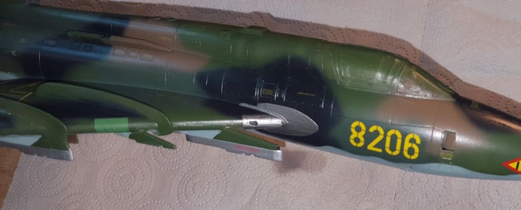

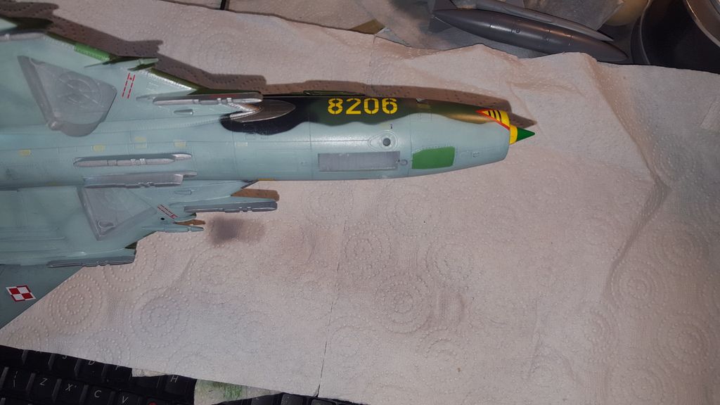

Muzz Posted August 1, 2015 Author Share Posted August 1, 2015 Yes that's the chap, Harvy5. Was going with the UB-16 as I have them handy, may have to purchase some UB-32's though! Amazingly another update although not much to show, got the bright green on the leading edges and under the forward fuselage done using Akan's Radome Green. I also got a semi-matt varnish down, was going to go for matt varnish but decided to go with the semi matt to see how it looks. 4 Link to comment Share on other sites More sharing options...

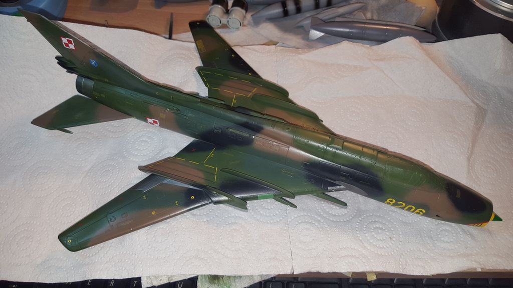

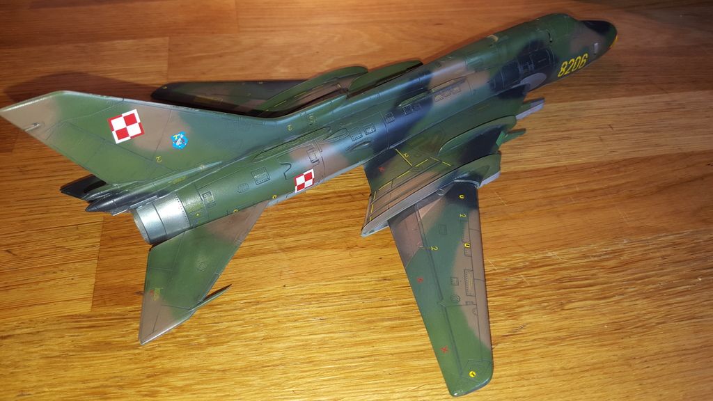

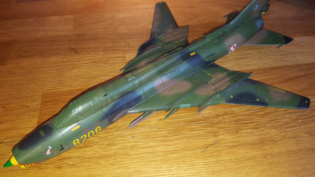

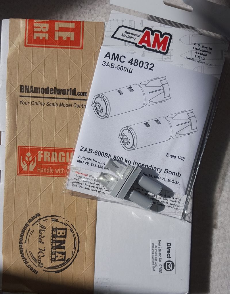

Muzz Posted August 15, 2015 Author Share Posted August 15, 2015 Wash added and pics as promised.............. And these have literally just arrived from Oz..... 3 Link to comment Share on other sites More sharing options...

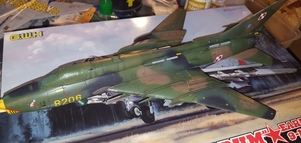

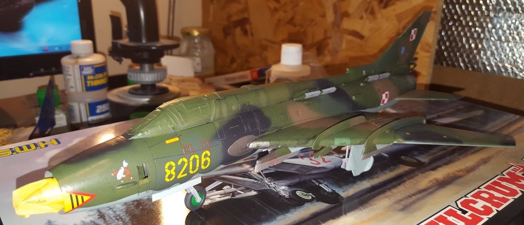

Muzz Posted September 2, 2015 Author Share Posted September 2, 2015 Undercarriage / doors on and countermeasures dispensers painted on the fuselage, getting there..................... 6 Link to comment Share on other sites More sharing options...
exdraken Posted September 3, 2015 Share Posted September 3, 2015 absolutely nice! cool progress! nice bombs! I like this Company (AM) and their products a lot! 1 Link to comment Share on other sites More sharing options...
