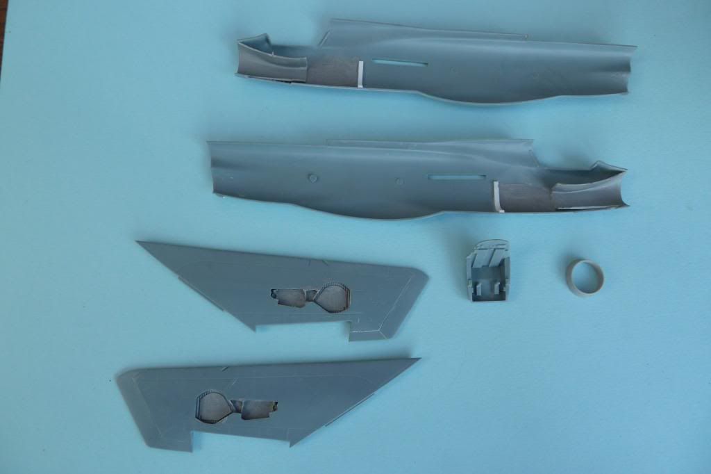

Paul J Posted May 17, 2014 Share Posted May 17, 2014 My T Bird Lightning should be on show here late Sunday or early part of next week. Seats make up beautifully with those precoloured etch parts but are a tight fit in the tub but DO fit !!! No other major issues found in building. Cockpit tub fitted very well, no issues for me there. ( I did read elsewhere of probs, but none found).And haven't had to use any filler at all!! Not like the Czech kits of the past. Must be one of Swords best models I've built so far!! Link to comment Share on other sites More sharing options...
Sten Ekedahl Posted May 17, 2014 Share Posted May 17, 2014 Yes it's a h*ll of a good kit. Requires a bit more work than the Airfix F2A, but that's to be expected with a shortrun kit in my opinion. Only problems I have discovered so far are the the cockpit tub which I have, contrary to a few others, found slightly too wide; thr preprinted PE instrument and sidepanels which I thought would be black (I have the T.4 kit). My biggest worry is the front of the air intake. The inside of the front edge is of uneven thickness and you are left with a nasty joint both at the top and the bottom. I wish Sword would have made the front of the intake as a separate part. I will either use the intake cover provided in the Airfix kit, or maybe get the Quickboost intake rim intended for the Trumpeter kits. Anybody tried the latter approach? BTW, the T.5 square top fin had been removed from my kit. Is that standard? As a comparison the Sword two seat Harrier kits contained all the parts for both T.2 and T.4. Only the decals differed depending on the boxing. Link to comment Share on other sites More sharing options...
Paul J Posted May 18, 2014 Share Posted May 18, 2014 're the fin,yes,someone at Sword had done this to each version of the kit. I contacted them and have been informed that this practice will be stopped. With the intake rim,I carefully pared it down and tiny smear of filler sorted out the join. Link to comment Share on other sites More sharing options...
cardiff guy Posted May 18, 2014 Share Posted May 18, 2014 (edited) I have cut the Sword intake ring off and am going to use the trumpeter nose ring also used the trumpeter intake ducting though I think the Airfix assembly would work better . regards Glenn Edited May 18, 2014 by cardiff guy Link to comment Share on other sites More sharing options...

Sten Ekedahl Posted May 24, 2014 Share Posted May 24, 2014 I have just received the Quickboost resin nose intake from Hannants today. Although intended for the Trumpeter horror job, it looks like it's going to fit the Sword kit quite well. Link to comment Share on other sites More sharing options...
Sten Ekedahl Posted May 24, 2014 Share Posted May 24, 2014 Sawed off the intake rim on the Sword kit to testfit the Quickboost resin intake. Turned out to be a near perfect fit. Just need to enlarge the opening slightly. Recommed this solution to get a good looking nose on your two-seat Lightning. 1 Link to comment Share on other sites More sharing options...

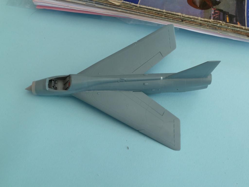

cardiff guy Posted May 25, 2014 Share Posted May 25, 2014 (edited) Ok so I've been having a bash at this one. Not a shake and bake kit ,but a good one . I have replaced the intake ring with the ring and nose bullet from the trumpeter kit also used the trunking. I also found when i placed the fuesalage on some old plans the spine a little short so I added a shimey of plastic card. also a little inspiration a T.55 Airfix wing and belly tank should do the trick. Happy modelling Glenn. Edited May 25, 2014 by cardiff guy 1 Link to comment Share on other sites More sharing options...

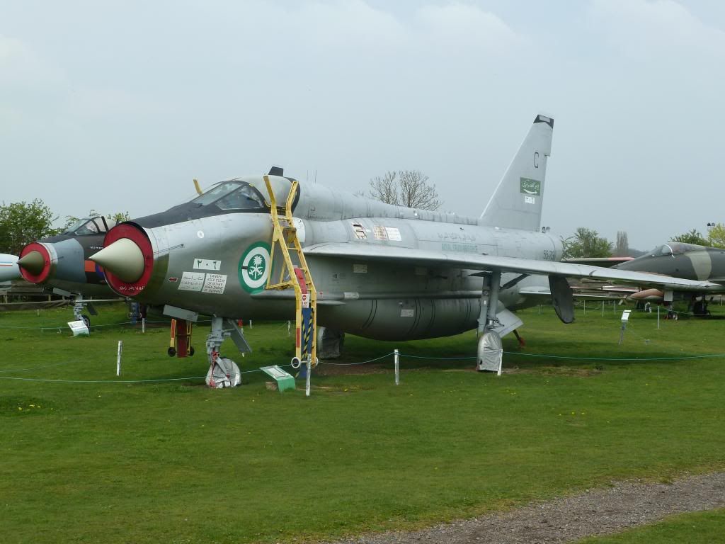

sailorboy61 Posted May 20, 2015 Share Posted May 20, 2015 And when we're done in 1/72, upwards and onwards at 1/5: 3 Link to comment Share on other sites More sharing options...
keefr22 Posted May 20, 2015 Share Posted May 20, 2015 How cool is that??!! Totally unrealistic though - a real one wouldn't have the fuel to display for that long!!! 1 Link to comment Share on other sites More sharing options...
woody37 Posted May 20, 2015 Share Posted May 20, 2015 I've just shown this to my son. He wants to buy one! So do I !!!! Link to comment Share on other sites More sharing options...
