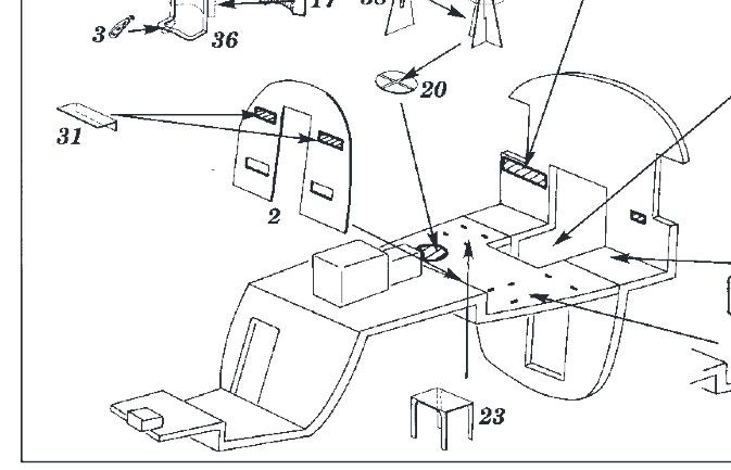

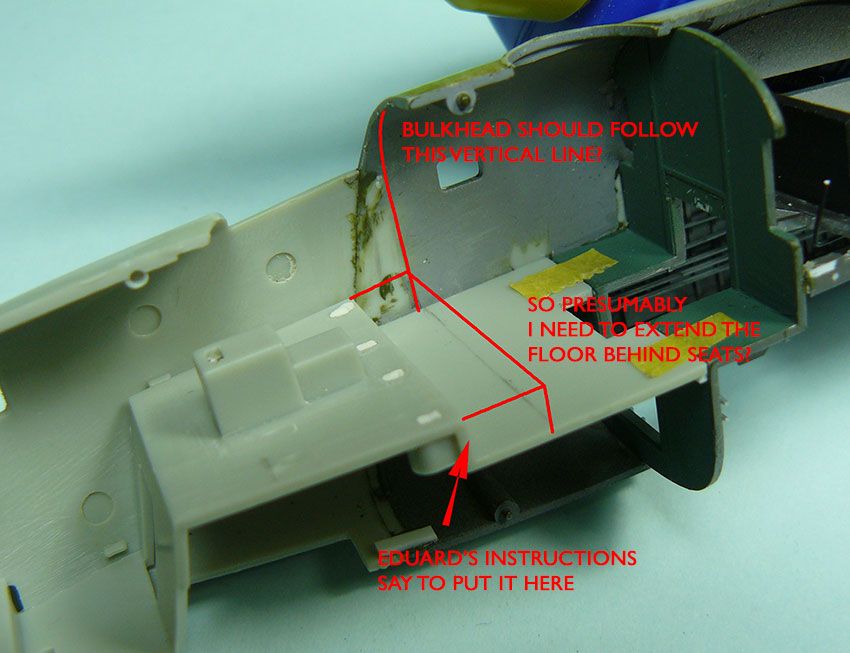

On with the cockpit, and I'm a little confused. I've got Eduard's 72191 set for the Minicraft B-24J, and there's a bulkhead just behind the pilot seats.
According to the instructions, the bulkhead (part number 2) sits at the rear of the floor level of the pilot seats:
eduard-72191b
But if it goes where Eduard say to, it's too far forward. So, presumably I need to extend the floor level backwards to make the bulkhead sit in the right place, indicated by the red vertical indicated here in my little schematic:
eduard-72191
I assume the bulkhead is vertical, and not slanted backwards? Is that right?
Simon
Edited by Simon
relinking images from Photobucket to Flickr
Link to post
Simon
Simon,
From what limited information I can find (an old cutaway which appears to have been widely published), it seems as though there may in fact have been two bulkheads - one that is slanted backwards (ala the Eduard instructions), which meets at the top of the fuselage with a second, straight vertical bulkhead. So you might not actually have to extend the flight deck backwards...
Byron
Link to post
Thanks Byron.
I've seen the cutaway you mean, I think, and it does seem to show a slanted bulkhead in front of the vertical one. I've dug out a load of photos from online, it it looks like there is a wide rib that follows the slanting panel line where the nose joins the main fuselage. From the photos , it looks to be about 6 or 8 inches wide, so maybe this is what it depicted in the cutaway. You can just see it on the left-hand side of this photo:
http://acesflyinghigh.files.wordpress.com/2013/03/img_3902-1024x683.jpg
It also looks like the lower section of the rear bulkhead slants forward to meet the front rib about halfway up, but as always, I can't find a photo that conclusively shows this. That would mean the floor need to be extended backwards, but not by as much as I thought:
eduard-72191C2
Oddly, Eduard don't include this new bulkhead in the photo-etch in their re-boxing of the Academy/Minicraft kits. :shrug:
Anyway, enough thinking out loud, must get on with the actual job...
Simon
Edited by Simon
Link to post
