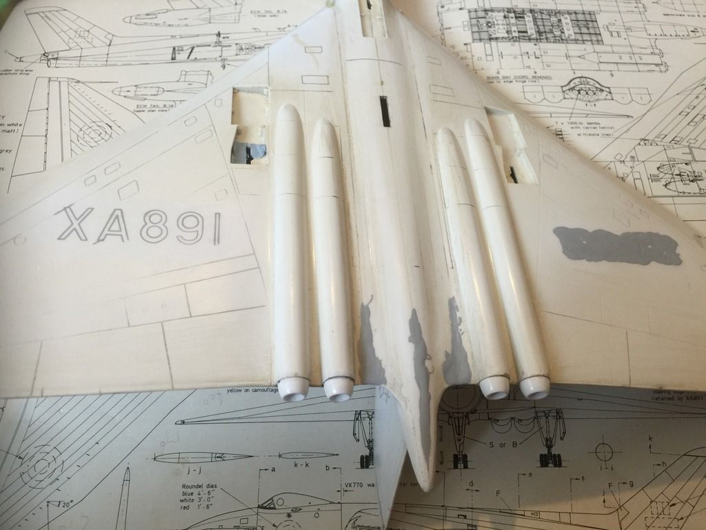

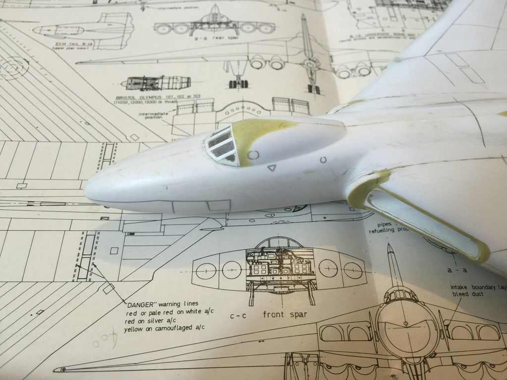

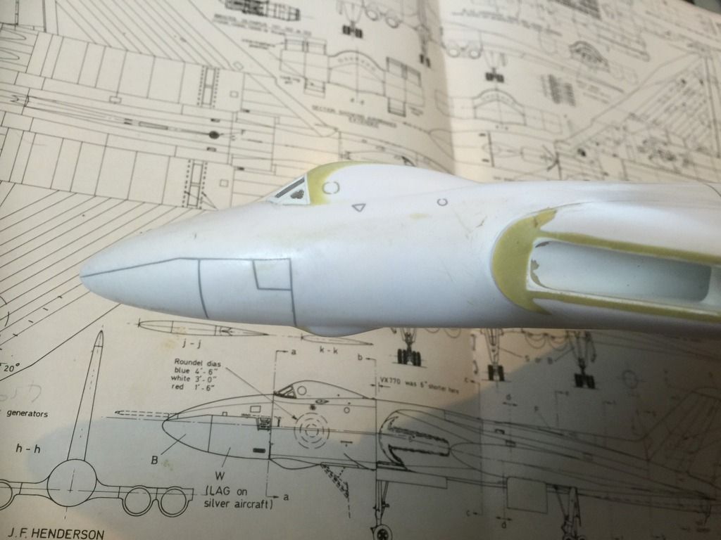

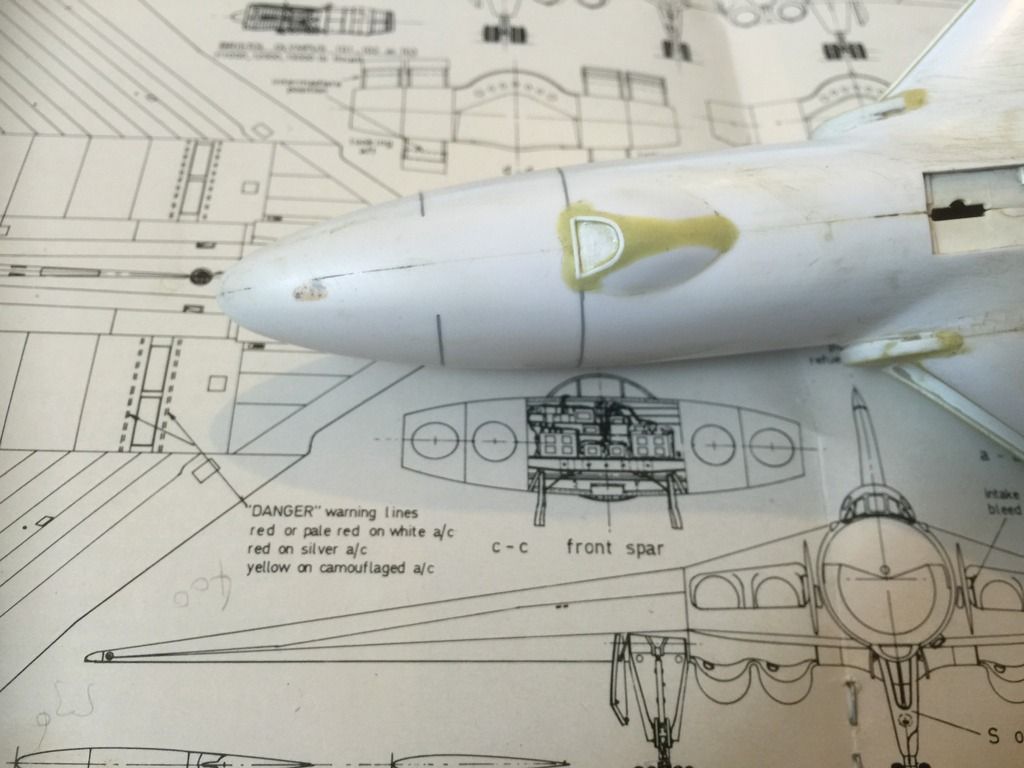

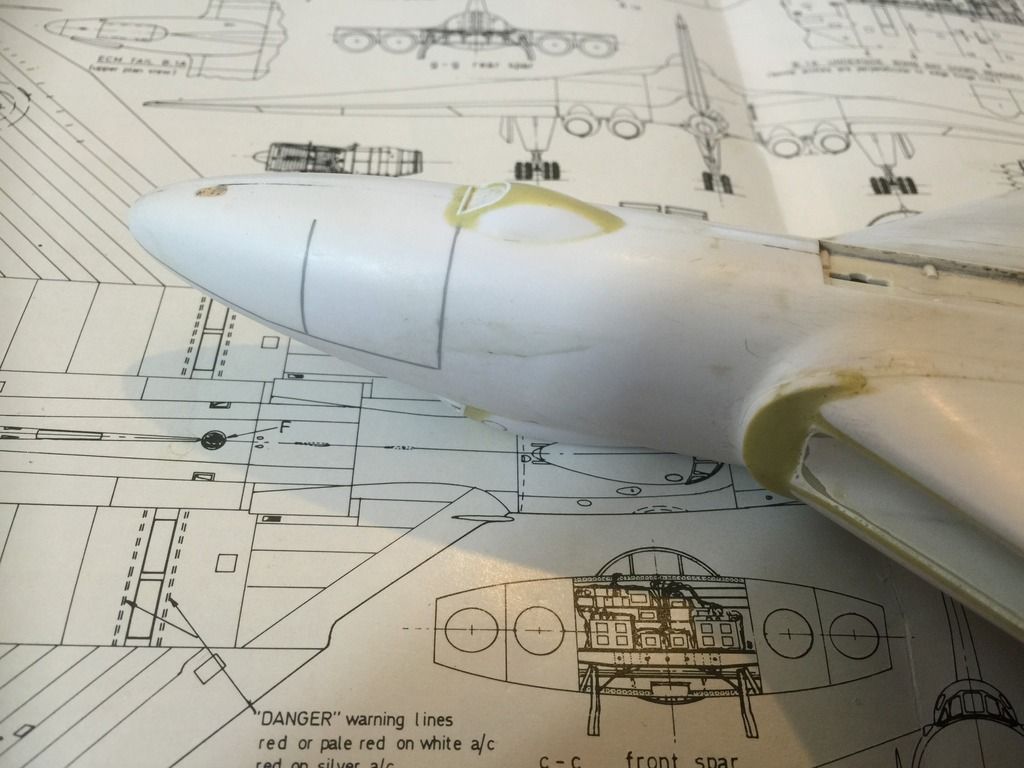

robvulcan Posted October 16, 2015 Author Posted October 16, 2015 I have not touched this for a few weeks except to dream about the end result but here is a bit more progress of where I am up too. On the Canopy I have added milliput to feather in the frames and build up the shape to look more like the real deal with a little hump at the front which has improved the look I think. Same goes for the Bomb aiming window too. I have been infilling certain engraved lines numbers roundels and flaws with MrSurfracer 500 then I can start to scribe a bit more detail on and correct a few things. I need to blend in the exhausts now and angle then off so they slope at the back. More soon Rob 9

cathasatail Posted October 16, 2015 Posted October 16, 2015 Nice work on the canopy and bomb aiming blister, really coming together now I'll get some of my vulcan done tomorrow (as you know, I've been working out how it should be built, while dreaming of the finished product!) Goodnight all Sam 1

robvulcan Posted October 17, 2015 Author Posted October 17, 2015 Cheers Sam and Colin yes now the Milliput is set I can tidy it and blend it in with MrSurfacer and she how shes looking under some primer. I think its nearly there now the only real challenge how is tidying up the joins and rescribing a few details and scribing a few more details perhaps, oh and port holes then were nearly there. Cheers Rob 1

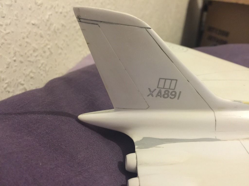

robvulcan Posted November 18, 2015 Author Posted November 18, 2015 Well I can't believe its another month since I worked on this... Well I will try and get the primer on before Christmas.. I have just reshaped the lower part of the rudder so it is a sharp angle like the real thing. Frog had put a curve there. Now I have to brave these port hole windows. I got some flat cutting Milling bits as per Bills recommendation. The plan is to star the hole with a normal drill then cut down only a by about 1MM. Rob 2
general melchett Posted November 18, 2015 Posted November 18, 2015 Good to see progress on this Rob, must admit I never noticed the curve on mine, (needed a magnifier but yes it's there, good call)....the windscreen looks good too, might well have to follow suite ! 1
robvulcan Posted November 18, 2015 Author Posted November 18, 2015 Good to see progress on this Rob, must admit I never noticed the curve on mine, (needed a magnifier but yes it's there, good call)....the windscreen looks good too, might well have to follow suite ! Cheers mate I also reshaped the fincap added the spine and blended the exhausts into the airframe as there was a nasty step there. Its getting there now just a few more bits of filler and sorting the port holes then Its time for some primer and a scribing session. I am undecided on a full scribe but whatever I do will be light as I can. I will probably focus on main points of interest like the radome, Air breaks and take it from there. The Control surfaces are not quite right and a lot of the panel lines on the wings is not quite right either. I am unsure weather to leave it as is, fill it all in, or correct it as best I can. Then it can make it to the next stage. I could do with getting them plans re-scaled to exactly 1/96 but I have no idea how to do it. Rob Looking goood Rob! John Cheers John and with all the stuff you sent me its going to be even more fun now Rob 1
