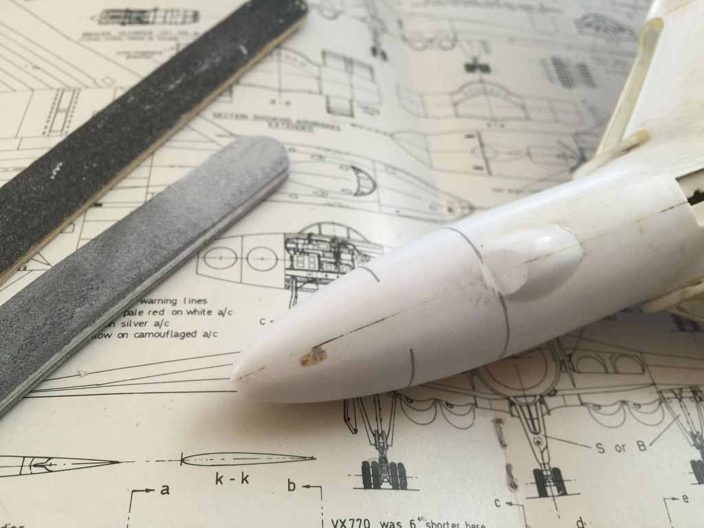

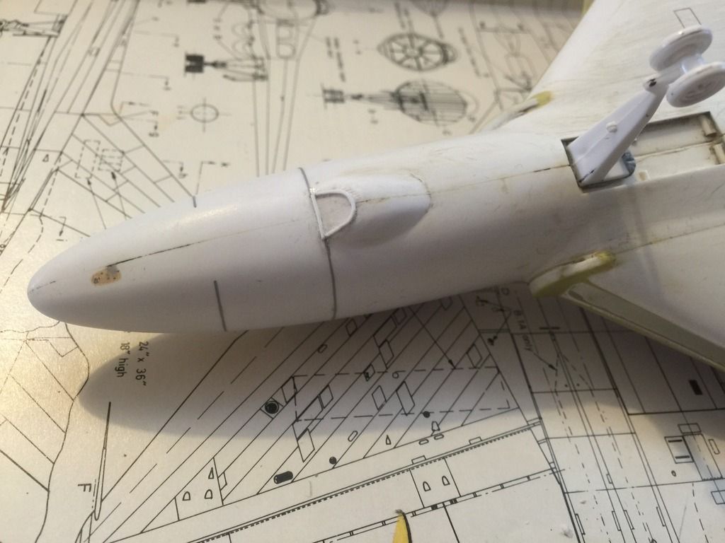

robvulcan Posted September 15, 2015 Author Posted September 15, 2015 I finished filing in the flat section window pane area. then gradually started to add the strip to the rear of the forward section. So far its looking how I want with the angles in there. Once all the strips are on and lightly reduced, blended and slightly filled at the back to blend tot he rear section it should look ok I hope. The forward area of the rear section actually looks like it needs a slight build up to me. I hope I am right. Cheers Rob 1

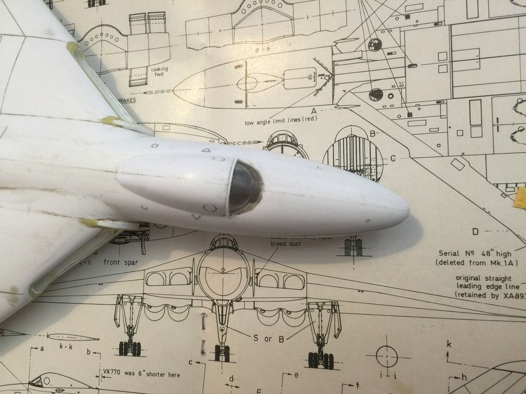

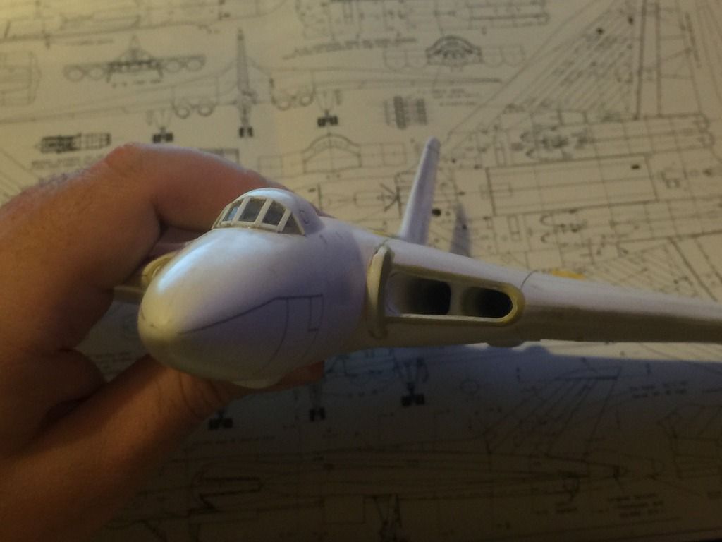

robvulcan Posted September 16, 2015 Author Posted September 16, 2015 Its a slow process mainly due to fumbling with piece of plastic trying to visualise what will and wont work.. But I decided to go the longer route with the finer strip to outline each frame as per the real thing. It should help me get it closer to the real thing . Cheers Rob 2

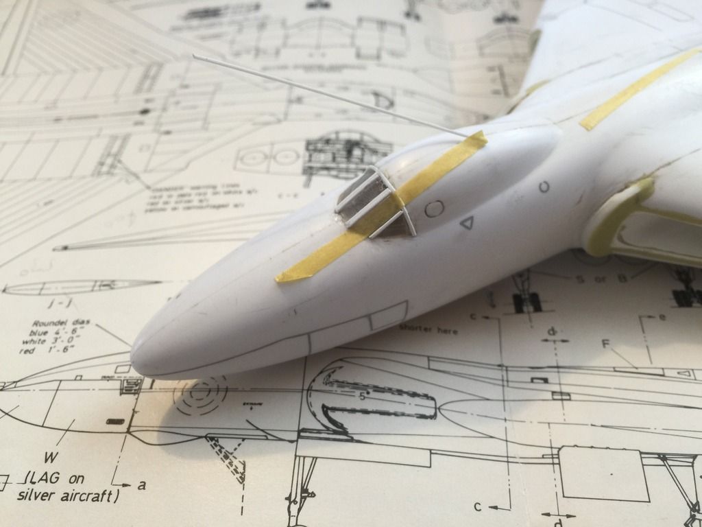

robvulcan Posted September 16, 2015 Author Posted September 16, 2015 Well in betwean the many other jobs of the day ive slowly got this far and im getting excited about what I am seeing. I had a curious measure of the canopy and the 1/144 drawings and did some maths and frog got it smack on. I would love to know how they used to make kits because the old ones so often seem to be right 3

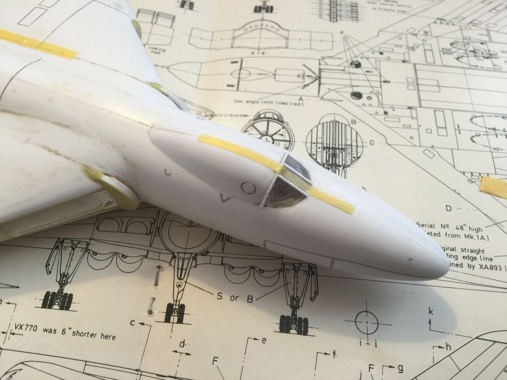

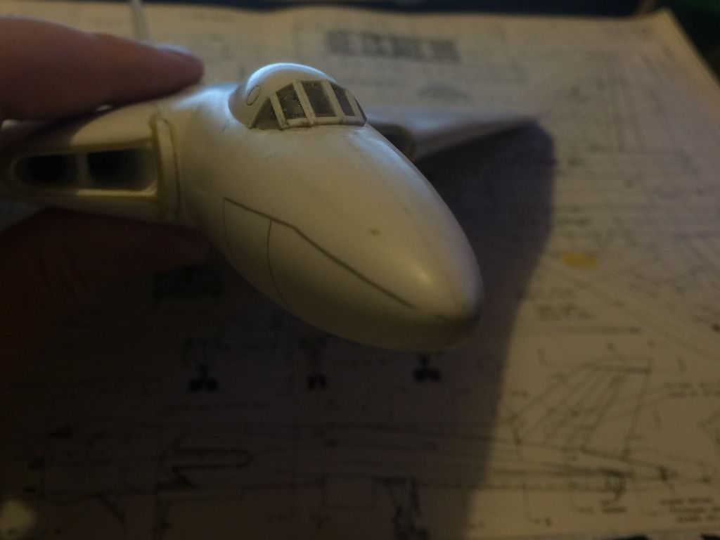

robvulcan Posted September 17, 2015 Author Posted September 17, 2015 (edited) Well thats the hard part of the framing done. Now to tidy it up and slightly reduce it then blend to the rear canopy. Also got to recess the side windows which I work out to be approximately 3mm. I picked up some Milling Bits for these (Thanks to Perdu for thinking of the name of them) They will allow me to cut a flat bottomed hole or recess. Rob Edited September 17, 2015 by robvulcan 4

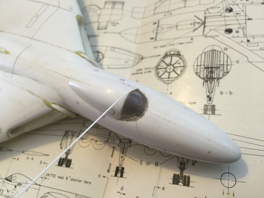

robvulcan Posted September 18, 2015 Author Posted September 18, 2015 Looking great so far, Rob! Top work Cheers mate. Just filing down the Bomb Aimers window. Its a bit vague in shape. and again no window is given. So I am cutting it back then I will bead it with plastic strip to get the shape then blend it with Milliput and I should have a recessed window that is the right size. I hope Rob 2
