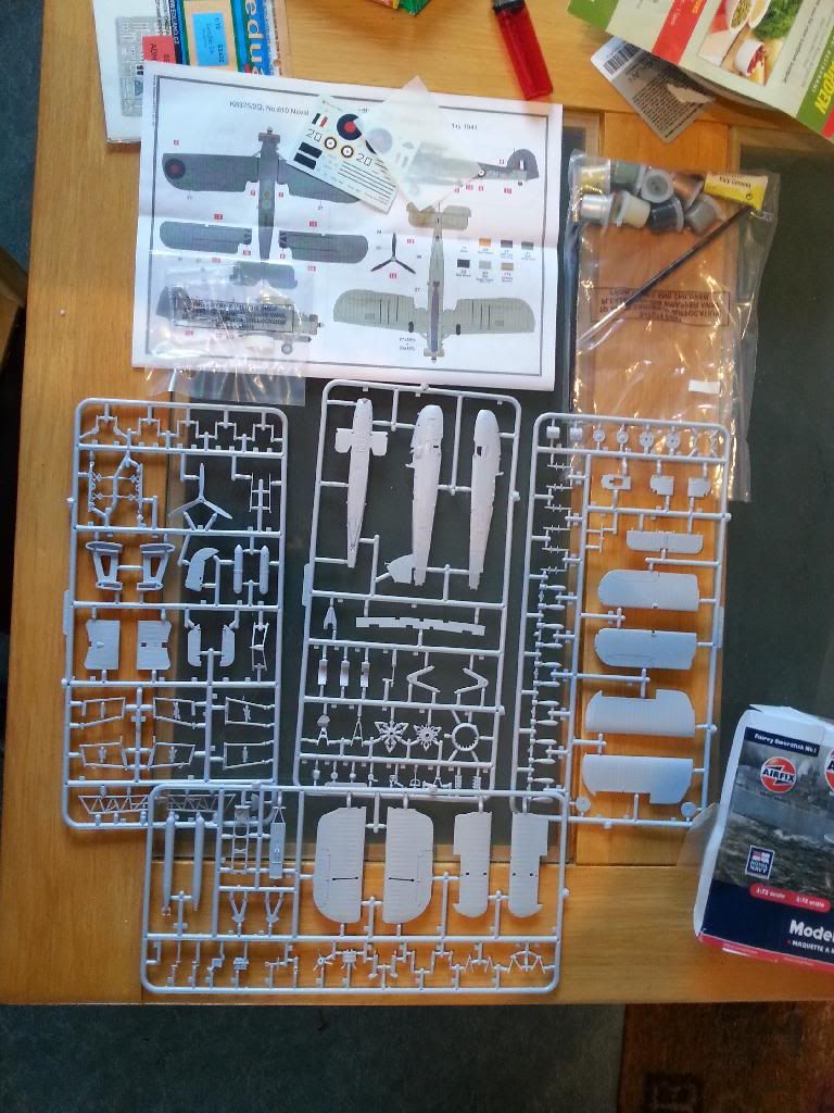

here's what's in the box

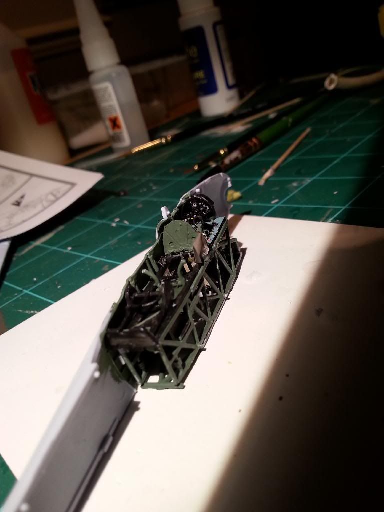

I must say the floor was fairly uninspiring, but I doubt anyone will see it once the kit is complete

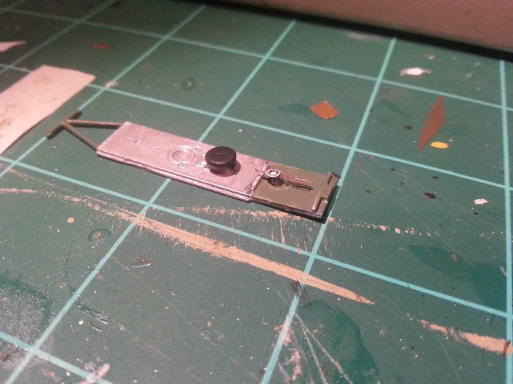

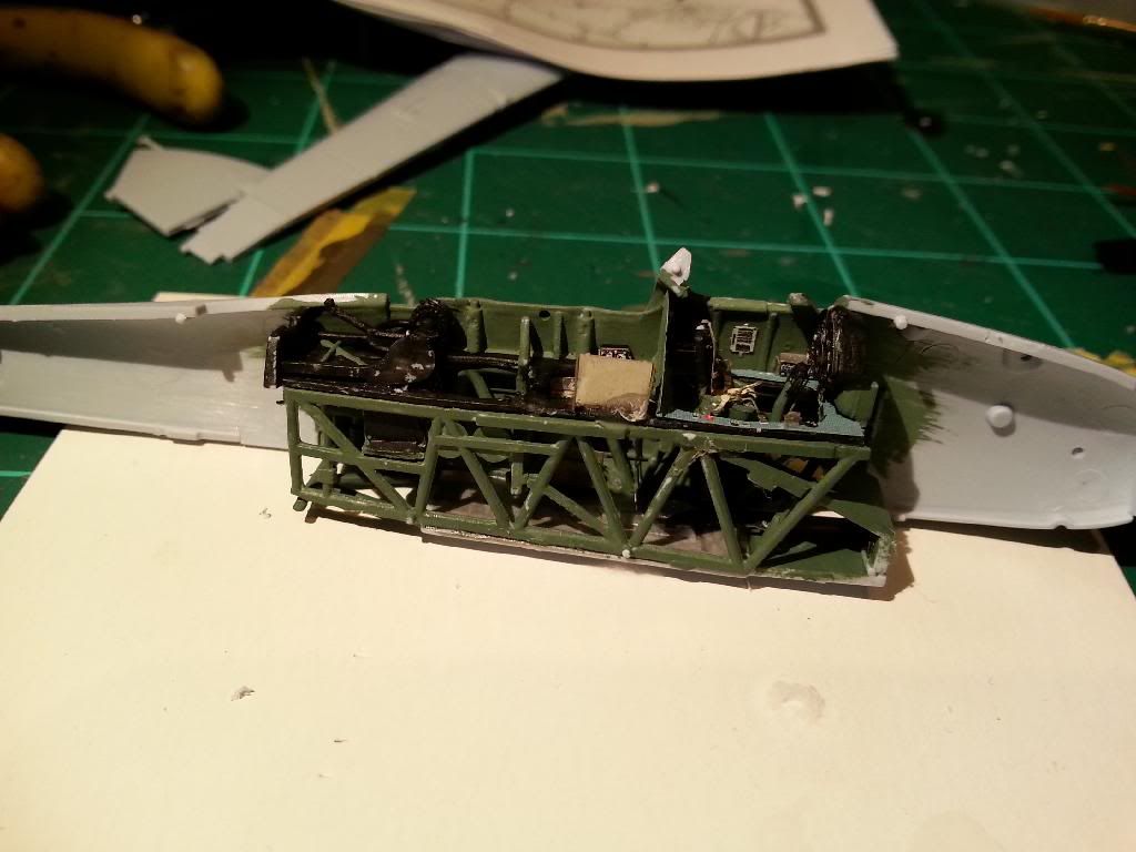

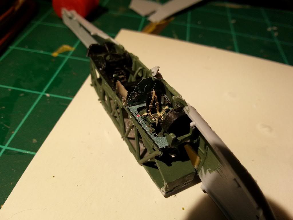

The rest of the cockpit is very time consuming & some of those photo etch parts are microscopic
The machine gun on the starboard side pokes through a hole on the side - when I put this through, it scraped all the paint off - so eventually I painted it once it was through & then positioned it correctly once it was dry. I painted the body under the gun beforehand with a brush. The gun is currently under a small lump of blutack. I have given the body a very fine coating of halfords primer.

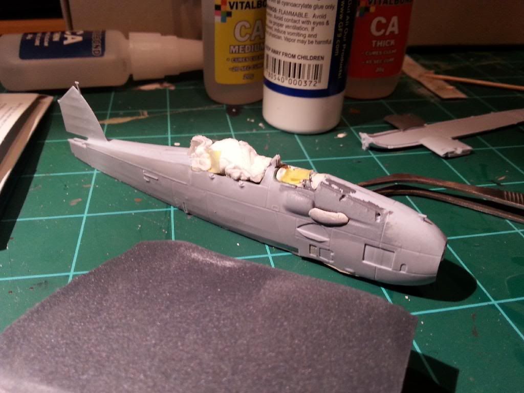

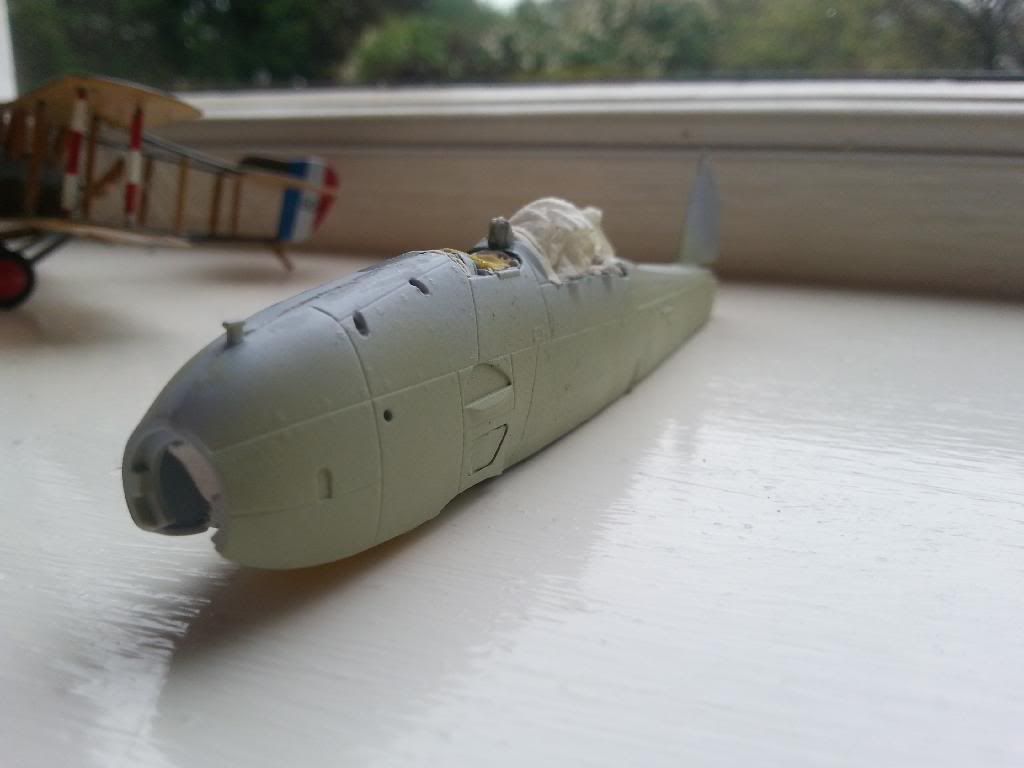

I've decided to paint each section before putting the thing together - here's the first coat on the body. My airbrushes are now totally blocked, so they both need dismantling before I make any more progress.

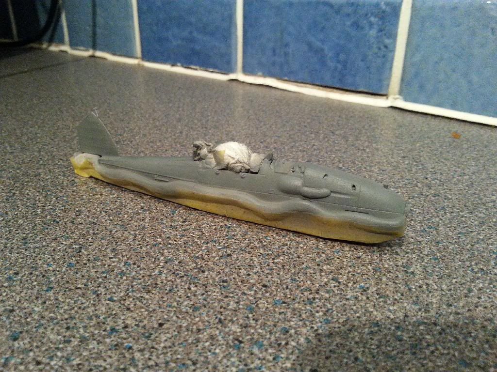

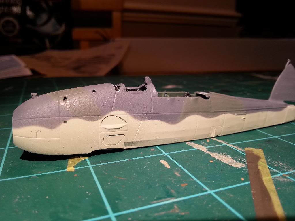

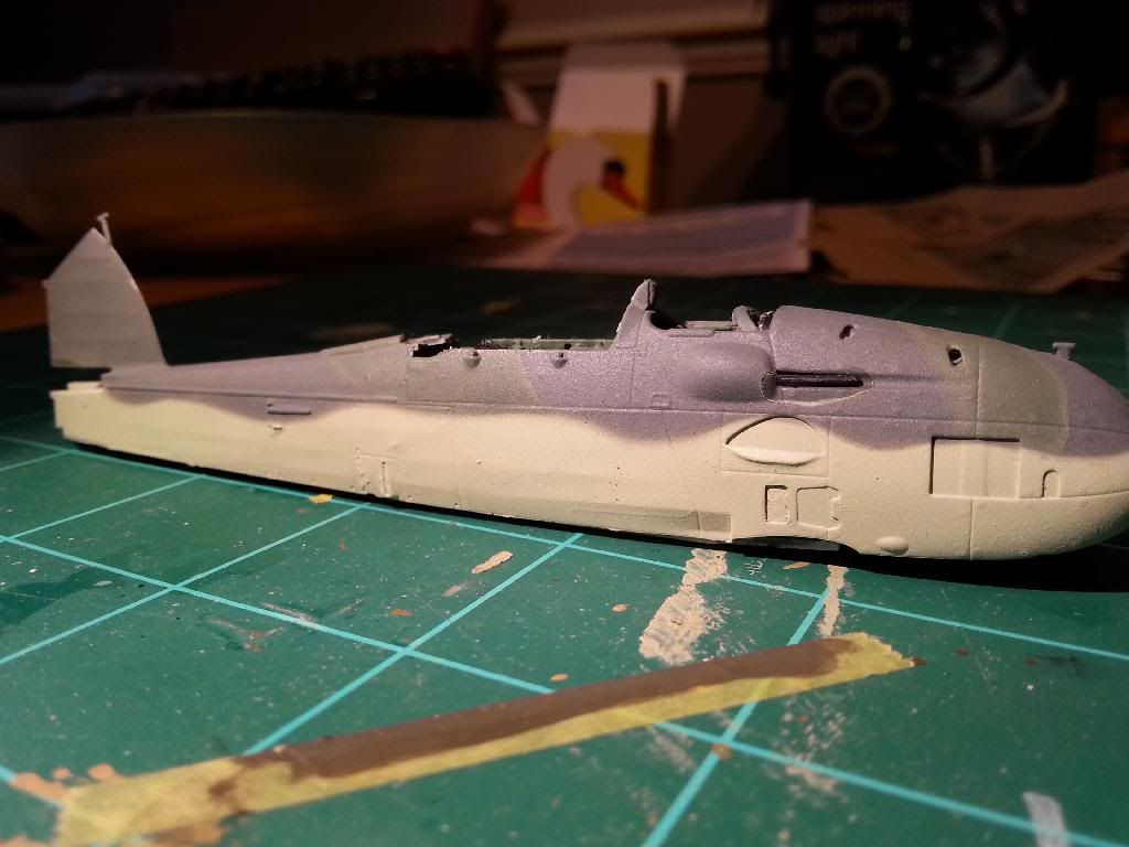

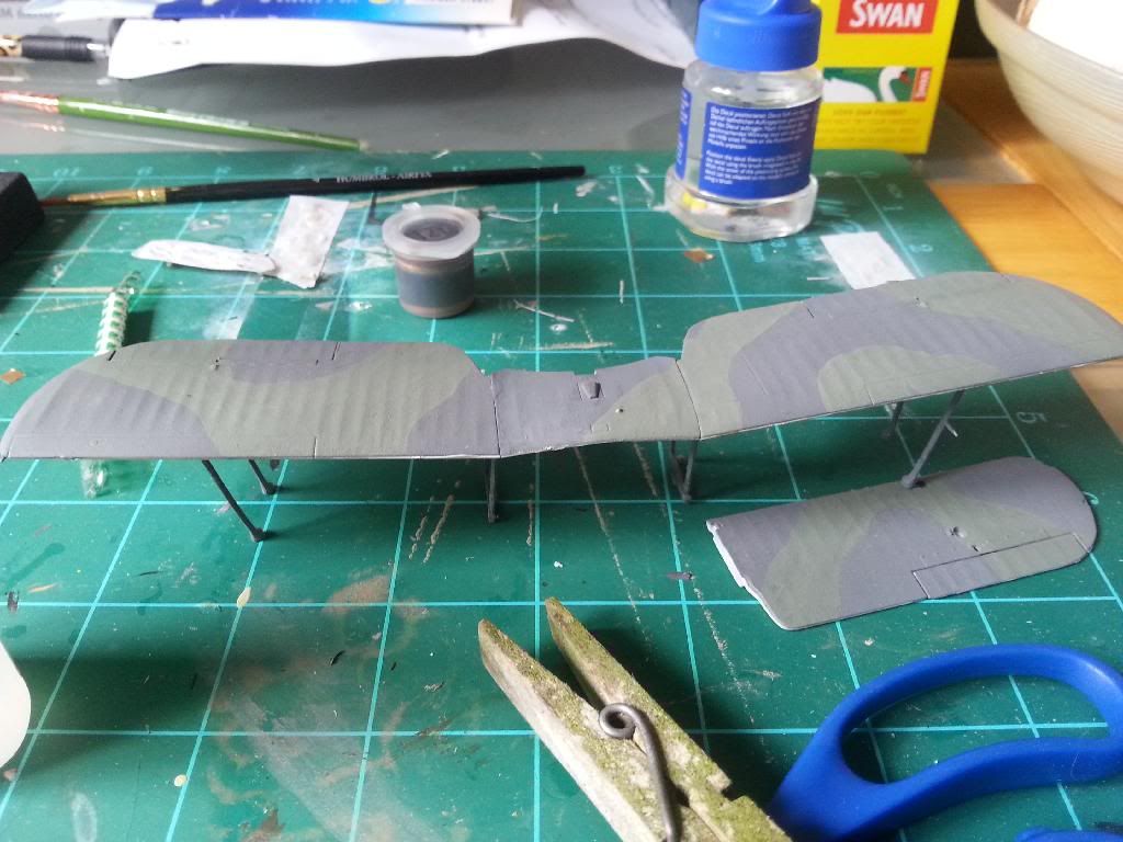

A little bit of progress this afternoon - although I don't really want a fuzzy edge to the paintwork, I certainly don't want raised edges between the colours, so I'm using blu-tac, but spraying into the gap - I hope it works. So here's the dark sea grey (humbrol 27). Hopefully I can get the slate grey on tomorrow evening.
Another couple of hours & then the exciting bit - pulling all the masking off
The contrast between the two colours isn't high, but I will persevere with the paints that came with the kit - and it looks like I may have missed a bit on the middle of the port side.
  • Like 4
You are doing well with this build. Don't worry over much about the lack of contrast between the camouflage colours, there wasn't a great deal in real life.

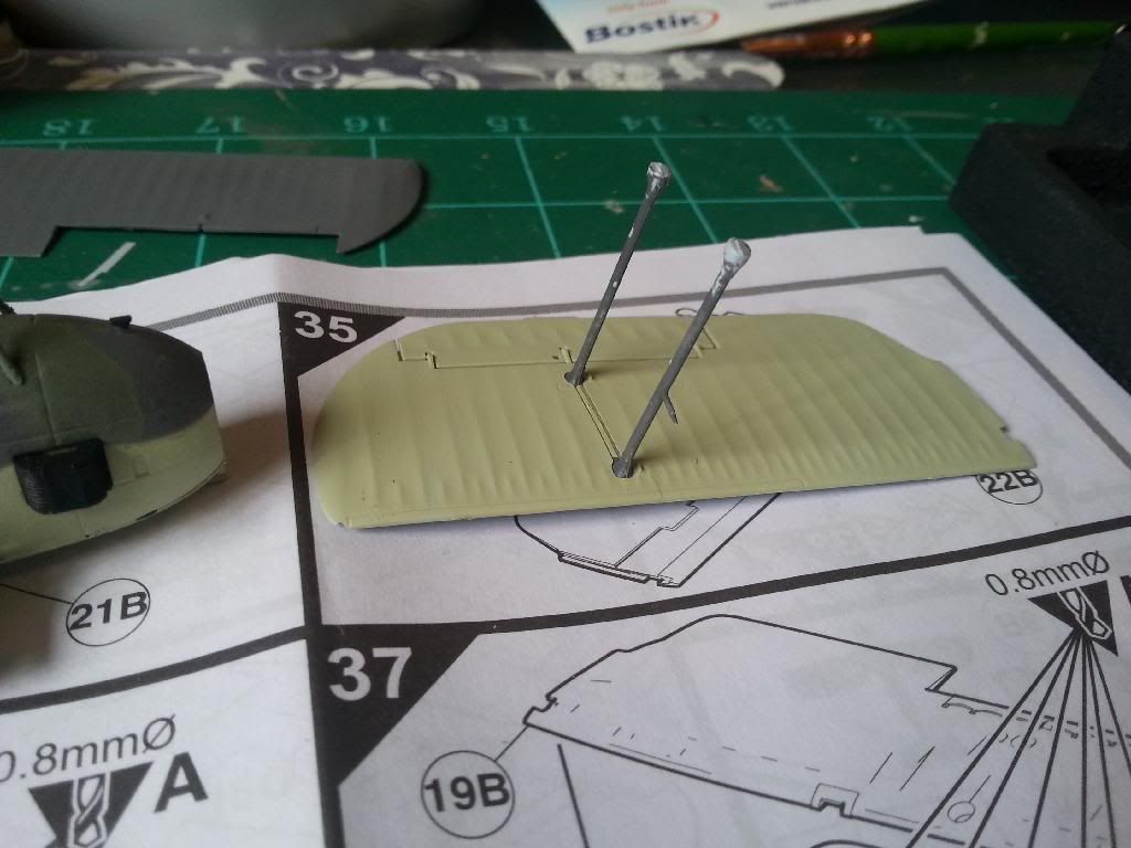

So next up was the wings - The upper wings fit together very cleverly & the way the struts fit in to the upper wing is awesome.

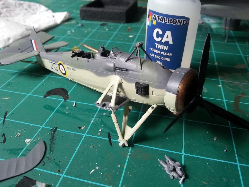

Before fitting the upper wing to the aircraft, the undercarriage was assembled - again, it needs a little figuring out, but goes together very nicely.

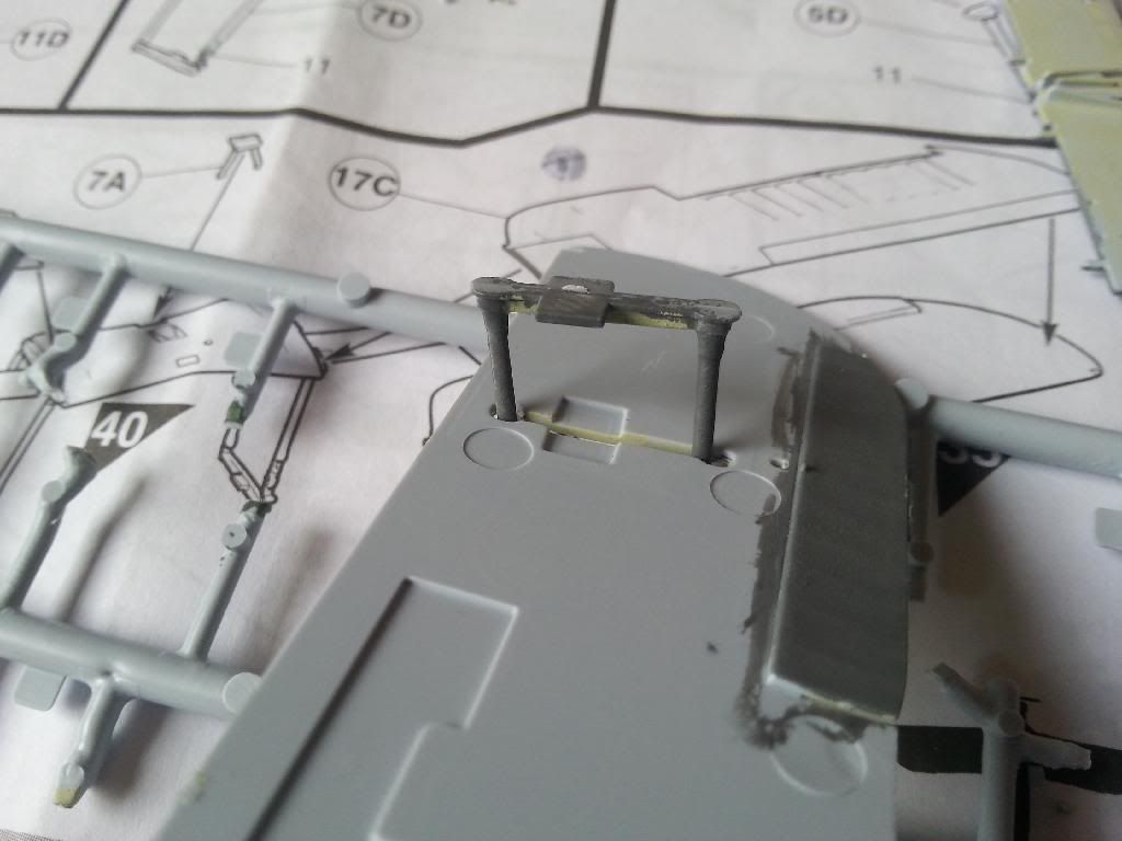

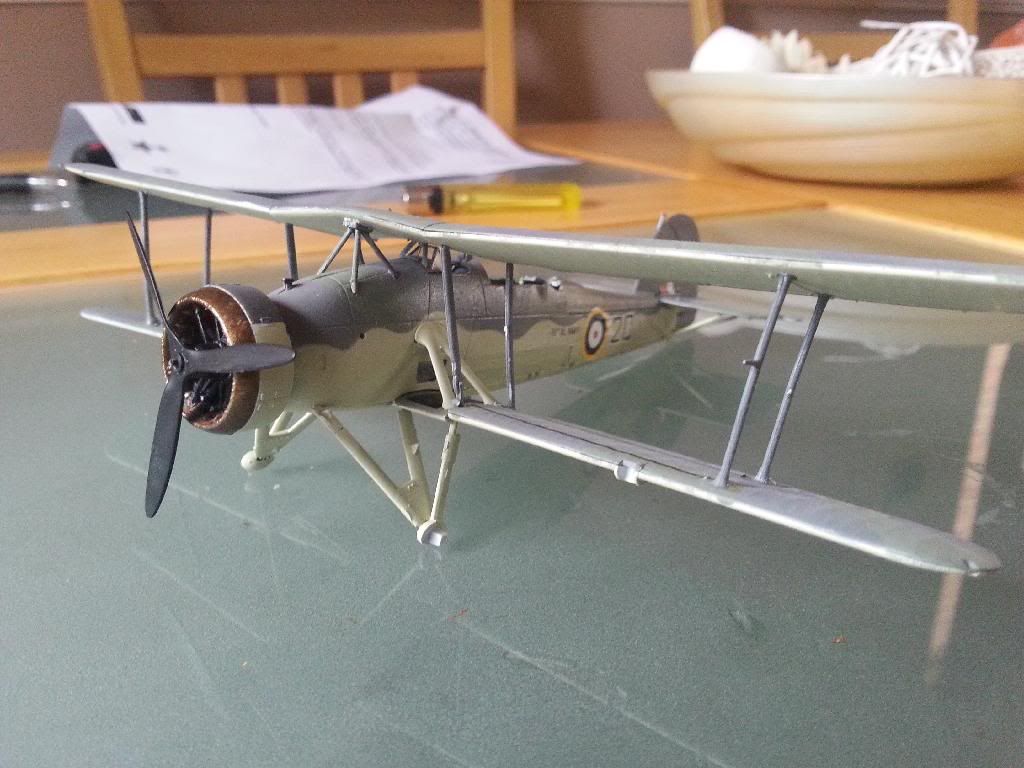

At this point disaster struck - fitting the upper wing was, for me, a nightmare - there is a small notch on the underside of the wing that fits over the supports on the front of the fuselage, the lower parts of the inner wing struts then fir into the little slots that can be seen on the upper side of the wing stubs in the previous picture. I simply couldn't get this to fit - with one wing strut fitted, I had to bend the wing on the opposite side downwards by a couple of millimetres, resulting in the fitted side eventually popping up. After much grief I finally used CA to fit the struts in place - but the fronts of the struts have set a little high, so now the joint between the wing the & the stub doesn't line up.
Lots of tarting up to do before I'm happy with how this looks.
I have been thinking about this one since your last post. I don't know whether you are in a position to remove the top wing and so my thoughts may be of no use. I think the problem might be that the central pylon may be on back to front. This would set the angle of attack of the upper wing at too steep an angle thus throwing your main struts out of true.
Hope that is of some help.
Martin
Martin
The problem was with the pylon - I've just found an extremely good walk-through on the Airfix tribute site. It's fitted the correct way round, but I should have filed it down so that it fitted better into the hole underneath the upper wing. The wings are pretty solid now, so I think I'll persevere with this as it is, I reckon I'll do more damage if I try to remove the wings now. ready for inspection pics will have to be from clever angles. The wings themselves are aligned with each other - both upper & lower have a slightly higher angle of attack than they should have. It's a lesson learned & one day I'll build another one. At least this will give me some good practice with the rigging.

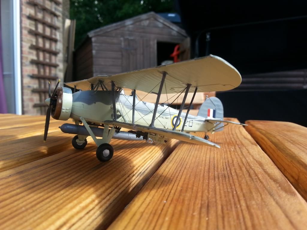

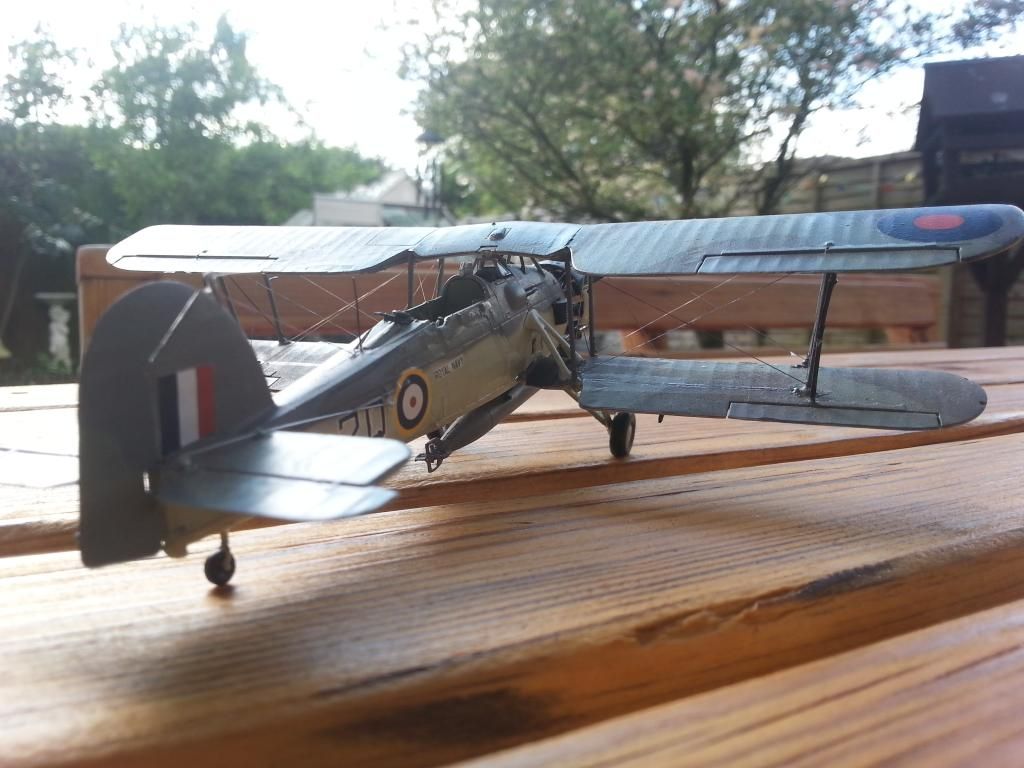

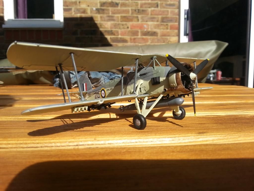

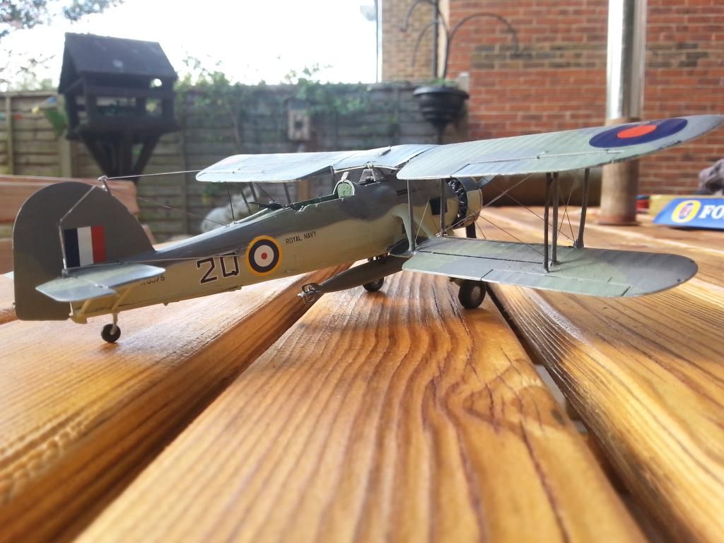

well it's been a while & it's almost finished - I doubt that I'll do any more actually, I've run out of steam with this one. The rigging is mostly ez-line, a few of the lines are also done using stretched sprue. This is the first time I've tried stretched sprue & I must say it is actually easier than ez-line & a hell of a lot more satisfying.
