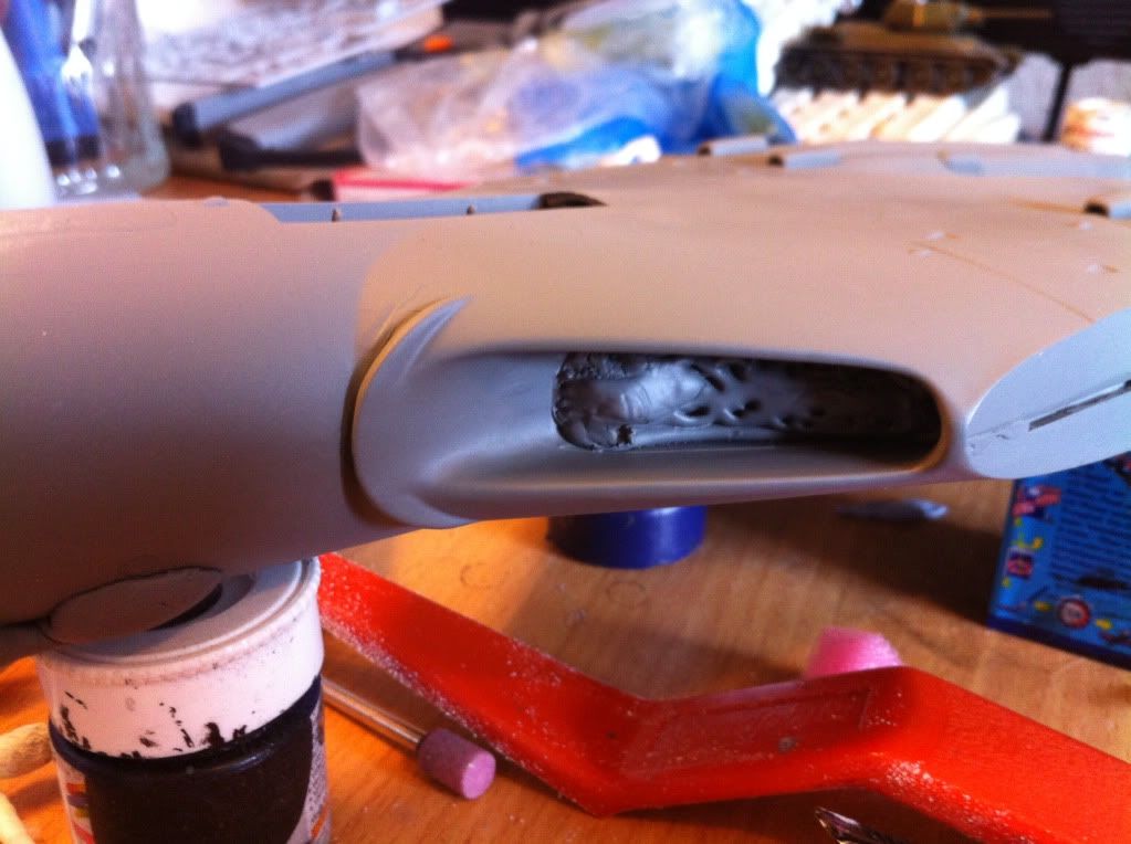

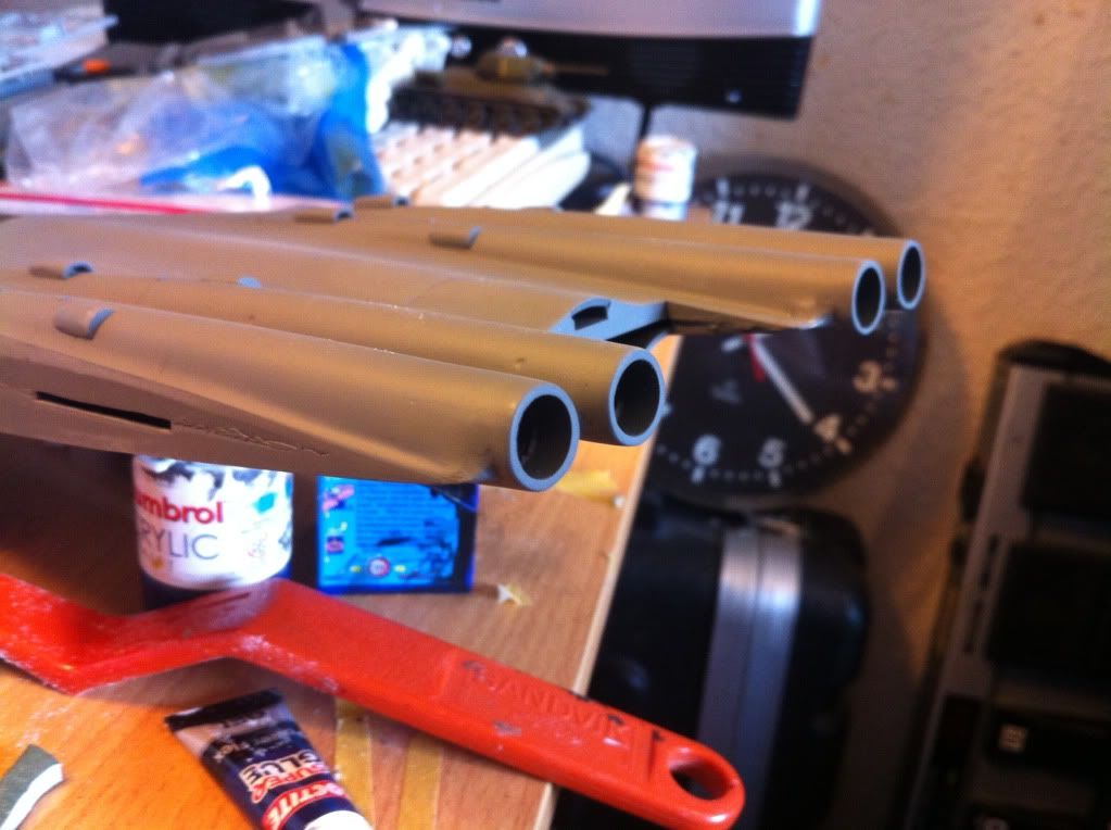

Cookenbacher Posted April 1, 2014 Share Posted April 1, 2014 That's some excellent putty work on the exhausts! 1 Link to comment Share on other sites More sharing options...
robvulcan Posted April 1, 2014 Author Share Posted April 1, 2014 That's some excellent putty work on the exhausts! About 18 Hours work in total... But worth It. Cheers Rob 1 Link to comment Share on other sites More sharing options...

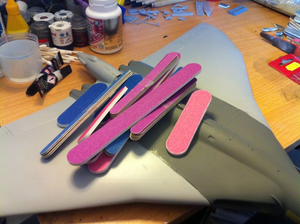

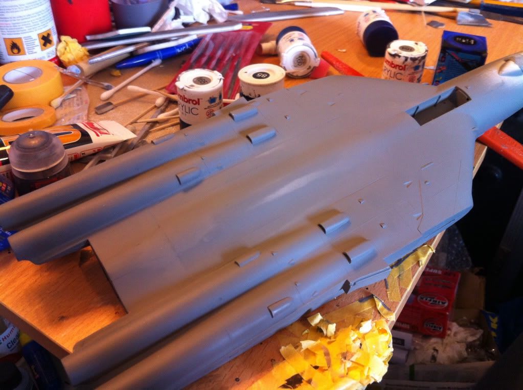

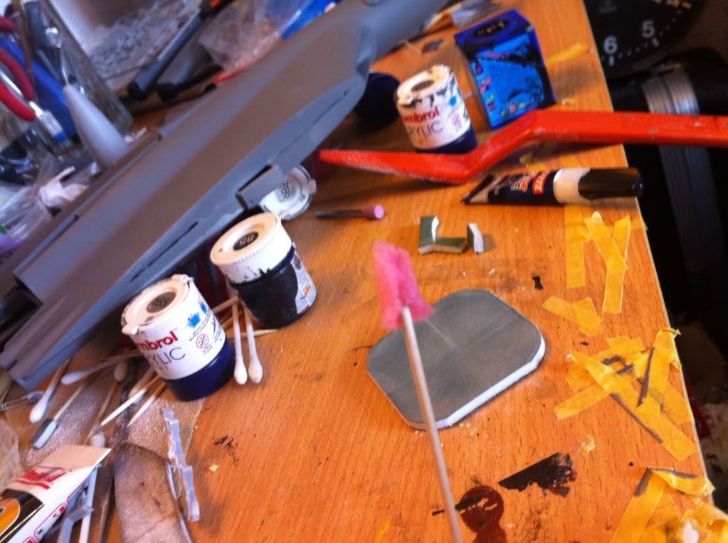

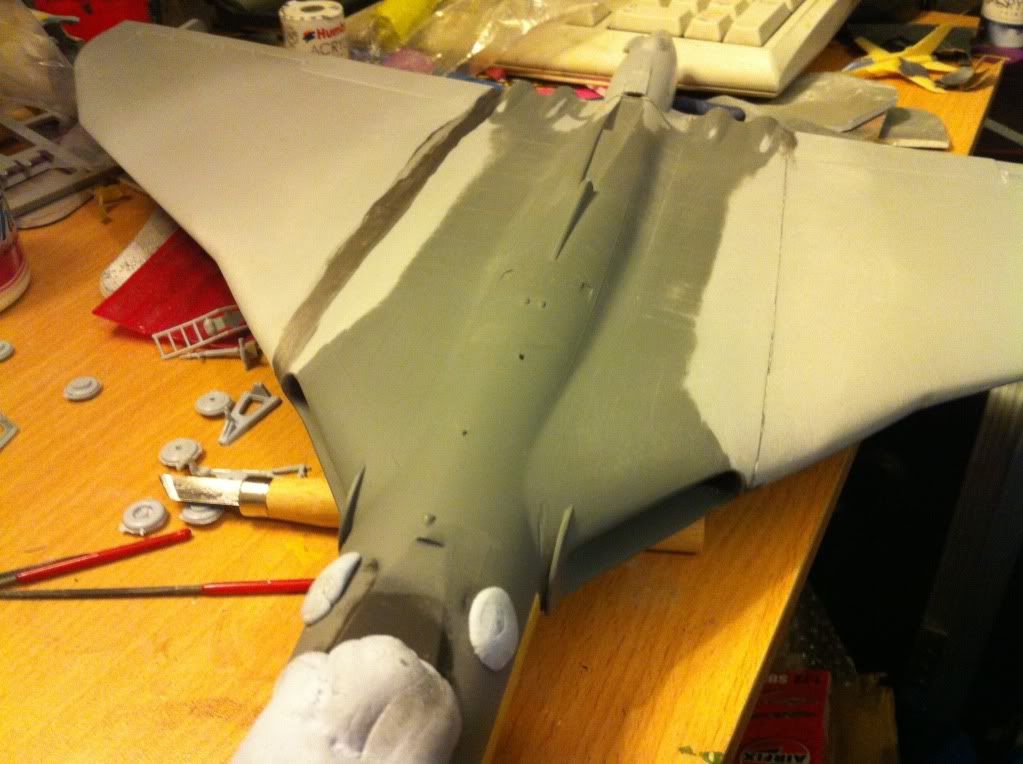

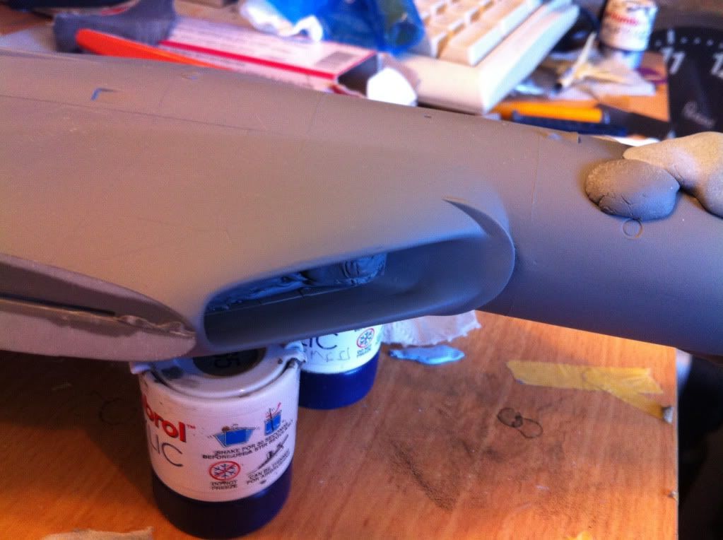

robvulcan Posted April 1, 2014 Author Share Posted April 1, 2014 At last I think I have pretty much won the battle with the intakes and exhausts. Sure a blemish here and there if you look really hard I suppose they could be better. But I think I am safe to move on to the wings et al. and may be give them one work over with The micro mesh lollipops I made. In the end a circular stone piece twisted with the finger sped up the job. A suggestion from my mate Steve who used to be a stone carver. He said the pads were simply replicating the problem. He was right. photos soon Link to comment Share on other sites More sharing options...

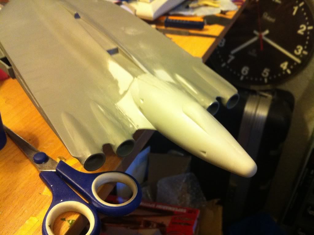

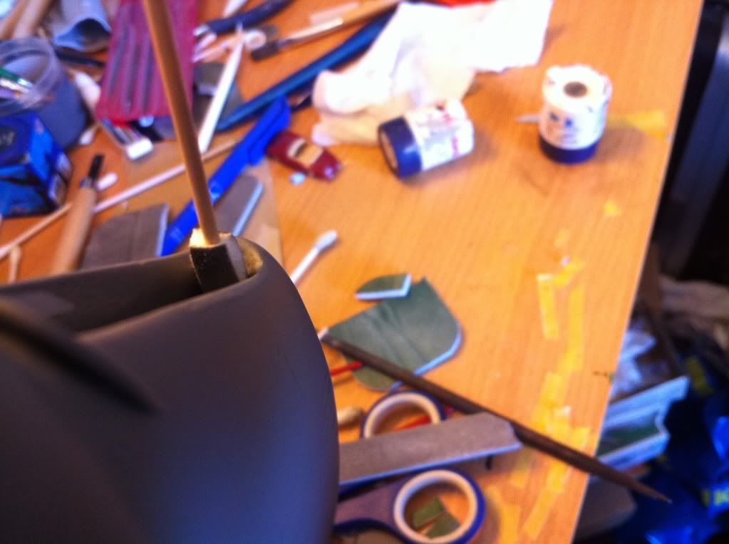

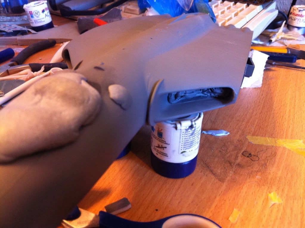

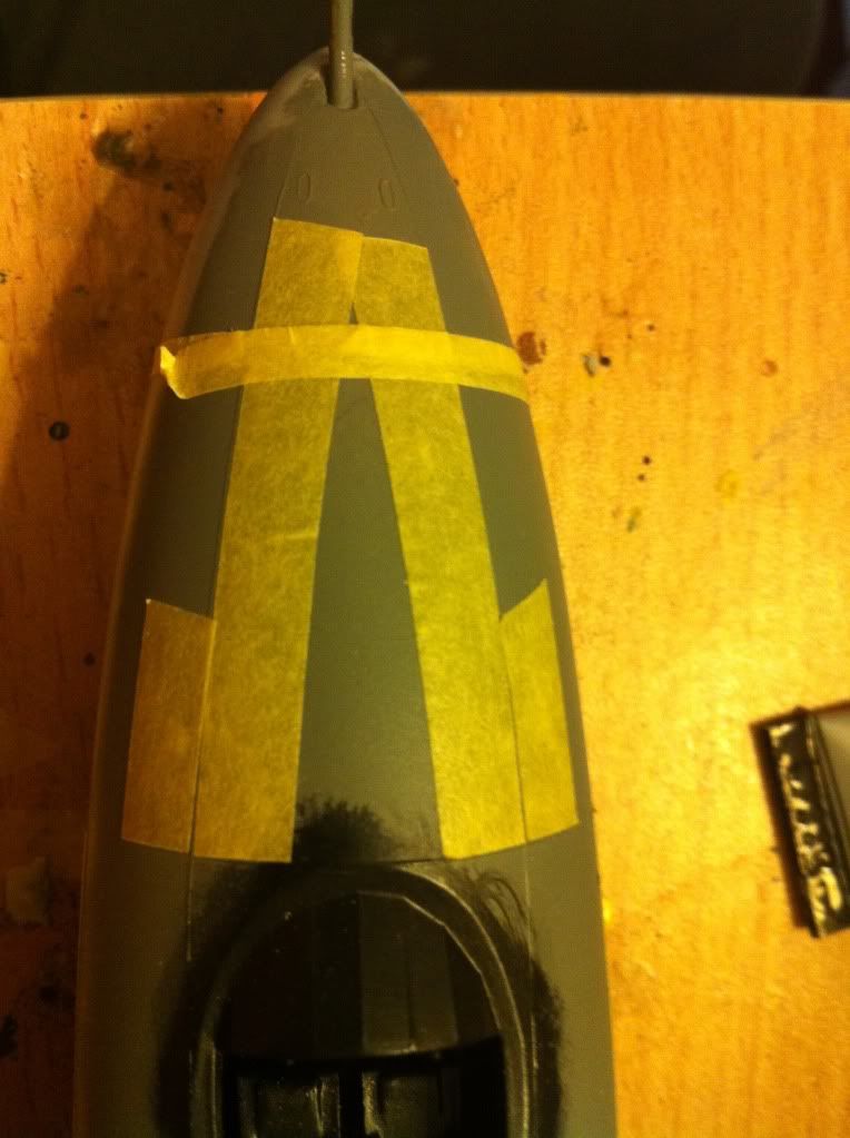

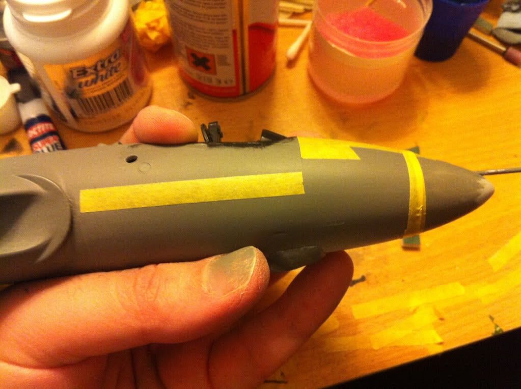

robvulcan Posted April 1, 2014 Author Share Posted April 1, 2014 Ok , A quick update from a now worried modeller. This is like Countdown.... I have modded the tail cone back to the original ECM shape, Actually its the second variant of the 3, It lacks the 2 underneath fittings and has the smaller but elongated tip. All I did was sand the kit item back to profile the tail cone shape after removing the two fittings, reduced the tip curve to the right shape. No measuring here just sighting it up. Then polished with Micro-mesh. The Tiddler has its ECM plates complete and the inner of the exhausts blacked out. The intakes.... Well they look better than this now but Whatever I do there is little imperfections that look worse here than in person. I have sanded them back some more. but I am happy with them. Since the paint has leveled off a bit they look a bit better now. My excuse (real ones have panel beating if you look ,,,,,eh hem ) The exhausts I am pretty happy with since I have to entirely scratch build them in the end. And a bonus is they look more like 301s than the Odd kit flared out ones..... (Flares.... well this kit was made in the 70s.. whats not to like !) Ah the belly of the beast........... Again nothing fits properly..... sand sand sand sand sand..... Super glue gel for gap filling is ace.,,,, more sanding,,,,,( I am knackerd gimme the beer,...... ) I made this to do the Klear inside the intakes of the Little tiddlers air intakes. Bit of fresh sponge super-glued to a cocktail stick. Blending blending and more blending..... On goes the tail cone. The tiddler has had a few wipes over with Klear again with a sponge. Tonight at work I can tackle those pesky windows with some matt black heavily thinned with Flow Improver. with a piece of guitar string set in blue tak. and A fine piece of sprue set in blue tak. Then more klear, decals, Varnish, Stand Bomb blue tak'd in and done.. The masks are merely "sights" for me to try and get the radome line in the right/ "or close as too" place for scribing. .....................But will I finish the big bird.... .......... Cheers guys. Rob 2 Link to comment Share on other sites More sharing options...

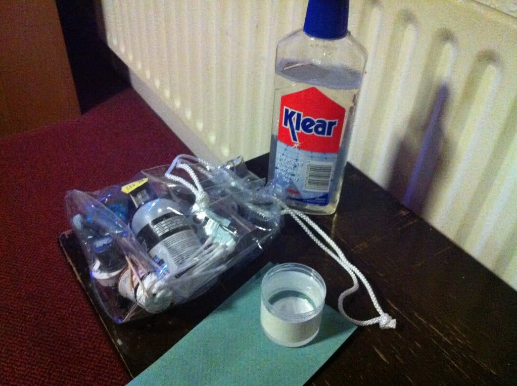

brianthemodeller Posted April 1, 2014 Share Posted April 1, 2014 Keep going Rob! Having just built two of the Airfix beasts I understand your pain - I have never used so much filler on a kit before. And there's a lot of plane to sand. The cleaner in the Premier Inn where I was staying must gave wondered what I had been up to with all the fine white powder on the desk... 3 Link to comment Share on other sites More sharing options...

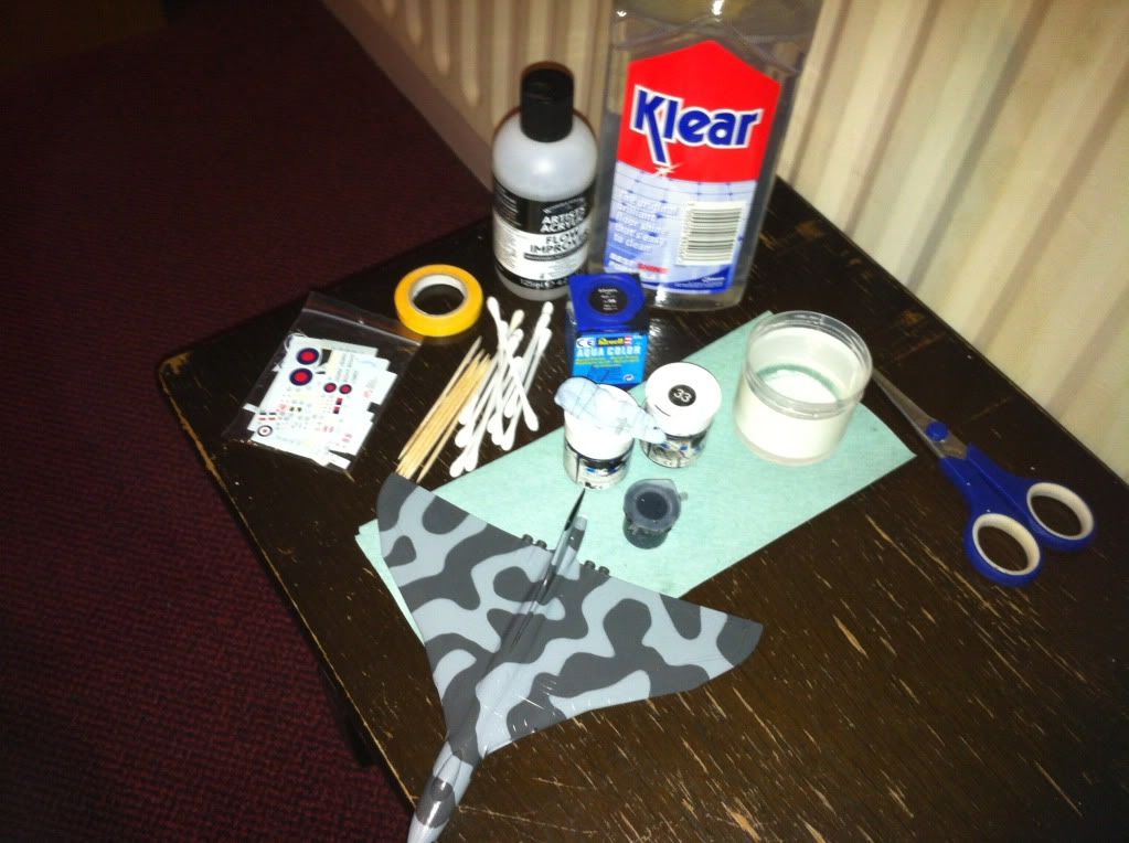

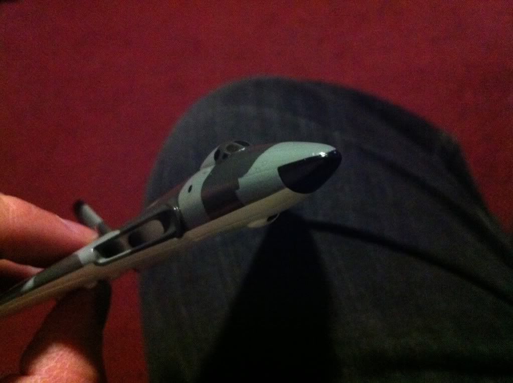

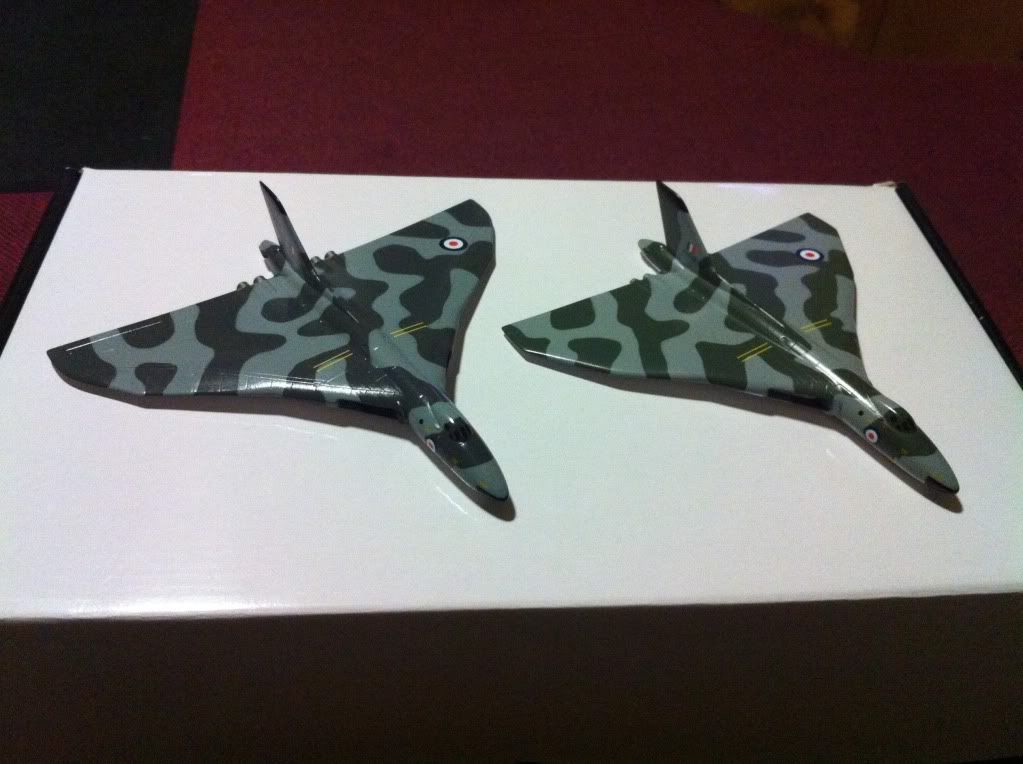

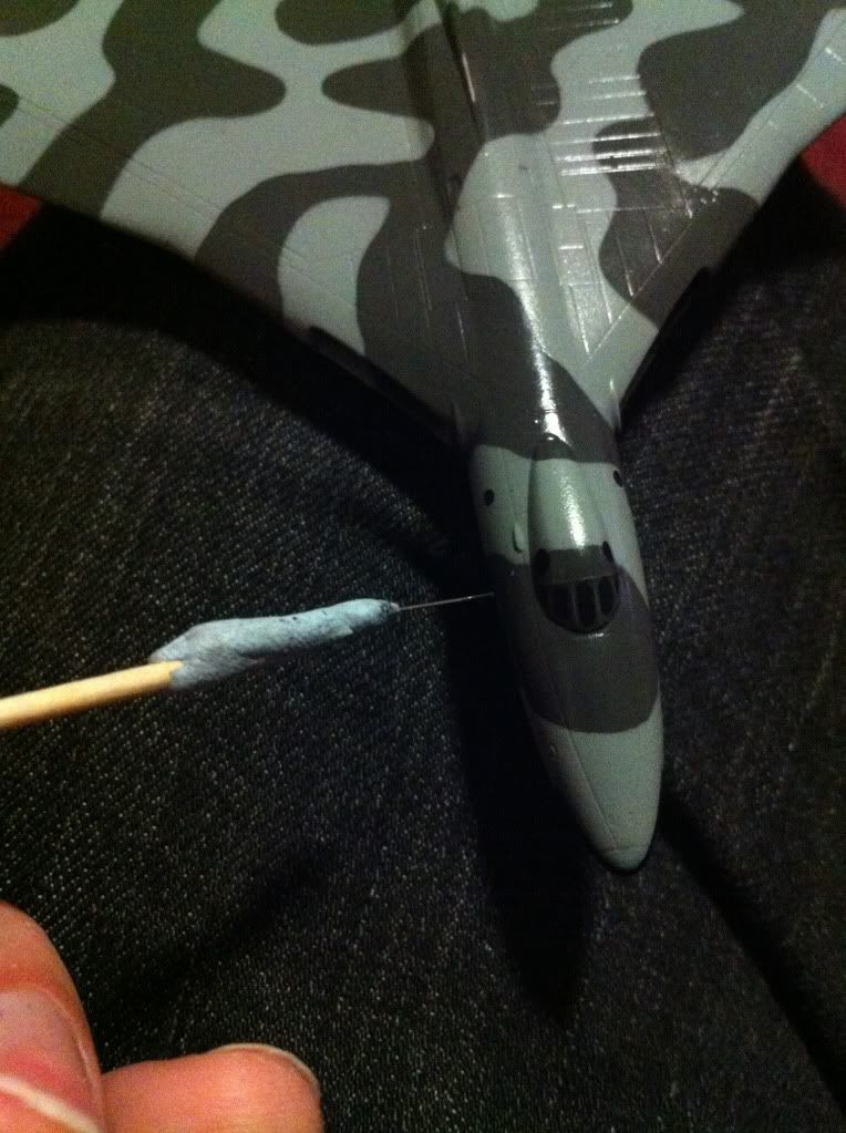

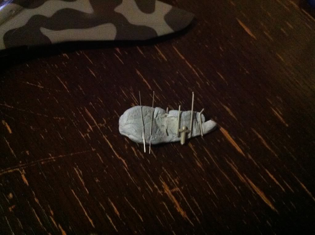

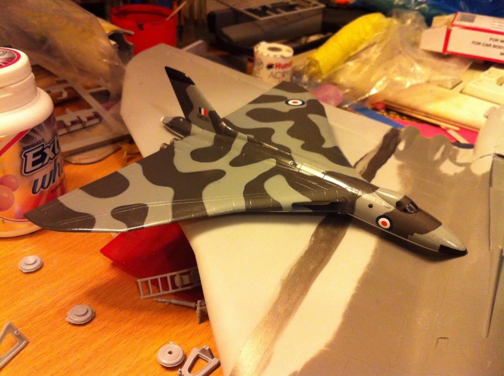

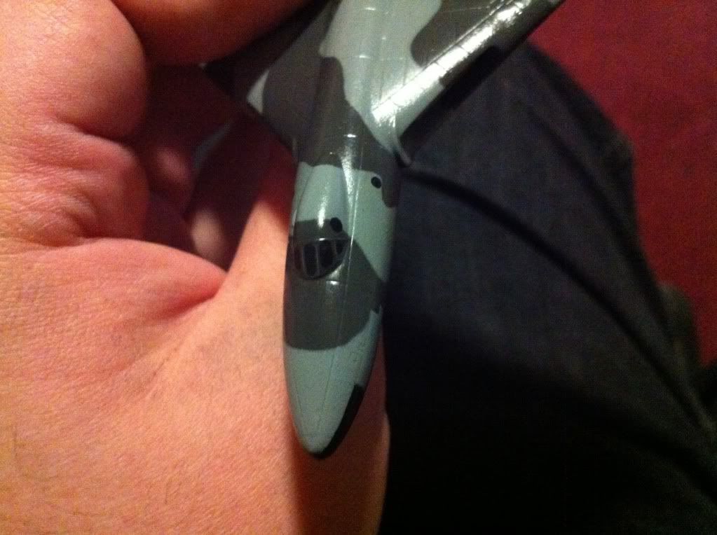

robvulcan Posted April 2, 2014 Author Share Posted April 2, 2014 (edited) Wah hey !! The tiddler is nearly there just need stencils and final varnish, and it bomb of course. But here she is I sorted her windows with guitar string Here she is with the B1a XH498 for my first model show at cosford last year. They make a nice pair little n large Cheers Rob Edited April 2, 2014 by robvulcan 3 Link to comment Share on other sites More sharing options...

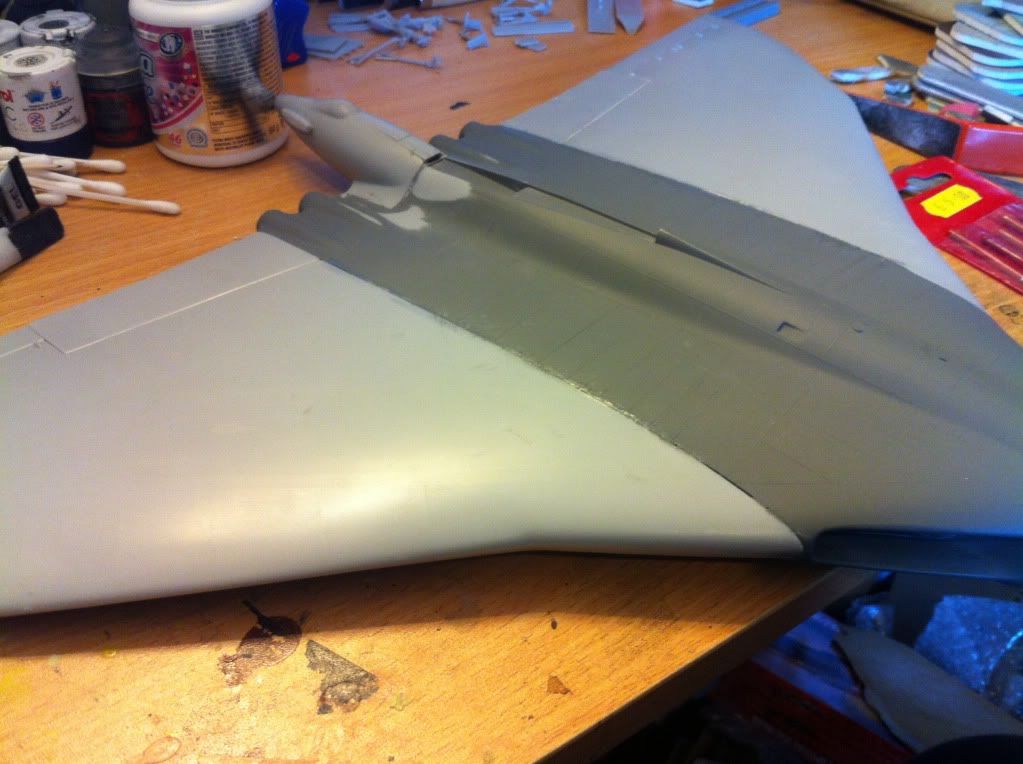

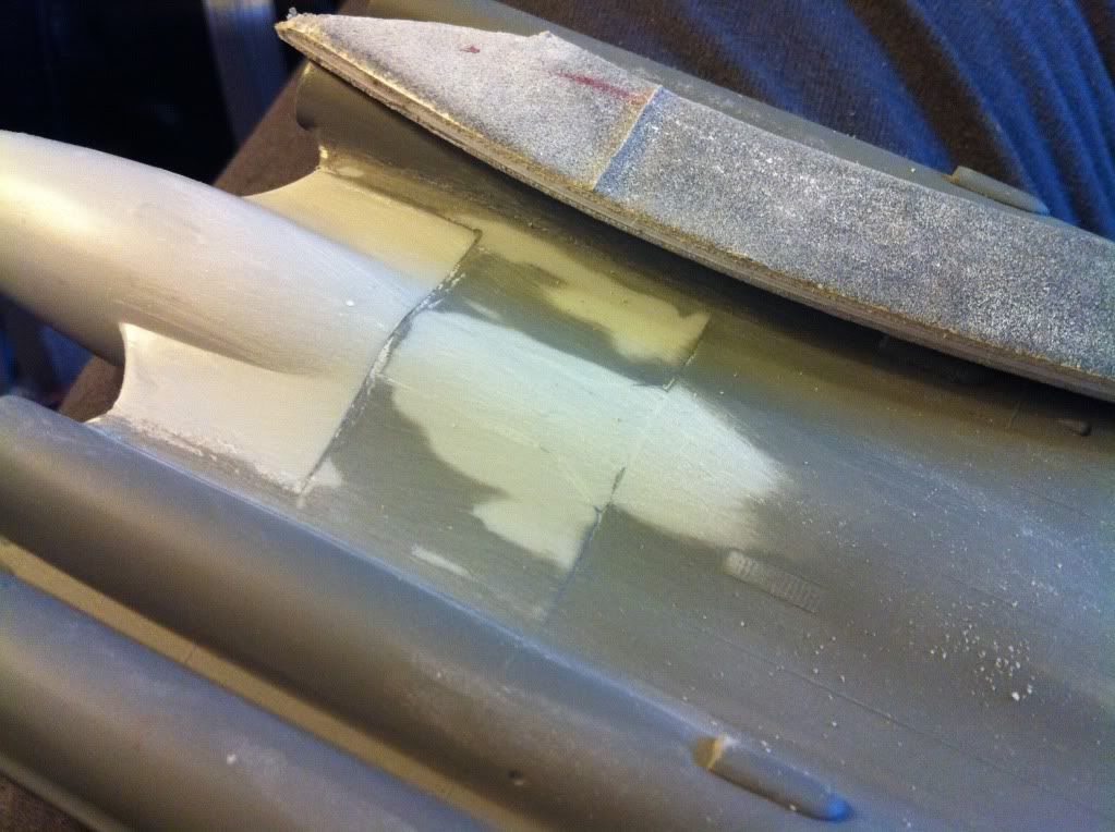

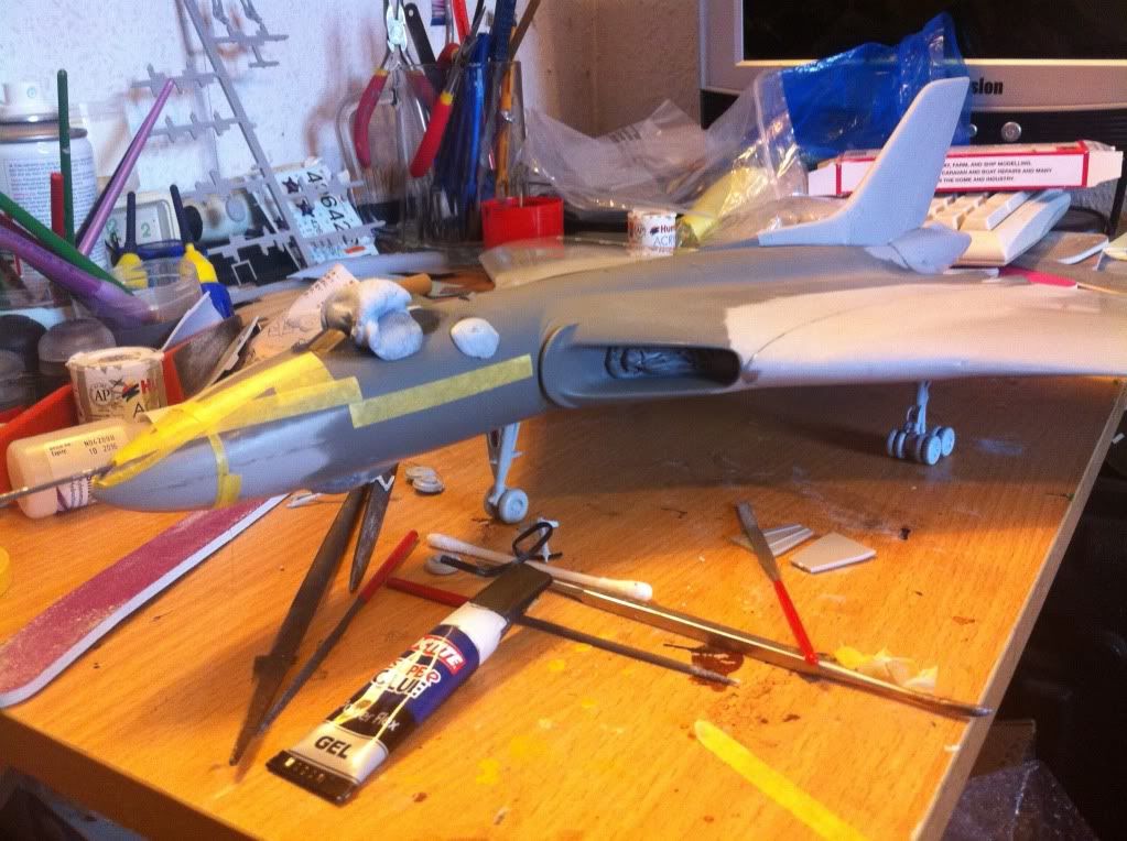

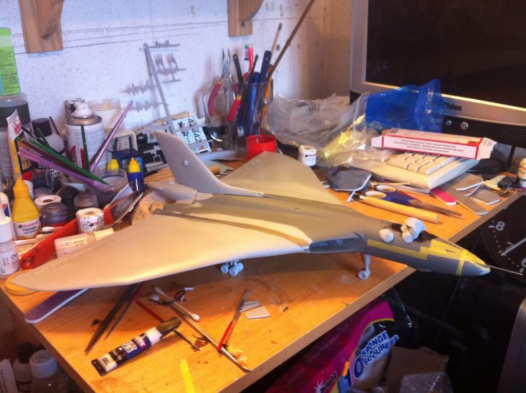

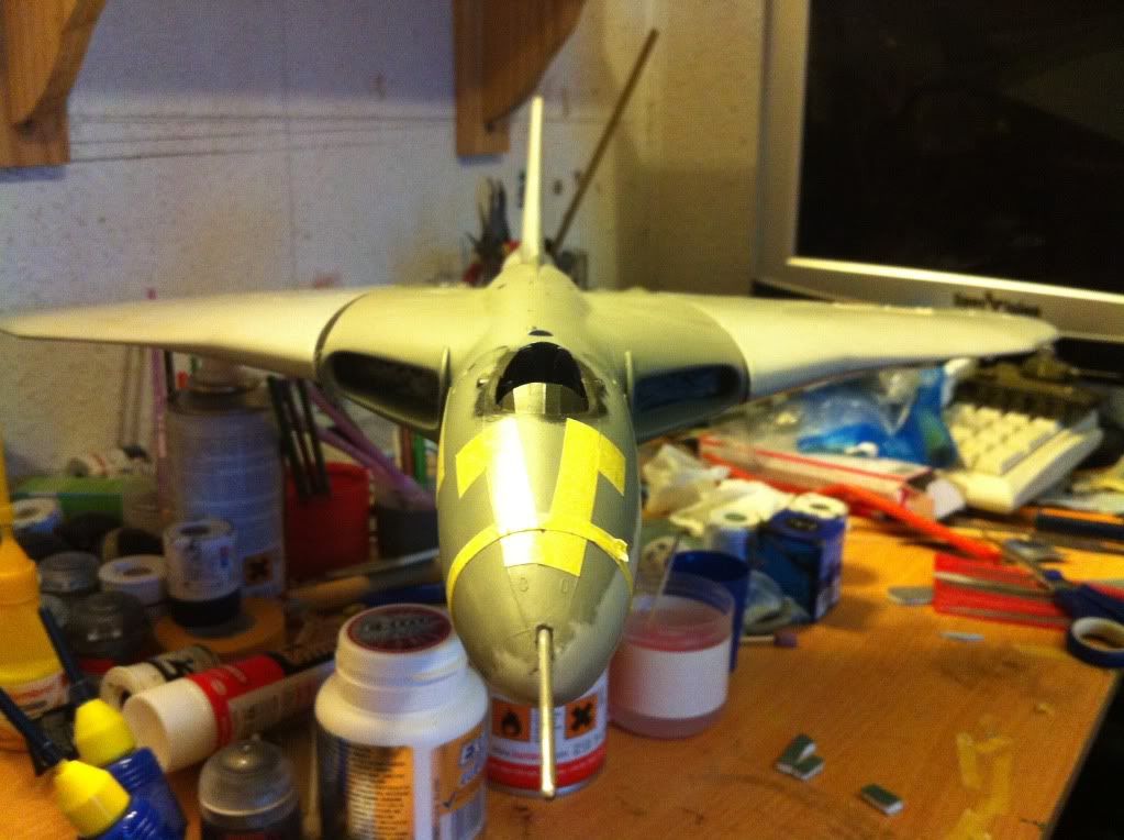

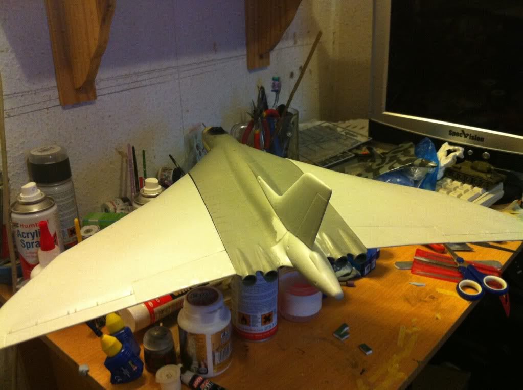

robvulcan Posted April 2, 2014 Author Share Posted April 2, 2014 Well I am optimistic this morning. But there is still a long road ahead.... whats that song... "The Long and Sanding Road........................." Great track that.. Well the wings are on. solid too and Its looking like a Vulcan. But with having to do my best to get the anhedral correct. The one wheel looks like its doing a 8 pint shuffle to the left. So I will have to devise a way to set them at the same angle and then hope that it sits right and don't look like one that's had a heavy landing... Like this poor one here. I started the day with a quick tidy.. It was looking a little like hell after yesterday. Here is the fight for the next few hours... Thanks to my mum who has supplied me with an arsenal of nail files... Though I think I might need to take a belt sander to this one.. Cheers Rob 1 Link to comment Share on other sites More sharing options...

robvulcan Posted April 2, 2014 Author Share Posted April 2, 2014 Perfect Putty Rob, it's just the ticket. No sleep 'til Hammersmith eh....well take it easy mate, tis only a model ! Only a model yes. However I have just realise I have less hours at work this week which ain't good but it is in a sense I have more time to model. This Vulcan Is putting a smile on my face now as I sand the wings into submission. I have found circular sanding helps irradiate seams easier. Just tried the Undercarriage loose and she site ok too which made me very happy. I am using some guitar string for the steering column. As regards smaller details. I am not sure weather to : 1. Leave off til last min and tak on with PVA so If they get knocked they won't hurt the paint. 2. Glue em on and risk it when Painting. 3. Omit them all together. Cheers Rob Link to comment Share on other sites More sharing options...
general melchett Posted April 2, 2014 Share Posted April 2, 2014 circular sanding irradiate seams easier. Blimey you're taking this nuclear role a bit seriously !! I tend to leave the detail stuff off until after painting and then fit with Gator glue (PVA), certainly wouldn't risk them before hand.....if that helps... 1 Link to comment Share on other sites More sharing options...
robvulcan Posted April 2, 2014 Author Share Posted April 2, 2014 (edited) Blimey you're taking this nuclear role a bit seriously !! I tend to leave the detail stuff off until after painting and then fit with Gator glue (PVA), certainly wouldn't risk them before hand.....if that helps... Aye I think that's the route I will tread. I am sorry for all the apparently "stupid" questions, I can figure it out myself but I always like to ask how others go about such things as sometimes you find new and better ways.Cheers General Well I have been working hard on the wings sanding and filling the 1.5mm gaps with super glue gel and sanding it back. I have done this 3 times on the top. The bottom is not much better I have not done much here but I have had no option but to loose some of the sky bolt panel this wing is that crooked I had a choice , gap or detail. But she is getting there I started to turn my attention to the wheels, here I have used a piece of guitar string for the nose wheel steering column. I have some spares so I have picked the best parts of what I had. Here is the assembled nose wheel glued with super glue gel I can't believe how robust this now seems wow,,,, You can see the guitar string in the v section The tiddler is nearly done and I am about to finish its stencils off. Just needs the final coat the bomb painting and a stand, I might just borrow a corgi one. Cheers Rob Edited April 2, 2014 by robvulcan 3 Link to comment Share on other sites More sharing options...

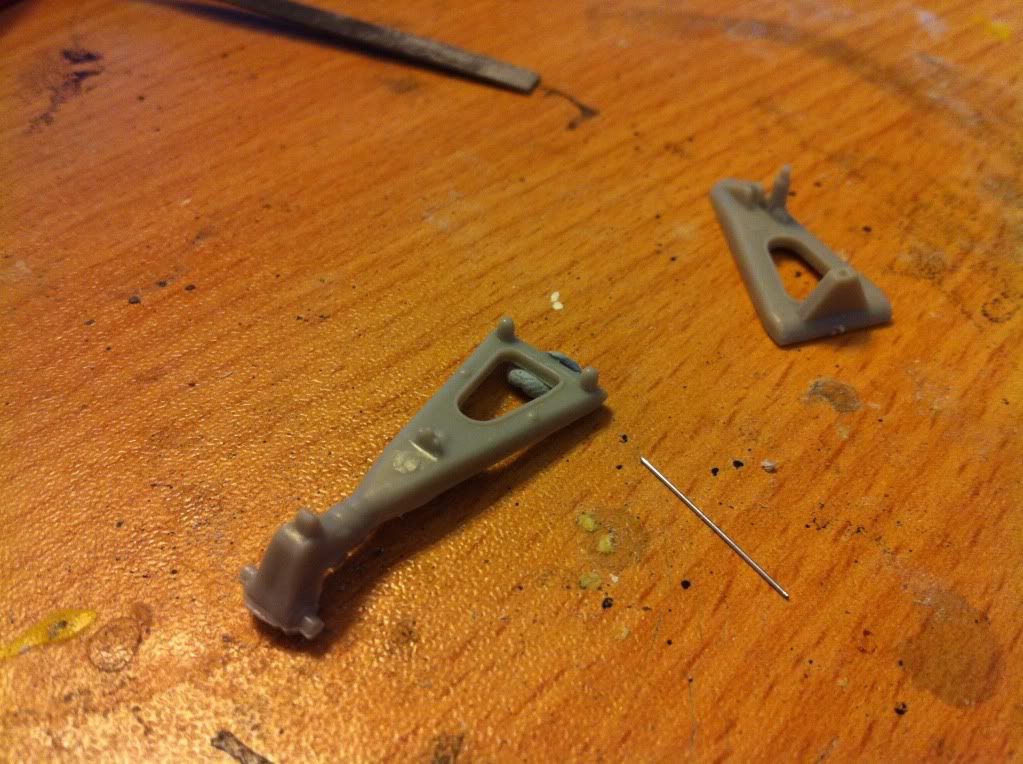

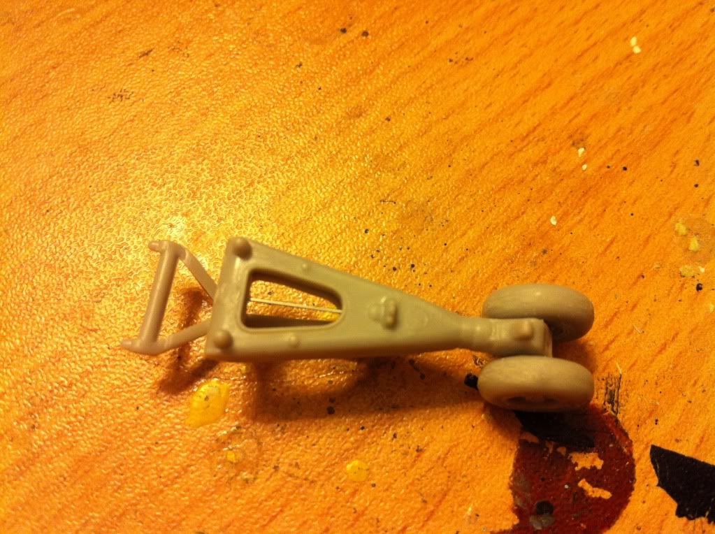

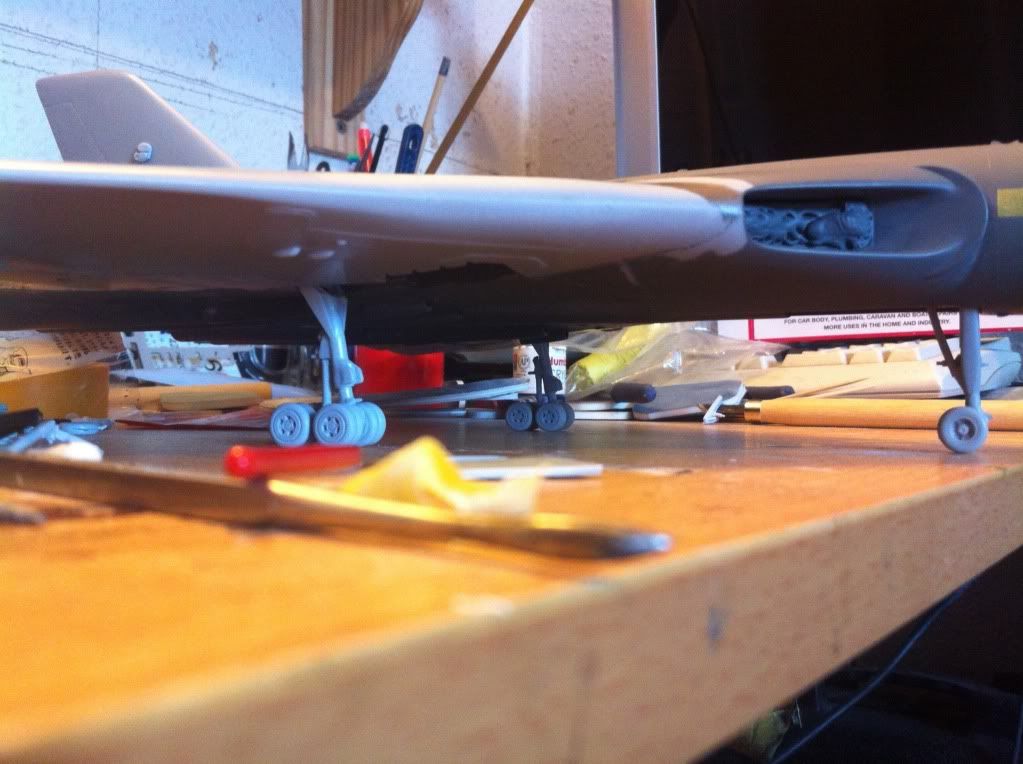

robvulcan Posted April 3, 2014 Author Share Posted April 3, 2014 Well Its update time. I need some help... I have made the Undercarriage up with exception to one part that seems far too long... Am I doing something wrong... The undercarriage is loosely fitted without the Forward struts on the rear legs. I am surprised how tough they are The Problem I have is this.... Here is the part fitted as it should. Which results in this...... So please help me were am I going wrong. My thoughts are it needs shortening a lot ! .. Cheers Rob t Link to comment Share on other sites More sharing options...
nimrod54 Posted April 3, 2014 Share Posted April 3, 2014 Rob, If you have a look at the Walkaround section on here there are some good views of the undercarriage arrangement that may help you. From a quick look you may be right about needing to shorten that forward strut. Link to comment Share on other sites More sharing options...
robvulcan Posted April 3, 2014 Author Share Posted April 3, 2014 Rob, If you have a look at the Walkaround section on here there are some good views of the undercarriage arrangement that may help you. From a quick look you may be right about needing to shorten that forward strut. Thanks. Well I will have an experimental chop up of a spare I have when I get back. I think she is getting there now. I just Hope we have some good weather for painting the next few days. Getting very excited about this now. Cheers Rob Link to comment Share on other sites More sharing options...
