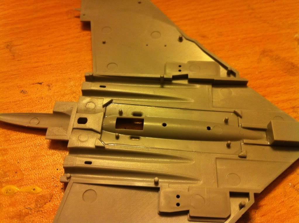

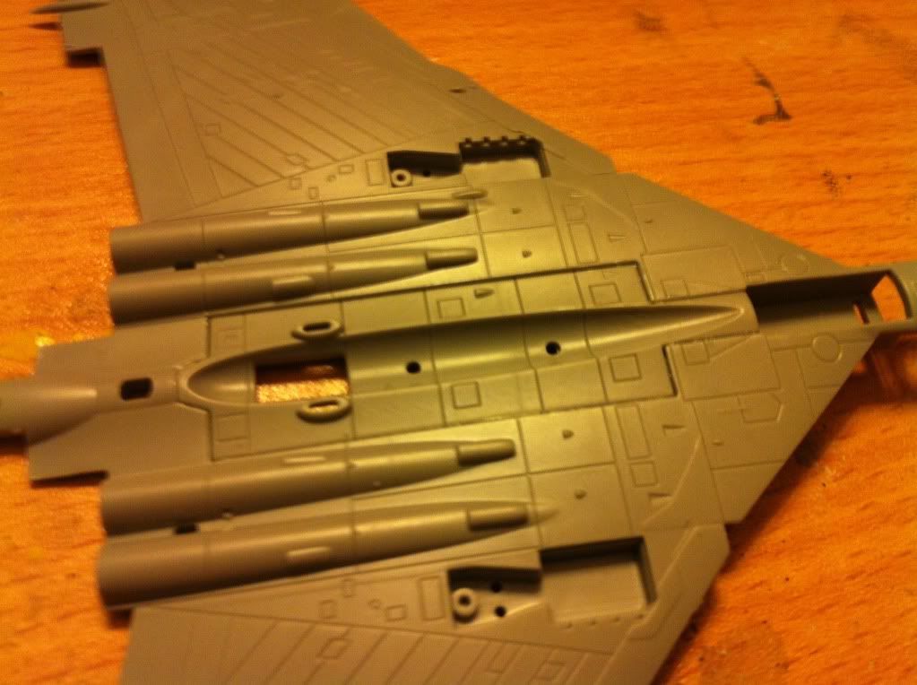

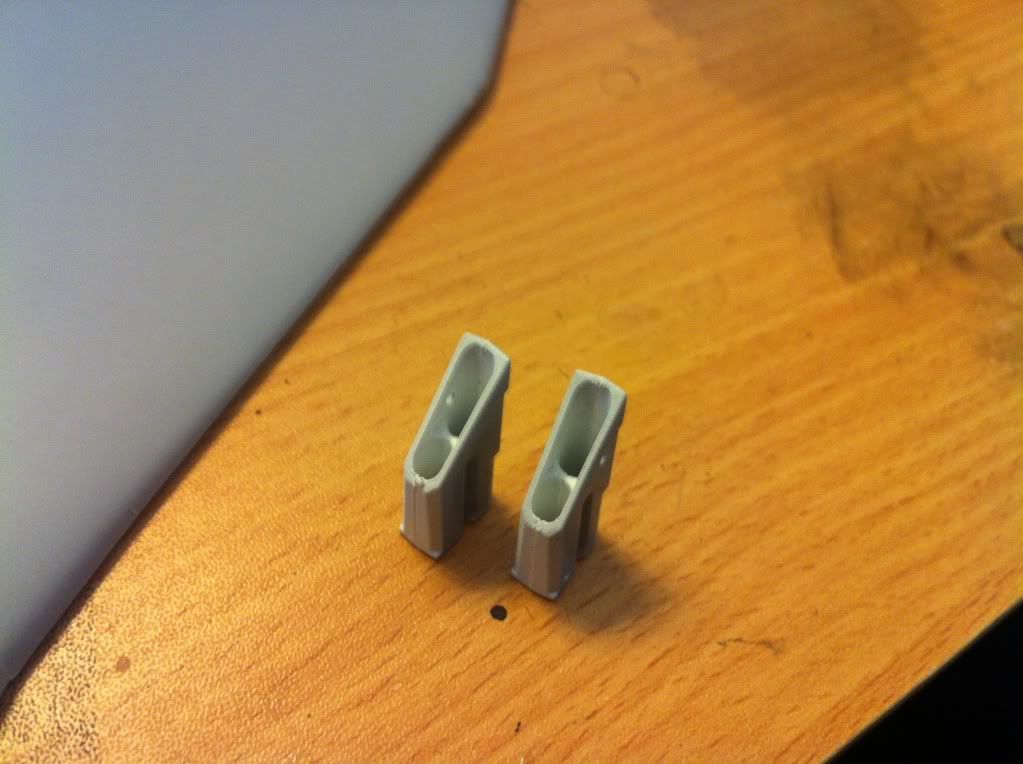

robvulcan Posted March 4, 2014 Author Posted March 4, 2014 So while I am deciding what to do next with the big'n , The little'n is having its air intakes prepped for painting white, Its scary how similar the Dragon kit parts are in looks to the Airfix kit. I am not using these intakes as I am awaiting the Wolfpack ones but here is a comparison for you, 1/72 and 1/200th Cheers Rob

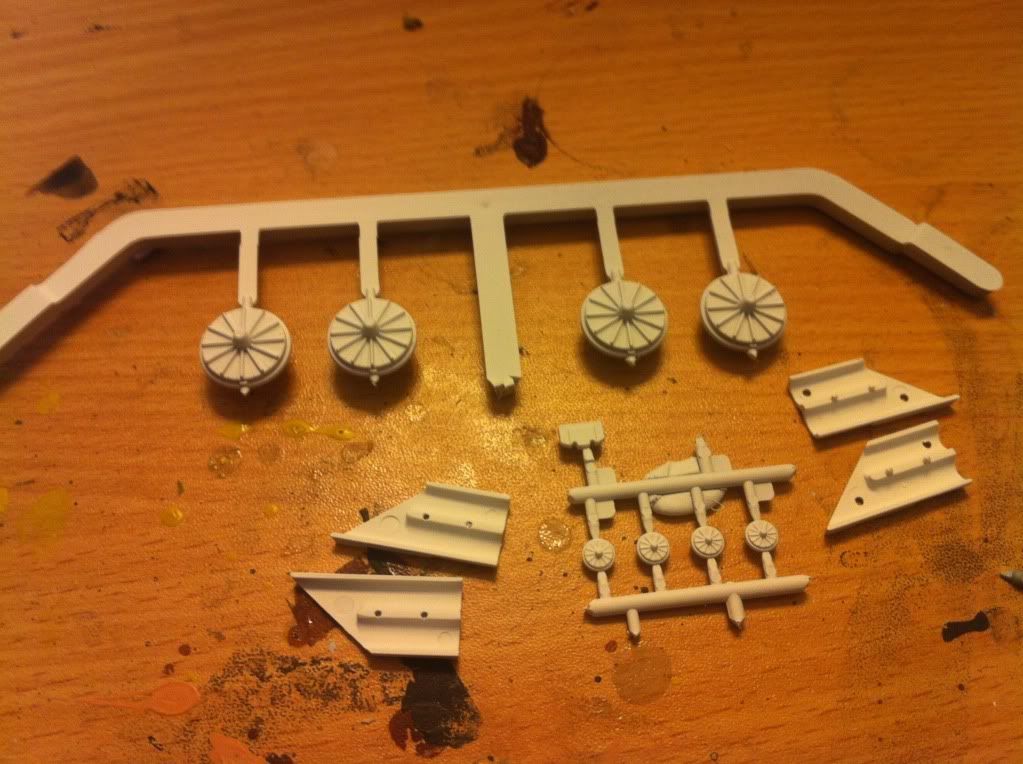

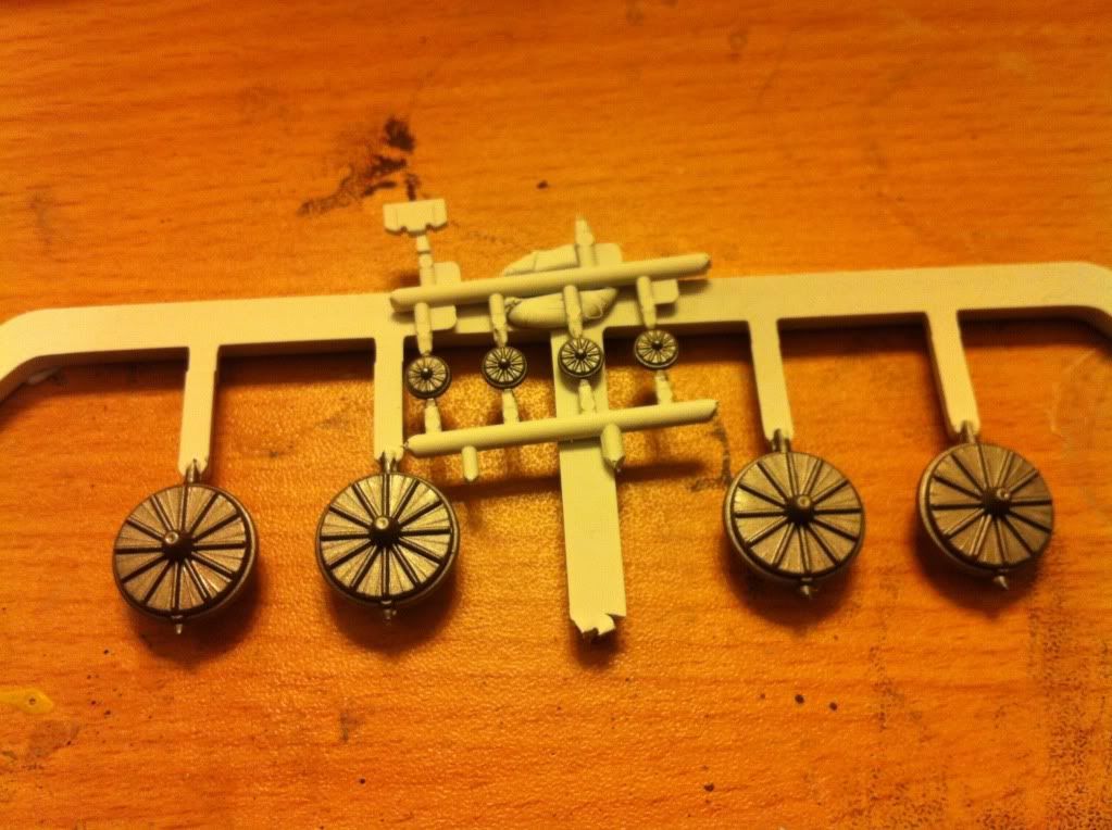

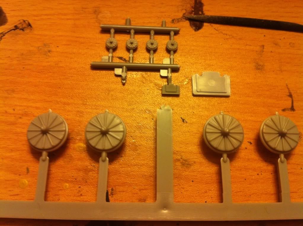

robvulcan Posted March 4, 2014 Author Posted March 4, 2014 Now I am getting the engine faces ready for painting again the similarity is startling also compare the bulkhead for the wheel well I think Dragon took a lot of inspiration from the Airfix kit. I am not certain which engine type comes with the wolfpack kit and I need to check these with photos of 300s Turbo Jets but I think these are quite accurate from memory. I thin it was only the 200s that had larger bullets and the 100s with much larger still bullets on them. The Intakes of the smaller one are now ready for a coat of white. Cheers Rob Cheers Rob

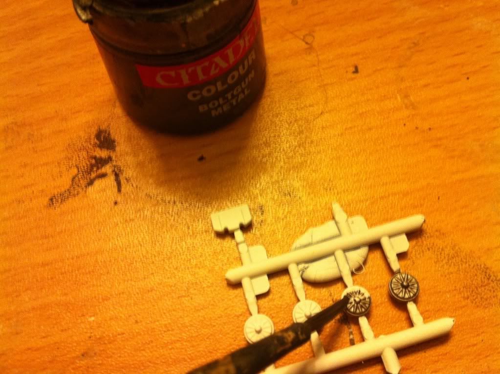

robvulcan Posted March 5, 2014 Author Posted March 5, 2014 Well I have not got that much done today. we had a delivery of wood to shift down the garden which was a bit of a work out. I did spray these white last night with humbrol rattle can matt white. I Can now brush paint the turbine faces and the intake halves for the tidler can be joined and then have yet more white sprayed down them. I had got distracted with some other models today and started a whiff project. Busy few days ahead and away over the weekend so there may not be much progress till Monday. Cheers Rob

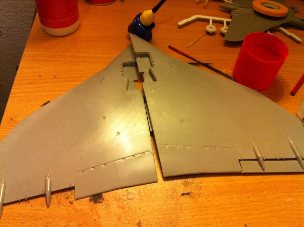

robvulcan Posted March 10, 2014 Author Posted March 10, 2014 Some progress I have sanded off the panel lines on one of the wings to give the clean look. Meanwhile the tiddler has the intake halves joined. Once dry I can get in there with the wet and dry and then spray more white down them. More soon right after more Coffee !
robvulcan Posted March 10, 2014 Author Posted March 10, 2014 (edited) Update time. Sanding of the panel lines continues..... Its actually quite time consuming doing this. I am using a 1500 grit pad and the good bit about this is that when its painted you can still very subtly see the lines. The intention is to use chalk to create highlights in certain areas to break it up but give the clean but used look as this one will be high gloss like the real ones were. Its defiantly going to be XM597 Just got to make a decision on colors. The engine faces of the tiddler and the little one are receiving paint now. I am hoping to try and build some depth here with some black and a wash. The citadel paint has flow improver in thats it and as you can see it flows lovely with the brush. The Tiddler receives the blue steel bay and will be XM595 as per the kit but in an earlier condition with none of the day-glow dumbos and with original nose minus refueling probe and TFR thimble It is interesting again how very similar Dragons is to the Airfix kit with the little corner pieces just like the Airfix Its almost a smaller clone in some ways. The Tiddlers Intakes were run through with 1200 wet n dry now I can paint them white again to smooth them up. Cheers Folks Edited March 10, 2014 by robvulcan

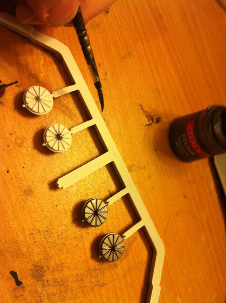

robvulcan Posted March 10, 2014 Author Posted March 10, 2014 I have tried to add more depth by my usual method with the Citadel Nuln Oil wash and added flow improver. Using capillary action from a loaded brush. Just got to wait for that coat to dry then I might add some brown too and a different lighter silver for the bullets perhaps. Then a coat of clear varnish to make them reflect a little. In the mean time I am still sanding the panel lines of the big vulcans parts No further work on tiddler yet. Cheers Rob 1
nimrod54 Posted March 10, 2014 Posted March 10, 2014 Looks like you have had quite a productive time today Rob. I still haven't tried the Nuln Oil wash yet, just waiting for the right kit to try it on (one where it won't matter too much if I c**k things up ) but I will give it a go soon. Meanwhile, I look forward to seeing more of your progress. 1
robvulcan Posted March 10, 2014 Author Posted March 10, 2014 Looks like you have had quite a productive time today Rob. I still haven't tried the Nuln Oil wash yet, just waiting for the right kit to try it on (one where it won't matter too much if I c**k things up ) but I will give it a go soon. Meanwhile, I look forward to seeing more of your progress. Aye I would have liked to have got more done but not too bad. Tommoro I should get more done. Got a bit distracted today. You should get some and give it ago on some scraps of sprue and random objects. Make sure you add some W&N Flow Improver though. Cheers mate Rob
