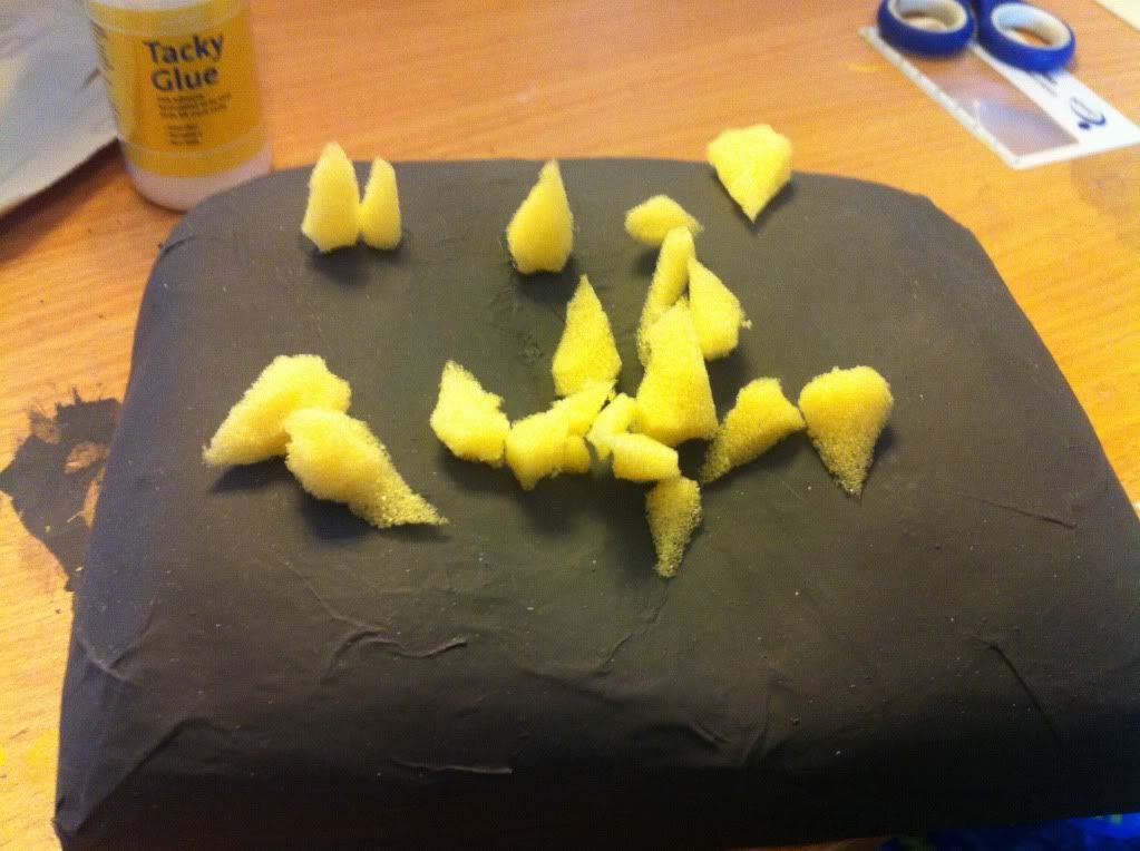

Right well as I said this thread is not done with entirely yet. There is the tiddler which is finished but her display base is not.

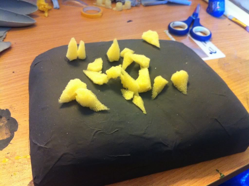

I abandoned this as I ran out of time and had to make do with a Corgi stand for the show. But for the Tiddler I have started to make a dio of the Canadian tundra out of insulation foam board on a wood base with newspaper and PVA glue. That part was actually made for the Precision Ice and Snow review I did last summer and I need to follow that up. This was originally going to be for the snow man I made but I will do something else with that later.
So I decided to chop up bits of sponge and I might redo all these as they could be better. But I am trying to make small fir trees. I will paint all this and flock powder it all greens and browns then I will add some Precision Ice and Snow to create a winter enviroment for XM595 to fly low level over. This is what the MSG and Green scheme was for on V bombers

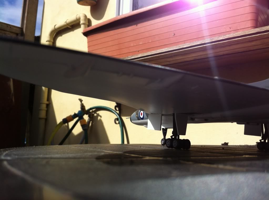

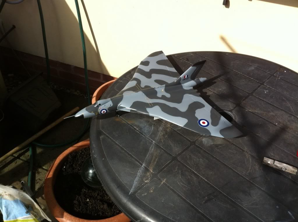

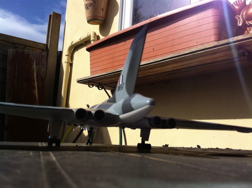

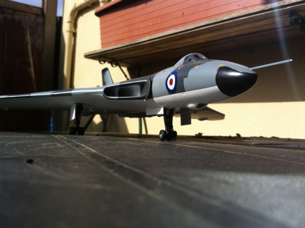

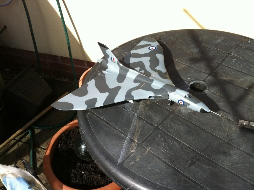

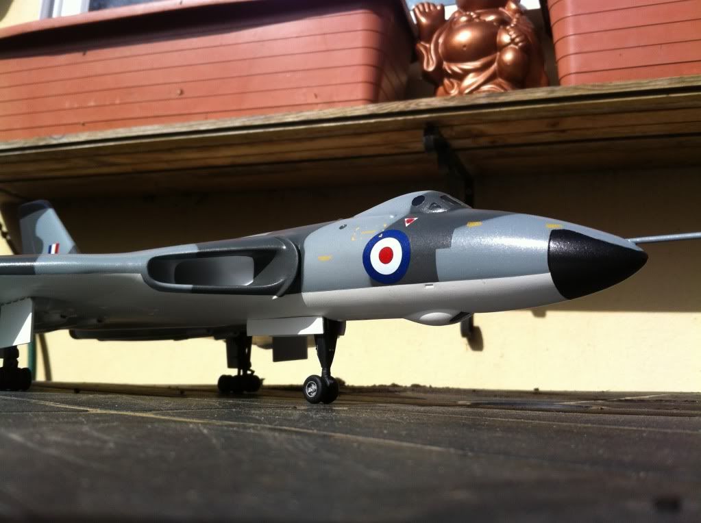

As the sun was so nice this morning I took a quick few snaps outside in natural light to show you the results of my paint experiment I believe its worked out pretty well and I am chuffed with the results.
B6FA9AD8-63DA-420B-B026-07C6BE258C8B-194
45C03CC6-27DA-42BF-8D3C-10184D3B7603-194
CA649DFB-EDA7-4335-A360-001E522D436A-194
6467FF57-C5E9-443A-A224-E36406E84F2B-194
3DE02976-DD87-4AAA-AAD0-A24505ADF643-194
EC83CD5D-CA8C-480E-84E8-9431ADFF84E3-194
I need to plan what to do next with her. I need some punches to mask off the round radar panels on the fuselage 1 on top 2 on the bottom.
I then need to remove the wheels and doors so I can sort out the holes I added to add some gear door struts too. also to make them easier to decal as I need to as the number XM597 to the insides of the rear doors and possibly the smaller ones to the front ones. I will have to check my photos.
The Glue and glaze is brilliant for setting the doors wheels etc as it not only dries clear but its also goes like a rubbery jelly. So it has some spring and cushioning but also with care its easy to remove should you need to. But once set grips very solidly. I love the stuff. I recommend you pick some up from deluxe materials. The do some good stuff and their putty is amazing. General Melchett give me the heads up on both these products I really must buy some Gator Glue which he tells me its wonderful too.
Then I will need to add the last few stencils to the bottom and then mask the windows off with PVA again so I can give her the final finish.
I like the satin look she has but the radome and fin cap need to be returned to matt, Once thats done I can mask them off and spray a final coat of varnish and then I might polish it up to a super flat high shine gloss as per the real thing, But the satin does look nice from the can.
The very last job for this build will be to paint up and add with glue and glaze the smaller aerials etc.

Rob, ever thought of doing a Vulcan ?...I know it's a bit off piste for you but.....
Looks really good, as pointed out it just need the radome black and fin cap matting , the tan circular plate and a few aerials fitted and she's good to go, (but at least you can do these at your leisure !!)....though I know you enjoy the stress.... :banghead:

Well today I have been sorting the final finish on the tiddler by giving her some klear, then cidadel nuln oil wash applied to the panel lines sparingly and the excess removed. Then a coat of hu satin varnish and a polish up to a gloss. Photos of that later.

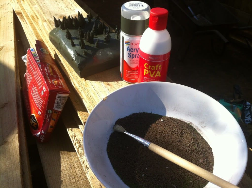

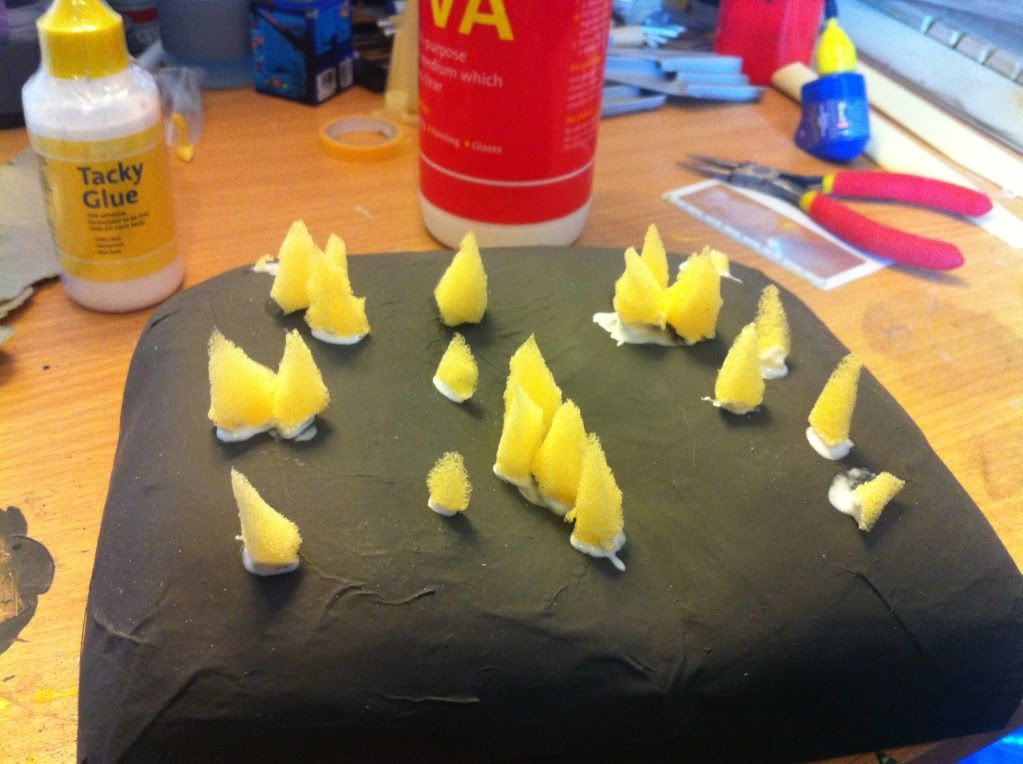

But today I have also been working on the Canadian Tundra Dio for her to fly over. Very crude this and started in desperation for the show but not finished in time hence her hiding at the back of the big 'n on the corgi stand in a temporary matt finish.

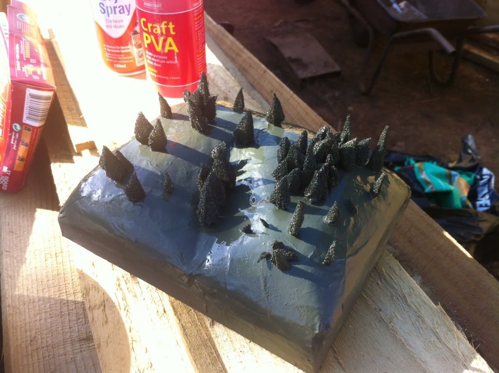

I cut some bits of sponge and stuck them on to my base with PVA. Then I sprayed them in humbrol 163 from the can. when dry I will add some pva and real soil around them. The soil dug from the garden sieved and microwaved to kill any bugs etc.

After the dirt is down its time to get to the fun part using some Precision Ice and Snow ;)

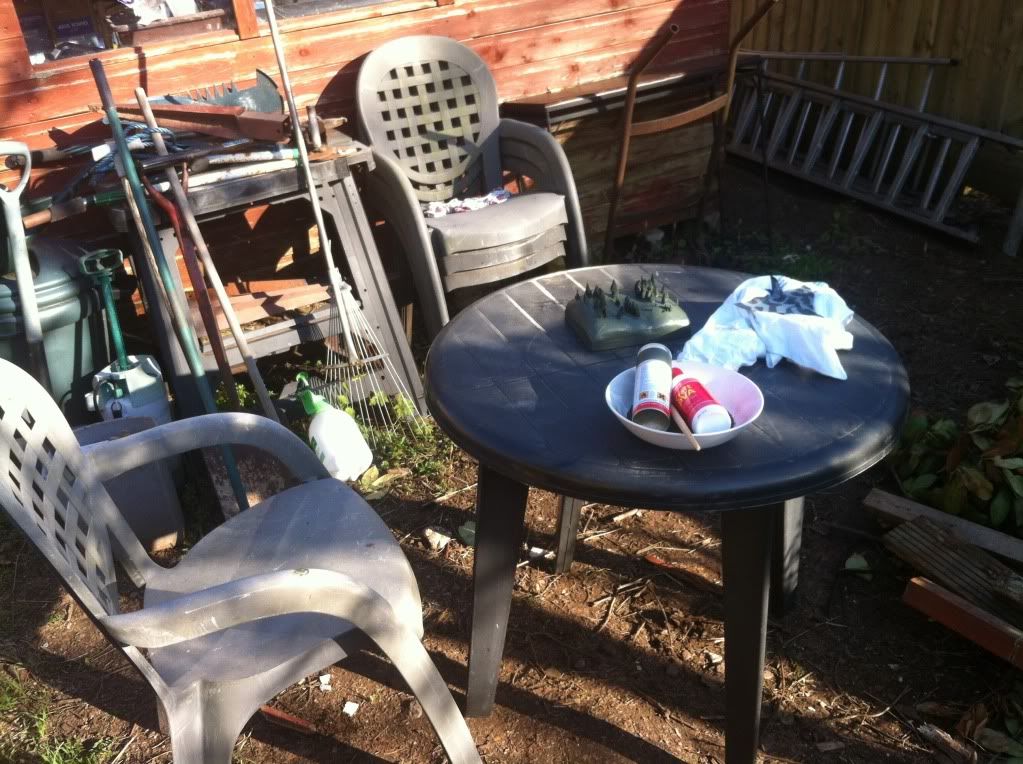

So here is my impromptu garden modeling table at the bottom of the garden which we are having extensively remodelled at the moment. decking sheds the lot.

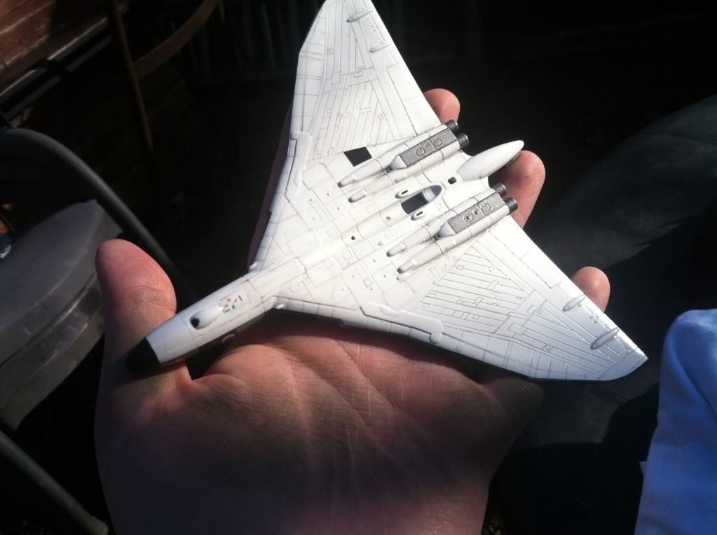

Some quick shots of the tiddler in here near finished state, Panel lines picked out (don't normally bother but it adds something in this scale but I have kept it very subtle)

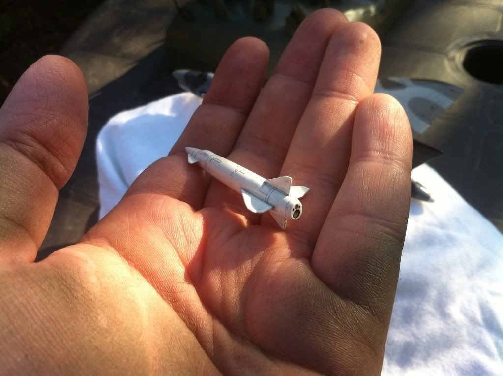

Here is her little cute Blue Steel Missile :)

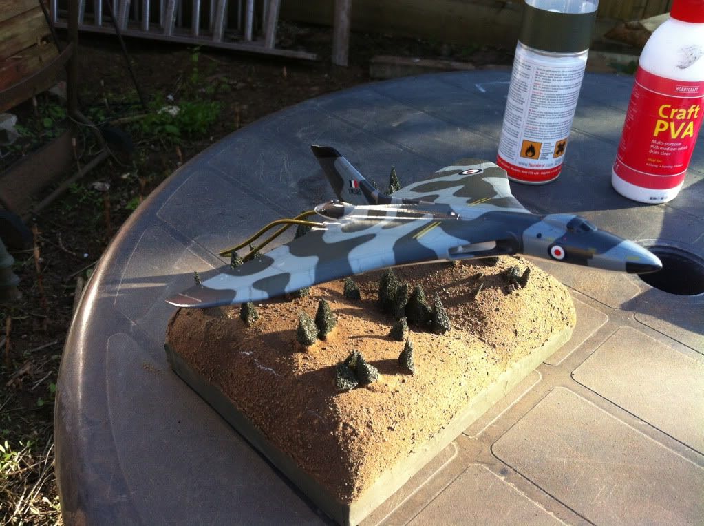

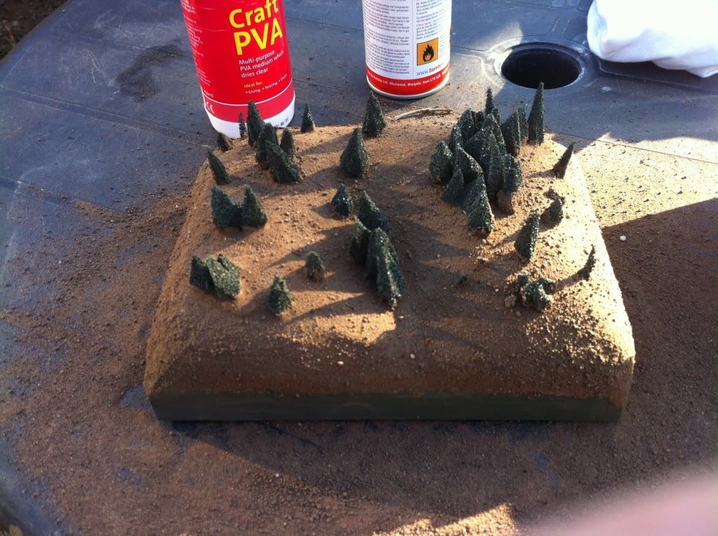

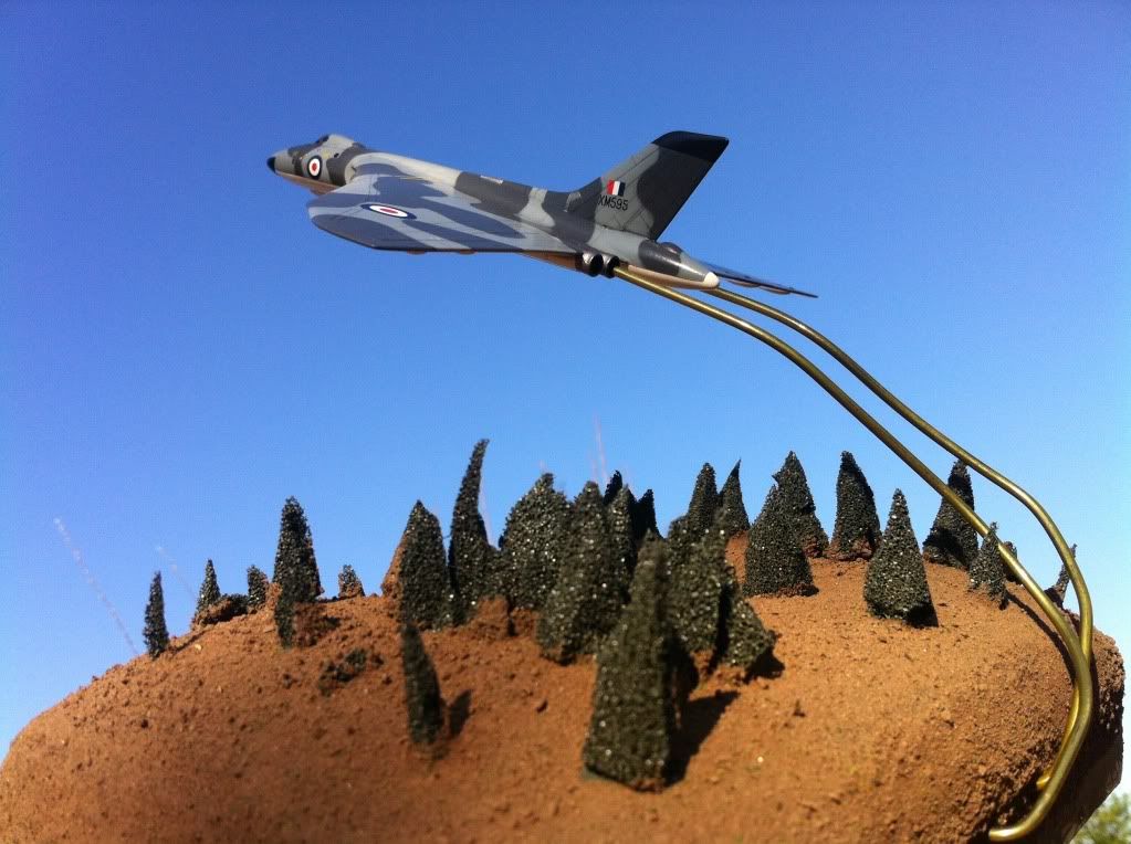

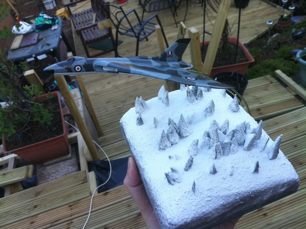

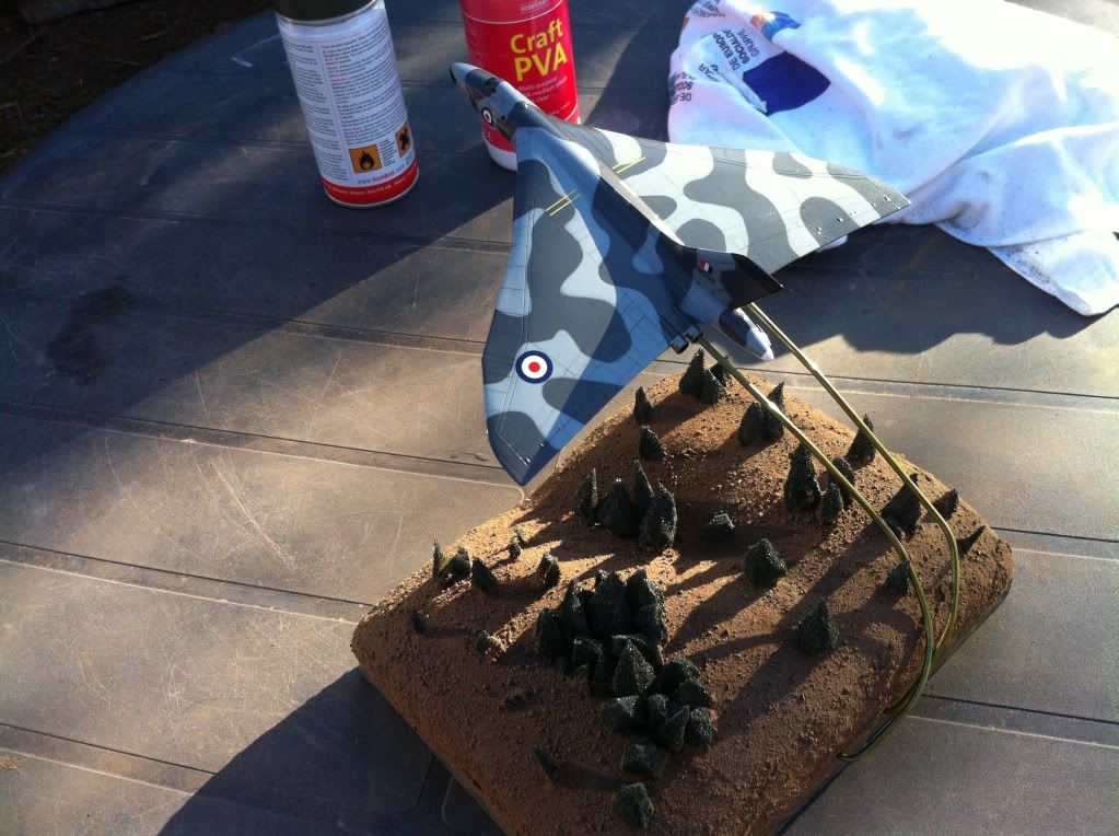

Onto the forest Real soil and it still looks like bits of sponge haha.
6E9D7301-AFE2-4EF6-B337-A32F8B121E50-104

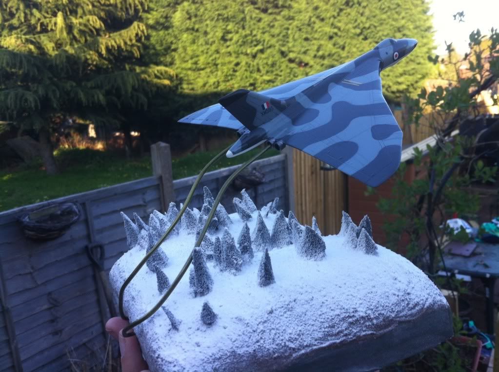

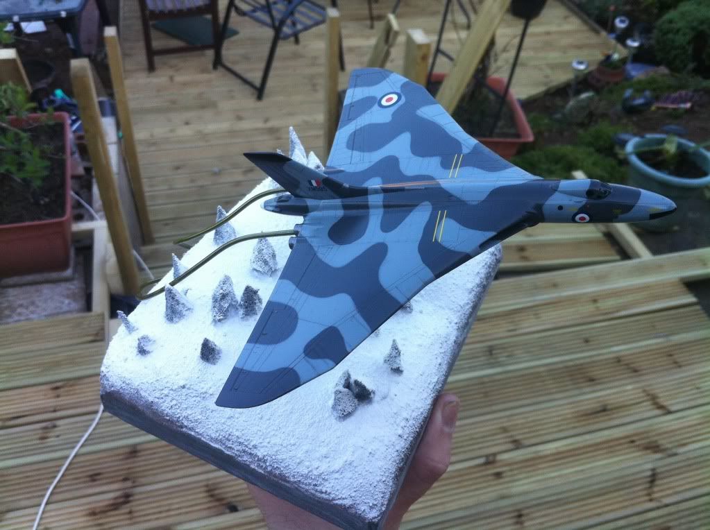

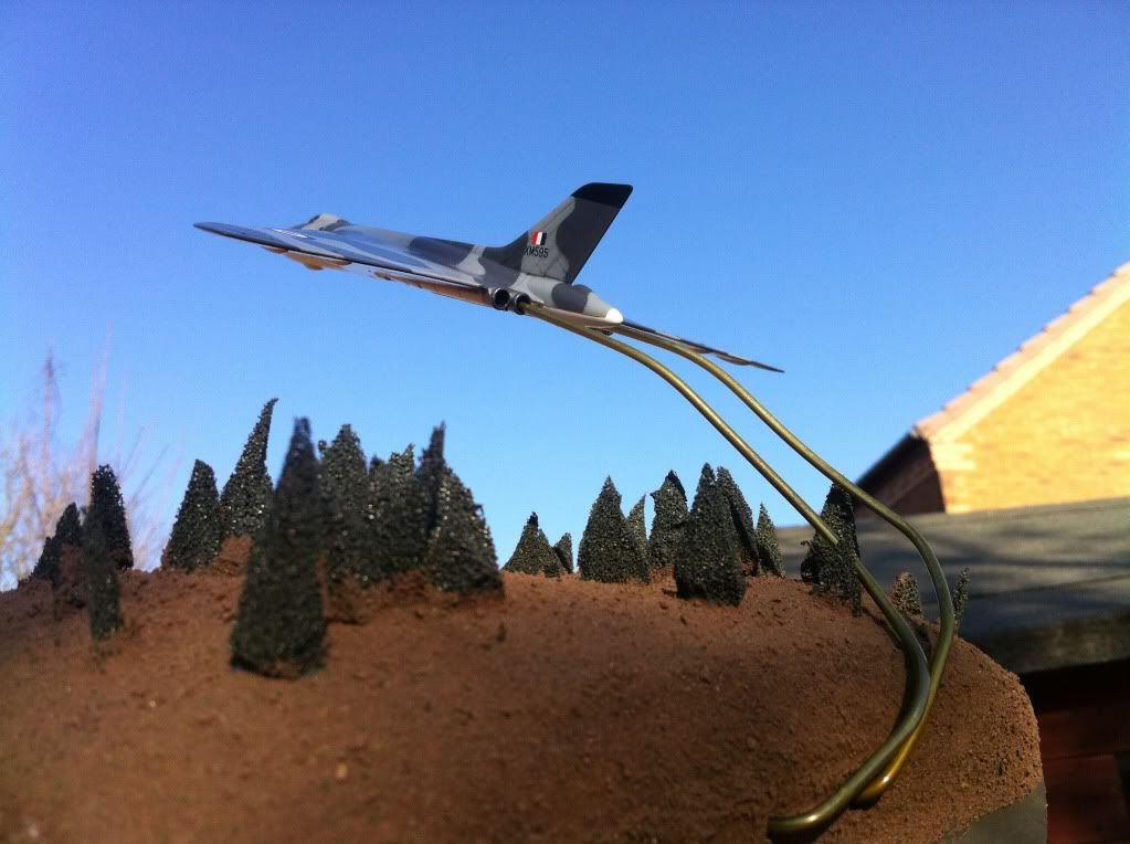

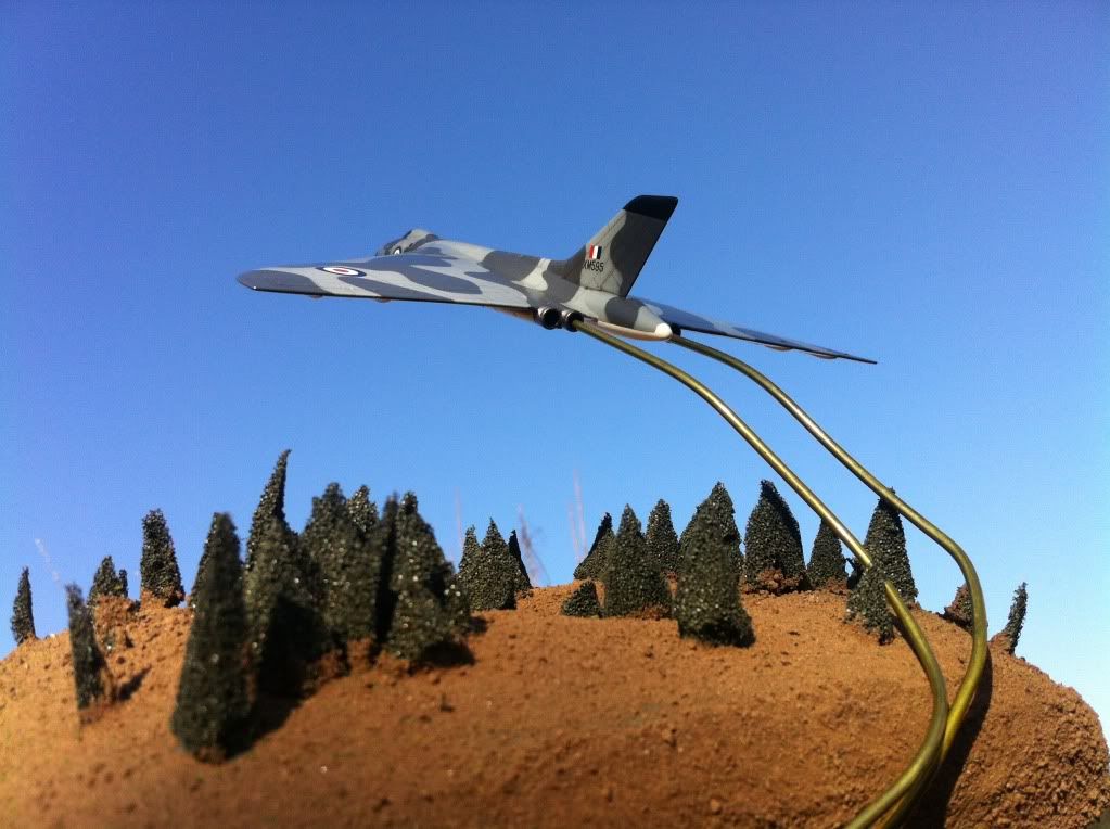

The brass wire is coat hanger wire. This is temporary till I can find something more suitable. Not the final position either. Just a quick look at whats going on.

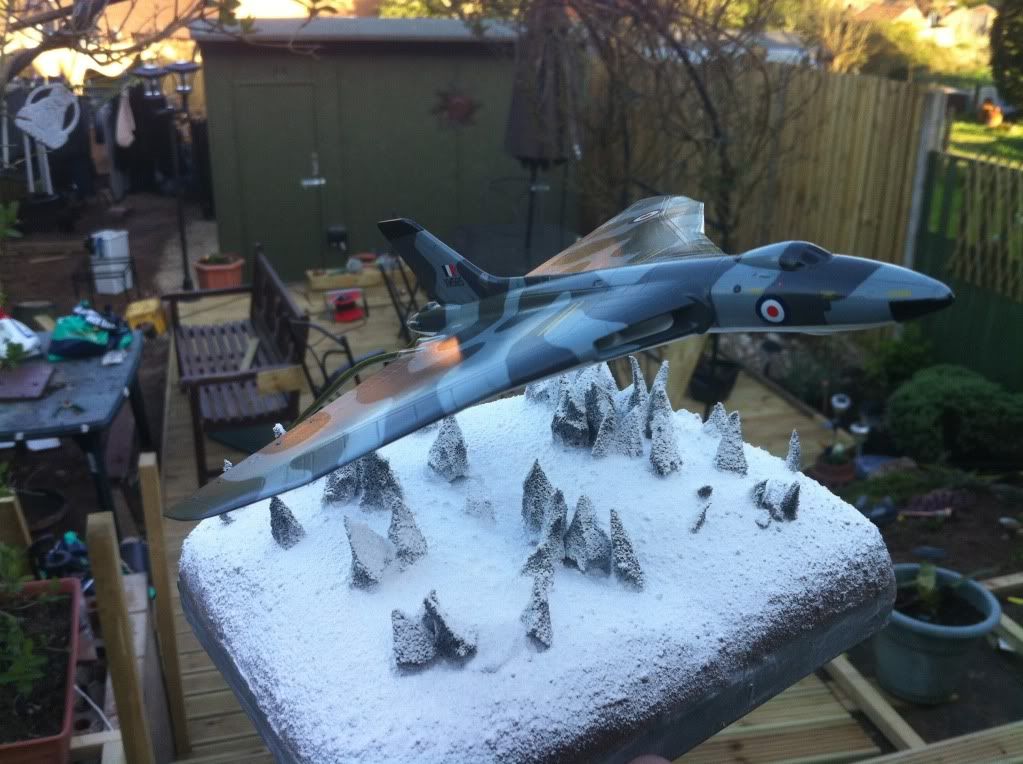

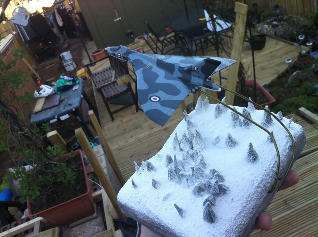

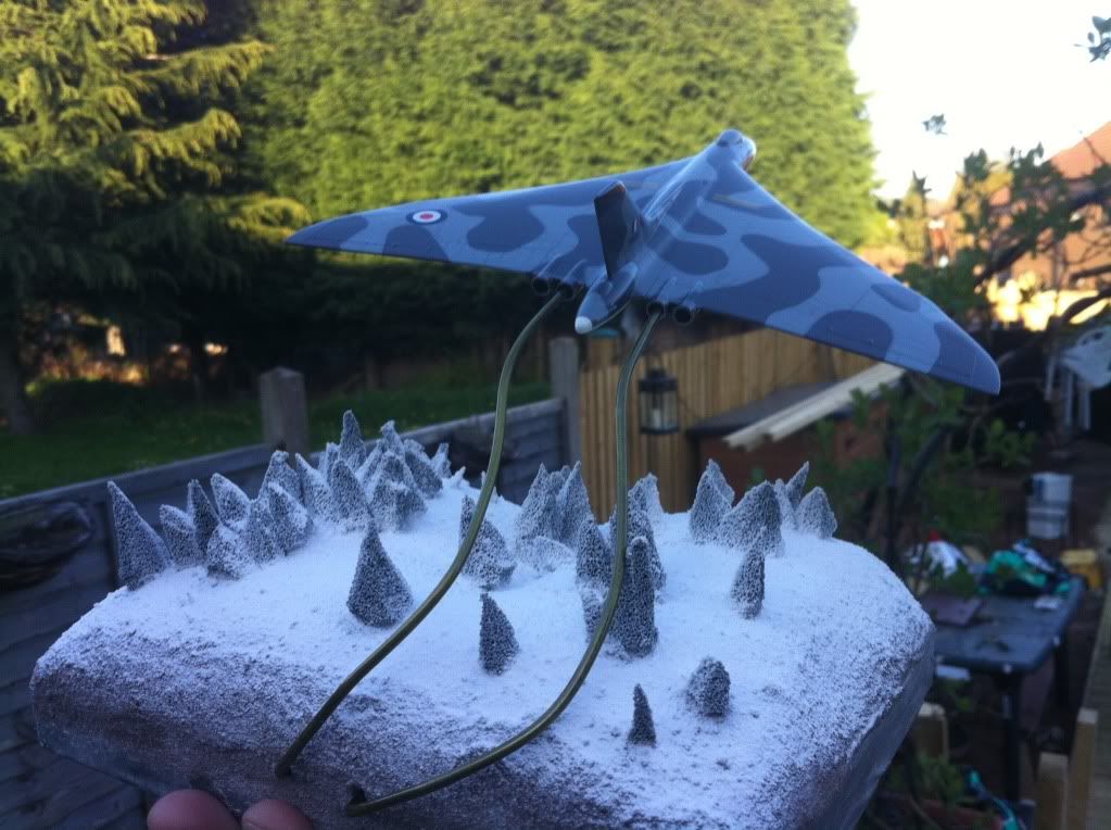

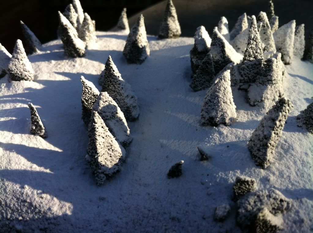

Right I have been getting all sorts of funny looks off the neighbours today. Me holding little aeroplanes up to the sky to see how they are looking, My fingers in a bowl of microwaved soil, Armed with PVA glue a brush and a MASSIVE BAG OF WHITE POWDER ON THE TABLE !!! I hear the Police helicopter coming.... Oh and to top it off Hairspray and 3M spray...

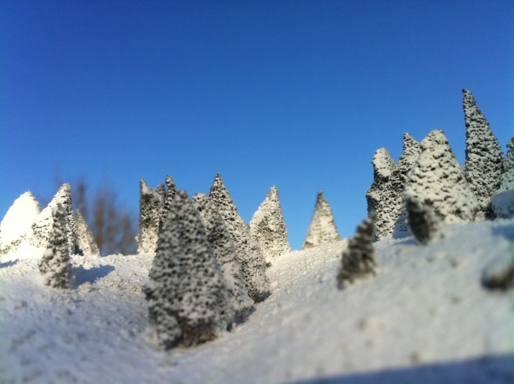

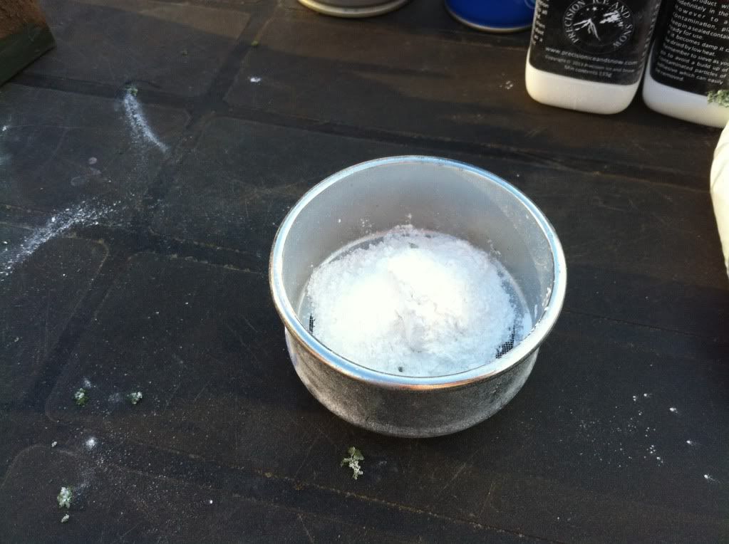

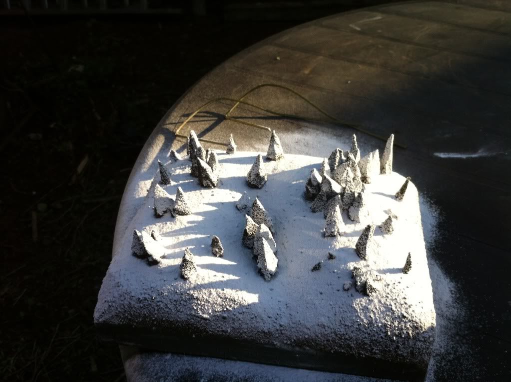

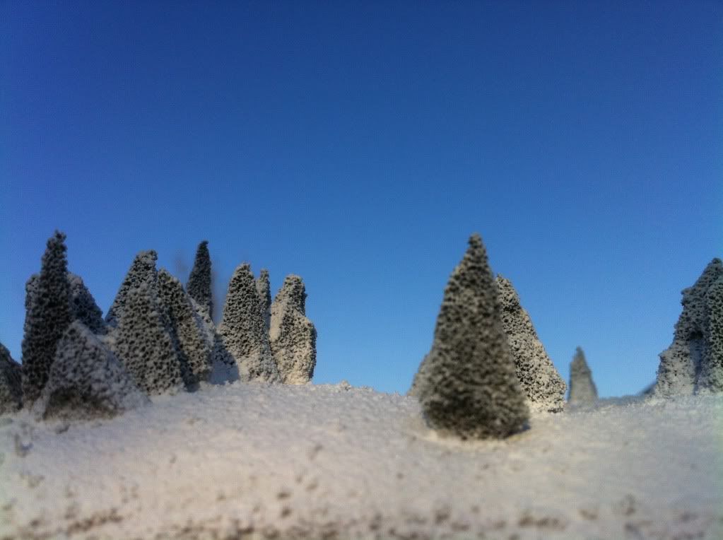

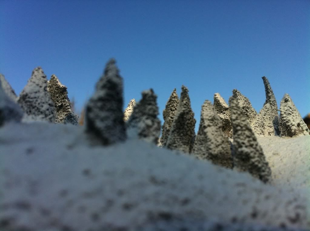

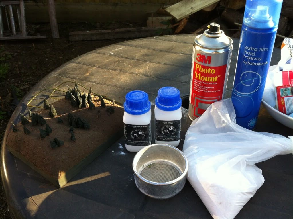

So here we have it. Forest, Hair spray, 3M Photomount, plus Precision Ice and Snow kit with its own medical grade sieve. Away we go.
F9F47F0D-CEF4-4E54-9353-7FD83CA25260-104
This does look greedy to the casual nosey neighbour :yikes: . It sieves much better if its half full.
7272DF18-CBE7-4D0C-8D40-0029A54C819B-104

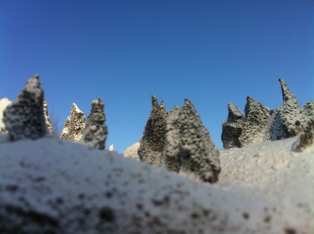

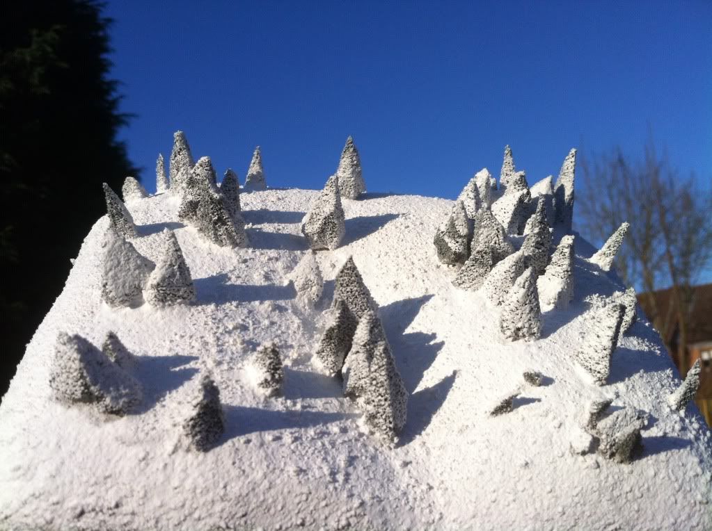

Plenty of hairspray and then 1 coat is sieved on.
938FA5ED-C14A-407B-AE6C-FC787A113652-104
087814AD-5E18-4044-8671-2C6A42C4ABC4-104

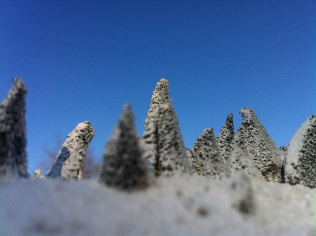

2 more coats with hairspray (removing and reusing excess in between by tapping off and reloading the sieve and then 2 coats with 3m for a finer top layer.
F46FA36C-AF5B-4FB3-B037-91FBC9F8A528-104
CF20D41D-5CE5-41C6-9F52-CC58E664B8D6-104
B710078A-9FDF-436E-88EF-287898D7C127-104
27EAC5F8-CA19-4AF2-B763-B3D0CE272696-104
796ABD07-1A37-47C0-91BB-C6D7D20E8BBE-104
32BC93F3-7F90-4EFF-A9A1-E93E85F47827-104

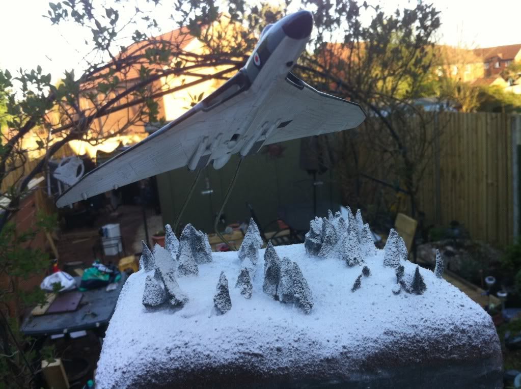

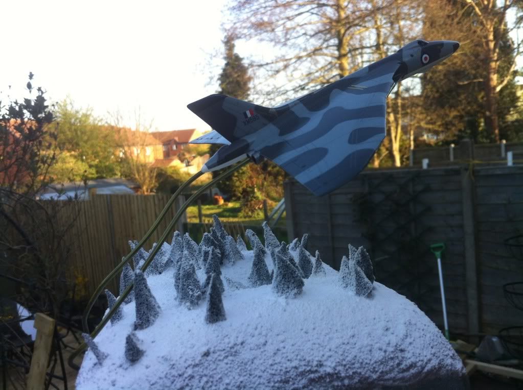

I did this in a rush to test the theory. If I had taken more time with the sponge this would work better. But we are getting uber close here and the point of this is to have tiny trees for the Vulcan to fly over. But later on she will need a bigger Dio me thinks. With a fine lycra wires to sit her on or something.

Bigfoot is hiding....
Cheers Rob ;)
  • Like 9
Yeah, Rob. Where have I heard that one before.
Great diorama.
