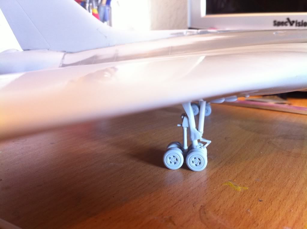

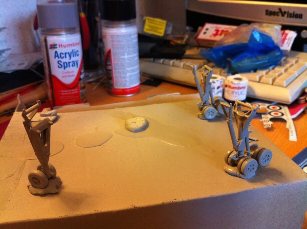

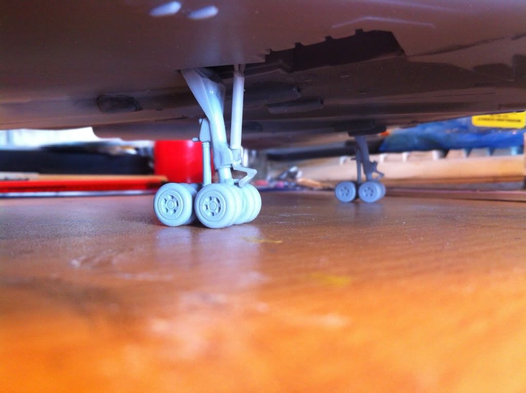

robvulcan Posted April 4, 2014 Author Share Posted April 4, 2014 I decided to strengthen the undercarriage. I have been messing with it that much I don't trust it not to break. I am also thinking of investing in some metal ones for the future too.. Possibly.. So I used A cotton bud. I chopped in half the strut and then superglued them in, The bore was just right and whilst it adds a bit of thickness it also looks a bit like this one. http://data3.primeportal.net/hangar/bill_spidle2/avro_vulcan_b2_xm606/images/avro_vulcan_b2_xm606_46_of_93.jpg .... Ok so it looks a bit .. but its strong and black is a slimming colour. Most importantly right now It works.. So here it is loosely fitted. As you can see there is a step in the triangle part. but if you look at the photos its actually now in the right place. The kit fit puts it far too high. Just need to pack out the gap Both the new stuts together. Now to sort the gap out. .......Meanwhile.... here she is now primed with some humbrol ocean grey direct from the spray can. Next I can fill the little gaps with our good old friend mr milliput. Then fit and paint the ECM area and were ready for the paint shop starting with the white and then a capacious masking session.... 3 Link to comment Share on other sites More sharing options...

nimrod54 Posted April 4, 2014 Share Posted April 4, 2014 Well done Rob, see ahead of schedule already. As for the undercarriage give it a fictitious Mod No. and claim that it was a strengthening Mod introduced by AVRO. 1 Link to comment Share on other sites More sharing options...
robvulcan Posted April 4, 2014 Author Share Posted April 4, 2014 Well done Rob, see ahead of schedule already. As for the undercarriage give it a fictitious Mod No. and claim that it was a strengthening Mod introduced by AVRO. HAHA. Well some vulcans might need it haha. I actually think it looks a bit better It certainly don't hurt its appearance too much. Just trying to rescribe some lines that got hurt making the thing fit together. Just about to milliput her then I will sort these struts out and the Doors. After that its gonna be one hella marathon paint and decal session. I have finished the tiddler. I have started making a dio for her too. Cheers Rob;) 1 Link to comment Share on other sites More sharing options...

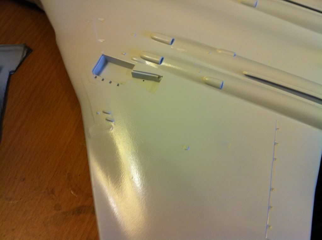

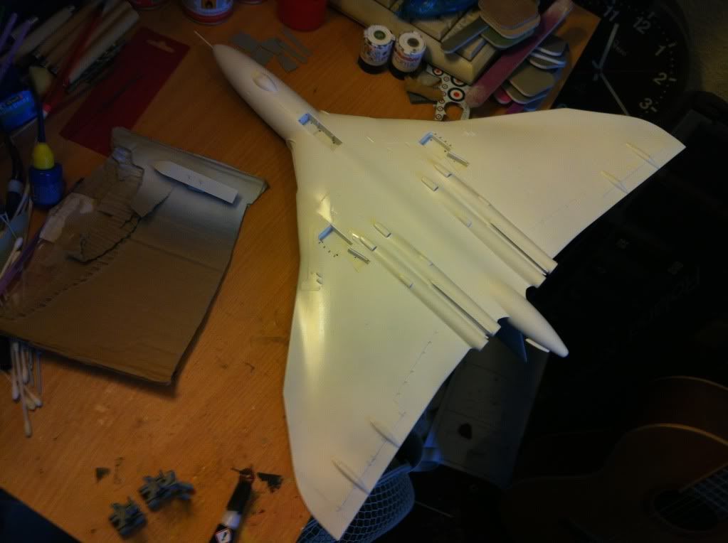

robvulcan Posted April 4, 2014 Author Share Posted April 4, 2014 Well i have donemy best with the seams,tons of super glue, milliput, sanding, micro meshing, filing, repeat again and again . but still slight liitle marks remain. not even milliput will do it no-matter how i apply it, wet, cotton buds, dental tool., its just wiping out . I can live with it, real Vulcan's have blemishes. but... I have some tip ex. now i hear others use it but in the past i had trouble painting over it . Any tips ? Link to comment Share on other sites More sharing options...
perdu Posted April 4, 2014 Share Posted April 4, 2014 I dont rate Tippex much myself though it has been OKish for me in the past Small surface blemishes cry out for a fingertip of spatupon (really) Perfect Putty. Even when wet applied it dries quickly and can soon be gently sanded. Just a spot on a finger and lay it in lightly, wet'n'dry paper will whip it orf invisibly shortly afterwards I don't rate even PP for deep applications, like you I prefer Milliput for that (just bought a new pack, it works so much nicer than my old stock M'put which I've had a couple of years) but however what you need is subtle resurfacing work. The new struts look good enough, and on the 'table' least said is best. Most observers DONT actually see what they are looking at I hope to see a goatee around the halls on Sunday, I'll be the old git driving a MG Midget 'spritedly' into the car park Bloody rain, I was hoping for a roof down day b 2 Link to comment Share on other sites More sharing options...
robvulcan Posted April 4, 2014 Author Share Posted April 4, 2014 I dont rate Tippex much myself though it has been OKish for me in the past Small surface blemishes cry out for a fingertip of spatupon (really) Perfect Putty. Even when wet applied it dries quickly and can soon be gently sanded. Just a spot on a finger and lay it in lightly, wet'n'dry paper will whip it orf invisibly shortly afterwards I don't rate even PP for deep applications, like you I prefer Milliput for that (just bought a new pack, it works so much nicer than my old stock M'put which I've had a couple of years) but however what you need is subtle resurfacing work. The new struts look good enough, and on the 'table' least said is best. Most observers DONT actually see what they are looking at I hope to see a goatee around the halls on Sunday, I'll be the old git driving a MG Midget 'spritedly' into the car park Bloody rain, I was hoping for a roof down day b Ah yes it was a gorgeous day last year at cossie. Was my first model show. I hope It does not rain.... Boo Hiss.... Yea I just tried out some tip ex., Was not impressed before I am not impressed now..... Rubbish.. Well I have managed to fit the struts. The wheels are removable. Which is good for the sake of : 1. Transport, 2, Breakage and repairs, 3 may need to refinish the beast after cossie and do more too her, Like polish her to a super high gloss, Though For now I am opting for matt or satin just for the sake of speed and also its easier to make that look good. 4.Might add metal wheels in future. 5. Even though I hear some say vulcan undercarriage are "Quite sturdy" I hear some say they collapse. Mine seems pretty stable without glue. I can set them for the show with PVA and if I want to later pop em off again. There are a few blemishes here and there but To be honest I can live with it and considering the starting point it being the worst fitting kit I have ever made. (Not a reflection of the Airfix Vulcan build loads easy before just this particular one) I think she is looking pretty good overall. So what next. Well the Milliput is drying albeit only a tiny bit. Next another go over with the grey, Then spray the white and mask it. That will be breakfast time tommoro. Then I need to paint the wheels which I have nearly finished faffing over.. Then need to sort the gear doors, I have drilled holes so I can fit guide/mounting rods to make them replaceable. Your right, Folks tend to only see the overall effect. Its my Vulcan Its not perfect but I love it. I always endeavor to improve and this has helped. The next one will have to be better still. I must hunt down an MPC boxing next time. Well I think I might wrap up for the night now. Getting pretty tired now.. Hell of a day but I enjoyed it. Cheers Rob 1 Link to comment Share on other sites More sharing options...

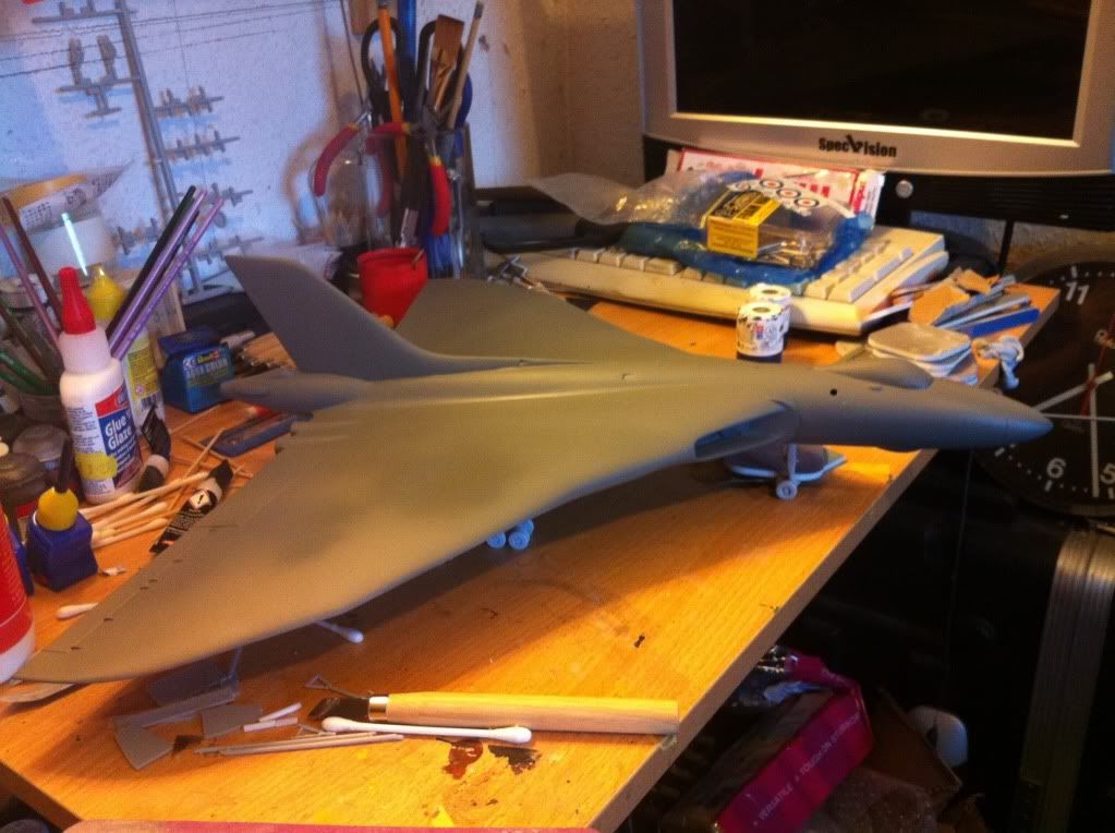

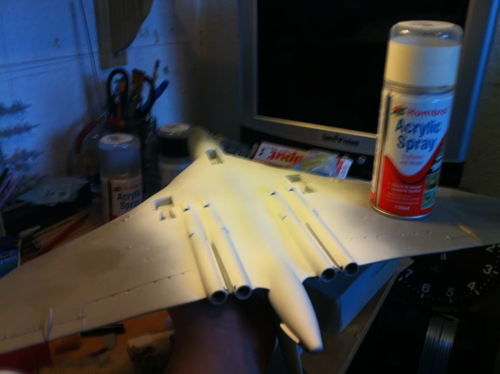

robvulcan Posted April 5, 2014 Author Share Posted April 5, 2014 It goes on like this which is nice but When dry this stuff levels out and bites into the plastic. Its great to prime with and brush over with Acrylic with W&N Flow improver added. Sticks like to a blanket. For anyone looking for a good white Humbrol spray cans are the way to go. And they do matt, satin and gloss, I stick to matt and satin. I find them more user friendly. I feel reassured now I am getting my fix from the smell of paint. Its the painting stage I like the most. Cheers Rob 2 Link to comment Share on other sites More sharing options...

general melchett Posted April 5, 2014 Share Posted April 5, 2014 (edited) You're doing well and will be graded later ! Ha...good job fella, but to be honest to get all that camo masked and done, plus decalling and top varnish by tonight is a huge ask !....unless insomnia is the order of the day. For anyone looking for a good white Humbrol spray cans are the way to go. And they do matt, satin and gloss, To be honest Rob Halfords is great stuff, the primer can be micromeshed down to super silky smooth and the appliance white is a joy to behold..it's the only stuff I use for glossy white finishes. (The trick is to spray it on fairly thickly to avoid orange peel though not too thickly so as to get the dreaded 'sag' and then put it in a very warm place quickly, I put them on a rotating stand in front of a convection heater, at a safe distance of course......dries as hard as nails) See you tomorrow , Melch (btw I've given up on getting the Victor done by tomorrow as the gloss blue's still tacky and I aint going to rush the blighter at this stage....so don't feel too bad if it proves a bit much ) Edited April 5, 2014 by general melchett 1 Link to comment Share on other sites More sharing options...
robvulcan Posted April 5, 2014 Author Share Posted April 5, 2014 You're doing well and will be graded later ! Ha...good job fella, but to be honest to get all that camo masked and done, plus decalling and top varnish by tonight is a huge ask !....unless insomnia is the order of the day. To be honest Rob Halfords is great stuff, the primer can be micromeshed down to super silky smooth and the appliance white is a joy to behold..it's the only stuff I use for glossy white finishes. (The trick is to spray it on fairly thickly to avoid orange peel though not too thickly so as to get the dreaded 'sag' and then put it in a very warm place quickly, I put them on a rotating stand in front of a convection heater, at a safe distance of course......dries as hard as nails) See you tomorrow , Melch (btw I've given up on getting the Victor done by tomorrow as the gloss blue's still tacky and I aint going to rush the blighter at this stage....so don't feel too bad if it proves a bit much ) I must give halfords a try again but after a bad expiriance with their paints in 2005 I have never touched it since. However I hear those problems are irradiated now. The Humbrol stuff I still say try if you have not. (It used to be rubbish in the 90s I remember that, Runs , Weak pigments etc..) But the new stuff never orange peels, never sags, never runs, (unless your painting at point blank, very hard to make it run) The colour density is amazing, It levels out, Becomes part of the plastic and nearly impossible to scratch off. Its a shame your abandoning the Victor but your right not to rush it. Especially if the paint is tacky. Mine is drying pretty quick. I look forward to seeing it done when its done. The level of mods on that thing is nuts. You should bring your Airfix Vulcan the Blue steel 60s camo one. Can't wait for the show.... Actually I can I hope it takes ages to get to tomorrow morning... I need the time. Cheers Rob 1 Link to comment Share on other sites More sharing options...
