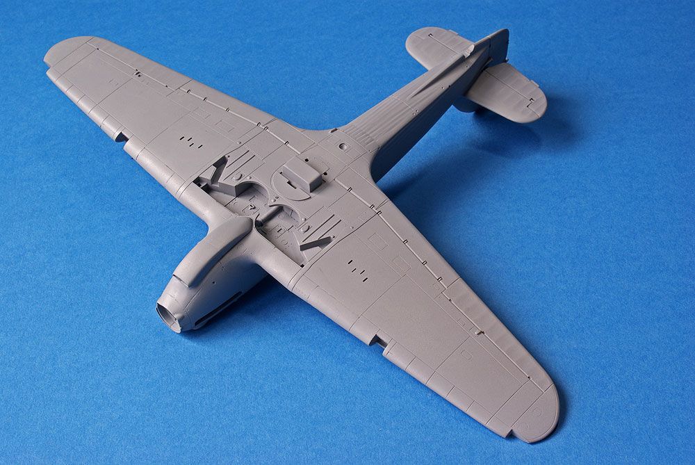

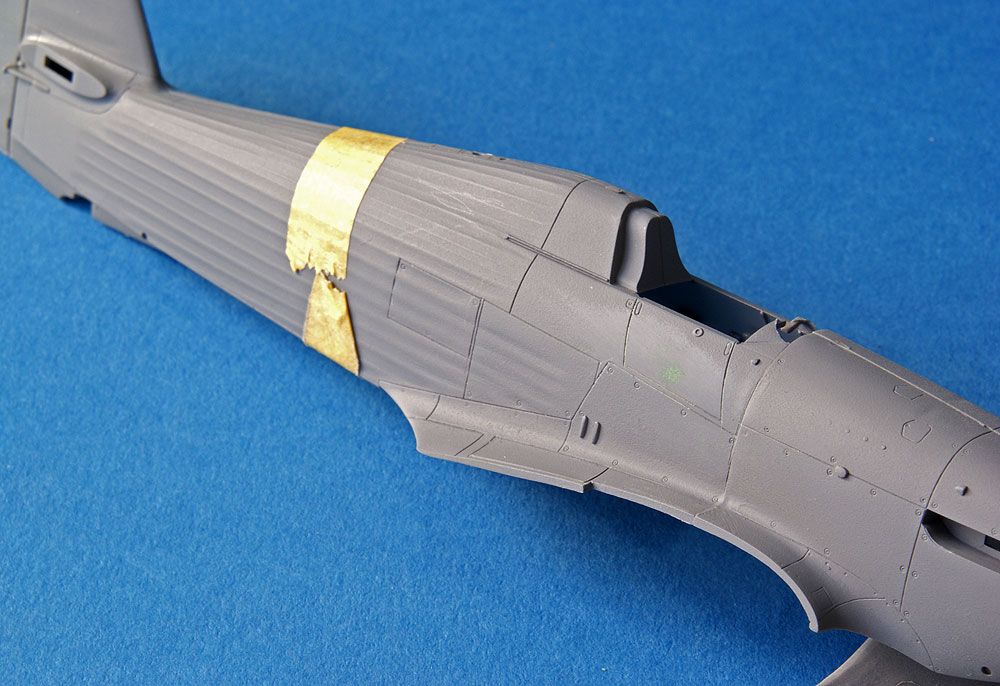

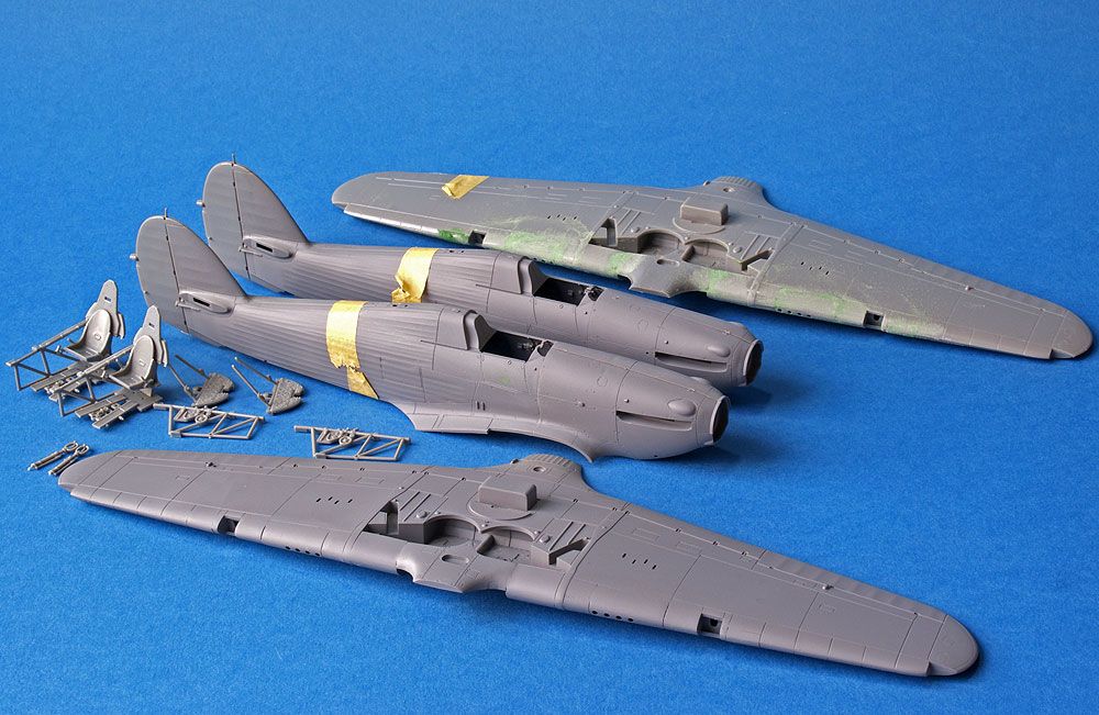

woody37 Posted January 31, 2014 Posted January 31, 2014 Bought these quite recently as I have a soft spot for the Hurricane but wanted to do something different than BoB. Hoping to make a start this weekend. Whilst there's some additional goodies that will find their way in to the builds, the main goal is to have some relatively simple sanity builds with the focus being on the paintwork and weathering rather than being crammed with every detail imaginable. To prevent Troy from telling me off , I've started to sand the panels on the sides which should have the corrugated form right across the join. Only done one side of one kit so far using a round file. Wasn't brilliant, but hope to improve for the others. Wasn't a disaster either! 1

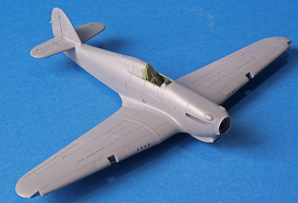

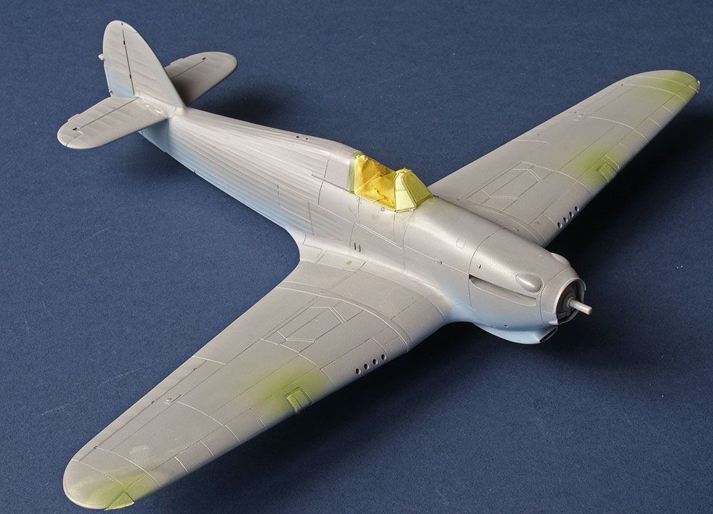

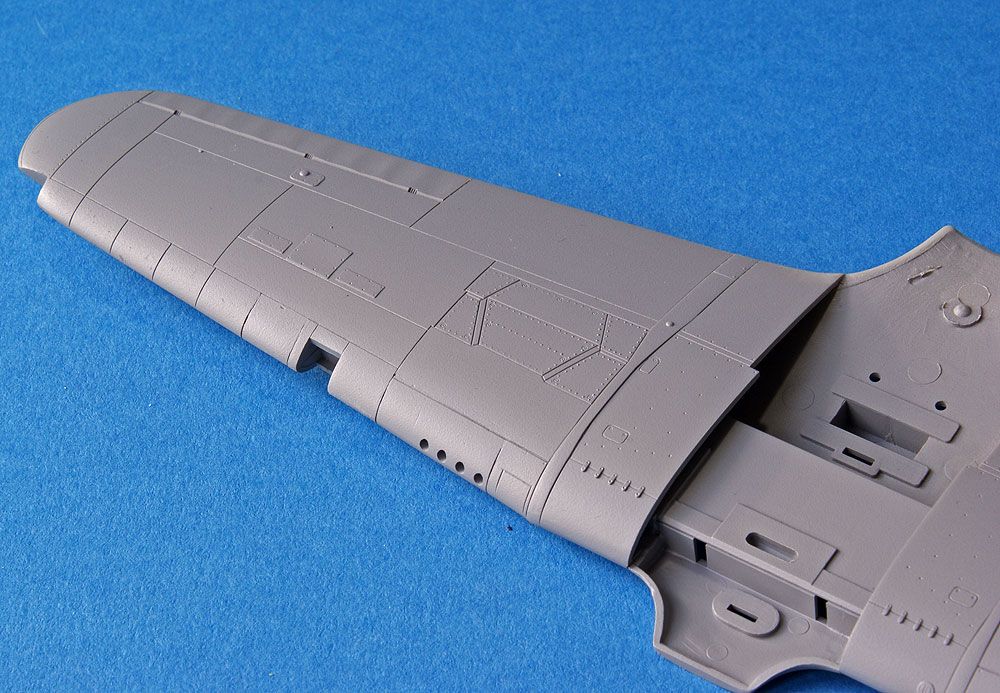

woody37 Posted February 2, 2014 Author Posted February 2, 2014 Made a bit of progress this weekend doing prep work. The Free French one will be a Mk.II with the slightly longer nose and a tropical filter under the nose, but has the 8 .303's rather than 20mm cannon. The fabric effect has now been corrected on the panels below the canopy as best I can. Some filler work is needed to remove sink marks and blend the bits that need to be stuck into the wing leading edges. Open to other fixes that are relatively easy to tackle if you can point them out. Cheers 6

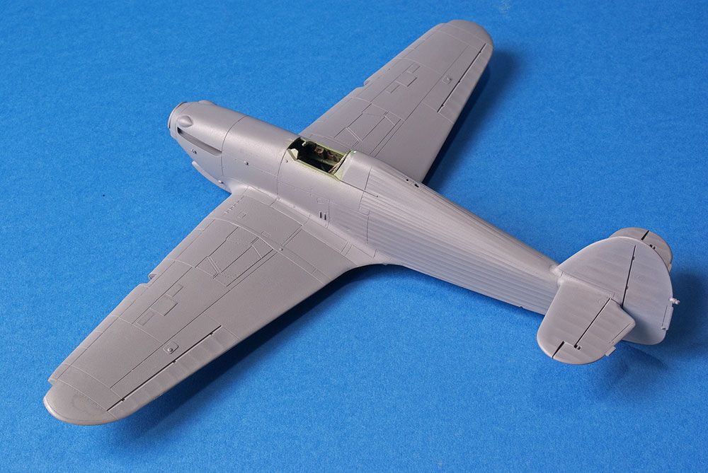

woody37 Posted February 9, 2014 Author Posted February 9, 2014 progress has been a bit slow, but got the Mk.II together so far. Been distracted by a Triceratops too with my son, the 1/35 Tamiya one he bought with his pocket money to go with his TRex! So far, please with the kits, although getting that rear join sorted where the lower wing meets the rear fuselage is beyond me, just done the best I can. The square panels to the rear of the landing lights need sanding off yet, need to bring the Mk.I up to this point first. 4

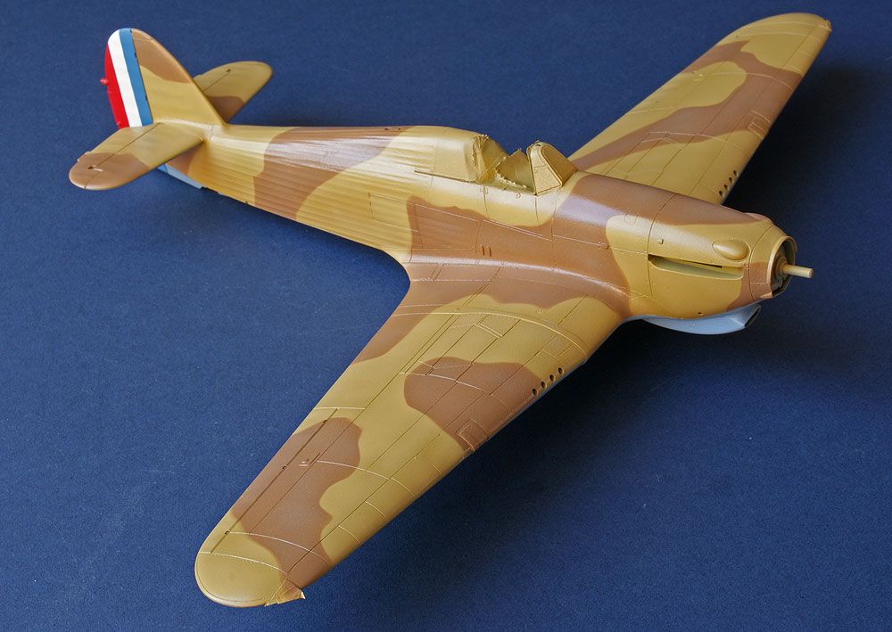

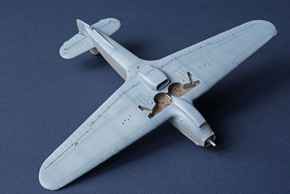

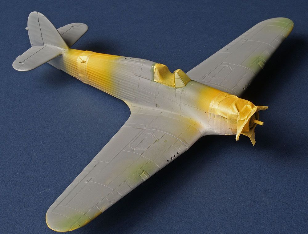

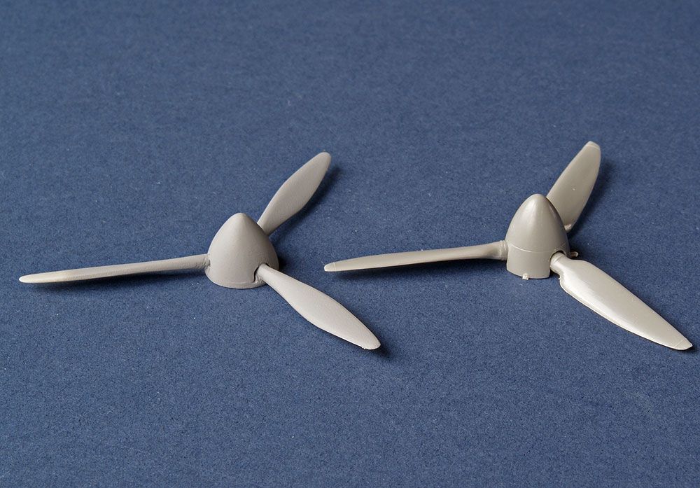

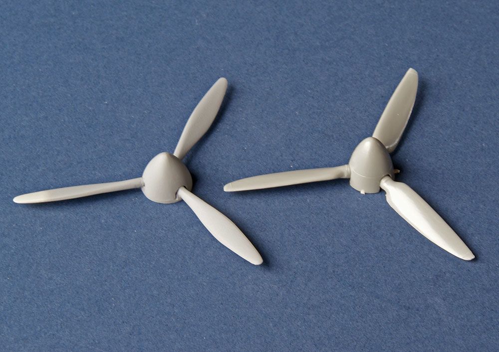

woody37 Posted March 1, 2014 Author Posted March 1, 2014 Not got much modelling done recently, but following the thread in the WWII section, started to paint these. There's some mods to do to panel lines after correspondence with Troy, I'll get them done before the camo goes on. It looks like the Mk.I should have a ring site too, not the one that comes with the kit. Mk.I: Mk.II Got an Airfix prop from Troy, here it is next to the Hase Rotal unit: Cheers 2

Troy Smith Posted March 1, 2014 Posted March 1, 2014 Hi Neil Looking good. One point, I think you have left the little tropical vents on the Romanian plane, which need to be removed. If this gobbledegook for anyone... here's a pic, the two little black lines directly below the pilots right foot, are vents to help cooling on tropical aircraft, and are not seen until 1941. They are on the Hase kit as is uses one generic fuselage sprue. My name has been mentioned, the reason is Neil asked about Romanian colours in the WWII section http://www.britmodeller.com/forums/index.php?/topic/234956047-romanian-hurricane-underside-colours/ And this led to various other discussions, including spinner types, which ended up with me sending Neil a spinner and blades. cheers T PS couldn't find any pics of the Free French MkII option. found some MkI pics http://scalemodel.forumactif.org/t514-blackhawk-hurricane-mki-ii-trop-croix-de-lorraine bit of background here http://www.aircraftresourcecenter.com/Gal8/7101-7200/gal7133-Hurricane-Beauvais/00.shtm The FAFL (Free France Air Force) regiment Alsace went to Egypt in 1942 and was equipped with Hurricane Mk I in English colors, awaiting for Mk II. Those aircraft arrived in August 1942 and were send back to the 417 squadron on September the 6th. Aircraft Z4615 was dedicated to high altitude interception and was equipped with only 4 machine guns. no idea if correct. another mkI, the box art plane

woody37 Posted March 1, 2014 Author Posted March 1, 2014 Cheers guys. Troy, I Ieft the little vents on to check you was paying attention Next step will be to spray the tail markings on rather than using decals, then there are some minor fuselage mods to take care of under the watchful eye of my uncle Troy! That Free French Mk.I (not the bottom one) looks to have a three tone camouflage which is unusual ?????

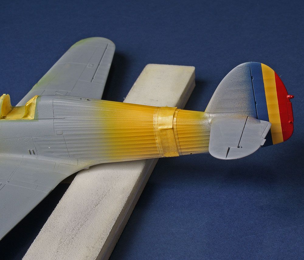

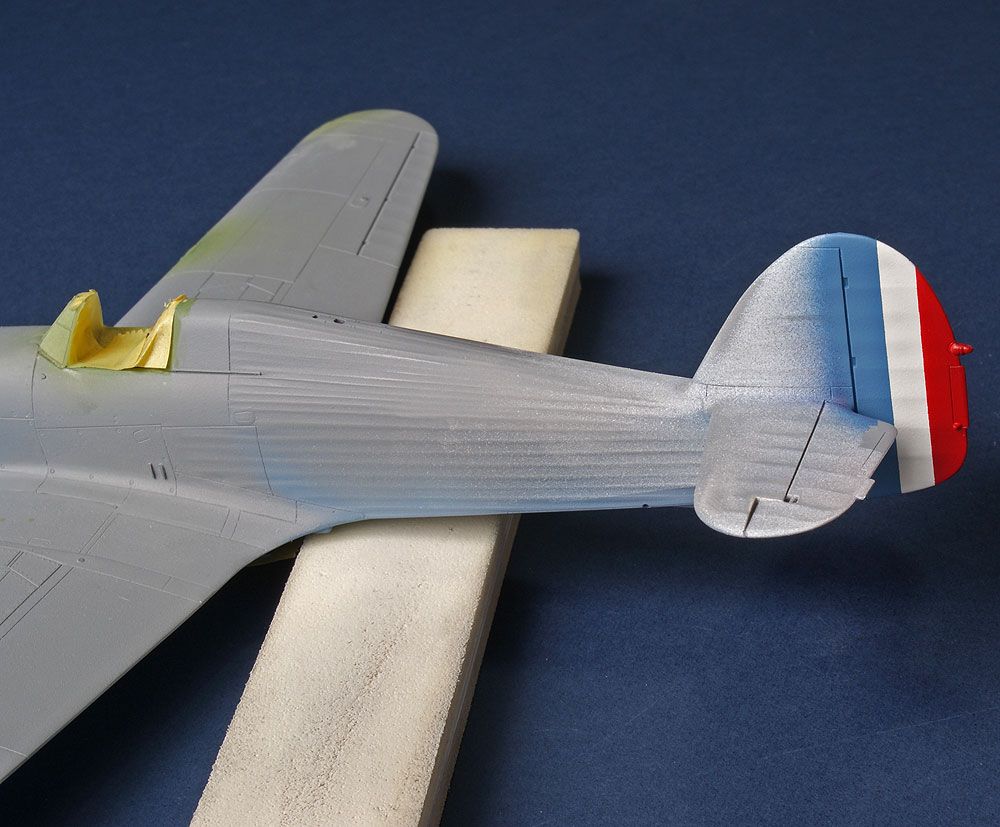

woody37 Posted March 2, 2014 Author Posted March 2, 2014 Got the rudders painted this morning, fiddly job that is! 2
stevej60 Posted March 2, 2014 Posted March 2, 2014 Great work so far can,t wait to see these two coming to completion.
Troy Smith Posted March 2, 2014 Posted March 2, 2014 Next step will be to spray the tail markings on rather than using decals, then there are some minor fuselage mods to take care of under the watchful eye of my uncle Troy! That Free French Mk.I (not the bottom one) looks to have a three tone camouflage which is unusual ????? wow Neil those rudder stripes look great. The apparent 3 tone camouflage on the FF plane looks like an artistic overpaint of previous RAF markings with fresh Dark Earth, note they are also seen on the other photo, note fin and pyramid shape on fuselage. The only fuselage work I can see some careful filing of the infamous 'join line in middle of fabric panel' http://data3.primeportal.net/hangar/mark_hayward/hurricane_mk1_l1592/images/hurricane_mk1_l1592_23_of_26.jpg But does mean a respray after so may be too much bother cheers T

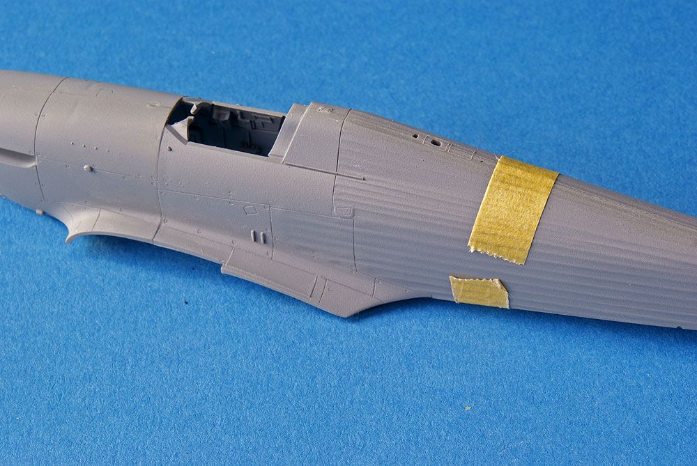

woody37 Posted March 3, 2014 Author Posted March 3, 2014 Cheers guys. Troy, the vents are now off and I've replaced the engraved panel line behind the cockpit with a strip of solar trim as you mentioned some time ago. The join under the fuselage beat me, I did what I could, so it will just have to stay. Fortunately it isn't on top! Occa, that's news to me about the crosses. If correct, I could always overpaint the decals with a fine brush, fairly basic shapes to cover. John, that was post shading mate. Never really got the hang of pre-shading. Just added some dark earth / white to the base colour to lighten some areas but then redid the panel lines with the base colour because I'd gone too far! Same with the white, I added a spot of black to the white to break it up a bit, just doesn't come out well in the picture. All masked up now but run out of paint, so awaiting a parcel Cheers

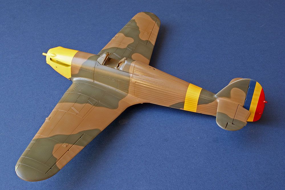

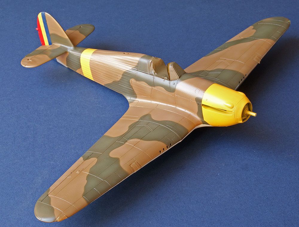

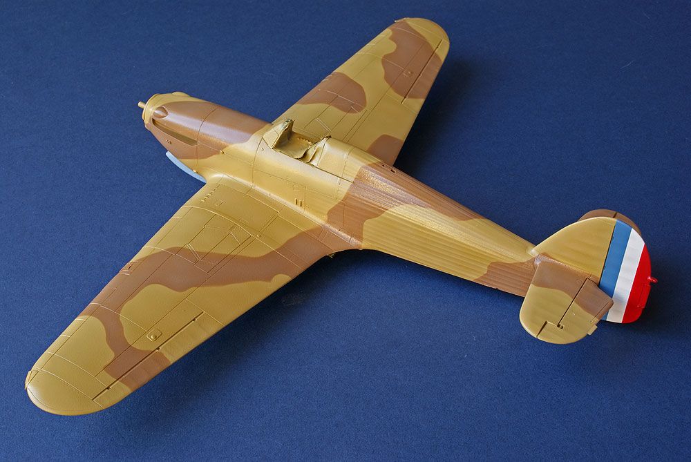

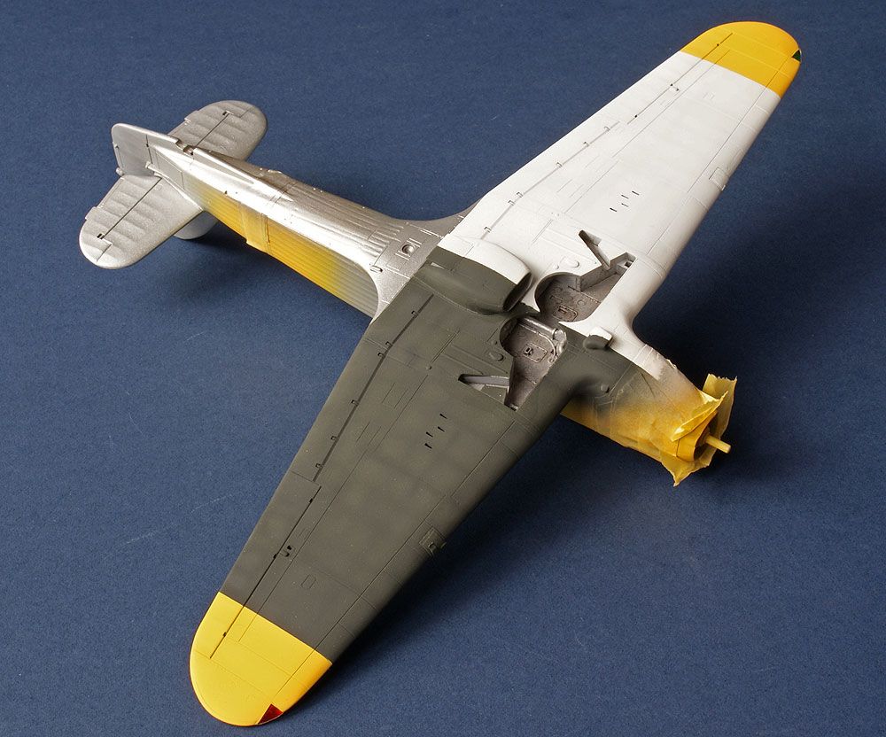

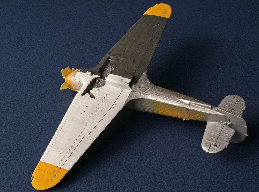

woody37 Posted March 7, 2014 Author Posted March 7, 2014 Managed to get some paint on this week and some Kleer ready for decaling and a wash, quite pleased with how the masking turned out, it's always a nervous step removing it all! 7
stevej60 Posted March 7, 2014 Posted March 7, 2014 Oh these two are turning into masterpieces,looking very impressive.the paintwork is outstanding.
Col. Posted March 7, 2014 Posted March 7, 2014 Those two look splendid in their new coat of colours. Top job as ever.
