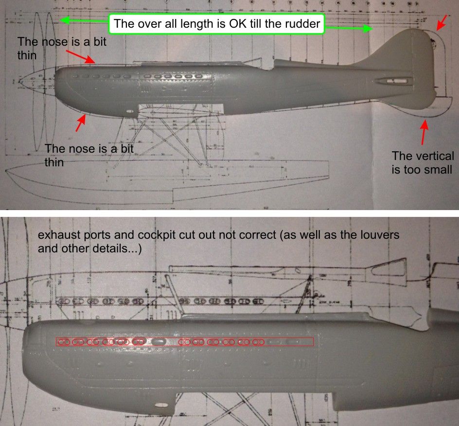

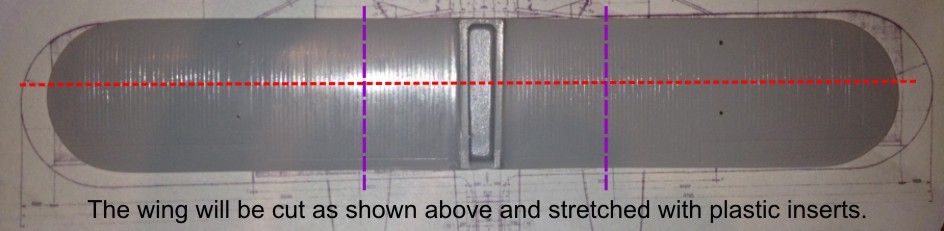

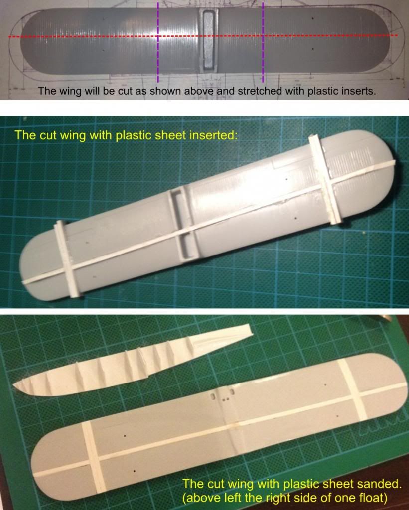

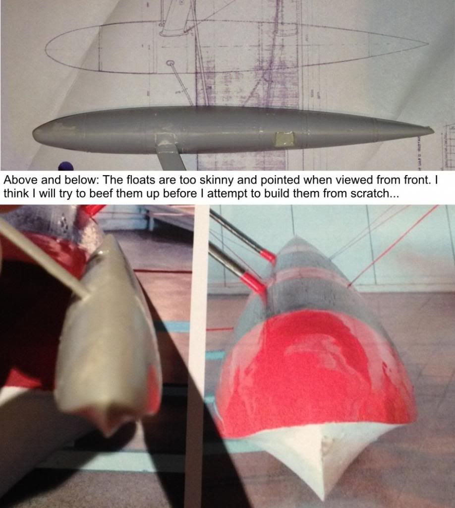

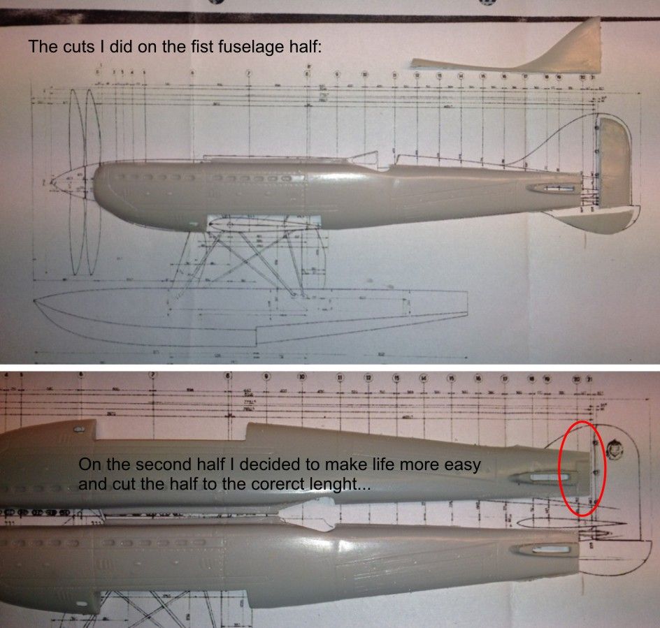

Caerbannog Posted February 11, 2014 Author Posted February 11, 2014 Due to some minor problem with my G-LYNX build in the Lynx GB I started to compare the kit parts to the Castoldi drawings as shown below. The issues are about the same as stated above. The fuselage is too short and the vertical needs complete replacement. The "hump" from head rest to vertical is larger and has a slightly different shape on the real thing too. Further more almost all engraved detail is wrong: Despite some thinning on the fuselage insides I started to cut the fuselage halfs to bring them to size: The wing is too small as well. I will cut it as shown below and insert plastic strips to get the dimensions right: The horizontal tails are completely wrong and will be scratched: The floats are going to be nasty as well. They are quite off and reshapeing them will require some elbow grease: Rene 2

CarLos Posted February 12, 2014 Posted February 12, 2014 What method will you use for the floats? If it was me I would balance between cutting them in half / insert plastic card / reshape and crush mold them twice (using first the float as a mold, and then the float with the extra thickness). Carlos
Caerbannog Posted February 12, 2014 Author Posted February 12, 2014 What method will you use for the floats? If it was me I would balance between cutting them in half / insert plastic card / reshape and crush mold them twice (using first the float as a mold, and then the float with the extra thickness). Carlos If I split them and insert plastic card the floats will become too wide at the underside as well and creat additional work there. So I plann to add plastic sheet to the top area only. If this fails I will have to build one from scratch but I do not think so. Depending on the maount of work I will then decide if I recast the one float (would that be OK with the GB rules here???) or build a second one. Rene
Caerbannog Posted March 10, 2014 Author Posted March 10, 2014 OMG one moth past already and not much done on this one. Yesterday evening I cut the wing lenghtwise and inserted a 2 mm plastic sheet to bring the wing to the correct length (in flying direction). Tonight I will add two further cuts and insert 7 mm plastic to get the right spann. Thus prepared the wing will join me on a busines trip to get sanded to shape. I will also try to fix the floats on this trip. Mor on this when I return in two weeks. Rene

Caerbannog Posted March 16, 2014 Author Posted March 16, 2014 Hi from Pakistan. So wing is cut and shut and sanded (underside in Bangladesh, topside in Pakistan - there is not much free time on this trip). But I need to apply some filler which I do not have with me, so some more work on the wing is waiting when I return end of next week. Pics of the wing will follow. I hope to do someting on the floats and or tailplanes the next days. Rene

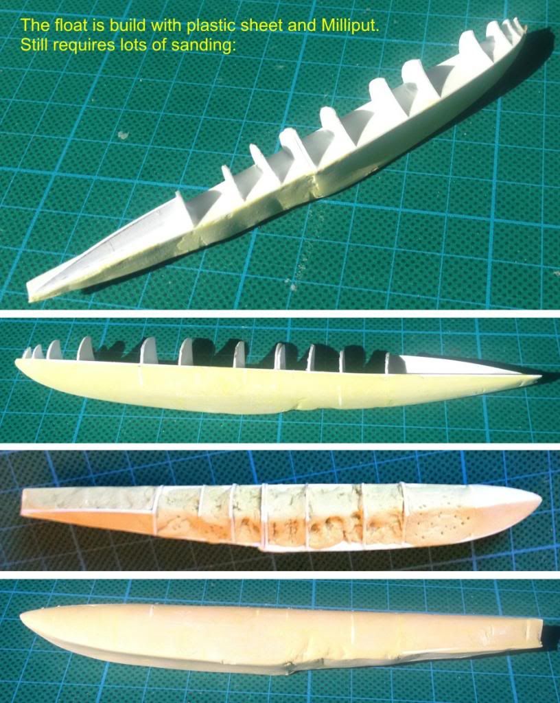

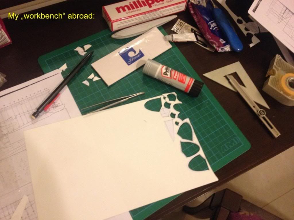

Caerbannog Posted March 24, 2014 Author Posted March 24, 2014 Thanks Mark! I returned and here is what I have done abroad. First pic shows my hotel man cave: I am really happy I took the tools and parts with me as I did way more progress there than at home. My goal was to get at least the wing done, which is not that much work but includes long sanding (boring...). Just for good hopes I took Milliput with me for the case I can start on the float master (I plan to cast it). So here is the changed wing: The wing is done so far - only the coolers are still missing. I have three ideas on how to do these (decals, scribing embossing thin sheet metal). With the wing done I started on the float: There is still some sanding needed but I did much more progress on this than I expected... ... So I started the scratch horizontals as well: Meanwhile these are sanded to shape but I did not take a pic. Will follow later. So the next days I will be busy finishing my Lynx. More work on the MC.72 and S.6B in about two weeks. Rene 1
