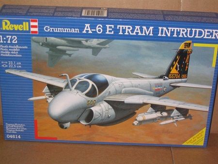

Revell subsequently reboxed the Italeri kit in the mid 90s (kit 04614).
