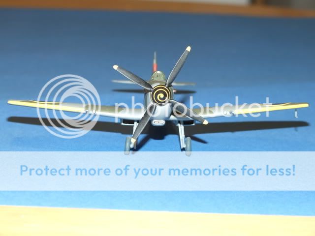

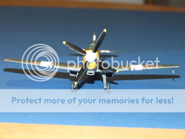

Yes, Hasegawa did a Mk.VIII. The Mk.IX kit was designed to allow a Mk.VIII to be made easily just by changing a few bits: pointed rudder (also present in some boxes of the Mk.IX) and retractable tailwheel. IIRC some boxings also included the extended wingtips.
A number of features of the Mk.VIII were however not present: the ailerons needed some filling (the original configuration allows both the IX and the VIII depending on which lines are filled) and the panel lines for the wing leading edge tanks need scribing.
This is the Hasegawa kit practically straight from the box apart from the tanks scribed and the ailerons sorted (and aftermarket decals):
Speaking of the Hasegawa kit reminded me of what seems to be a common "issue" in several kits, for example the Hasegawa, Airfix and italeri ones: these feature a large bulge on the wing that is only present in aircrafts used postwar, therefore needs removing for 99% of the subjects reproduced. In the picture I posted the bulge has been removed
Link to comment

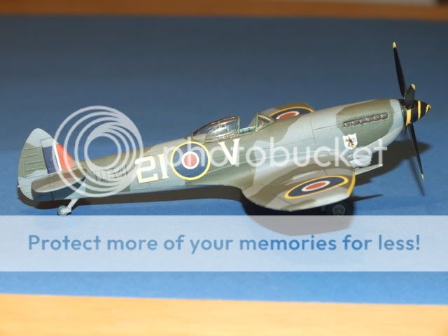

Here's what I've found with 1/72 Spitfire IX and XVI kits. I'm not too concerned by accuracy as all the kits I've built look enough like Spitfires to me, I'm more concerned with how they build and the detailing.
Airfix new tool - on the plus side it goes together really well and isn't too expensive but for a new tool kit the level of detailing is very disappointing. The cockpit detailing hasn't improved on old style kits, there's no detailing in the wheel wells and the panel lines are quite deep. In short, if you didn't do any weathering, it will look like diecast model when built oob.
Italeri - (this also applies to the Mk VII) Nicely detailed and cheap! However, they are really horrible to build and as others have said, require a lot of filler, sanding etc. To be honest, I would avoid them.
Hasegawa (Mk VII, VIII, IX) - Easily the best detailed and best to build of the more mainstream manufacturers Spitfires. I've not managed to get a VII or IX but have built 3 Mk VIII's. Despite the accuracy issues, I would recommend this kit to anyone like me that isn't too bothered if it's mm out here or there, simply because it's a nice kit in other regards! Problem is finding them and when you do find them, they aren't cheap. 3D kits do a late Spitfire IX conversion set for the Airfix Mk IX but the Prop and late style rudder will fit on the Hasegawa kit, I know as 2 of my Mk VIII's have had this treatment!
Heller Mk XVI - I got one of these a few years ago, what a horrible kit! I think the moulds are past the best. Mine was mis-moulded and ill fitting. It's an old style kit and cheap but I think it's better spending money to get a decent kit.
KP (Mk VIII) - Old style kit like the Heller one but not as badly moulded. It's cheap and not too well detailed. I painted it to the same standard as my Hasegawa kits and the Hasegawa models looked far nicer built up.
Sword (IXe, XVIe) - Sword do a LF Mk IXe and XVI (highback and bubble canopy) and they look very nice in the box. I've not built mine yet but if they are as good as the other Sword kits I've built (Spitfire Vc, PR IV and Re2001) then they won't be too difficult to build, although not as easy as the Airfix or Hasegawa kits. Detailing is of a high standard.
AZ Models (IX, XVI) - I've not got any of these but if they are a similar standard to the new Bf109G series they have just released, then they'll be extremely nice! Be warned though, the similar Mk VII and VIII are not of the same standard, using older moulding technology.
My conclusion is that if you want a good Spitfire IX or XVI, spend the extra. You may pay more for the Hasegawa (if you can find them!), AZ Models or Sword but in my experience these are far better kits than any others currently available. If you really don't want to spend the money, then I would say go for the Airfix one unless of course you enjoy making hard work of things!

Head-on view:
Oob shows original radiators and (rather nice) propeller blades:
Modded shows reduced height rads and (less nice) prop blades:
Side view:
Oob shows 'flat' upper cowling contour, high fin, slightly too stumpy spinner, under nose contour and carburettor intake (rather bulky):
Modded shows my attempt at scribing, adding the 'Packard bulge' to the upper cowling contour, reduced fin height / replacement rudder (3D kits), alternative longer spinner, Hasegawa undernose cowling and carburettor intake:
It is often mentioned that the Heller kit undernose contour is 'pigeon breasted'. I must admit, comparing the two photographs I can't see a definitive difference to the Hasegawa pieces. Could it be an optical illusion caused by the too bulky and too far forward carb intake, and the slightly stunted spinner? Discuss . . .
As you can tell from the photos above, despite some minor differences, the basic Heller kit still looks very much like a XVI. With some relatively simple and cheap mods, it can be made into a nice representation imho.
