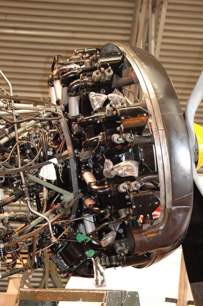

swordfish fairey Posted December 1, 2013 Share Posted December 1, 2013 This is what it should look like.......... MkI Swordfish W5856 RNHF Smudge 2 Link to comment Share on other sites More sharing options...
