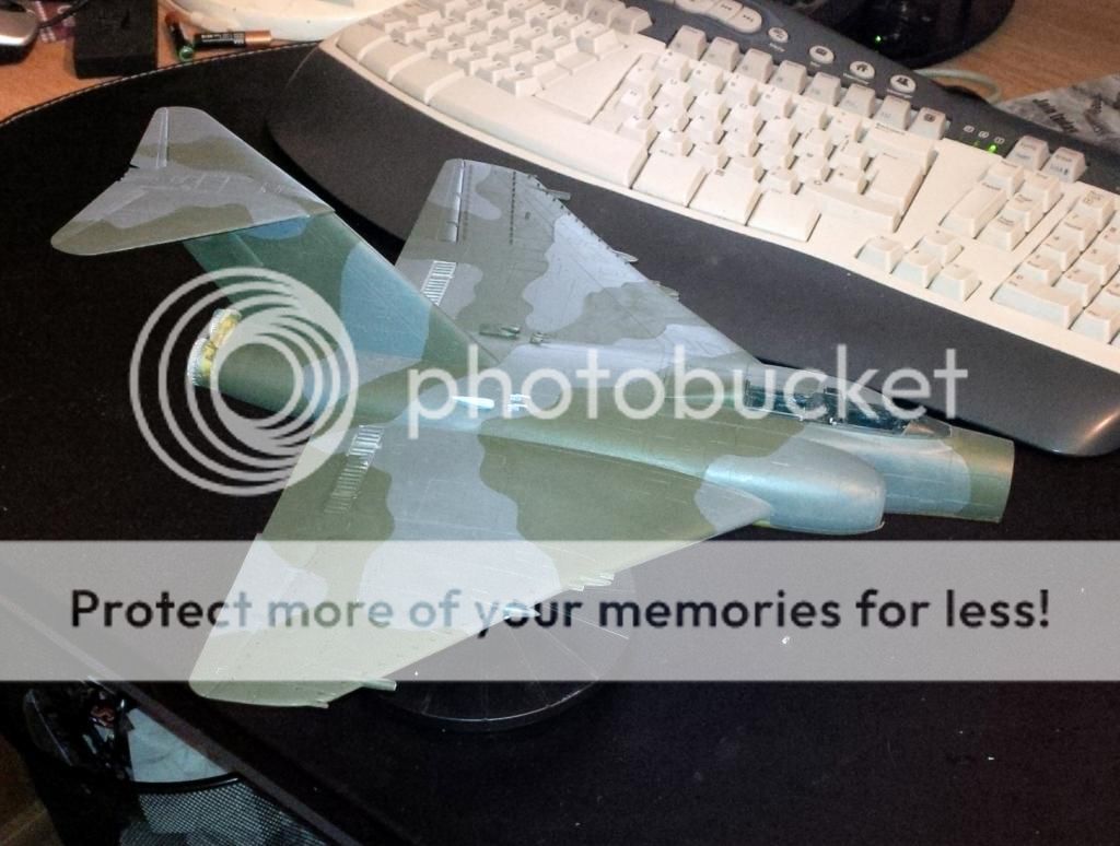

SLoB Posted November 13, 2013 Share Posted November 13, 2013 Tony I have painted most of mine (hairy stick painter so got odd bits to finish off) and if care is taken with cutting, fitting, filling and sanding it may be possible to simply paint the new parts and gradully blend in. Or am I being too optimistic about a) how easy it might be and/or my skills I am thinking: 1) that cutting off the vortices is no big deal and clean up should be OK if care is taken 2) cutting out the wing leading edges should not be too much of a big deal 3) not sure what the tail changes will require and it is this that troubles me most 4) not sure if there are other chagnes that might be easy/problematic The whole reason behind this is that I want to depict the 228 OCU squadron that my dad served in (as armourer/general ground crew) when Javelins first arrived there, but when I started the build any conversion set seemed a way off. I am also not sure I could get past SWMBO a second Javelin! (they are a bit big to hide). For these various reasons it may be a while before I get another Javelin to have a go at. I am therefore keen to try to fit the conversion to what I have built. The pic below gives an indication of how far I have got. I suspect I am not the only one who has started one of these and now wishes they had waited If someone could give an indication of how practical it might be to make the changes at this late stage I would be grateful. Thanks. P.S. I hope I am not hi-jacking this thread - sorry if you think I am. Link to comment Share on other sites More sharing options...
pigsty Posted November 13, 2013 Share Posted November 13, 2013 Personally I think if you're at the "last few bits to add" stage you're too far along to convert your Javelin. Nose: if your preferred Mark has the UK radar, no worries. If it has the US radar you're in a spot of bother - you have to remove the forward fuselage as far as the intakes to fit the replacement part. With enough care it might be possible to trim the replacement parts down to just the mounting ring for the oblique-hinged radome, but I wouldn't relish it. Wings: you have two bits of cutting out to do to the leading edge if you're after any model earlier than the FAW.Mk.8. That should be possible but it will take some care. Removing the middle row of vortex generators should also be OK. Tail: to fit the pen-nib fairings (or the different tail of the FAW.Mk.7) you'll be cutting away the aft end to just ahead of the trailing edge of the rudder. But you'll also have fitted the exhaust ducts by now, which will probably make the task of connecting the new bits quite tricky. Best thing is probably to look closely on the A2Zee website at what's on offer, and judge for yourself. Link to comment Share on other sites More sharing options...
SLoB Posted November 13, 2013 Share Posted November 13, 2013 Sean I suspect you are correct. I have looked at the website and I think it is the tail that is the problem, as you say. Seems like I will have to get the conversion set and then see about another Javelin kit in due course. Thanks for input. Link to comment Share on other sites More sharing options...
