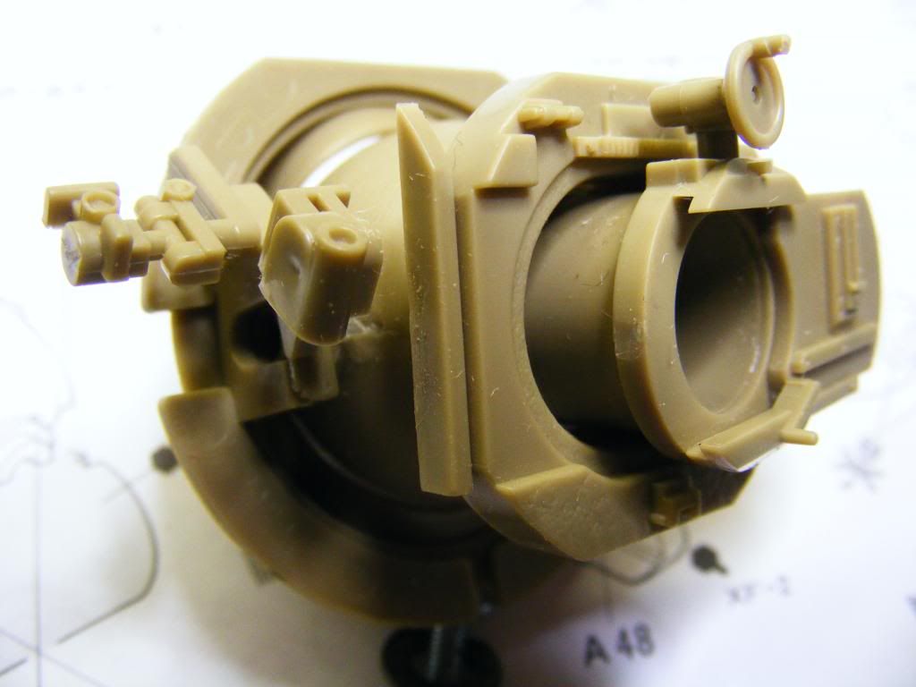

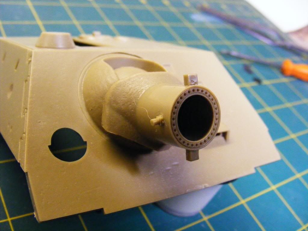

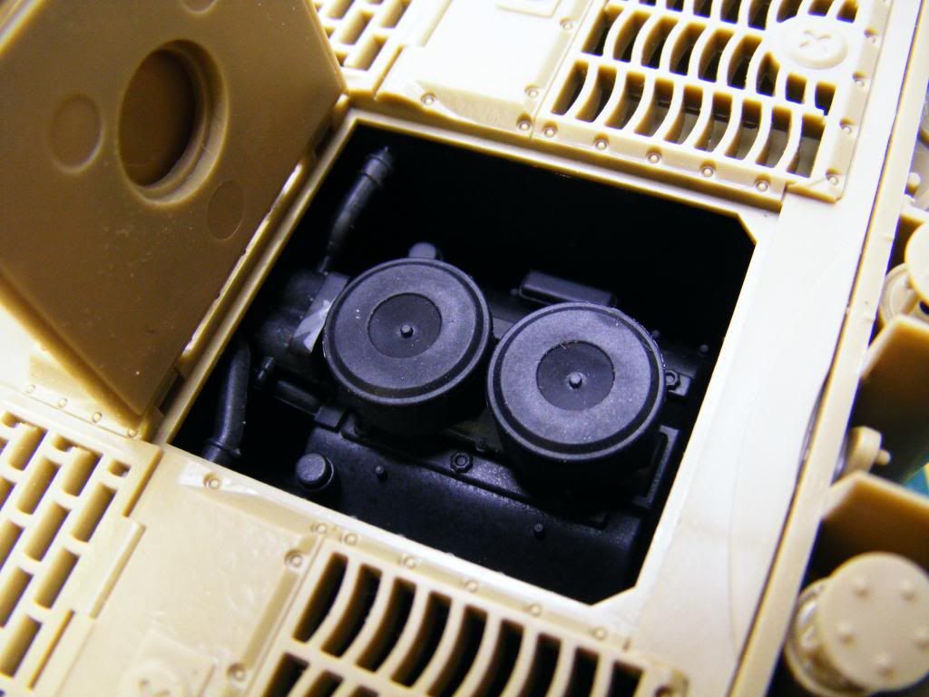

Precision Ice & Snow Posted November 2, 2013 Author Share Posted November 2, 2013 I kid you not, the dust is original and the boxes are out of the loft and where tucked around the house. The Schnellboot came to a halt as it was purchased with full etch which would have made it top heavy for water. The original idea was to make it full R/C with working Larsen effect, lights, moving everthing, sound, you name it. difficult to do with full etch though as it is so delicate. Anyway, I started the Sturm tiger below as I wanted to dio it with the emphasis on landscape, weathering etc. Then I came to a halt because I realised I could detail the interior......... I wanted to get on with the exterior really, in the last pic I have included a detail of a Bovington Tiger with nice mesh grills which I intend to scratch build when I get around to loosening my dilema 3 Link to comment Share on other sites More sharing options...

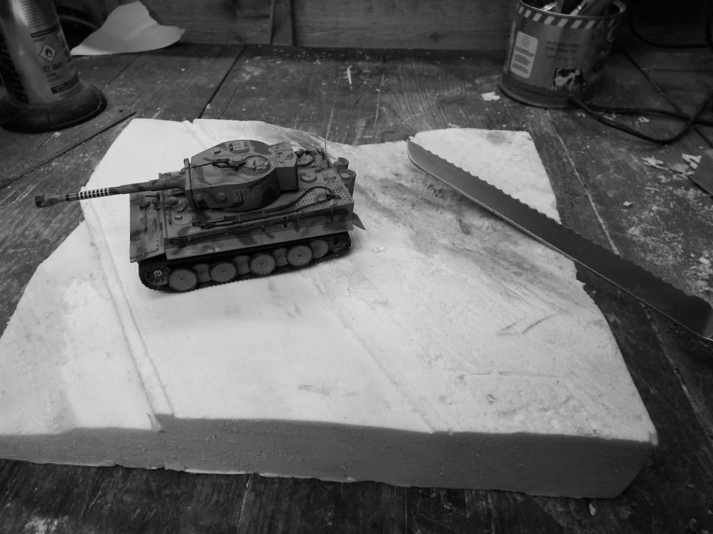

Precision Ice & Snow Posted November 2, 2013 Author Share Posted November 2, 2013 Anyway, I recon the safest thing to do is leave it rather than having a muddled build and move on for the moment. So here we go, as a destraction while my mind sorts itself out I'm going to do the craftspersons trick. Just leave it for a while and by next weekend I'll know what to do with the Sturmtiger, I hope...... This little Tiger is 1/54th scale. I can use it to experiment with where I want to go with the Tiger dio in the future. It won't take up much time or room and will be fun to do............... I have marked out the insulation board with a canal to the front, the tiger is sat on a paved road and behind it and lower will be a water course. 1 Link to comment Share on other sites More sharing options...

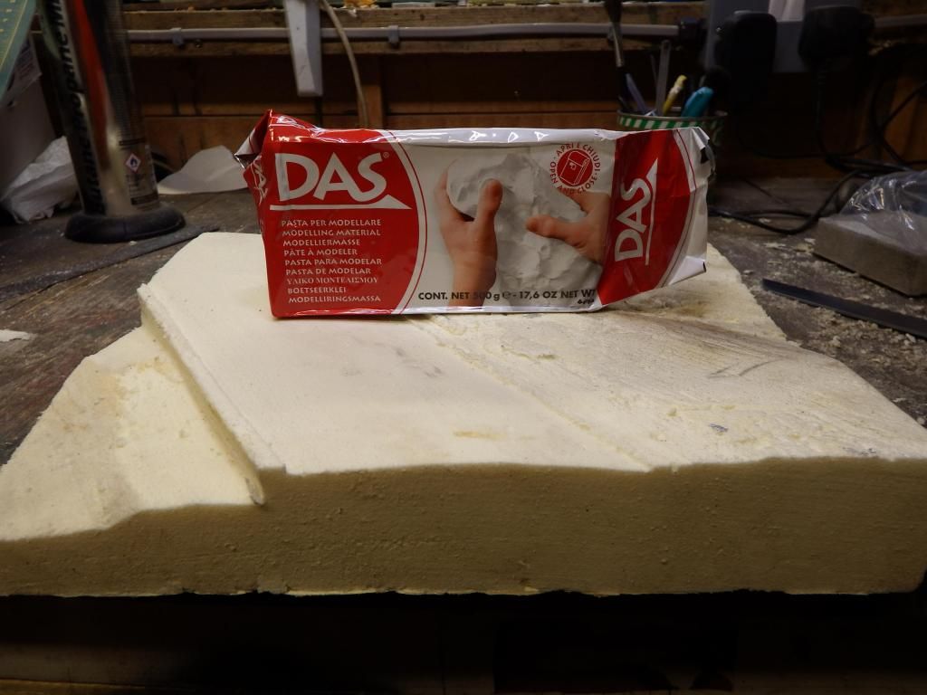

Precision Ice & Snow Posted November 2, 2013 Author Share Posted November 2, 2013 I borrowed a bread knife to carve the foam roughly as it does not generate to much crumb with its sharp blade. perfect, just dont tell anyone indoors! You can see the form of the landscape starting to form.... 1 Link to comment Share on other sites More sharing options...
Precision Ice & Snow Posted November 2, 2013 Author Share Posted November 2, 2013 I'm going to use Das as I can keep it workable for as long as I want and then harden it as the stages progress. 2 Link to comment Share on other sites More sharing options...

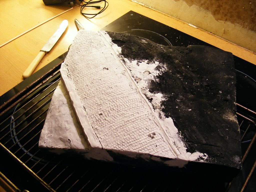

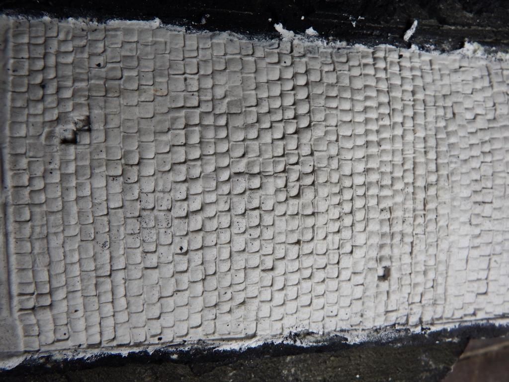

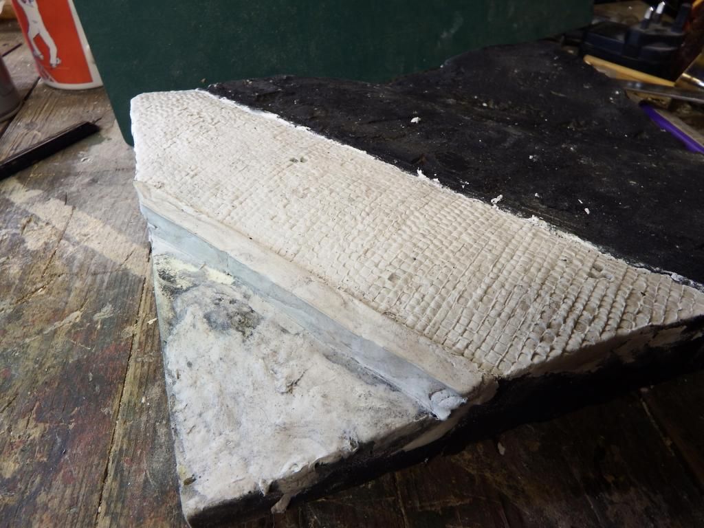

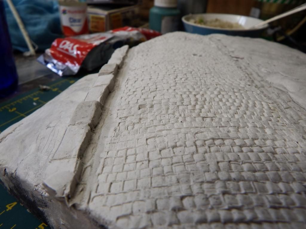

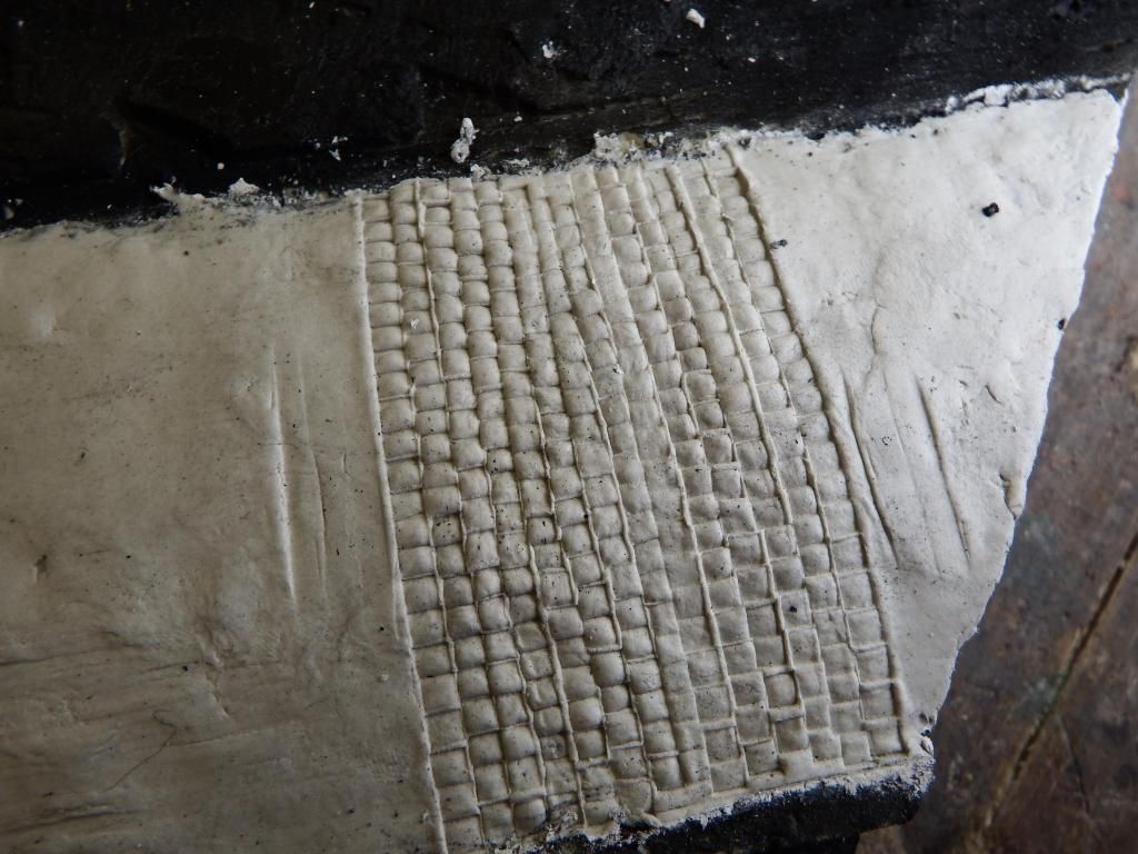

Precision Ice & Snow Posted November 2, 2013 Author Share Posted November 2, 2013 I have sprayed the foam first with matt black acrylic car paint to stabilize it. It is easier for the Das to stick like this this. Also, I used water to slurry the Das which is then smeared hard over the foam to get good adhesion before layers are built up. I am imprinting the basalt setts with a tool that I have made. At this scale they would be 4-6 inches square. Not an unusual size in europe. They are roughly put in at this stage but I will return to them to tidy them up later.... 2 Link to comment Share on other sites More sharing options...
Precision Ice & Snow Posted November 2, 2013 Author Share Posted November 2, 2013 More setts in place, some are bunched tight together and some are more iregular with with soil etc over the setts shoulders. I have punched some of the setts through so as to create gaps. I real life, when setts work loose, debris starts to get underneath and eventually the setts will be pushed out like loose teeth. Even out of the middle of panels of paving. Some of the proud areas around the shoulders of the setts will get the green moss, grass treatment later. 2 Link to comment Share on other sites More sharing options...

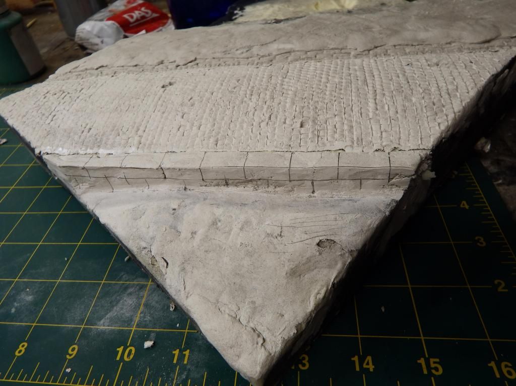

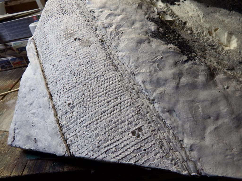

Precision Ice & Snow Posted November 2, 2013 Author Share Posted November 2, 2013 I finished the setts for the moment, so i started the canal to the front.It will be constructed from ashlar blocks eventually, the top of which will be just above the height of the adjacent paving. There will be drainage channels to relieve the camber from the paving. The canal is shallow towards the bank which is a common feature which is why tyou can sometimes see abadoned bikes etc just below the surface. 3 Link to comment Share on other sites More sharing options...
robvulcan Posted November 2, 2013 Share Posted November 2, 2013 Thats excellent love how you have use the DAS, how did you create the tiles so fast ? The tiger looks nice too, Will be watching this one with interest. I am getting really keen on the idea of doing some Armour stuff. it looks fun. Cheers Rob Link to comment Share on other sites More sharing options...
Precision Ice & Snow Posted November 2, 2013 Author Share Posted November 2, 2013 This will do for one evening, time for the oven! 1 Link to comment Share on other sites More sharing options...

Precision Ice & Snow Posted November 2, 2013 Author Share Posted November 2, 2013 Ho, Hum, that was close, I forgot I was cooking something The base board has actually distorted a little and is not level now such was the heat.. However, the Das has hardened like carveable hard cheese and is stuck to the base board like glue with no distortion, cracking or delamination. can there be a quicker way to build up a dio. Perfect, thats enough for one evening, see you soon. Lurcher1 1 Link to comment Share on other sites More sharing options...

Precision Ice & Snow Posted November 2, 2013 Author Share Posted November 2, 2013 The trick with the imptinting is to use the right wood for the tool, not to have the Das to sticky and to use a straight edge across the paving as a guide as you work. Das is good because it stays workable until you want to hit it with heat to stabilise it so to speak. When I was off for tea and things though I would reccomend covering it with cling film or suchlike to retain its pliability. The speed thing is just a knack as I used to make archtectural models. Thats excellent love how you have use the DAS, how did you create the tiles so fast ? The tiger looks nice too, Will be watching this one with interest. I am getting really keen on the idea of doing some Armour stuff. it looks fun. Cheers Rob your welcome. so what else for this dio. buildings, trees, etc ? Dunno yet. 1 Link to comment Share on other sites More sharing options...

Jaykay Posted November 2, 2013 Share Posted November 2, 2013 Hello lurcher, liking this thread a lot. I'm working on a berlin dio at the mo (have been for about 8 months and not much progress), so loads of cobbles. It's in 1/72 and I'm cobble budging in a similar way, using the ferrul of an old brush, but struggling to make me small enough and fast enough before the DAS dries. How much water are you using to mix with the clay? Look forward to next post, Jk Link to comment Share on other sites More sharing options...

Precision Ice & Snow Posted November 3, 2013 Author Share Posted November 3, 2013 Hi JayKay, thanks for your positive post. I am working in cool conditions and that may help but it does take a long time and keeping the Das workable can be a pain. I always keep it covered when I'm away and of course my baseboard is non absorbant which helps. A good trick is to get a small plant handsprayer and set it on fine and give the stuff a few squirts before storing it under polythene. Are you using the same stuff as me? You have my respect for working cobbles in 1/72 I generally only mix water to get it to stick to the baseboard, as a sort of key I suppose as the insulating board dosent like anything stuck to it at all. When i do this it really is like a thin gooey slurry. Cos I'm imprinting with a concave square wooden thingy if its too wet it tends to go horrid. So I like my Das on the top to be like plasticine in consistency. If I can be of any help get in touch....... I'm out to the workshop now for part 2. Lurcher1 Hello lurcher, liking this thread a lot. I'm working on a berlin dio at the mo (have been for about 8 months and not much progress), so loads of cobbles. It's in 1/72 and I'm cobble budging in a similar way, using the ferrul of an old brush, but struggling to make me small enough and fast enough before the DAS dries. How much water are you using to mix with the clay? Look forward to next post,Jk Link to comment Share on other sites More sharing options...

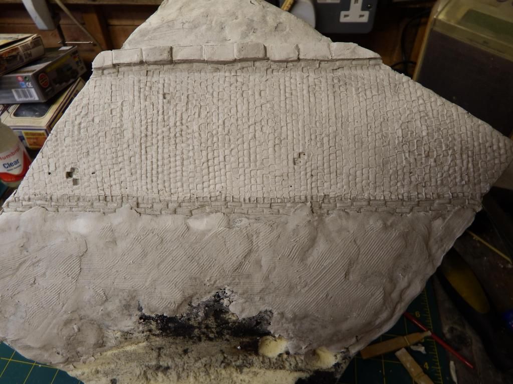

Precision Ice & Snow Posted November 4, 2013 Author Share Posted November 4, 2013 OK, I'm back, worked till midnight last night, nice and snug in the workshop though with an oil filled radiator. Winter was definatley here last night.............. Out comes the carving knife again, I wasn't sure how to tackle this side of the paving so left it proud so I could carve it if I wanted. In the end, I had a different plan. So the raised lond bit has to go....... After some lengthy printing with another wooden die I printed some long retaining setts along the edge....... Then I turned my attention to the other side adjacent to the wall, I wanted more of the same really along the walls base.......... You can see where I have cut out the old scruffy paving showing the foam. I always knew that I would be making these changes for the better. You can see the new paving in a couple of pictures but now I started to mark out the masonry blockwork for the canal wall. This bond is called ashlar and is very common....... In this pictures below, I have started to incise the joints between the stone blocks and carved them so they have slighlty different inclinations. Also I have changed the bulk of each stone to give it individually. (every stone has it's own life and story) 2 Link to comment Share on other sites More sharing options...

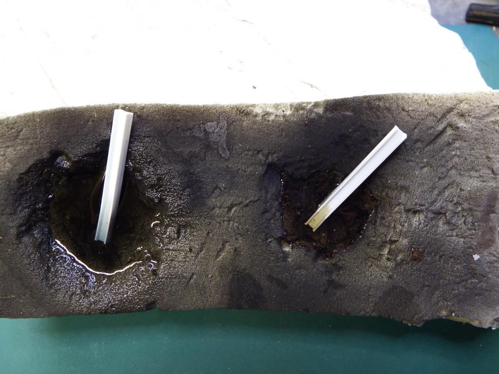

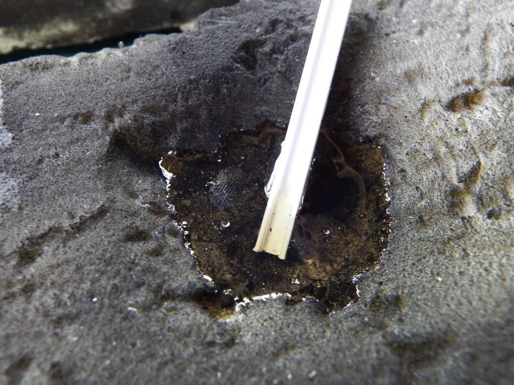

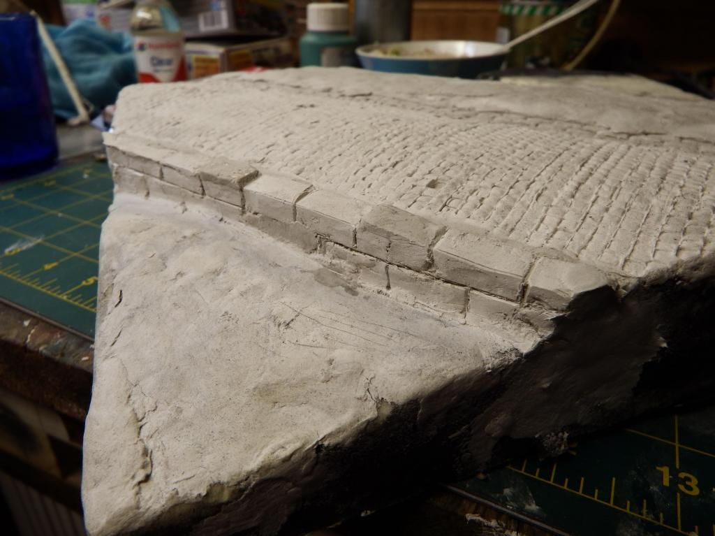

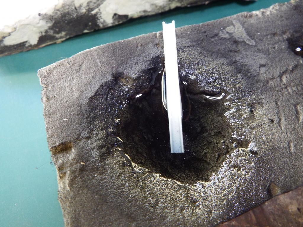

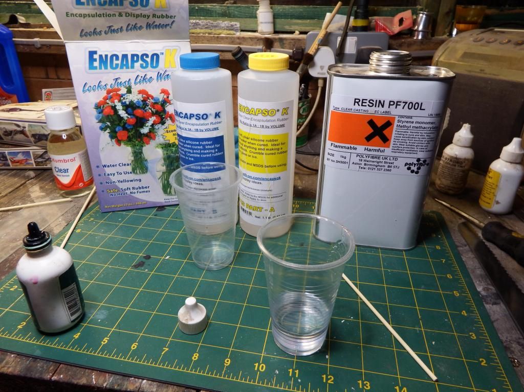

Precision Ice & Snow Posted November 4, 2013 Author Share Posted November 4, 2013 I'll put some better pics of the new paving and wall later. I have carved the front of the blocks also so that there are subtle differences in their orientation. Now comes the exciting bit. There will be two frozen water features on this dio. The canal and the water course lower down and iregular. I intend to use one of two 'miracle' products which are abound everywhere now. Fiorst though i need to terst them so I know what they are capable of and what damage they might do to the baseboard and styrene I used the products below as you cane see....... And, I arranged the tests as you can see below. Two shell holes filled with one of each mix and two containers, each with a bit of styrene steel column in............... Fingers crossed............. Its a miracle The base board has not disolved over night...... Even with the styrene on the right hand side......... The styrene girder, is still there and intact...........Yes!, Yes!, Yes! I'm so happy........... 2 Link to comment Share on other sites More sharing options...

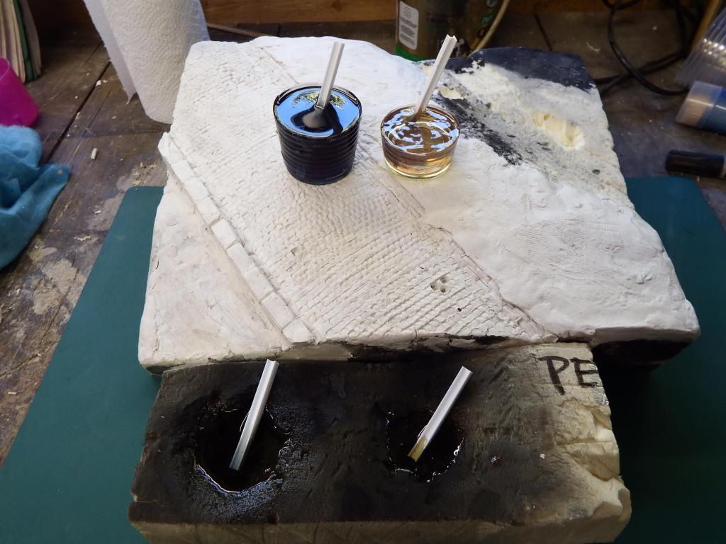

Precision Ice & Snow Posted November 4, 2013 Author Share Posted November 4, 2013 This one is the PE, or polyester......... This one is the stuff florists use for flowers etc............ I tinted the resin before casting it. I'm after a clear brackish look, kinda browny green in colour like you get in rivers in the south west of England cos of all that peat. Crystal clear but tinted.......... Now I know that both resins will not disolve my work what next. Well, I have now got to choose. The flower resin has a gorgeous ability to creep up the perimeter of the shell hole natrually making it look damp and boggy and very, very wet. The polyester has a cleaner edge with less creep, but the surface is rippled more and not so flawless.................. We will see............. I have now got to introduce my water to my dio.................. Fingers crossed 2 Link to comment Share on other sites More sharing options...
