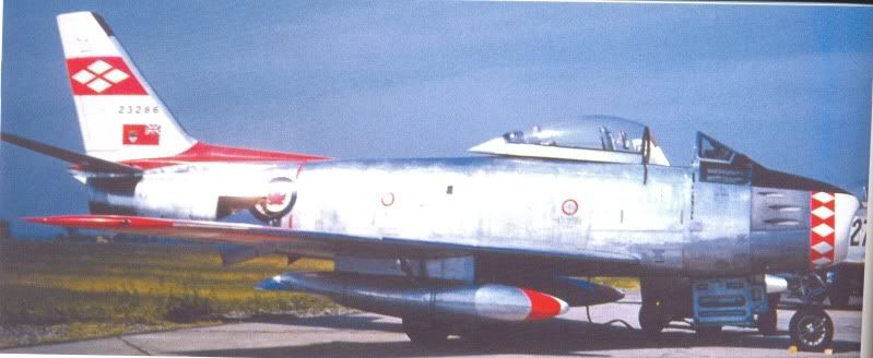

James Craik Posted November 1, 2013 Share Posted November 1, 2013 You could try this R.C.A.F.Canadair Mk5 (F-30) http://i47.photobucket.com/albums/f179/sabresix/F-86Mk5Lancer1.jpg Link to comment Share on other sites More sharing options...
