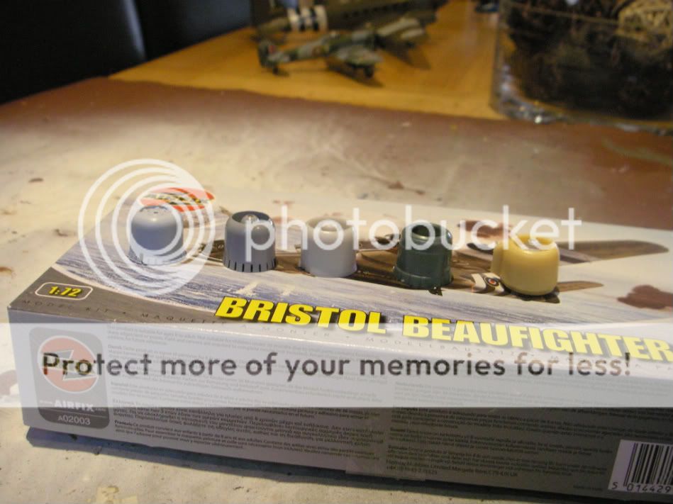

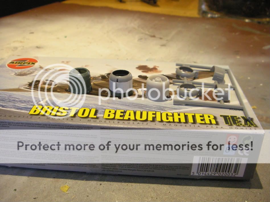

mike romeo Posted October 18, 2013 Share Posted October 18, 2013 (edited) I thought you might like to see the differences between another contentious area on Beau kits: the cowlings. L to R: Airfix, FROG, Airfix Halifax, Matchbox and Aeroclub. It's possible to get a reasonably shaped cowling by cutting the front off the Matchbox version (at the rear 'step'), glueing on one of the spare collector rings from a Hasegawa kit and wrapping the sides of the cowling in thin styrene sheet. That's what I used on my build of the Airfix kit. Of course, if you do that, the nacelle looks very 'wimpy' and I built mine up with milliput. Doing that of course emphasised that the wing is short in chord and span - a very good reason imho to steer clear of the Airfix kit. regards, Martin Edited October 18, 2013 by mike romeo Link to comment Share on other sites More sharing options...
