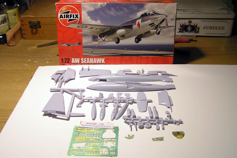

OK, at last. After the 1/9 Bianchi bicycle I am in for the GB with my 1/72 Airfix AW Seahawk from a modern release gift set. The moulds are very much the original from about 1959. I have the Airwaves set for the MPM model, which I think I can adapt, the Aeroclub white metal seat and (not shown) the Falcon vacform canopy.
I have lost the original injected canopy and I have never done a vacform canopy before; oh yes, and you only get one vacform in the FAA set which I have. Best I don't mess up then, especially as I want it show it open. There will be no extra detail in the wheel wells, I will just box them in. I will try and do something with the aftermarket for the cockpit as it will be on show even if I don't open up the canopy. Now, just to prove it is all in bits, the picture:
The kit decals will be used, though I know they are translucent and will need some backing when they go on. That's all for now, good luck to all GB-ers.

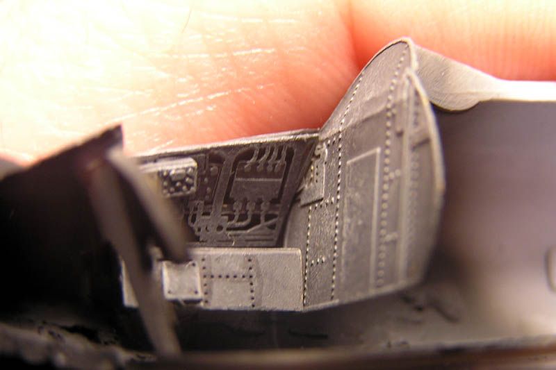

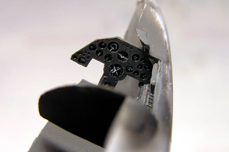

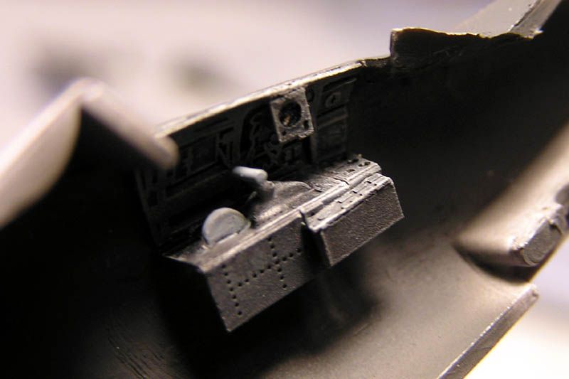

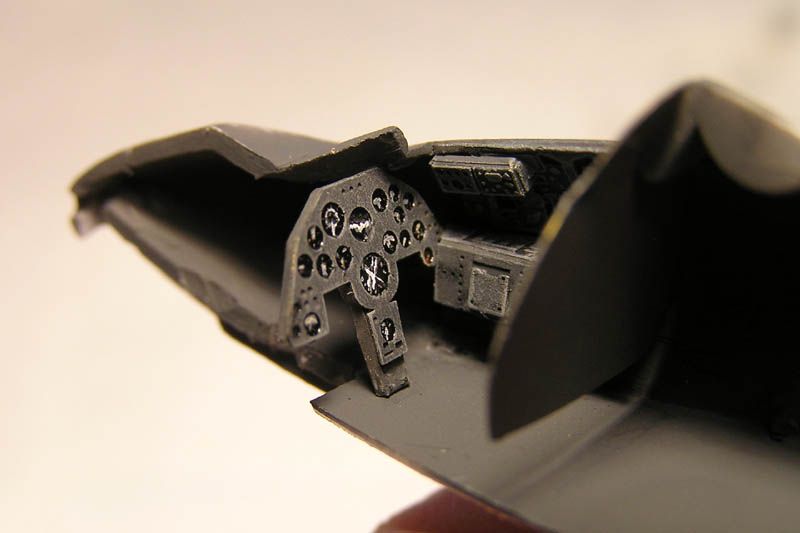

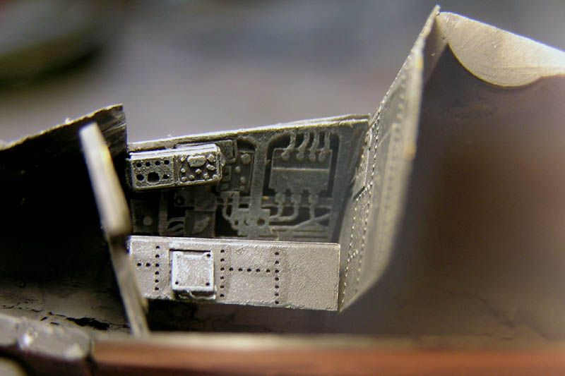

So, after a week of no modelling I managed a bit this weekend. I have the fuselage closed up now and awaiting a bit of clean up; and a bit of a scribe if I feel brave. The cockpit interior was done with the photoetch for the MPM kit as I picked it up really cheap at a show. I know there's an etch set for the Airfix kit, but that's no challenge is it?!

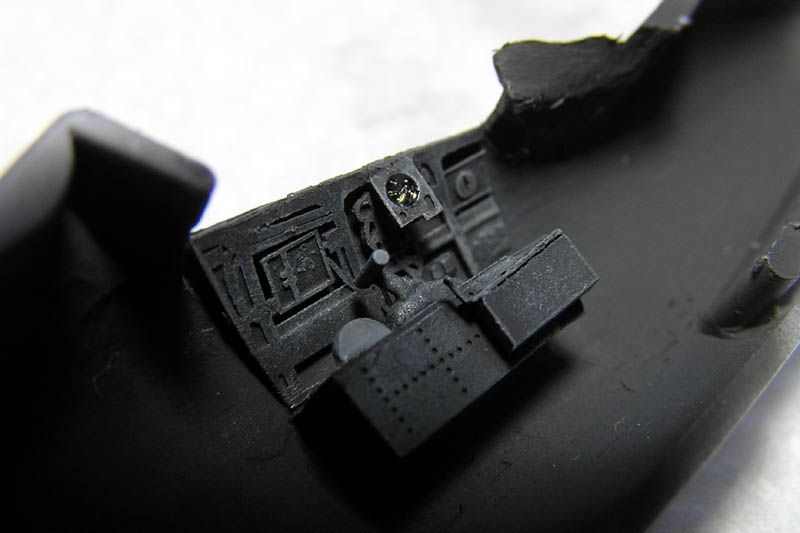

The wide shelves at the sides of the cockpit were narrowed with a scalpel and thinned with a dremel. The rear bulkhead didn't fit so I cut a couple of small slots with a razor saw at the back of the cockpit for it to slot in to and allow the fuselage sides to close, job done. The interior is painted with Humbrol German Grey and dry brushed a couple of grey shades, and I have lightened the pictures quite a bit so you can see the detail. The coaming has been cut back a bit, but more may be required to take the gun sight when I come to fit that later.
The instrument panel was fitted to an offcut of plasticard which was then shaped, the instruments being painted with a fine brush and 'glassed' with Klear. The cockpit floor was scratched from sheet. I have an Aeroclub seat to fit, but that will go in towards the end of the build.

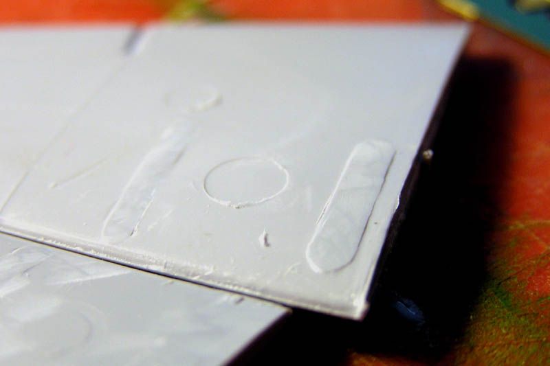

The wing pylons are rubbish, so of they came. As you can see below, the sanding to smooth the remains of the pylons needed to take care of the ejector pin marks and the seams on the leading edge too:

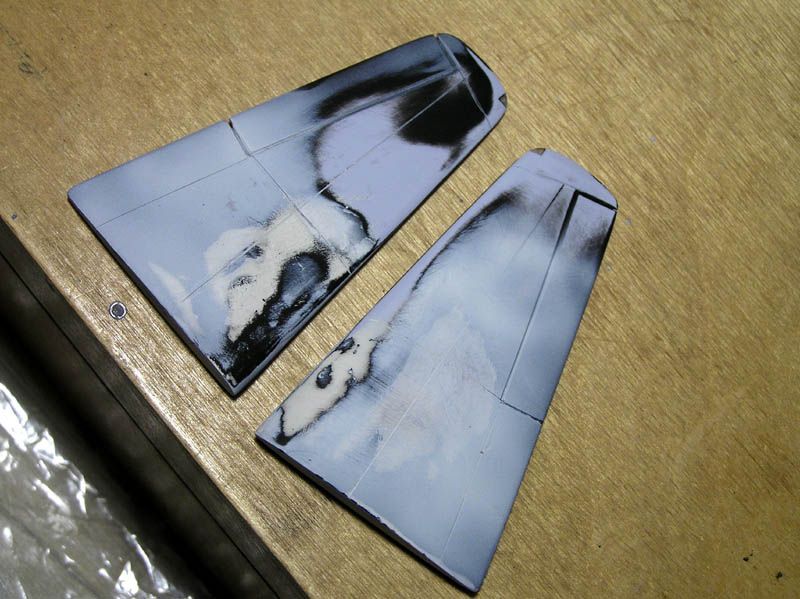

The wings are not the only parts with awful ejector pin marks, witness the underside of the tailplanes:

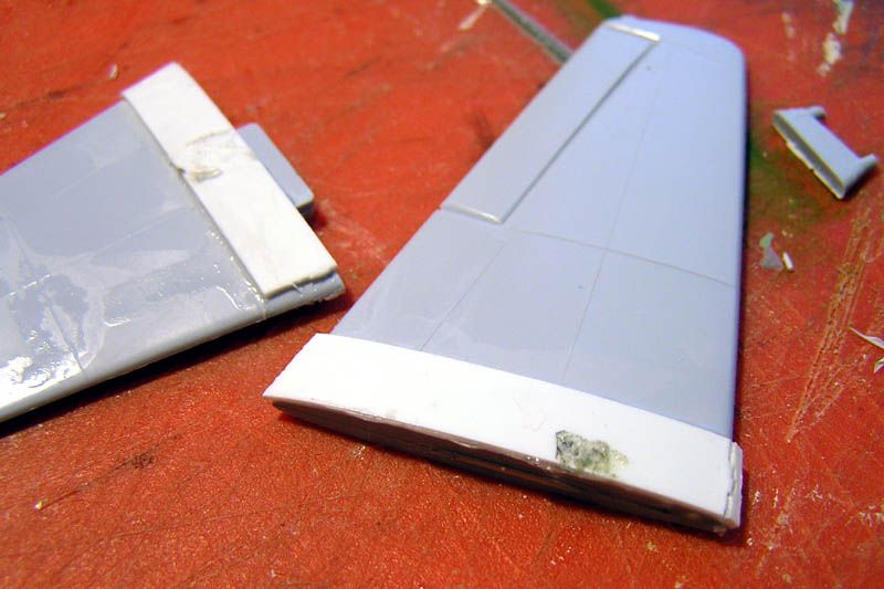

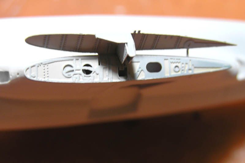

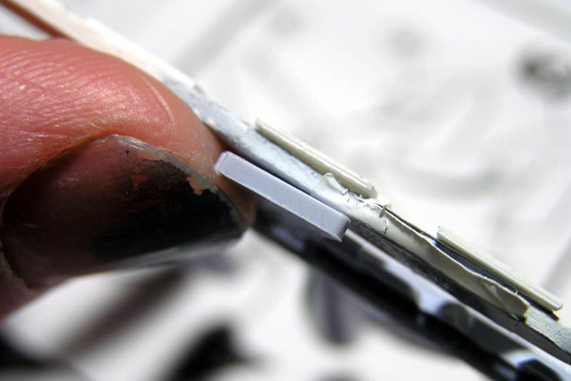

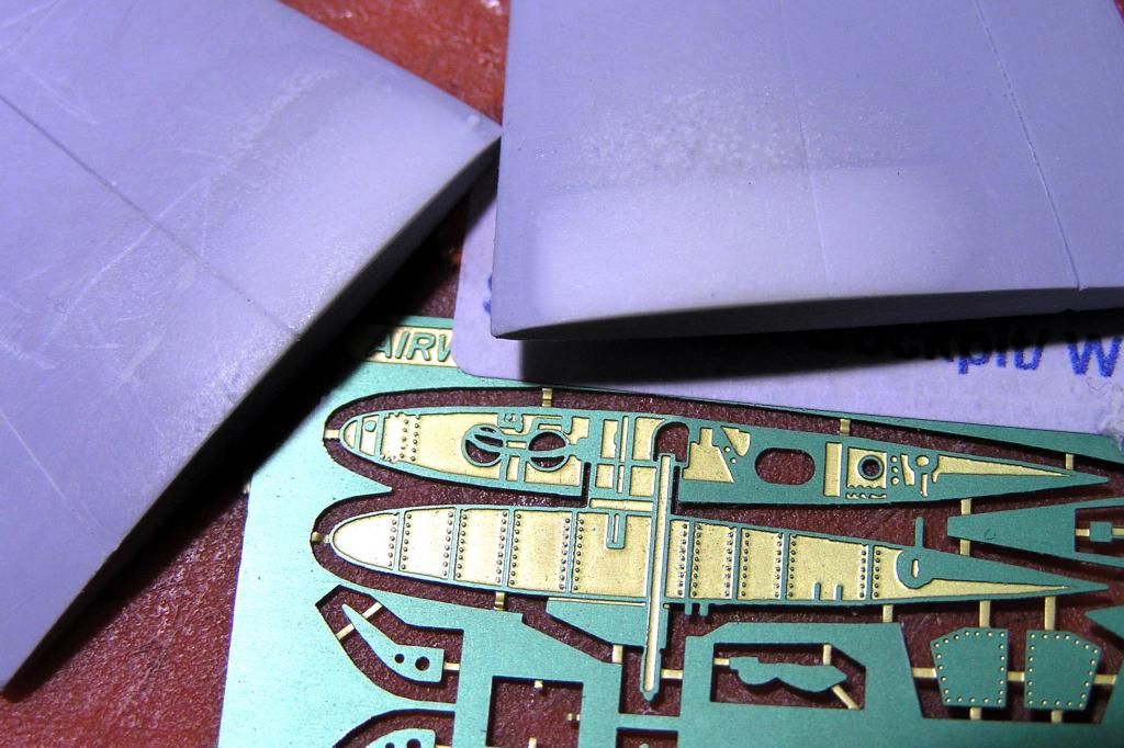

I am going to fold the wings, but the MPM etch means more work on the Airfix wings. The cross-section is all wrong for starters, so I glued a strip of plasticard along the top surface....
.... and sanded it to a rough profile. Then with superglue and talc filler I filled in the gaps it left and when it had hardened I sanded that to achieve a better finish. A quick (?!) scribe of the wings and I am here:

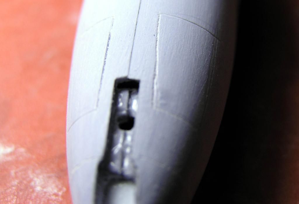

Scribing a fuselage is still a skill I have to 'develop'. The wings are relatively flat and it's all straight lines, but the fuselage is a struggle with its curves. The result of my attempt to do the canon muzzle panels can be seen - pants and in need of filling and rescribing. You can just see the forward section of the nosebay roof I had to remove to put the noseweight in. The model will be seen from above, not below, so the wheel bays will remain as they are; rubbish!

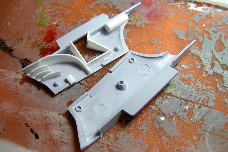

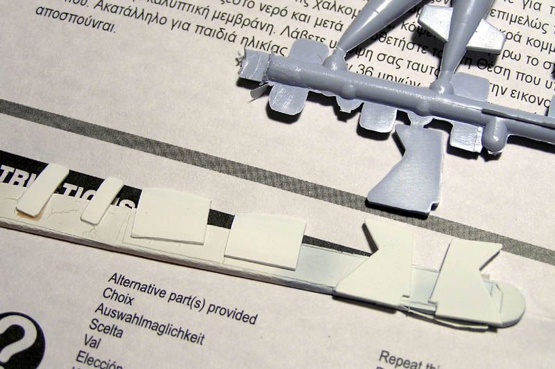

I have boxed in the main wheel bays, added in the intake vanes and made up exhaust tubes form plastic tube which has been sanded and filed to give scale thickness at the outer end. the extra little piece of card at the outer end is to spread the join to fit the etch wing-fold:

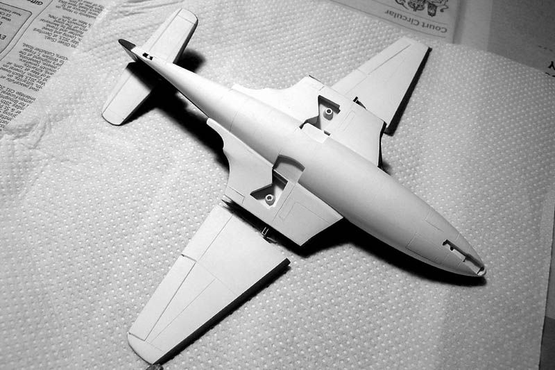

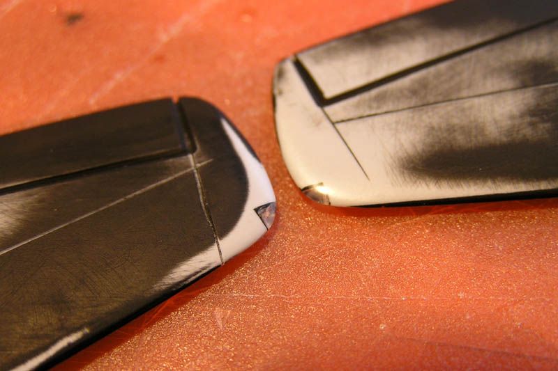

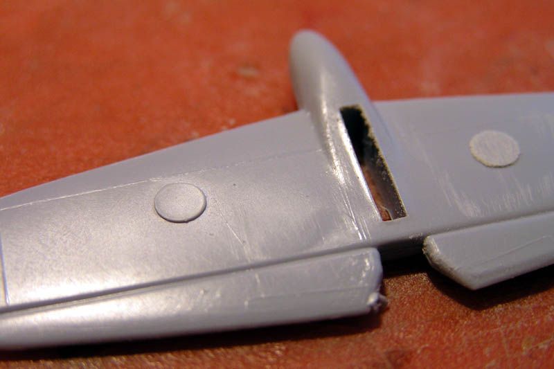

With the inner section of the wings spread to match the etch wing-fold I had to add more filler to the outer sections to match the profile and then more sanding ensued. I have made about four attempts to get this right but I am still not satisfied, though it will have to do. This pic should give you some idea how much filling and sanding was involved:

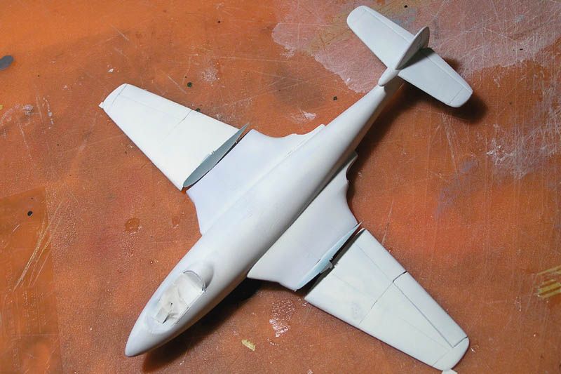

With the wing-fold in place and primed it looks like this:
The final fettling to get it in the right place will have to follow at the end when the painting and decaling is done, and the wing outer sections are fitted. The main assembly is all done now and primer applied. The white primer doesn't show any detail (including my poor attempt at re-scribing) but this was my finish point for the evening:

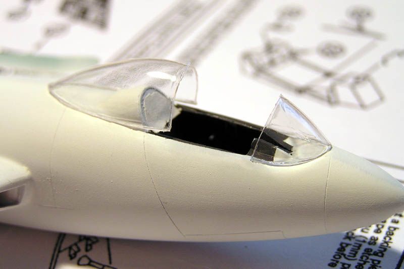

Now then, where were we? I have had a fairly busy few weeks with modelling being a little sporadic, but I have done some. I bought the Fleet Air Arm set of Falcon canopies, which was just as well as I have lost the original injection moulded transparency. The scary bit is that there is only one of most of the canopies in the set - no room for error. Oh yes, and I have never used a vacform canopy before. No pressure then!
I was careful and took my time with a new scalpel blade and this was the result:
It fits quite well doesn't it? Which is quite surprising as it is the canopy for the Supermarine Attacker- d'oh! So back to the canopy set to cut out the one for the Sea Hawk...

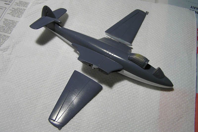

With the correct canopy fitted I masked up for painting. The underside is in Lifecolor white and the uppers in Xtracrylix Extra Dark Sea Grey. The windscreen canopy is fixed in place and the rear section just in place for the photo.
After a crisis of motivation where I have been distracted I should now be back on track to complete this before the deadline, so I can line something up for KUTA IV.

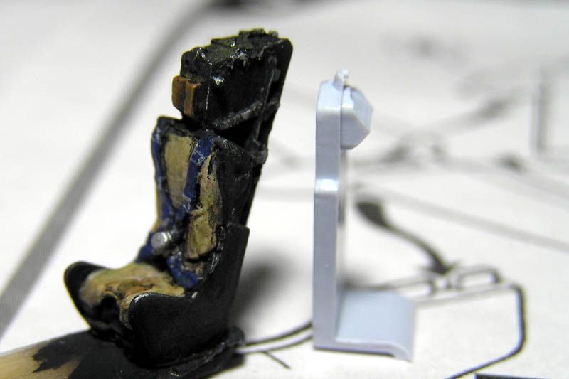

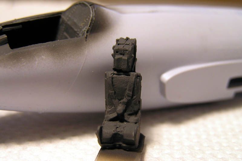

The seat lacked a certain something, so will be replaced by an Aeroclub white metal piece:

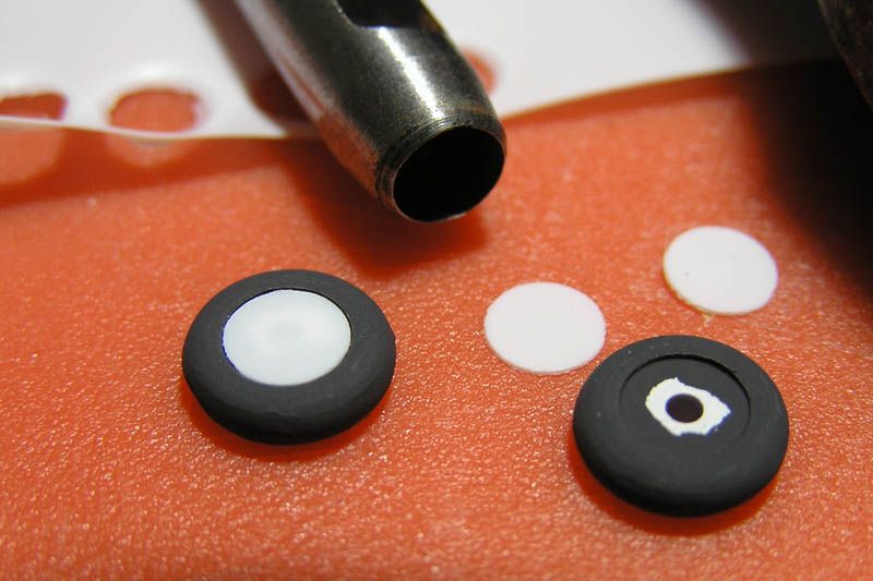

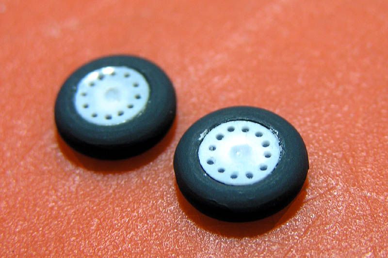

The wheels are pants too:
I stamped discs from very thin card (5 thou?):
And then drilled some 0.4mm holes around the edges so they at least represent the originals:
Just a thought, but isn't that intake trunking curving the wrong way?
