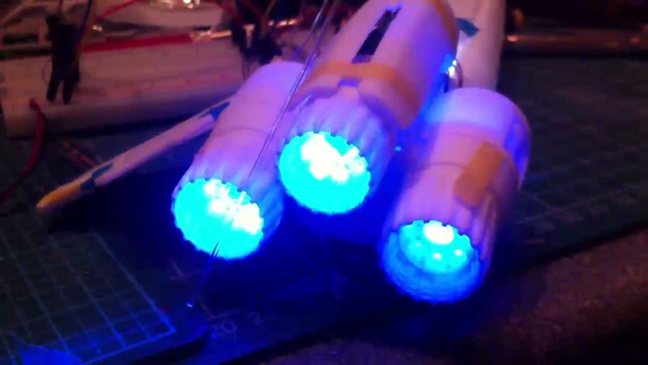

Madmonk Posted September 23, 2013 Share Posted September 23, 2013 Started work on a lighting kit using the Arduino programmer that SecretReeve introduced us to. Tried to emulate a bit of engine flicker along with cockpit lights both steady & flashing and wing tip warning lights. Quick video of a test run. Cheers, Warren Link to comment Share on other sites More sharing options...

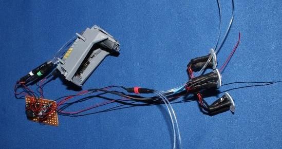

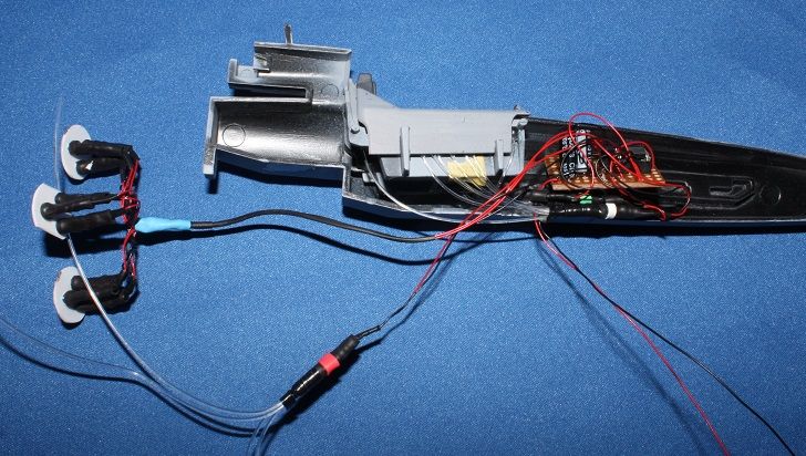

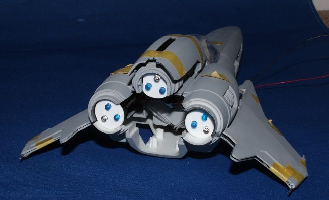

Madmonk Posted December 3, 2013 Author Share Posted December 3, 2013 Had the final version on test over the weekend with no issues. Here is video of it running, taken with phone so apologies for quality. And a few photos of the build process. Need to build up a few before putting them online. Cheers, Warren Link to comment Share on other sites More sharing options...
Breaker Posted December 4, 2013 Share Posted December 4, 2013 Warren, that looks awesome! The flickering engines and wing tips lights are just right, love to see it built up. Circuit seems quite large, what are the Caps for if you're using a PLC? Link to comment Share on other sites More sharing options...
Madmonk Posted December 4, 2013 Author Share Posted December 4, 2013 Hi Breaker, The kit is powered from a 9V battery and the Attiny85 processor works off 5V so I have a voltage regulator to give me a constant 5V rather than relying on a voltage divider. The capacitors are there just to stop any noise from the DC supply. The circuit board is 3cm x 2cm, I could have made it a bit smaller but had the room so made it as big a possible to allow space to get all the wires in. Cheers, Warren Link to comment Share on other sites More sharing options...
