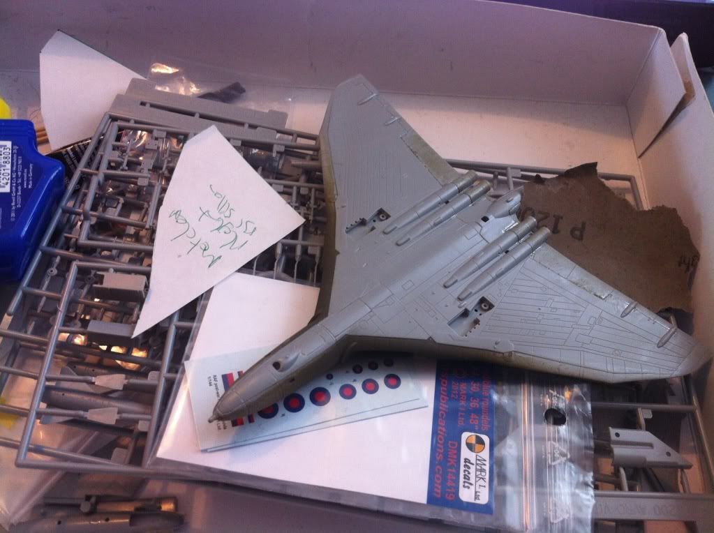

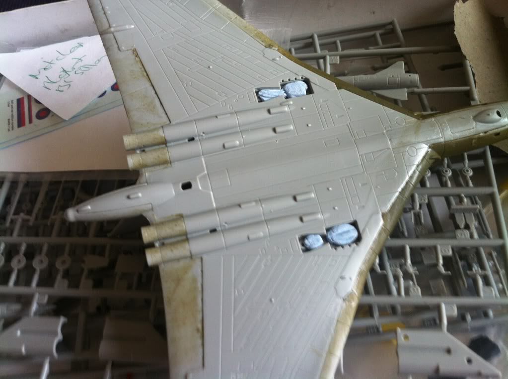

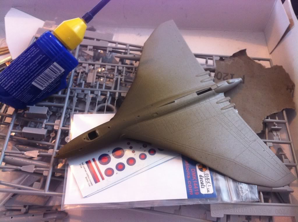

robvulcan Posted September 21, 2013 Author Share Posted September 21, 2013 Good morning. I started with the first job of the day a nice cup of coffee. Then checked the tail had set which I finished yesterday. This morning I fitted the canopy which I had sprayed the insides of dark grey yesterday to make sure its opaque. Then I have fitted some blobs of blue tak in the wheel wells to stop the under carriage doors falling in while the glue sets. I am now waiting for the rear doors to stiffen then I can fit the front doors. Here she is as of now. I have run glue around some of the gaps around the tail and fuselarge halfs next job is to fit the ECM plate or plates depending on what 426 had. Then decide if to bother modelling the 200 series exhausts or just cheat and leave the 300s on.. Milliput small gaps and then spray her allover in Hu155 Olive Drab. then the blue tak madness can begin ready for med sea grey. Then the dark sea grey patching can be applied. etc... Cheers Rob Link to comment Share on other sites More sharing options...

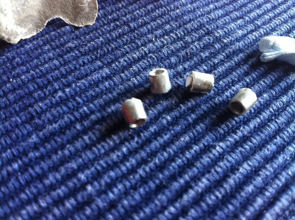

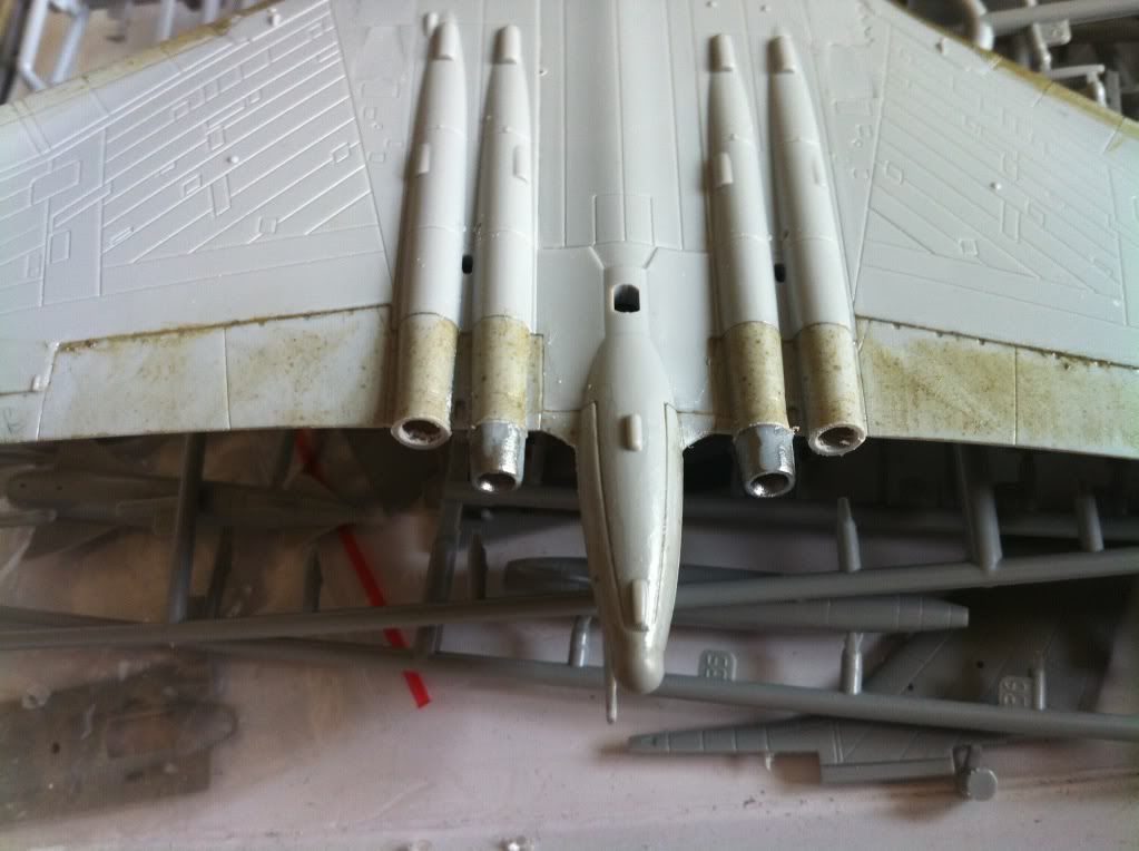

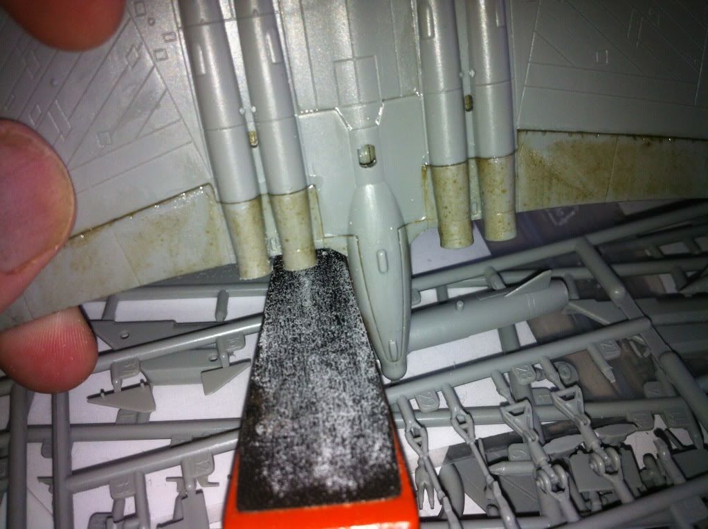

robvulcan Posted September 21, 2013 Author Share Posted September 21, 2013 I have filed off with the trusty old sandvick the exhausts back to the first kit line. Then I pinched some 200 series exhausts from an old die cast avro models vulcan. Filed them to shape and super glued them to the model. they now look more like 200 series pipes. As this model is to be displayed with my VDF era XH558 model I could not overlook this as they both had the same exhausts and I had modded XH558 in the same manner. next job ECM plates and milliput time. But first to the gym for a much needed work out ! Cheers Rob Link to comment Share on other sites More sharing options...

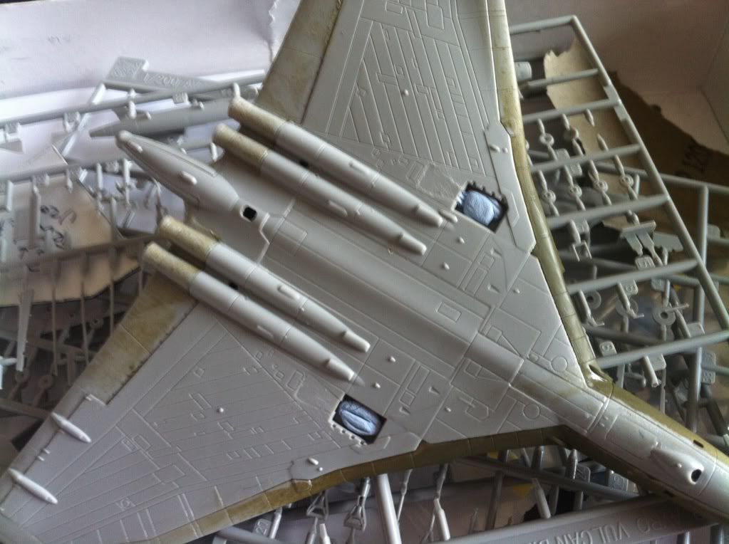

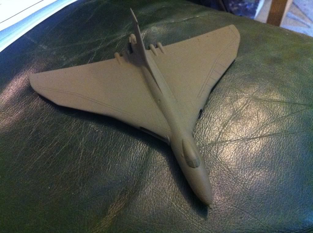

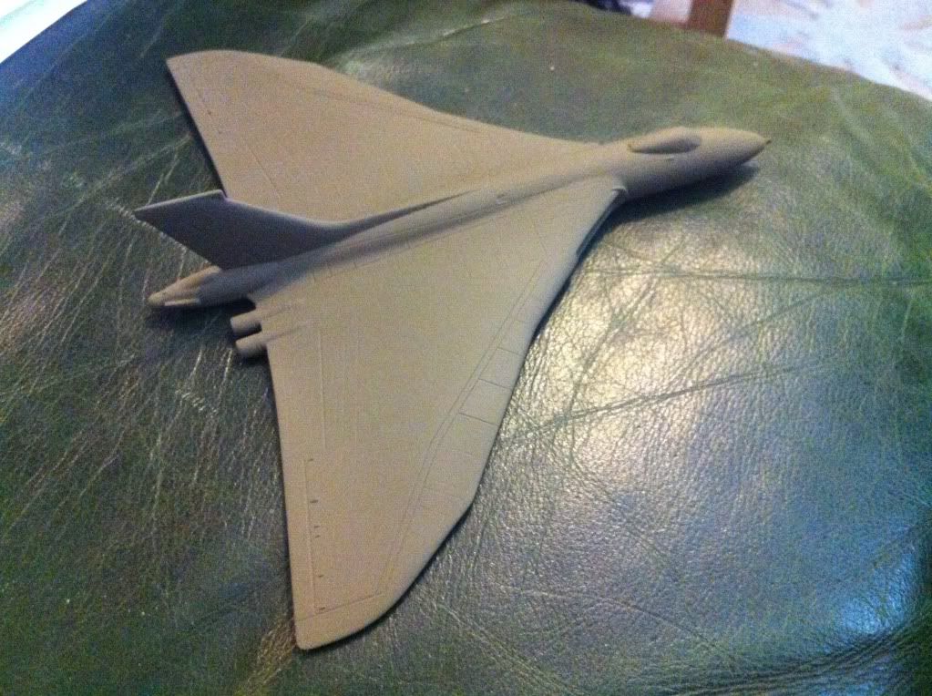

robvulcan Posted September 24, 2013 Author Share Posted September 24, 2013 Well I have been busy working on the Precision Ice and Snow Diorama and also working on this little beastie. I have fitted the ECM plate It looks like XL426 even though it was a blue steel fitted Vulcan lost its secondary plate later in life as I could so far only find one photo of her as she is today fitted with only one. I can only assume this is how she was in the early to mid 80s. So here she is milliputed in the small holes as I have with the others I have done I have been naughty and omitted the smaller details which are hugely over scale anyhow. I have also omitted the probe do to these often having to be moved around due to space. and built just for my enjoyement. However for the next one I build I am going to make it wheels down with a diorama base something I don't do often. Next I need to fit the ECM cone Intake and then spray her with the olive drab and then I can blue tak her for the grey, Cheers Rob 1 Link to comment Share on other sites More sharing options...

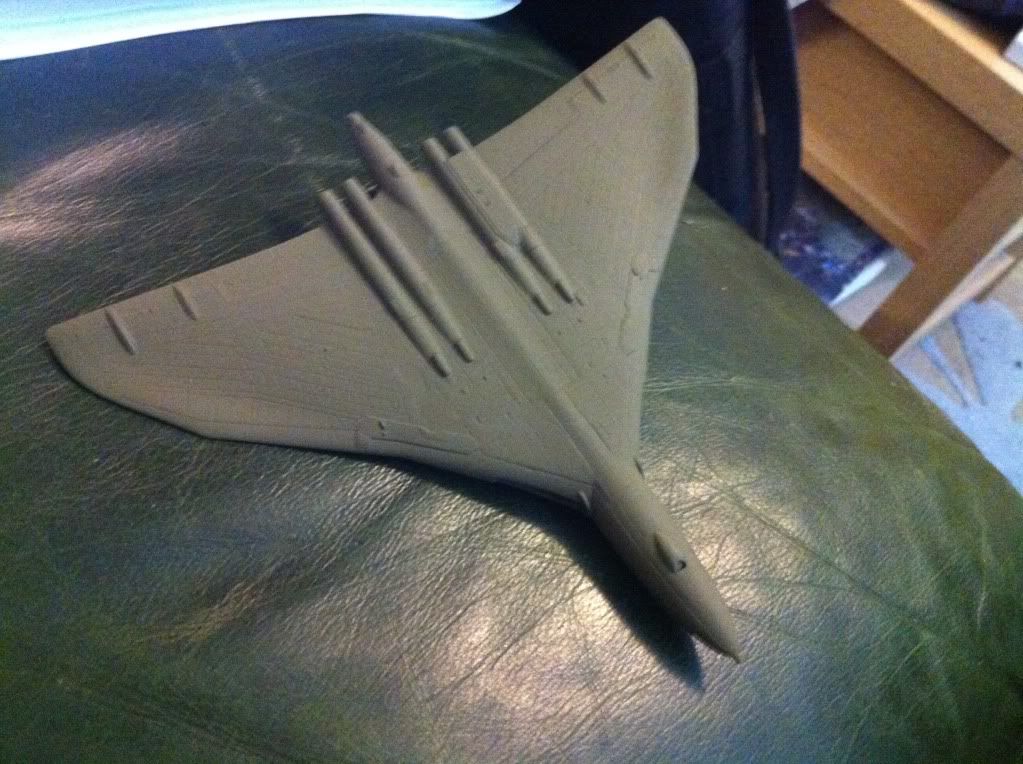

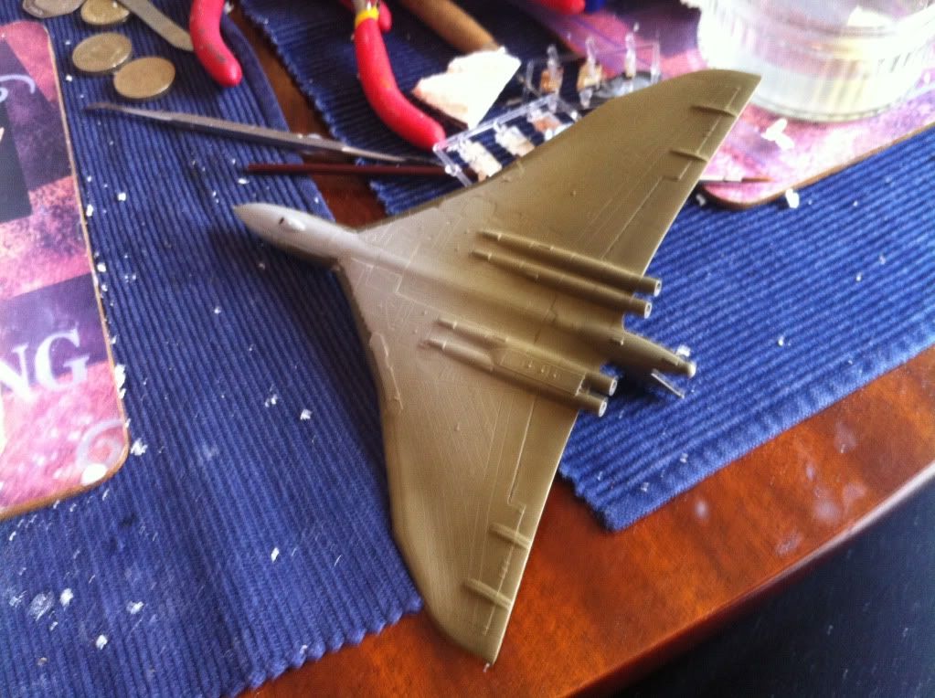

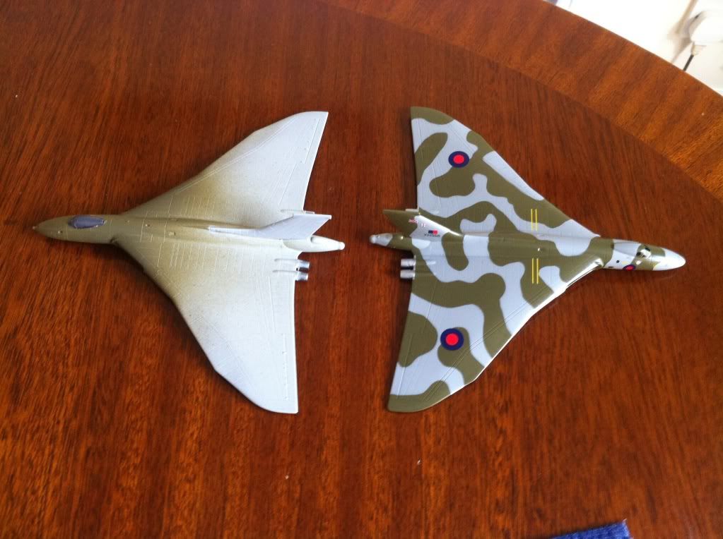

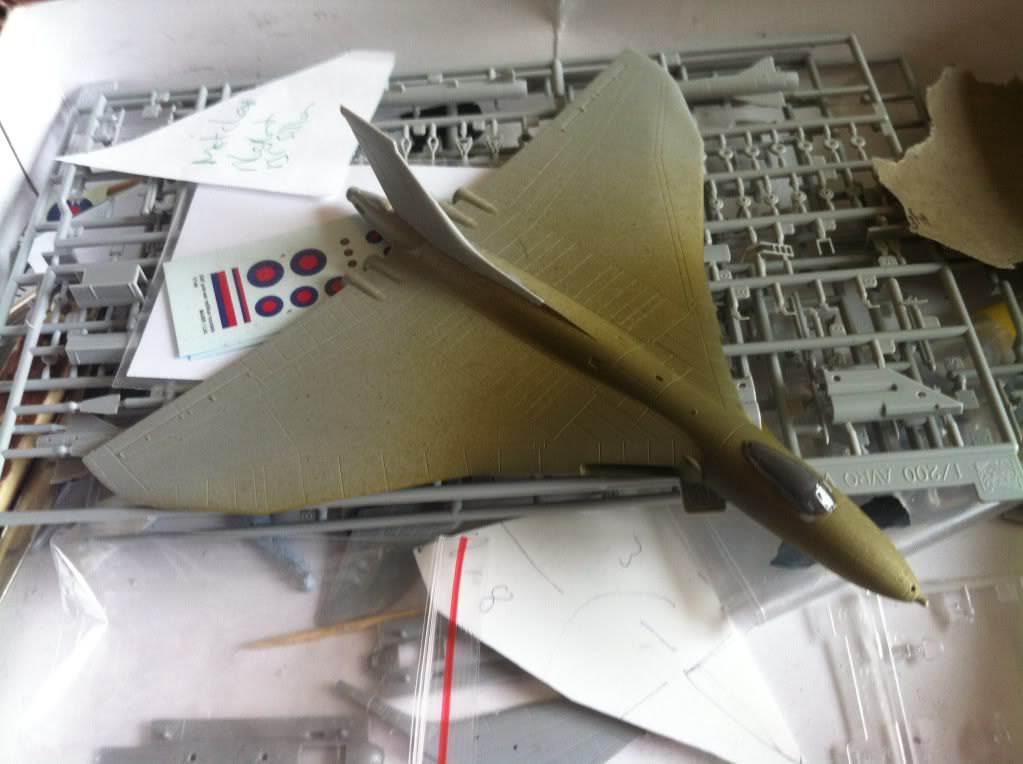

robvulcan Posted October 20, 2013 Author Share Posted October 20, 2013 (edited) Well good morning this must be the slowest Vulcan build I have ever done. She keeps getting put down and left due to other things since the start if the year. That's no reflection on the kit she's a peach.Current state of play the ECM plate was fitted. The intake on the tail cone fitted.Small gaps and holes were aerials should be filled in with milliput.Then I wet sanded with 1200 wet n dry. Then I sprayed her with humbrol rattle can 155 olive drab. I think she looks pretty nifty in one colour she reminds me of all over green drakens.Now to bluetak the pattern has any kind sole got clear pictures of xl426 undersides when she was in wraparound and a good top surface shot ?Rob Edited May 2, 2014 by robvulcan 2 Link to comment Share on other sites More sharing options...
