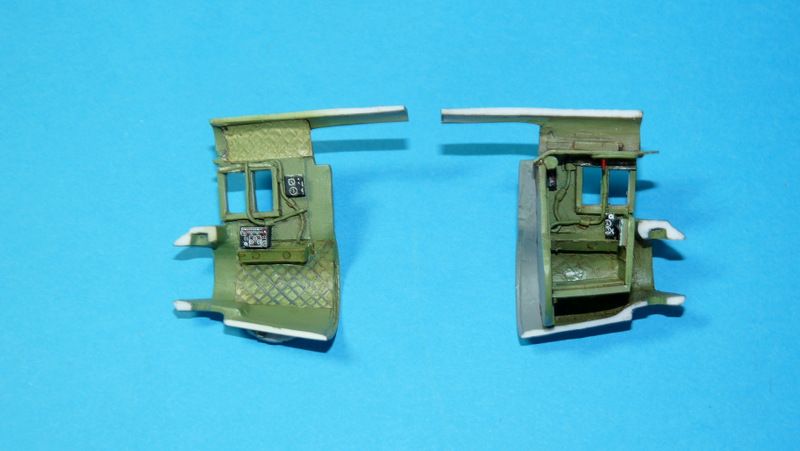

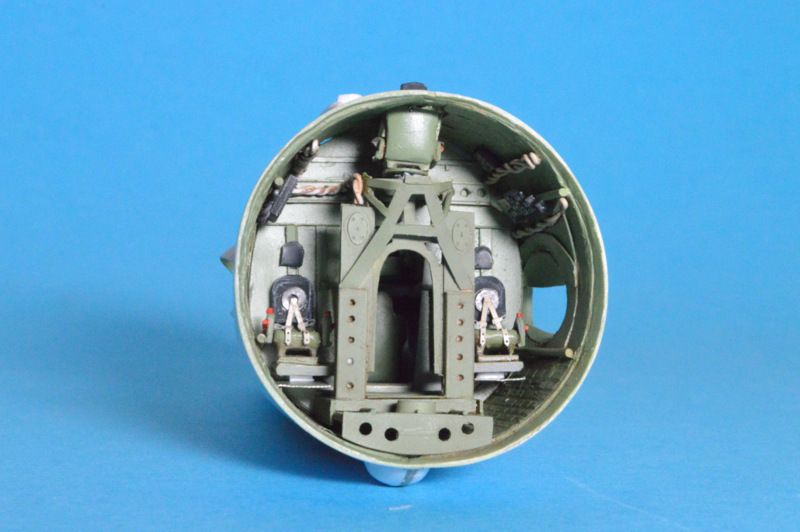

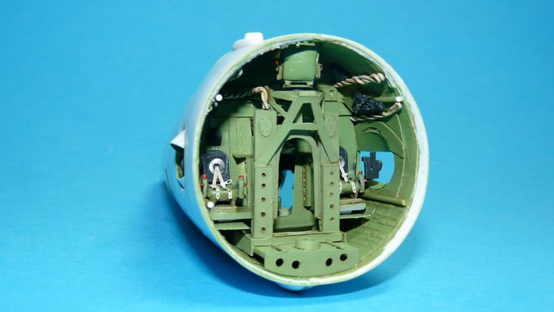

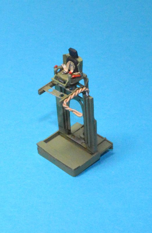

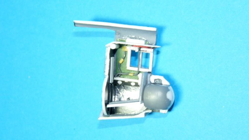

general melchett Posted October 31, 2013 Author Share Posted October 31, 2013 (edited) Right troops, before this thread is recalled from the front line for a damn good thrashing in the bath house I'll get back to whatever it was I was up to, er, now what was that, (been a bit distracted for some reason...images of stiletto heels, big guns and mini skirts by thunder !!), ?...........oh yes, the Bison, well I made a cardinal error in contacting those extremely knowledgeable lads over at Scalemodels.ru to ask if anyone had any info regarding the 3M and have been swamped by more info and photos than my hard drive can take ! All amazing stuff but sadly is leading me down the inevitable path of wanting to cram more stuff into the model that no one's ever going to see................ . The forward fuselage is nearing completion now as I have the info and photos needed to finish the dorsal gunners seat and equipment, and the blister gunners seats are fitted, (just waiting for some Eduard seat belts to arrive tomorrow to finish off). Next I'll build the sighting gear and add the overhead plumbing and a few avionics boxes and then I can finish the back wall that carries yet more avionics boxes. The section has been weathered with oils and pastel with a bit of highlighting to give depth.... Whilst this is drying I decided to tackle another area that Amodel have left rather basic namely the rear turret. They just went for a generic 'tub' with vague details and an undersized, basic seat. Using photos I've redone the interior adding inner window frames and gun laying equipment and associated plumbing. The ball turret is a tight fit so the side walls of the rear fuselage needs to be sanded away so that it all goes together..... The insulation quilting has been added using aluminium foil, a ruler and sharp pencil). Painted and washed, control boxes added, A new seat is needed too as the kit ones are undersize and the wrong design, so I decided to scratch build one rather than adapt the kit parts, Painted and belts added....not a lot will be seen again but hey ho.... The dorsal turret gunners position is now finished. I've redone the seat using new data as it was a little oversize..., Seat belts and upper radio gear installed , And gunners tower fitted, More soon, However before we leave the subject completely......... Wasn't like this in the trenches !!!.................beeeeeeeeehhh Cheers all, Melchie Edited October 31, 2013 by general melchett 1 Link to comment Share on other sites More sharing options...
John_W Posted October 31, 2013 Share Posted October 31, 2013 Wasn't like this in the trenches !!!.................beeeeeeeeehhh Cheers all, Melchie Should have gone for tanks dear boy... Lovely work on the inards. Real shame it won't be seen, but sometimes you have to put it in for peace of mind. Link to comment Share on other sites More sharing options...

Col. Posted October 31, 2013 Share Posted October 31, 2013 Cracking work Andy. Those sub-assemblies are models in their own right. Link to comment Share on other sites More sharing options...
general melchett Posted October 31, 2013 Author Share Posted October 31, 2013 Thanks Col, it's putting it all together without a massive implosion that's the trick..... Neil.. Do they take Brits ? Perhaps I can recruit online I've seen your legs mate.....no chance !!! Link to comment Share on other sites More sharing options...

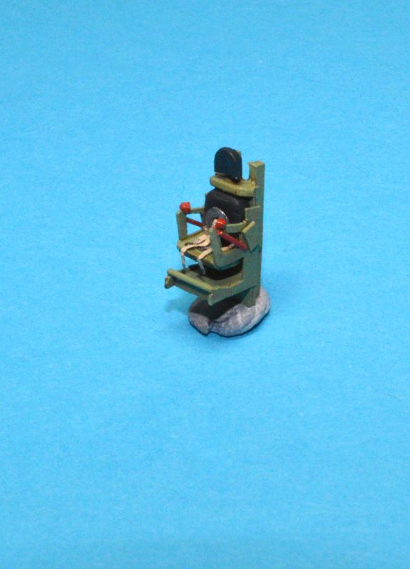

John_W Posted October 31, 2013 Share Posted October 31, 2013 There is a strange Soviet logic to having a gunners seat copied from centre court at Wimbledon. I presume he could come down to pee? Link to comment Share on other sites More sharing options...
general melchett Posted October 31, 2013 Author Share Posted October 31, 2013 Yes I was wondering what that Daily Star pap fella was up to as well.......he's either praying to the media Gods for his luck, just been delivered a low 5 by one of the marching 'ladies' or some oik has superglued his camcorder to the tarmac !......really make his day if they broke into a goose step The guy opposite looks quite chuffed with himself too... Ian ...............I really wonder what the contents of your hard drive/s holds sometimes !! Russian aircraft ........what..........where ?? There is a strange Soviet logic to having a gunners seat copied from centre court at Wimbledon.I presume he could come down to pee? Apparently it was so he could shout to the pilot 'Борис я могу видеть ваши даче отсюда' which roughly translated means.. .' Hey Boris I can see your Dacha from here'... Link to comment Share on other sites More sharing options...

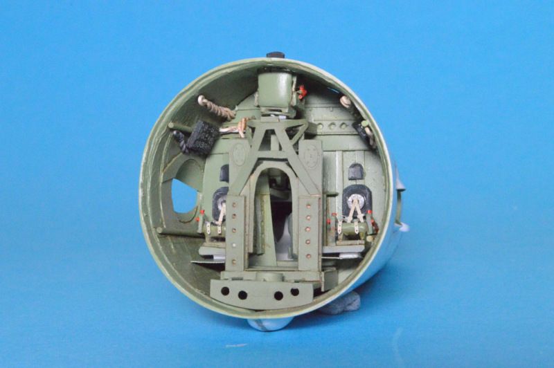

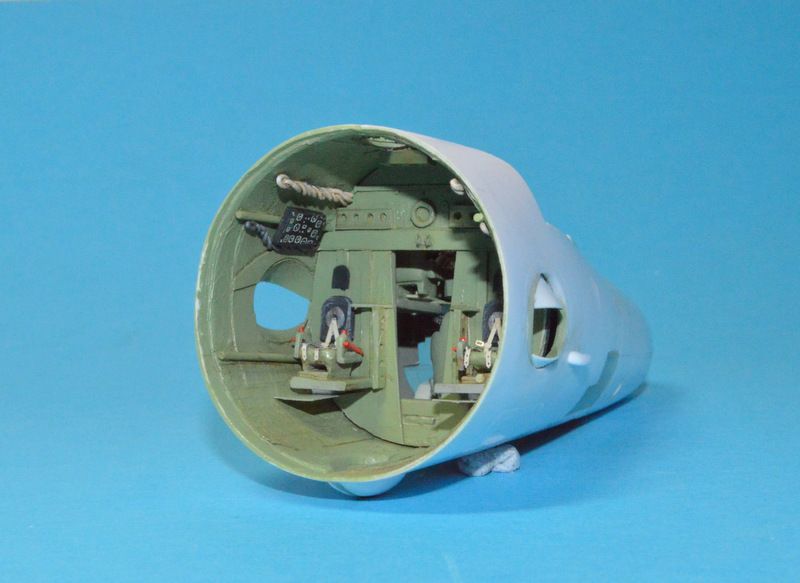

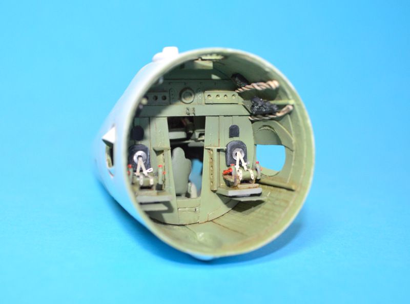

general melchett Posted November 1, 2013 Author Share Posted November 1, 2013 (edited) Blood pressure dropping now Melchie? Yep that's done the trick John ..................but then I keep scrolling up to Wolfies picture dammit !!!! . Because, Pin, there isn't an over 18s section? I'm just glad Jessica hasn't posted photos of well-build blokes in uniform for a bit of balance to make us all feel a bit emasculated. Well said Col...................just give her time !! Right, well for anyone who by some weird quirk of fate hasn't been distracted too much I've scratch built and painted the sighting gear for the lateral gunners, they were a wee bit fiddly... Installed them next to the seats and glued the gunners podium into position , (also added a few more avionics boxes too), Also fitted the rear gunners seat which needed a bit of modding to get to fit but it all goes into place now....all that's left here is probably the most awkward bit...replacing the four windows. The Amodel parts are atrocious, opaque and warped for some reason. I'll make these using 1mm acetate sheet. Back to the mayhem folks..... However I've got my special referee ready with his whistle should things get a bit dicey.... Melchie... Edited November 1, 2013 by general melchett 2 Link to comment Share on other sites More sharing options...
keefr22 Posted November 1, 2013 Share Posted November 1, 2013 Tremendous stuff Andy, those bits of fuselage really give a great impression of how cramped the inside of the thing was! And old Sam will undoubtedly be well up to the job of keeping the peace in here; “Ok rabbit … you forced me to use force” keef Link to comment Share on other sites More sharing options...
