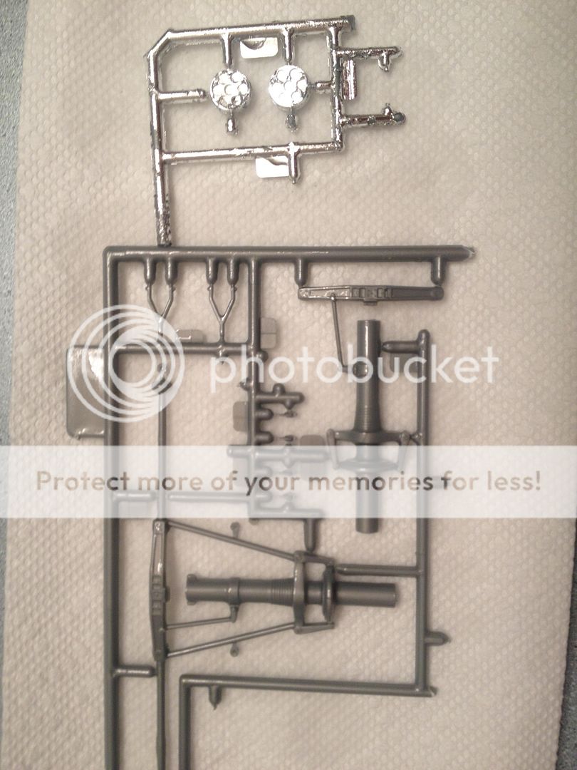

georgeusa Posted August 18, 2013 Author Share Posted August 18, 2013 Okay, just for grins, I left one of the sprues in the coke solution for a couple of days and the rest in the brake fluid solution. (Well, to be truthful, got caught up in work and forgot about the parts soaking.) Here are the results. The sprue with all the chrome gone is the one that soaked in coke for 2 days. The sprue that is, for the most part, still shiny with most of the chrome on it sat in DOT 3 brake fluid a little longer than the parts that soaked in coke. One is clearly labeled poisonous and gives instructions on how to treat if swallowed. The other is adored by millions and consumed daily in massive quantities. Gives one pause to think doesn't it. 1 1 Link to comment Share on other sites More sharing options...
Black Knight Posted August 18, 2013 Share Posted August 18, 2013 I would hope that brake fluid would not remove chrome plating. On some vehicles the pistons in the brake calipers are chrome plated. I would like to think that the part behind the seal would still be plated and not be getting dechromed and the brake fluid contaminated. By the way; I use caustic soda as it removes the varnish sometimes fould under the chrome on model parts. The 'chrome' on plastic parts is actually varnished aluminium. Link to comment Share on other sites More sharing options...
