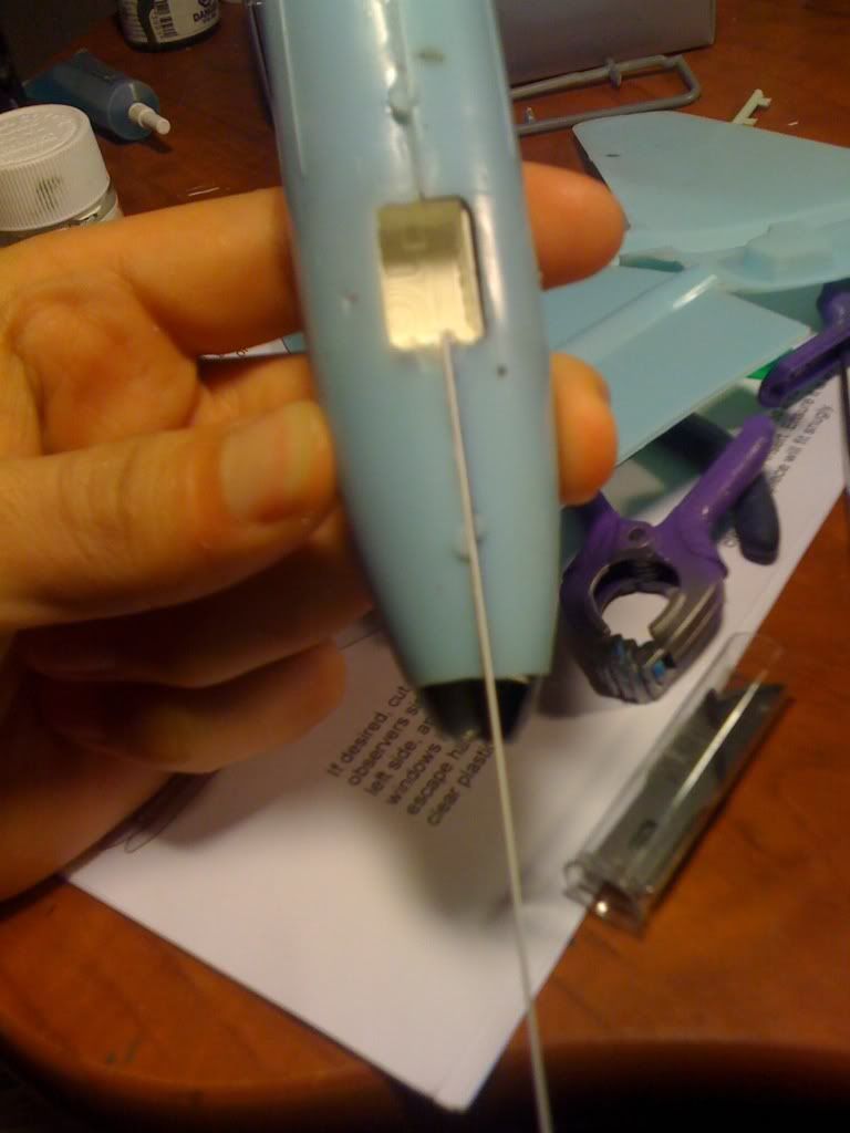

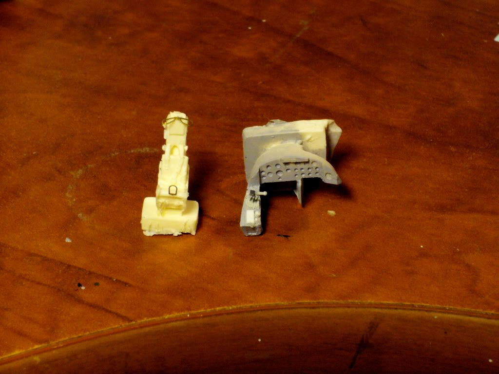

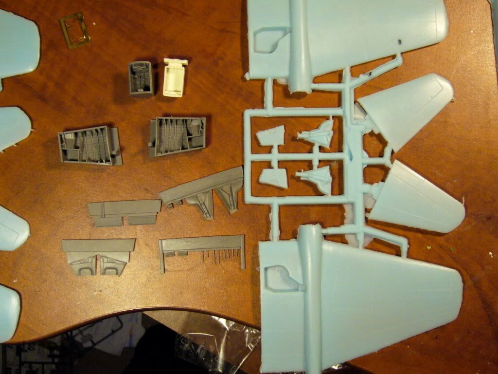

-Neu- Posted July 4, 2013 Share Posted July 4, 2013 I built a B.6 version in suez colours (apologies to people who have seen this before). As others have stated its accurate in outline but requires a lot of work... like here where I had to insert a spacer to fit the cockpit. I'd suggest that you invest in a landing gear bay for the Airfix or Xtrakit Pr.9. (I used the now defunct Resin Art set) The resin Cockpit bits. Still had to scratch a fair bit of the cockpit. I'm not really a great modeller and this was an early effort, but the final product was pretty good, I think. Hope that helps. 2 Link to comment Share on other sites More sharing options...
