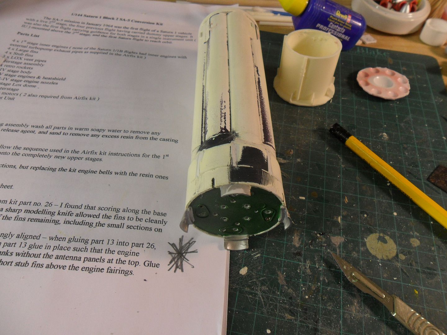

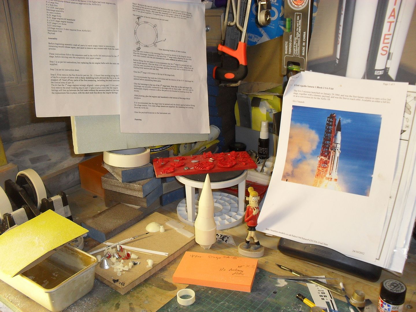

im using an old saturn kit to convert,so ive had to clean off previous paint etc
the fist job is too remove all the kit fins
and removing the top of the cluster,but if you were starting fresh,you would not fit this part,
i noticed that with the tank top,off there was a slight movement in the vertical join,it was a little bit flexible,
so i cut some strips of plastic
and fit them inside the body to stop the flex?

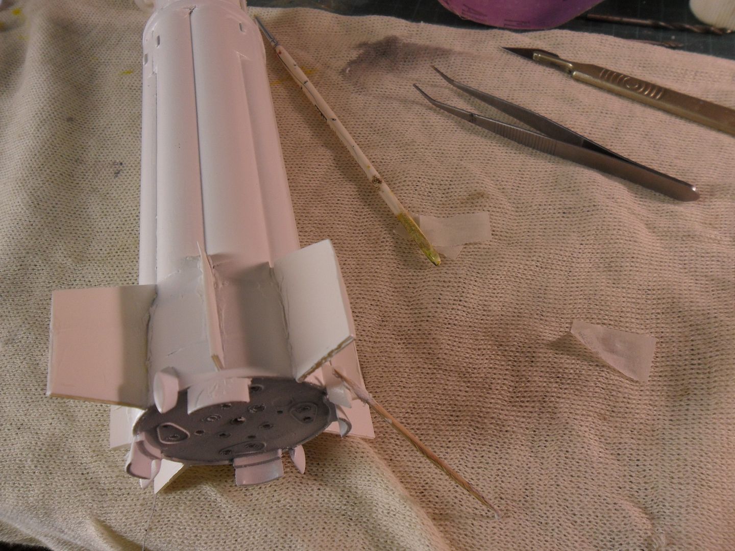

so this is fins before
so fitting the resin ones
its large,small large
so thats all the base fins fitted...

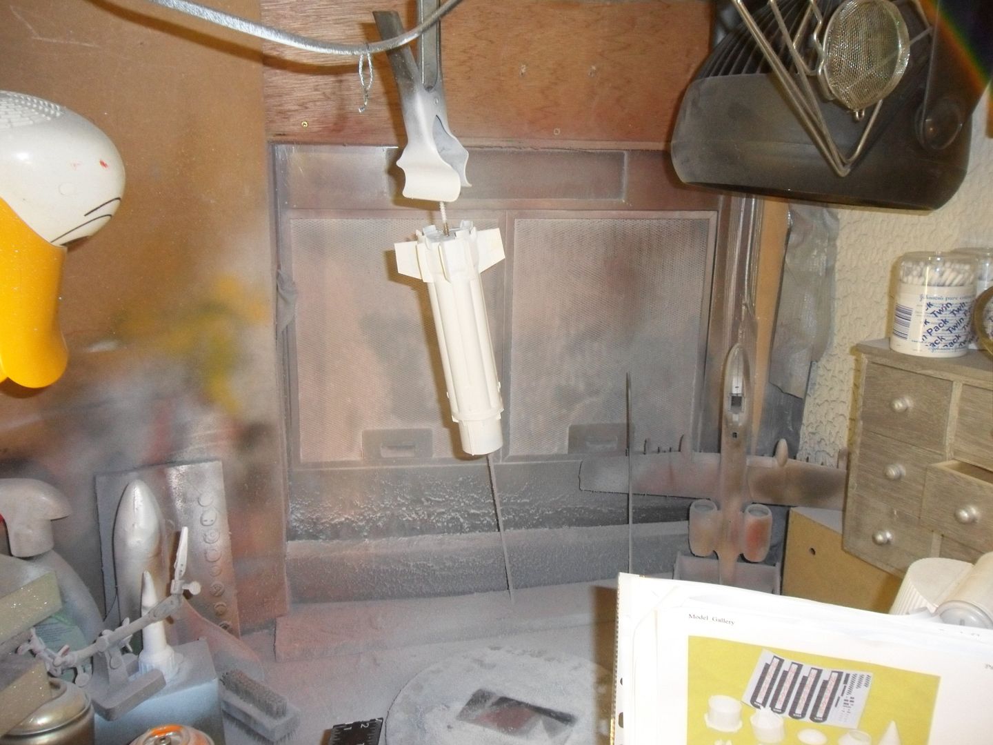

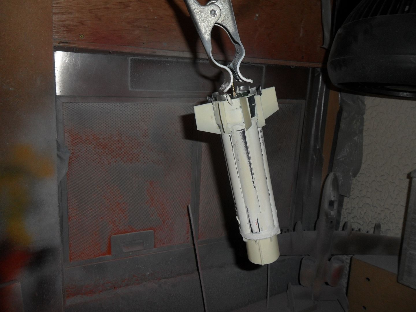

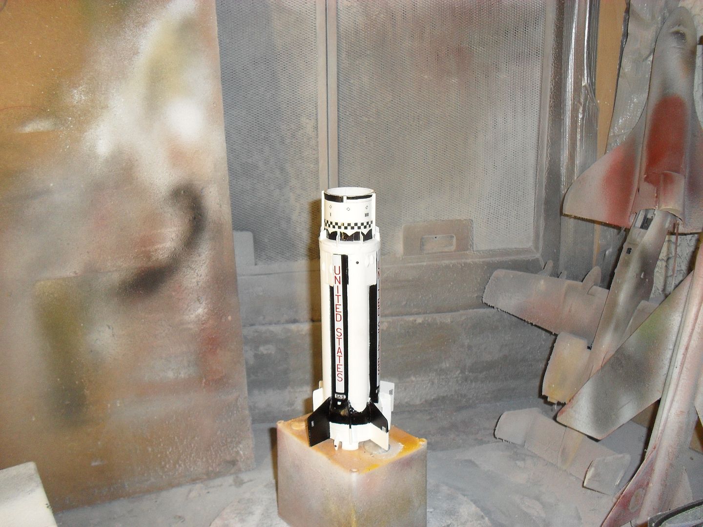

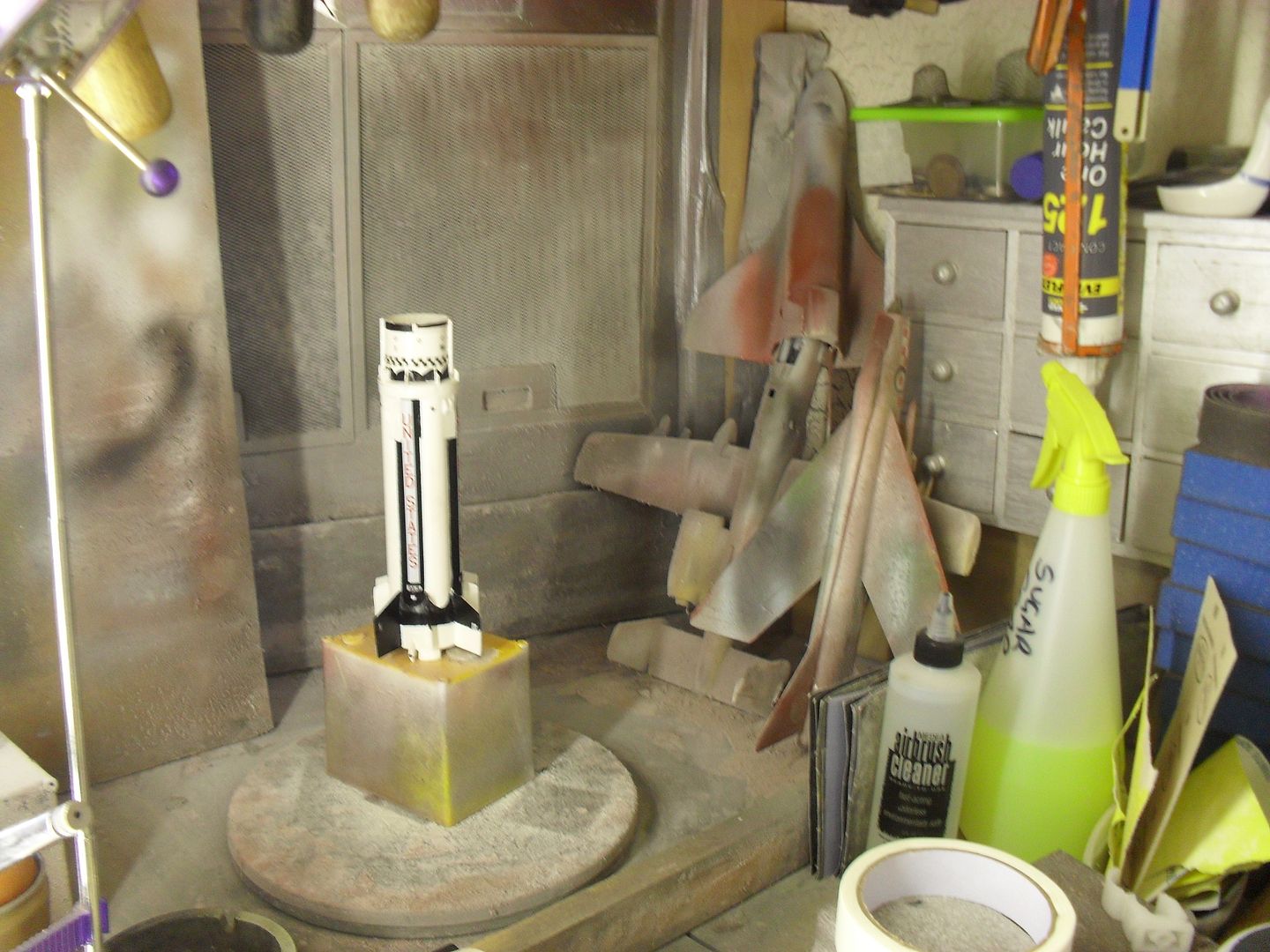

getting first coat of paint on
filling a few gaps in...
last coat before masking for the black....

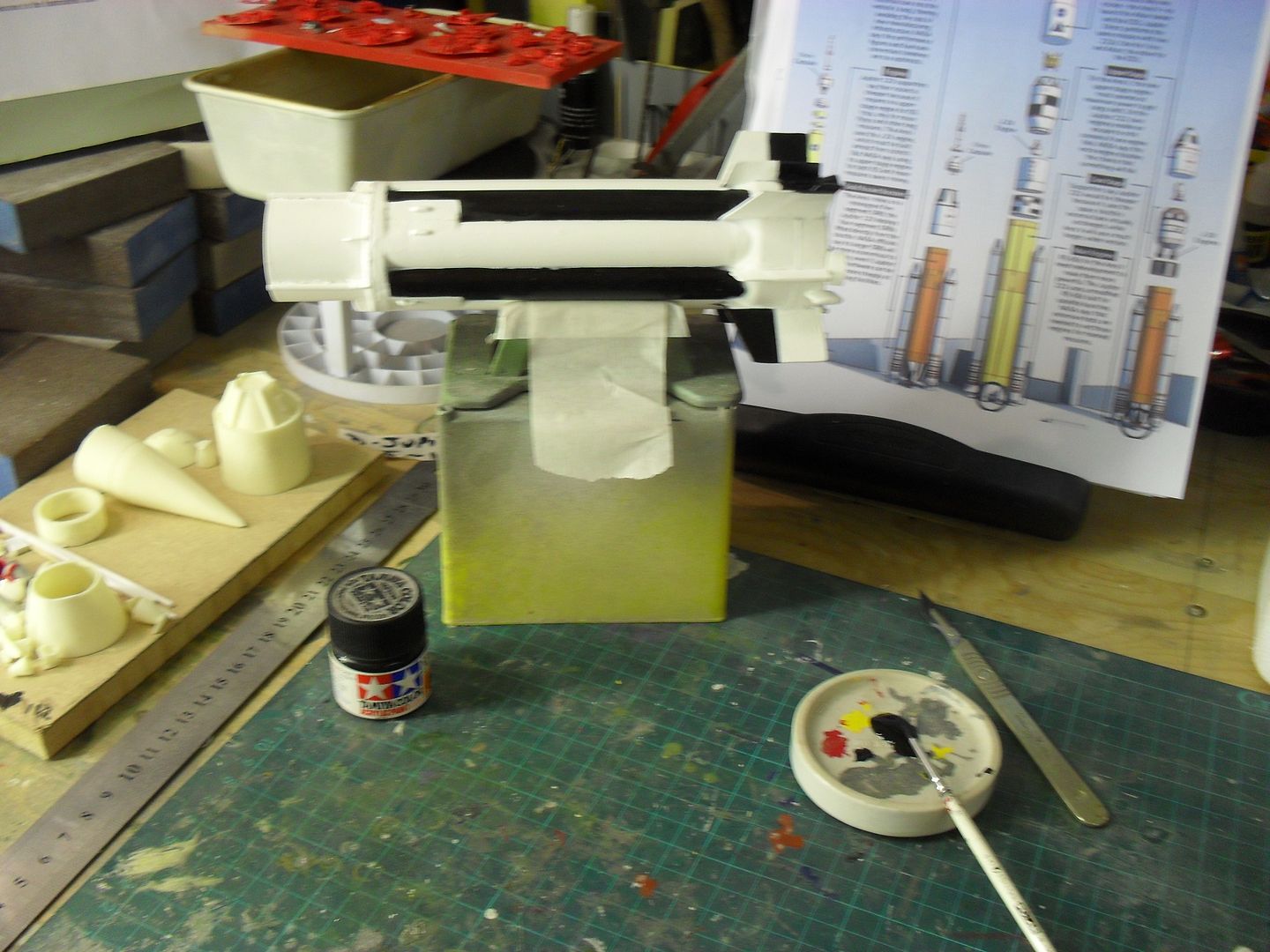

HI,Time for an update,as ive finished the build this week,here,s the story so far.....

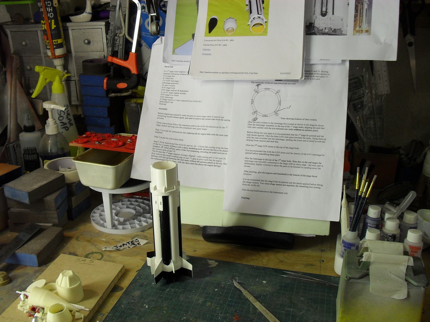

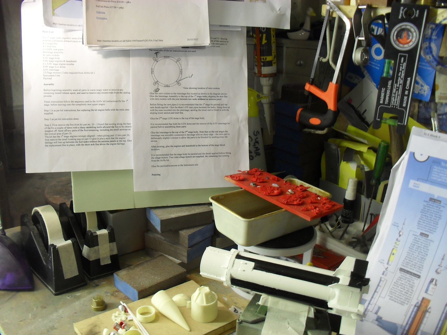

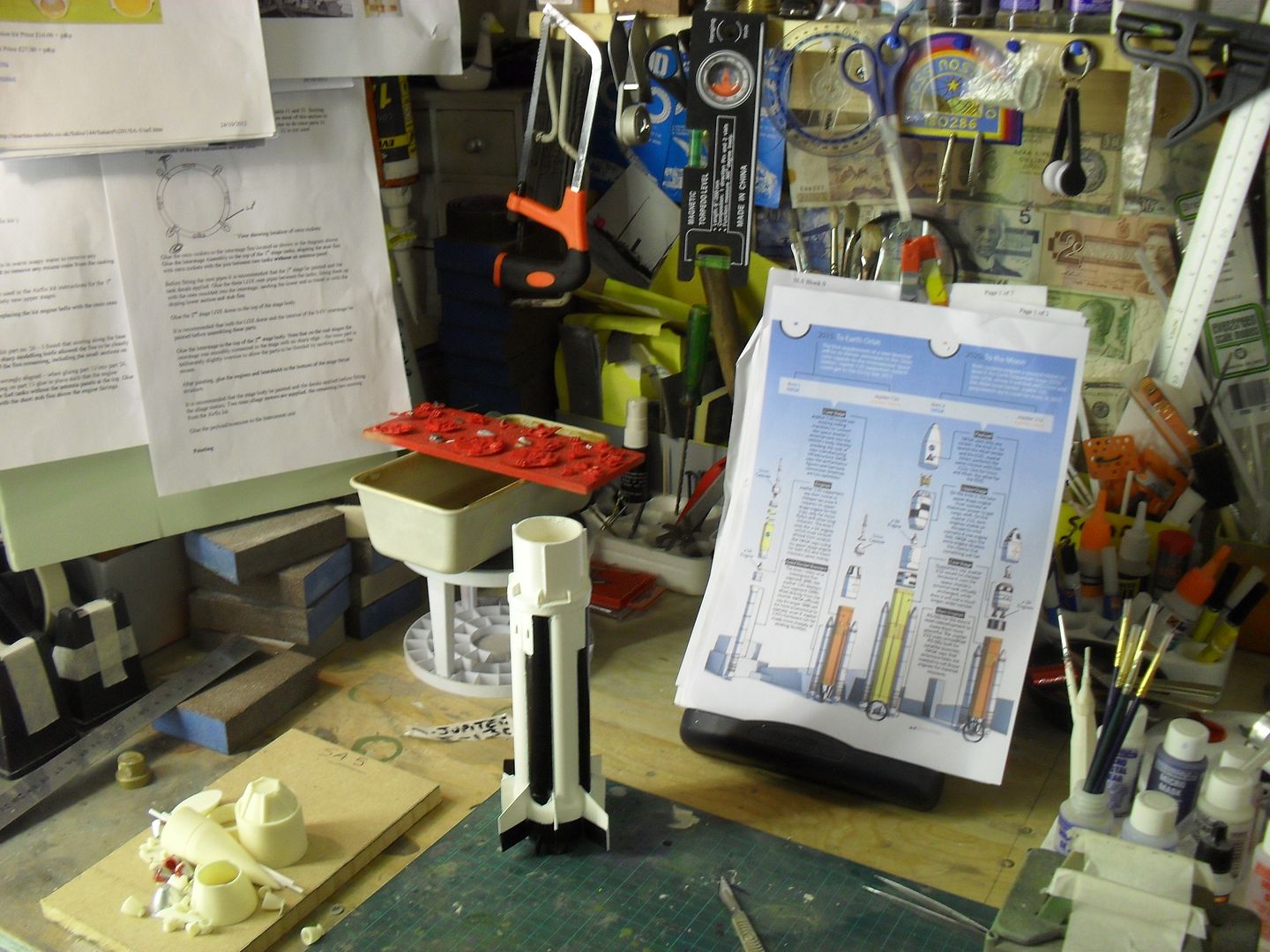

the clusters re-painted,these are the piece,s for the upper stage..
upper stage,

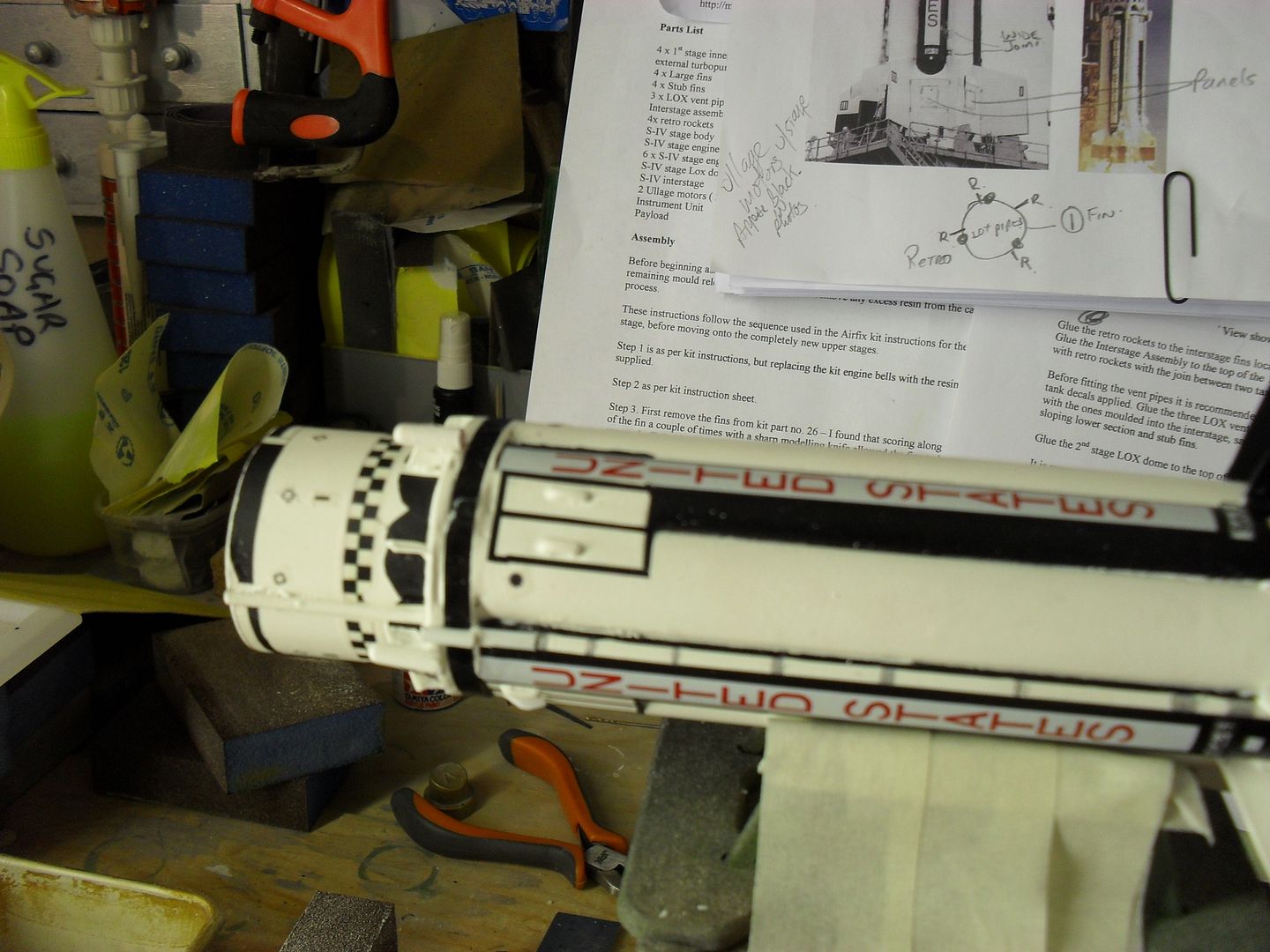

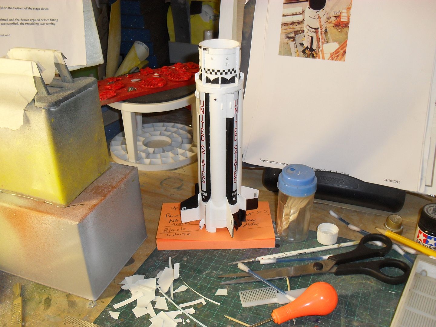

removing all the masking tape,to find out which quadrant to start in..
somewhere near,you need to find out which fin to start from,which then relates to the upper stage and retro,s etc
tidy up the black edges where the paints crept under....

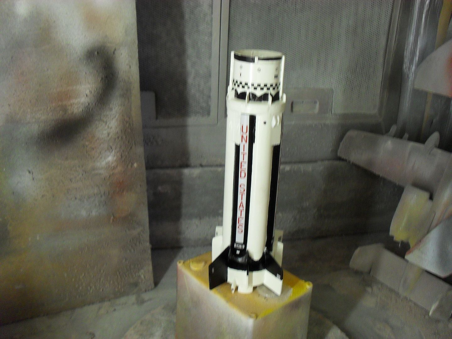

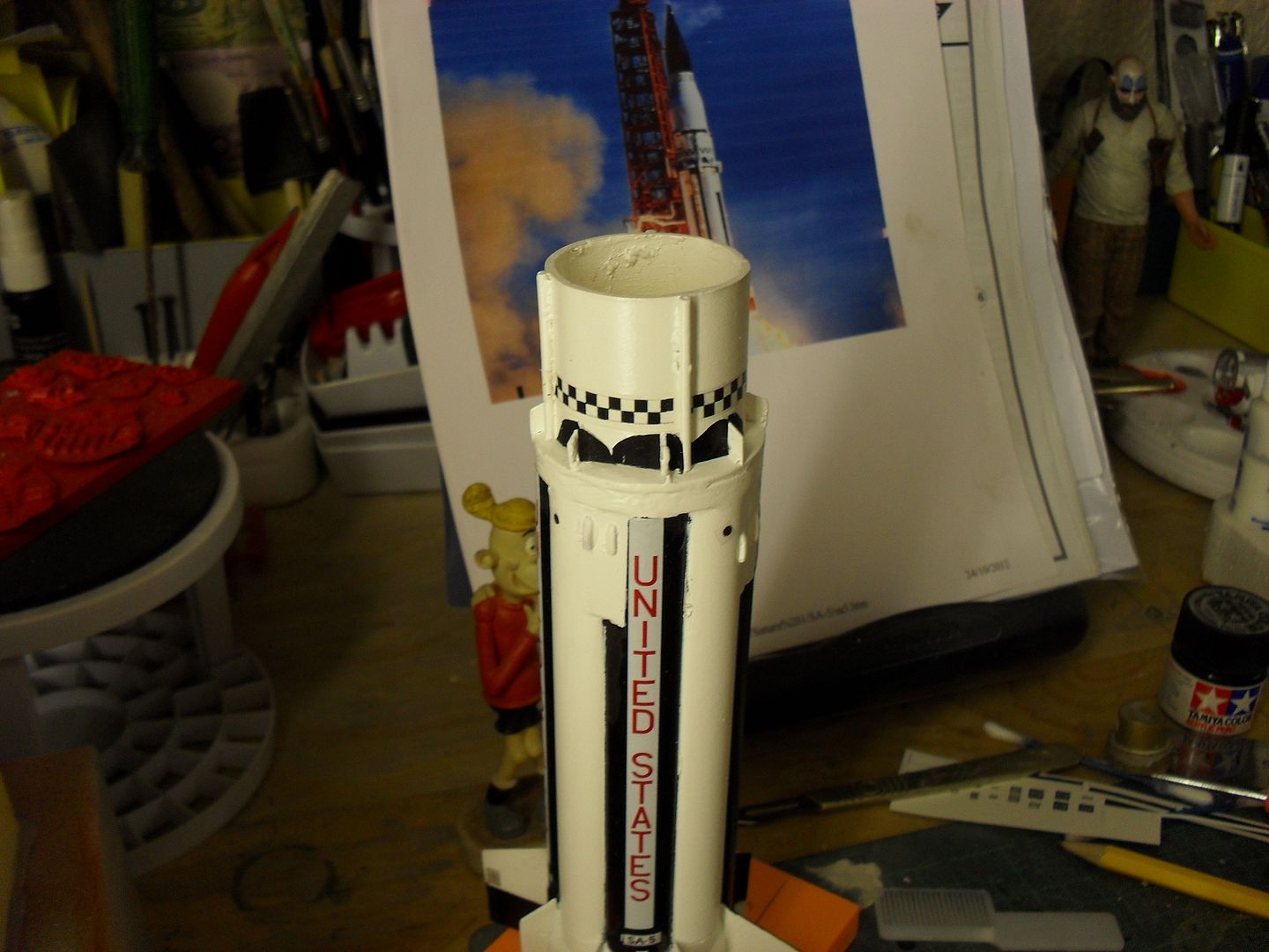

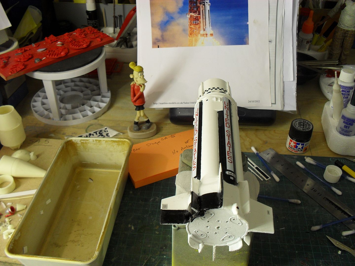

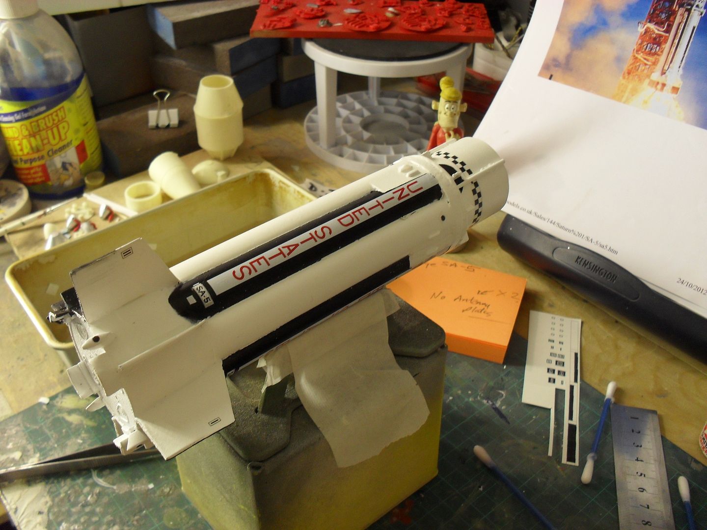

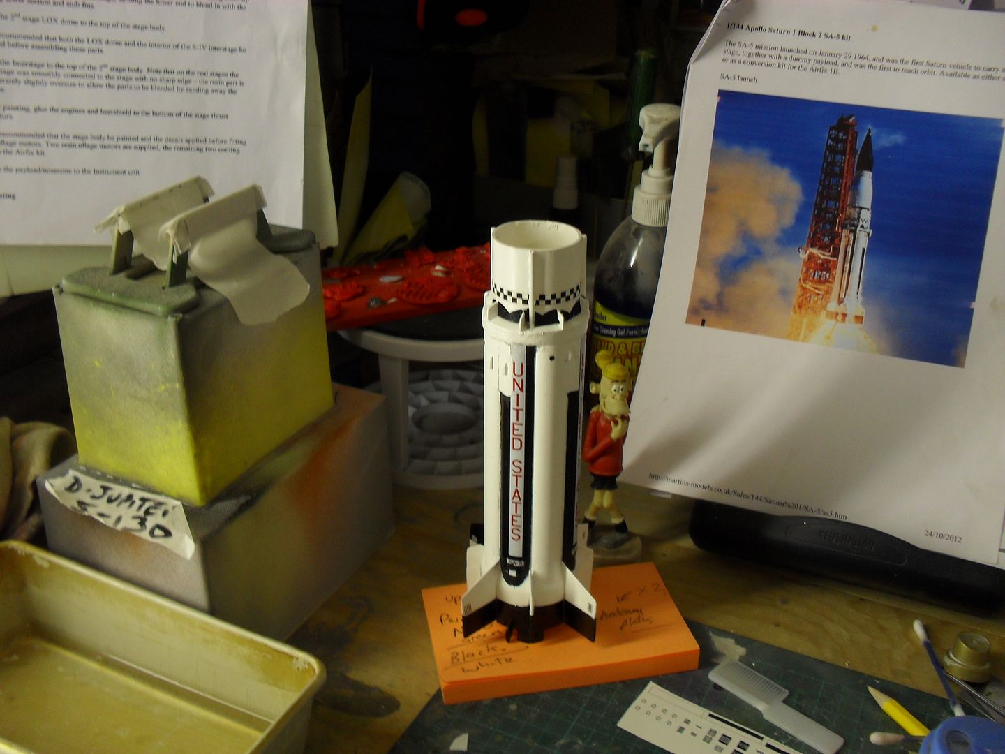

putting a few decals on now as the further work is over top of these,so very hard to do afterwards,ive used some of the decals off the airfix kit for this one,
lokks a bit rough,but it will clean up later,i hope?

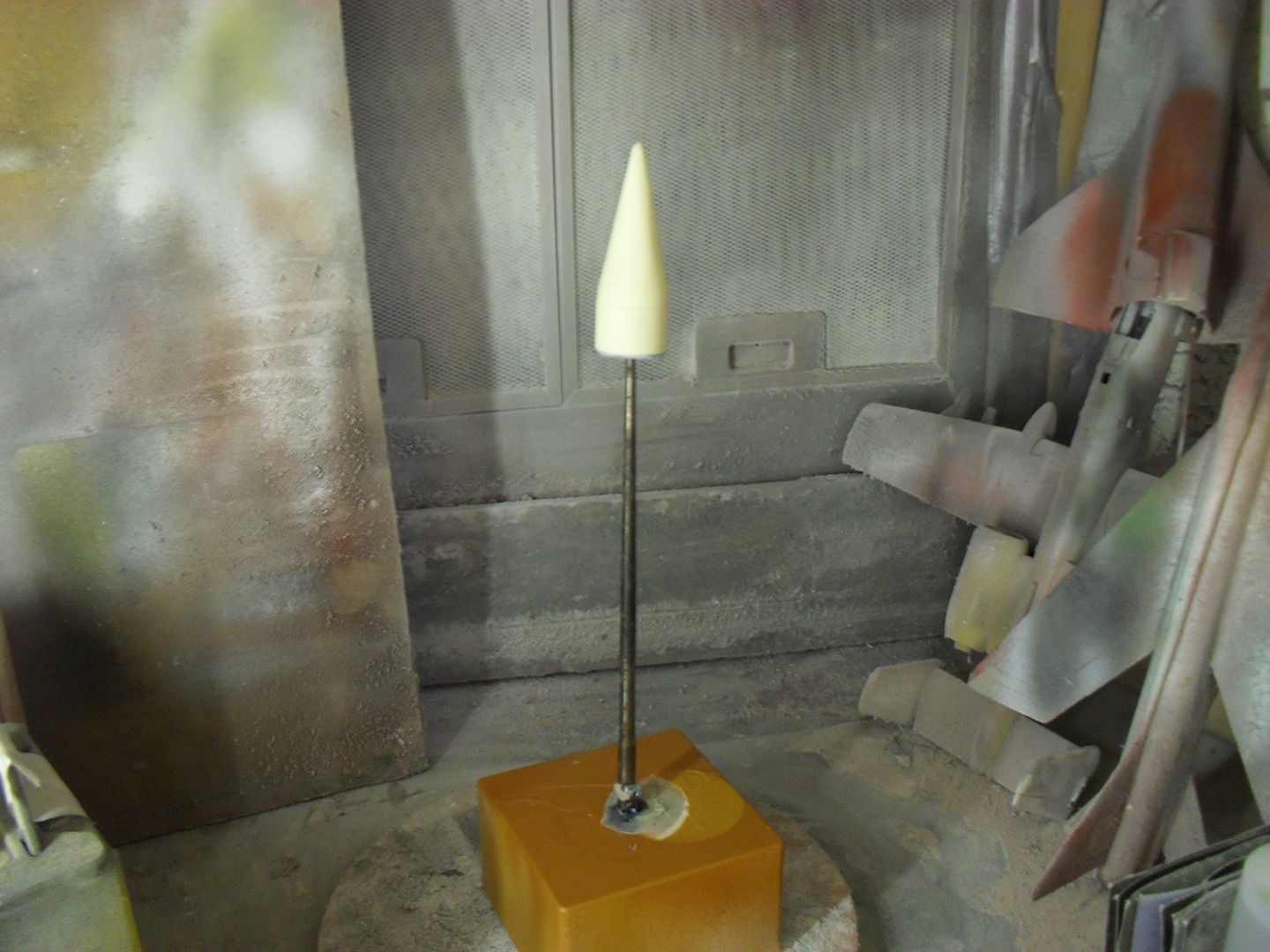

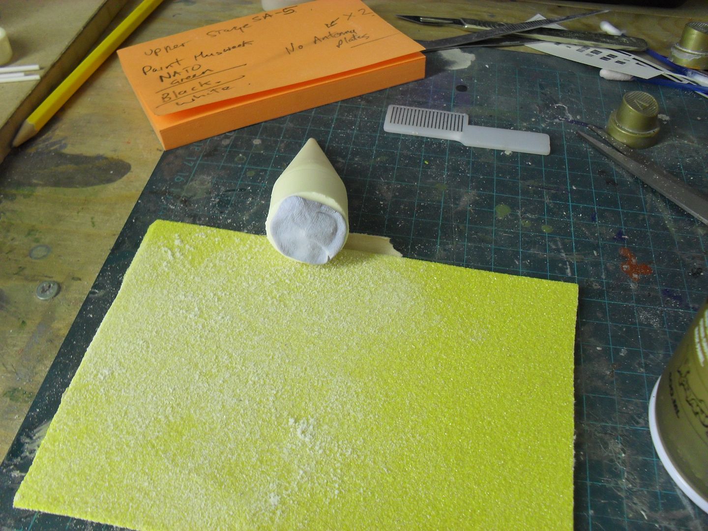

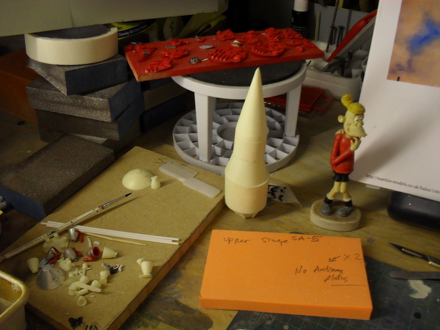

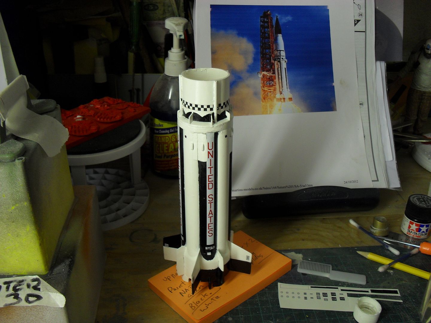

getting ready to mate the Jupiter nosecone to the upper stage,a bit of sanding...
trying to cut black decals to make the castellation effect,of the clustered tanks,you could paint it,if your careful,or stamp it on with a imprint and pad?
but this will do me...

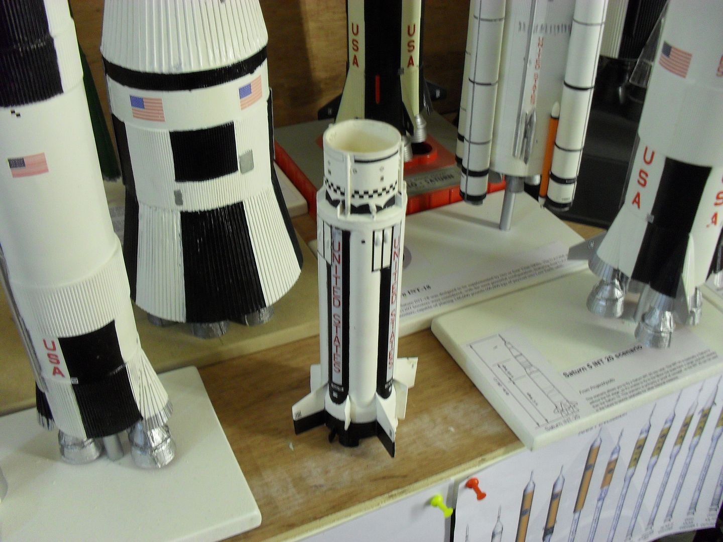

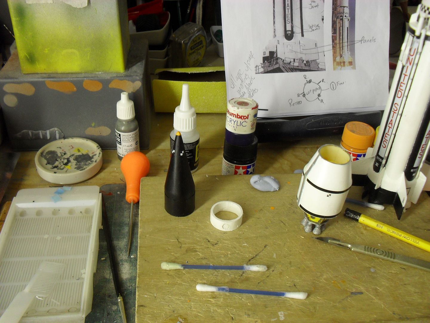

HI a few more pics...
not looking too shoddy,

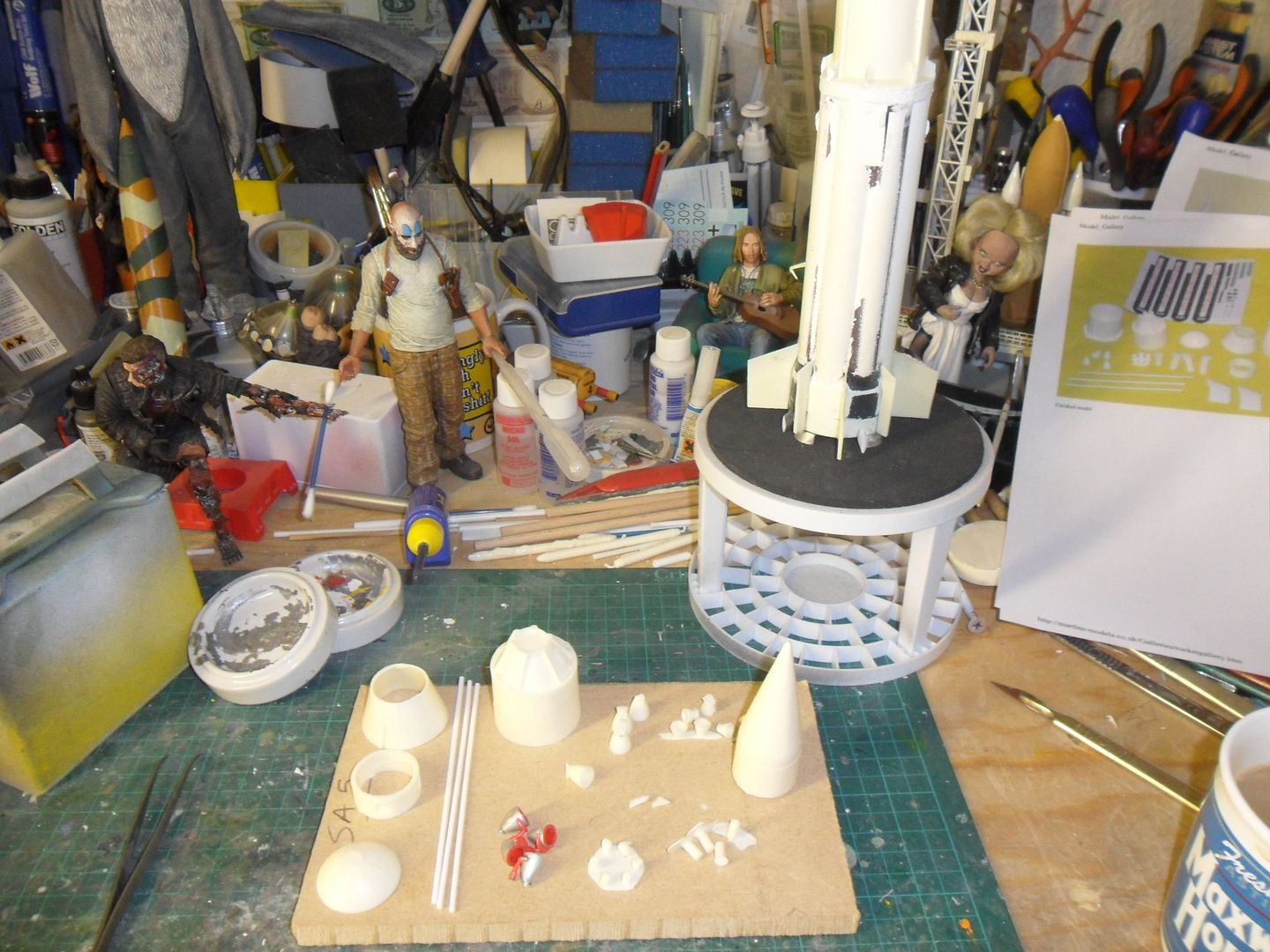

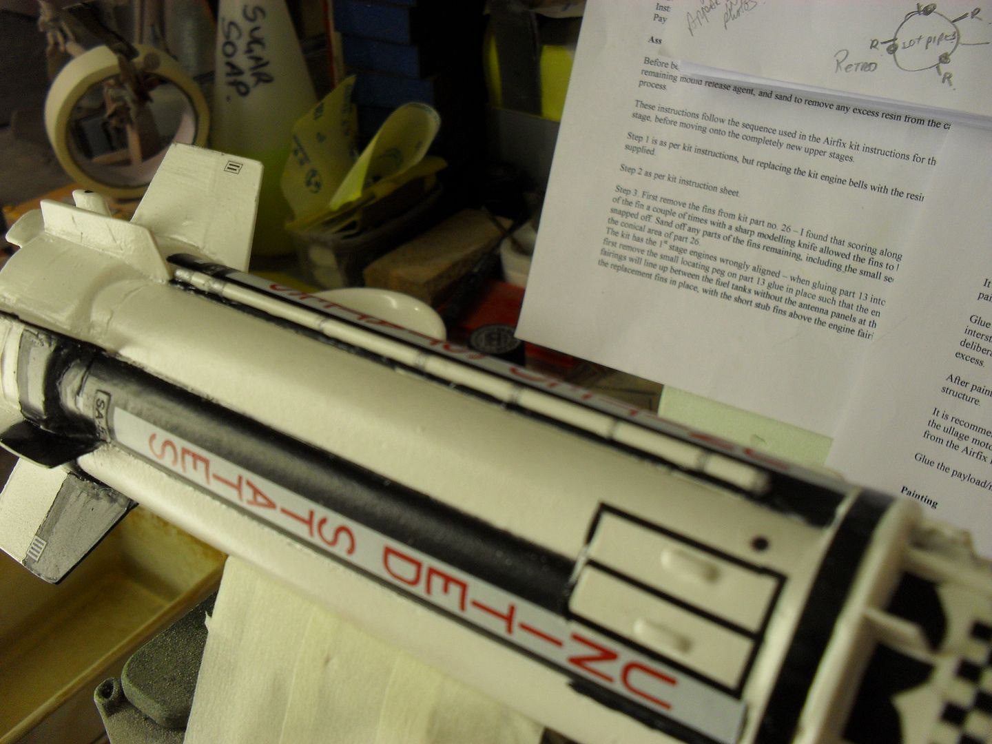

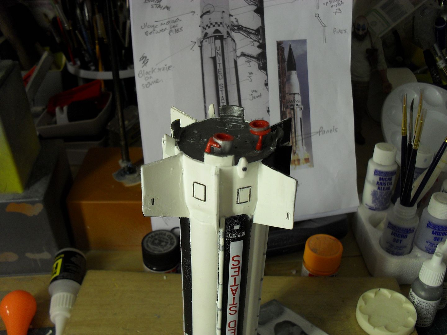

starting on the upper stage and lower stage furniture...

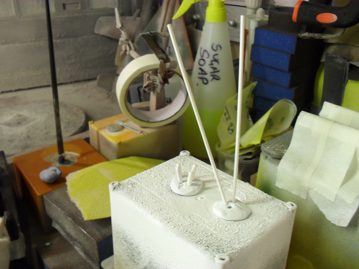

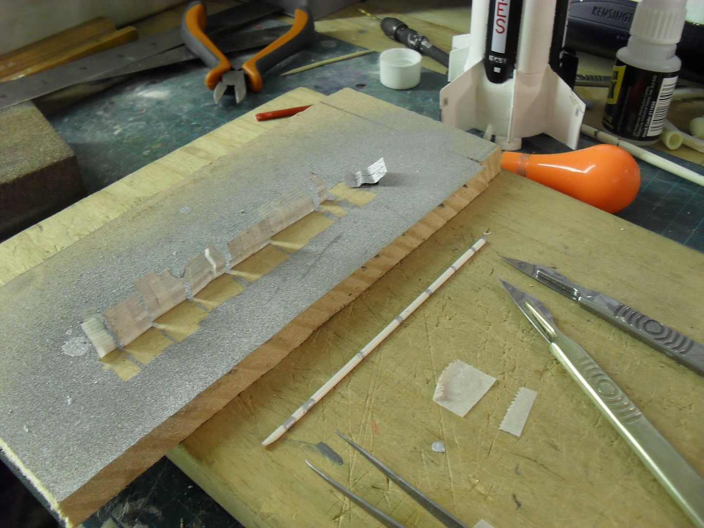

firrst im painting the dowel rod,supplied,to imitate the lox pipes?on the outside of the tanks,not on previous versions,also cutting dowel for the retro,s

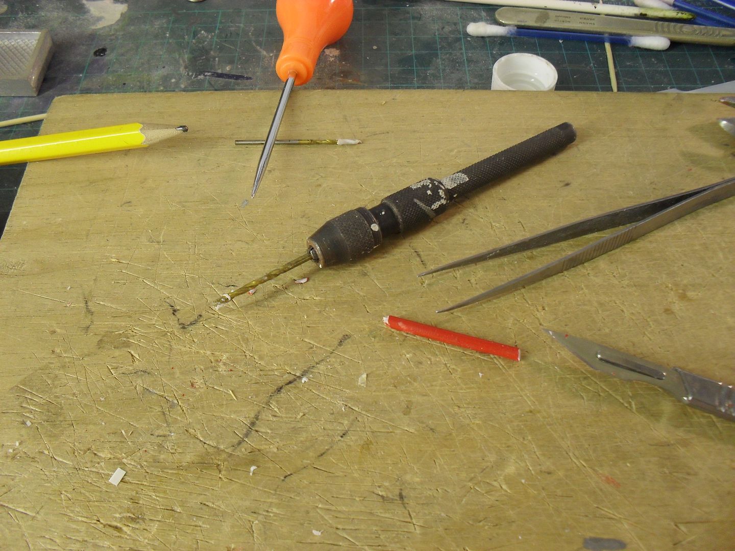

drilling and cutting the retro,s
put some paint stripes on to simulate the pipe brackets,seen on some photo,s
so get your lower stage,and make sure you start to fit the pipes,in the posistion on your photo,s

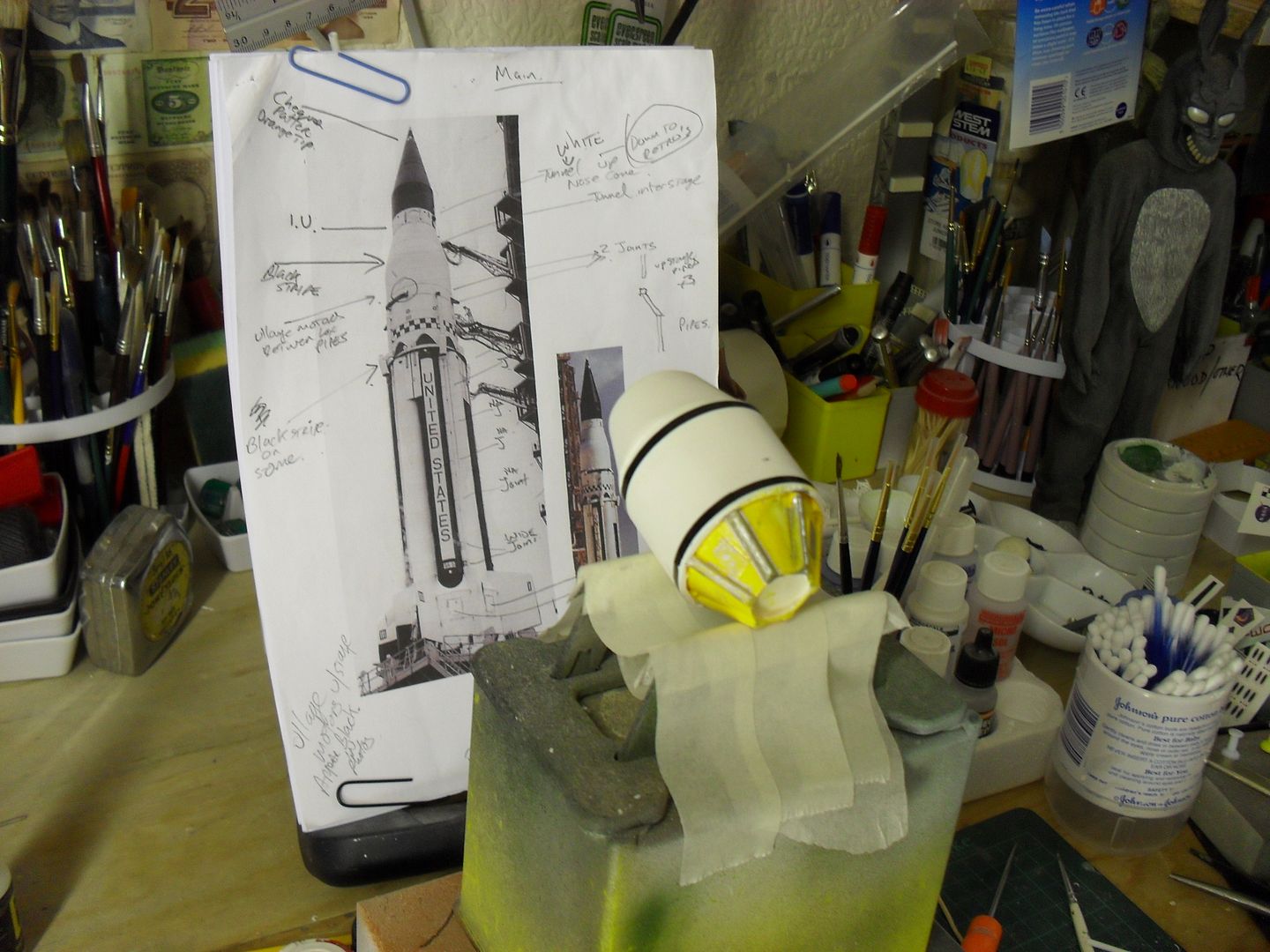

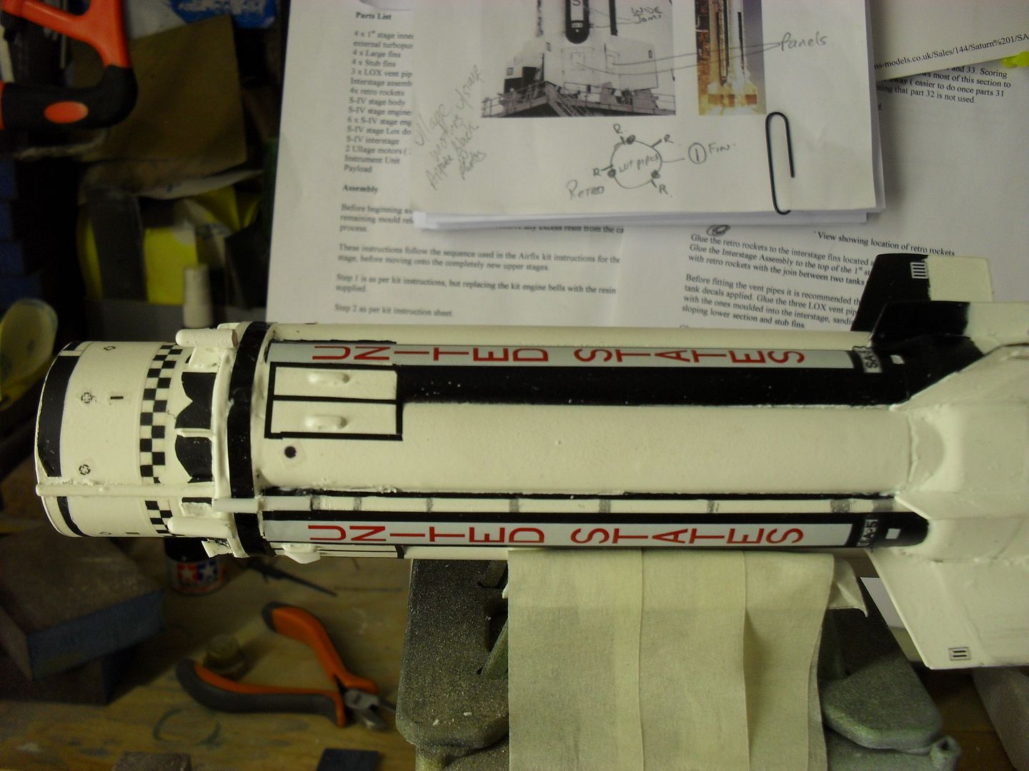

now a bit of colour on the upper stage,though not seen..

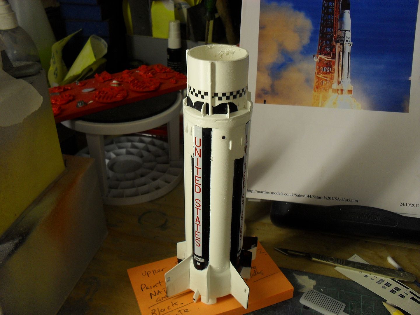

you can see in the background the photo i used,i find its easier,for someone who does,nt want an historical scale replica,just a model?,just find one good photo and work to the detail on that,cos i guarantee,yo will never finish otherwise,as i find photo,s later of other lines etc,i could of put on,...but hey thats just me?,,it passe,s as a sa5 ,it is an sa5
this is the instrument ring,seen on all the apollo moonflights,i think this was its first outing,the circular holes are where trays of instruments were slid in?..
jupiter nose cone painted,and roll decals fitted,
lox pipes you can see have to be hinged out over the stage flange...

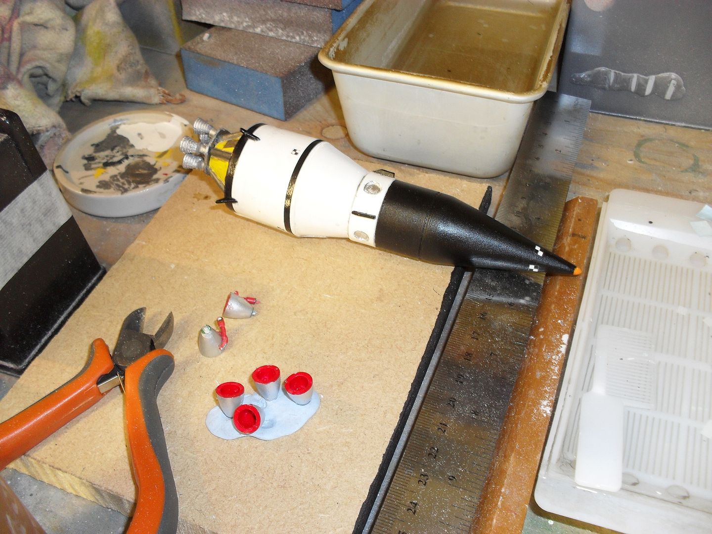

the engines the kit uses 4 of the airfix engines as the inner 4 were different to later ones..so 4 kit,and 4 airfix

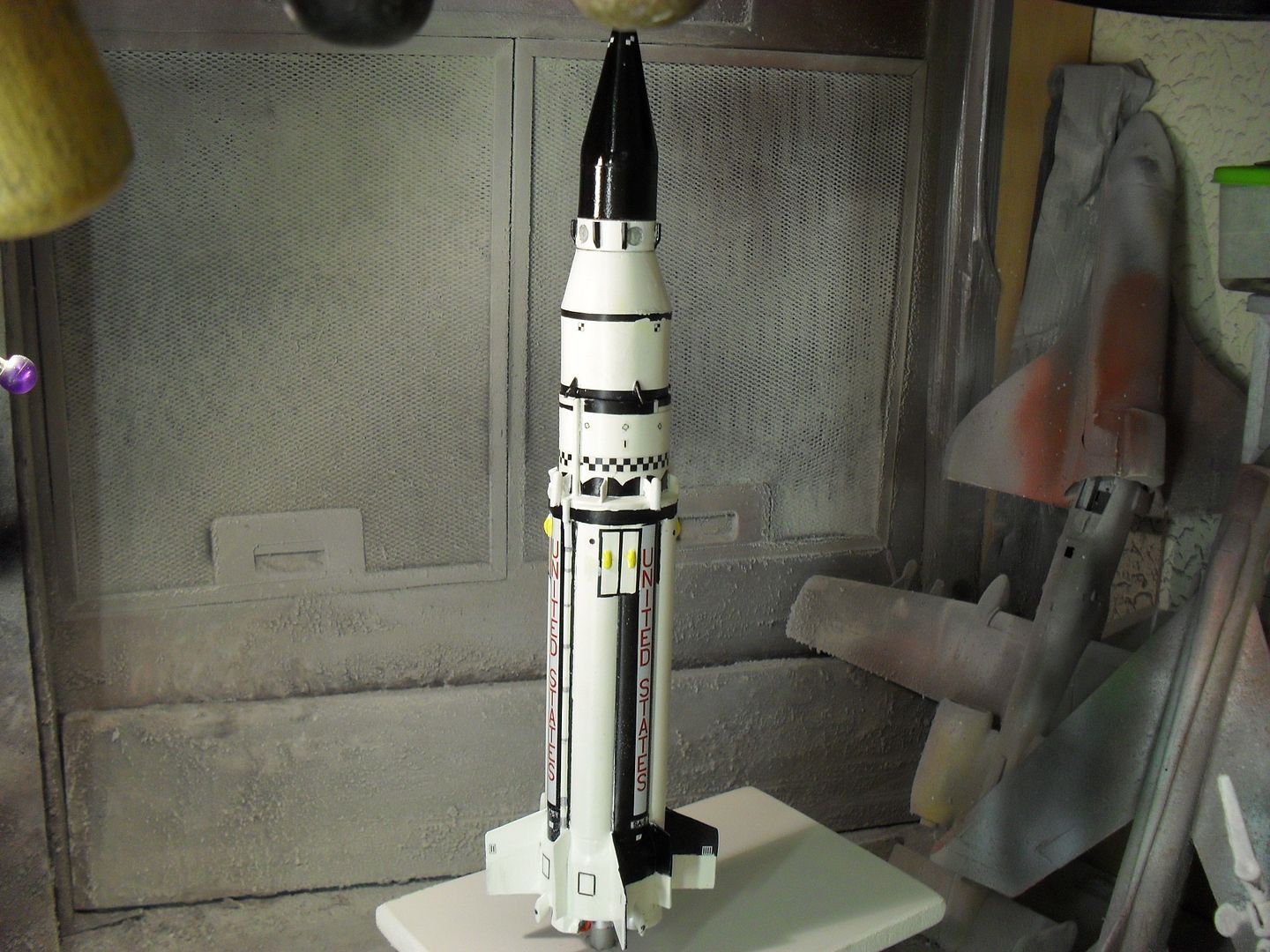

mating up the jupiter nosecone and the upper stage,complete with its engines and heatshield..
sorry got to go,and have my sunday bath?....cheers Don

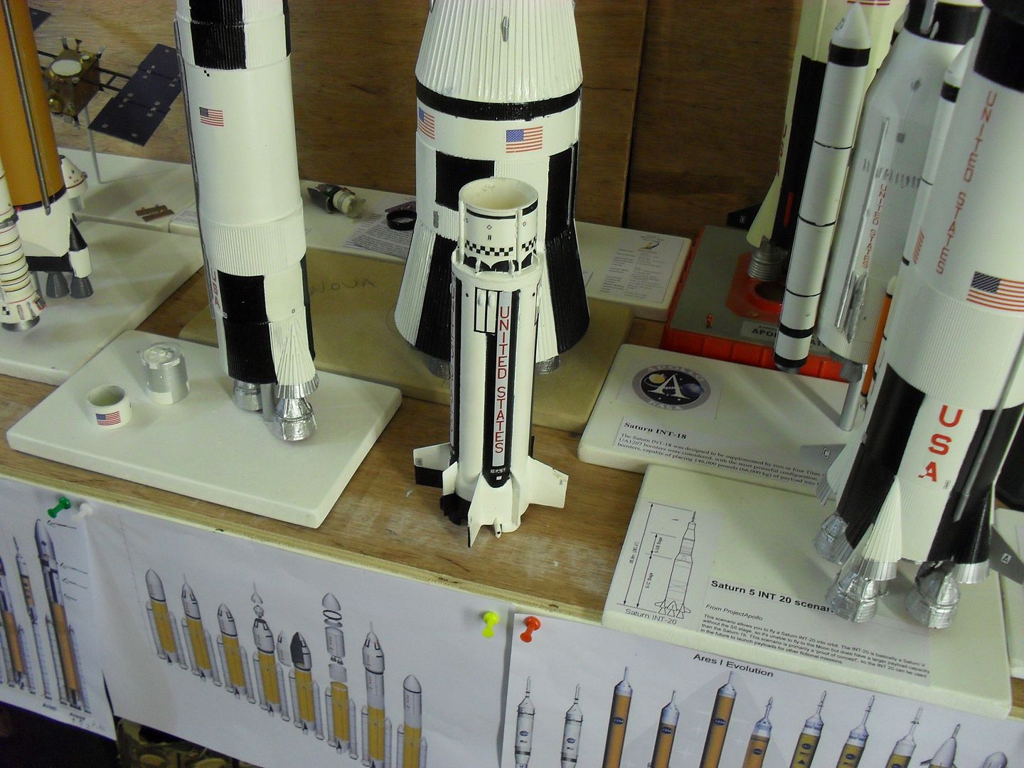

HI,LAST PICS,before i do the base,and call it finished.....
well that it,a very important rocket,in the space race,thanks for looking,and perseveering,next pics,in the finished section
