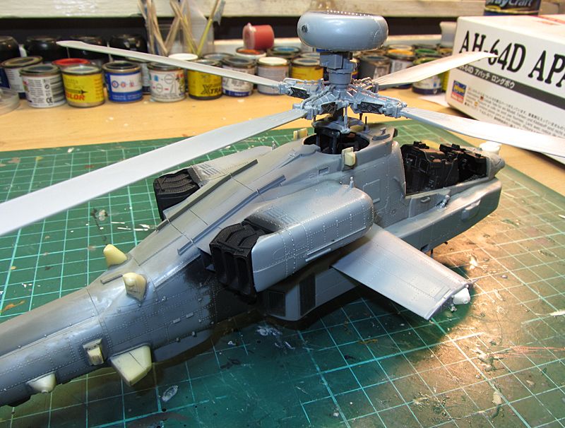

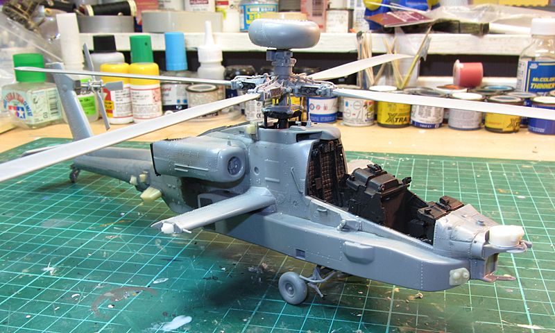

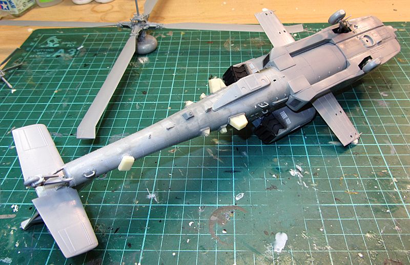

Shaun Posted February 25, 2014 Posted February 25, 2014 (edited) Here's a pic of the progress on my Longbow, almost ready for primer just a few small things to sort out (removing the redundant fuselage sensors is one of these small jobs from the 4 point HIDAS arrangement) before painting. Shaun Edited February 25, 2014 by Shaun 2
