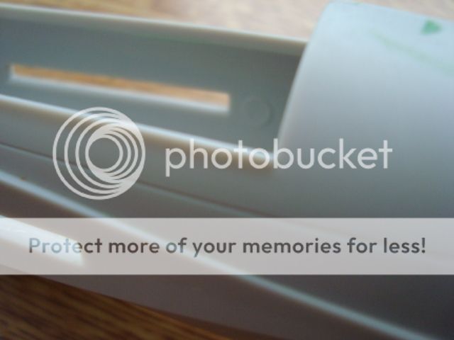

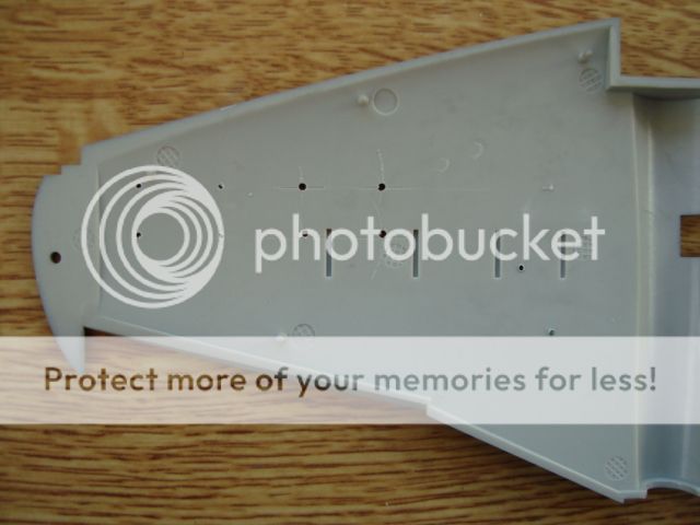

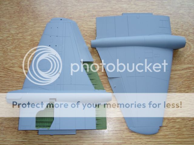

canberra kid Posted March 20, 2013 Author Share Posted March 20, 2013 Back to the wings, one other thing that Airfix and Italeri in there 1/72 Canberra's have got wrong concerns the gas vent for the engine starter cartridge. One the two kits they have moulded two vents as it is with the Canberra's using the Avon Mk.1 in fact the J.65 should just have one. On the plus side Airfix have done a very respectable job with the generator intakes. John 1 Link to comment Share on other sites More sharing options...

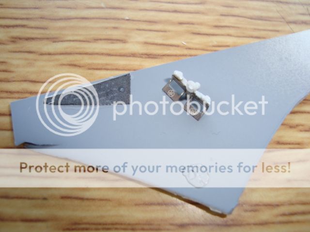

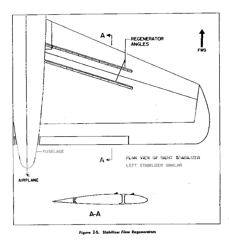

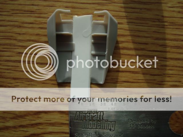

canberra kid Posted March 20, 2013 Author Share Posted March 20, 2013 In common with all 1/48 Airfix Canberra's the tail planes in the kit are totally devoid of detail so I have now scribed the detail and added the Stabilizer Flow Regenerators. The What? I hear you say, yes the SFR's I had no idea these things existed until recently. They appear to be something like vortex generators. The bad news is now I've found them I had a look around and I think they my be applicable to all B.57's! John 2 Link to comment Share on other sites More sharing options...

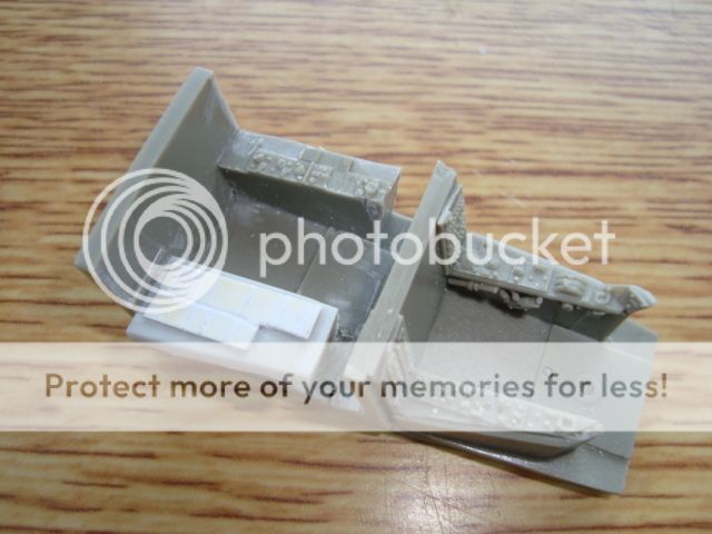

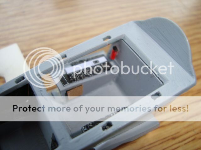

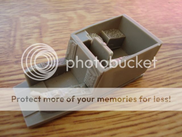

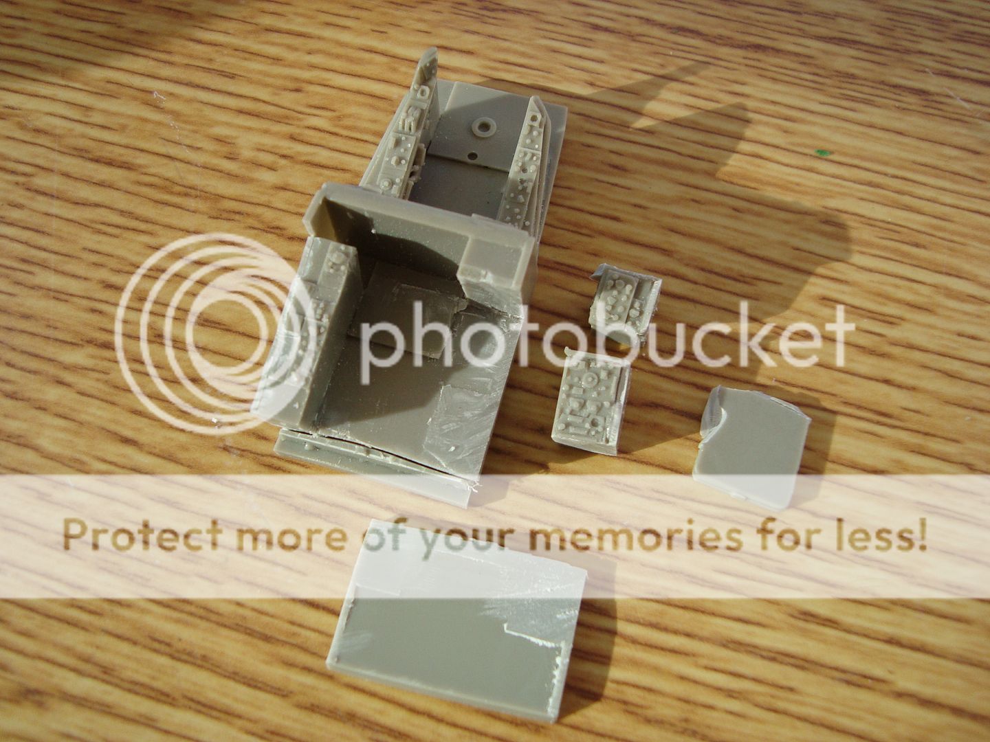

canberra kid Posted March 21, 2013 Author Share Posted March 21, 2013 I've been working on the office, I've added the hand held fire extinguisher made from a bit of sprue and positioned on the rear bulkhead, also the SO's map case. I'll be fitting the first aid kit to the rear port console later. I've also copied the circuit breaker panel from the illustration in the Flight Manuel, this is one of the things missing from the Edward set. This goes on the rear starboard side wall. The rudder peddles have been modified using the Airfix part and the PE part from the Edward set. John 1 Link to comment Share on other sites More sharing options...

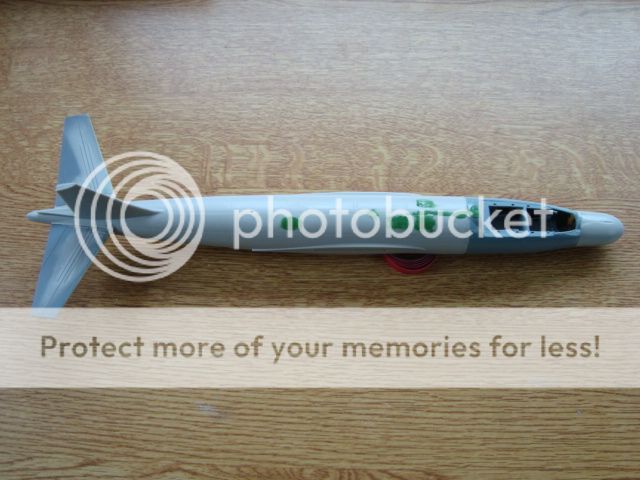

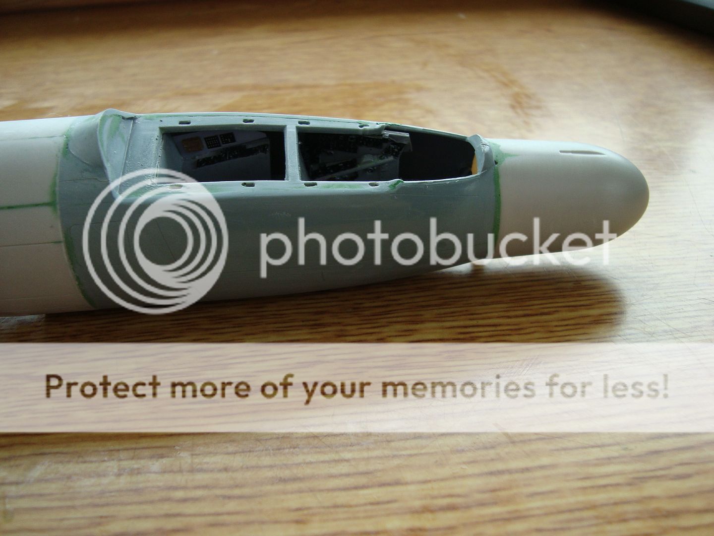

canberra kid Posted March 22, 2013 Author Share Posted March 22, 2013 With the wings now to all intent and purposes finished I thought I'd get the fuselage moved on a bit. The CA nose has been mated to the Airfix fuselage with out too much problem. John 2 Link to comment Share on other sites More sharing options...

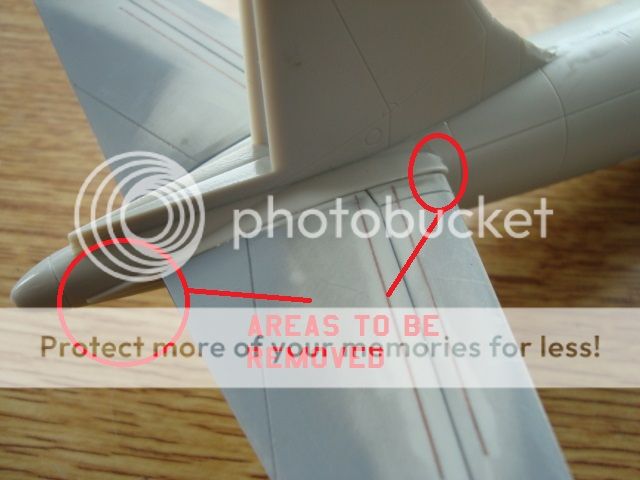

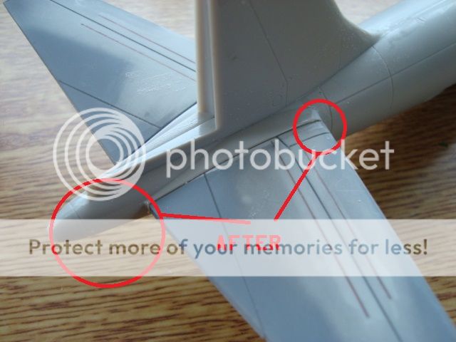

canberra kid Posted March 22, 2013 Author Share Posted March 22, 2013 Another issue with the Airfix Canberra's concerns the tail planes, on the Canberra the leading edge on the tail planes is a strait line up to the fuselage, as in the above drawing. On the kit there is a kink in the leading edge. If you wish to use them there are some very good replacement parts out there like Two Mikes set to correct this, but being a tight-fisted Yorkshire man I've found a way using the kit parts. What I do is cut about 3mm from the tab on the kit part, this enables you to slide the tail planes back thus created a step that if you cut back will straiten up the leading edge. After a bit of trimming and re profiling, you end up with a tail plane that looks as it should. Another thing that Airfix and as far as I can remember all other Canberra kit manufacturers have done is mould a elevator shaped stub fairing on the fuselage, this dose not exist on any Canberra and should be removed. And John 2 1 Link to comment Share on other sites More sharing options...
JasonC Posted March 22, 2013 Share Posted March 22, 2013 Looks like it's going well; very neat work. What exactly did you use for those regenerators? Looks like copper strip of some sort? cheers, Jason Link to comment Share on other sites More sharing options...

canberra kid Posted March 23, 2013 Author Share Posted March 23, 2013 Looks like it's going well; very neat work. What exactly did you use for those regenerators? Looks like copper strip of some sort? cheers, Jason Thanks Jason, The regenerators are made from fine plastic rod, in reality they should be 'L' shaped as per the drawing, but I can't find anything that looks in scale so this will have to do. Ones it's painted I don't think it will matter that much. Wow, hate to admit it but I know precious little about the Canberra save that it's an iconic British design, a gorgeous aircraft, looks like it must have been a joy to fly and a I know a few blokes who flew it. But I love this thread and I'm learning loads! Can't be bad. Thanks John Steve Shame on you Steve! if you want to delve in to the Canberra more take a look at my site, http://ipmscanberrasig.webs.com/ Well your doing some dn amazing stuff here canberrakid I remember a few years back stumbling accross some of your builds which were very nice and obviously memorable too. So I'm keen to see this and look at what goes into creating a stunner of a build. I like what you have done with the map and fire extinguisher Cheers rob Thanks Rob, this build thread as it is at the moment an edited version of the full build I'm doing on my site http://ipmscanberrasig.webs.com/apps/forums/topics/show/8621422-1-48-airfix-classic-airframes-13-bs-b-57g- when I catch up I'll be posting the two at the same time. John Link to comment Share on other sites More sharing options...

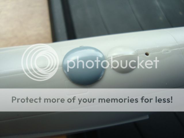

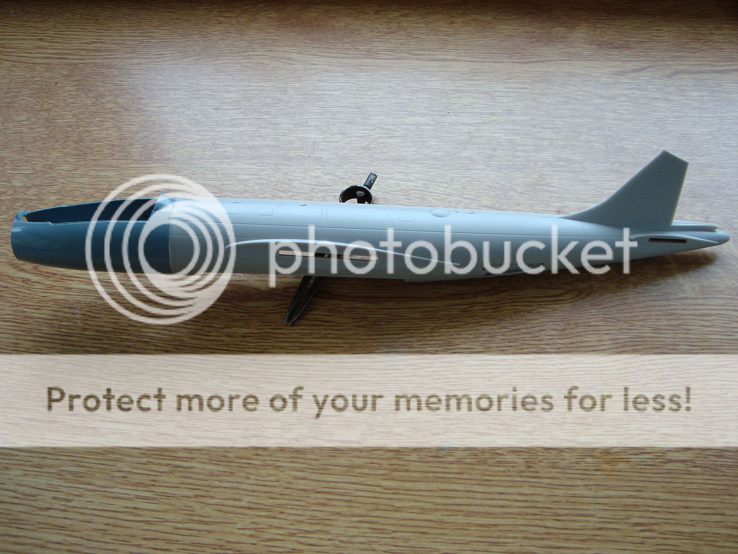

canberra kid Posted March 23, 2013 Author Share Posted March 23, 2013 Now the fuselage is together my first job will be to correct the two aerial fairings the domed shaped lumps aft of the bomb bay. Airfix is right to include two of these, for a latter B.57B but again for reasons best known to Airfix they have moulded them as different sizes when they should be the same. The one on the underside is the more correct of the two. Unfortunately for any one wishing to build a B.57G the bottom one needs to be removed this will leave you with the one on the top which you need to keep, but of the two it is this one that is the wrong size! To get around this problem I will be removing the Airfix one and replacing it with one from the CA kit. I've also filled in the three fictitious fuel filler points on the starboard side of the fuselage as well as the front one of the three on the port side as the B.57's only have two. As you can see the major fuselage components are now together. I'll need to do some filling and re engraving of the panel lines, as with the wings the fuselage of the B.57 were skinned in a different way to her British sister. The first phase of filling is done, I'm quite pleased with the way it's looking the joint between the Airfix and CA fuselage appears to be quite good John 1 1 Link to comment Share on other sites More sharing options...

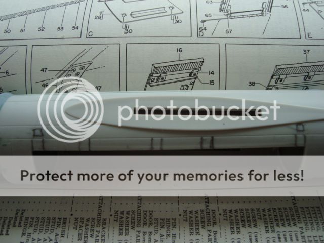

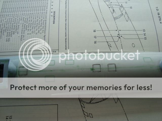

canberra kid Posted March 23, 2013 Author Share Posted March 23, 2013 I'm going to address another of Airfix's fictions, this time the ridge that runs along the top edge of the bomb bay. This is quite correct for the British Canberra's, but it is not applicable to the B.57, so off it comes! More work on the fuselage, working from my manuals to check accuracy, I've engraved the doors that are associated with the operation of the rotary bomb bay. Also the hatches on the crown of the fuselage that allow access to the fuel cells for maintenance and removal and reinstalling. John 1 Link to comment Share on other sites More sharing options...
robvulcan Posted March 23, 2013 Share Posted March 23, 2013 Beautifull work how do you go about marking out accurately and taking account if the curvature I'd love to get my hand on aircraft manuals for certain aircraft Link to comment Share on other sites More sharing options...
