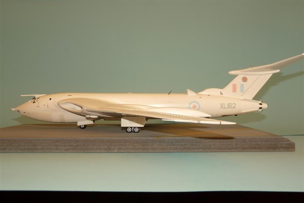

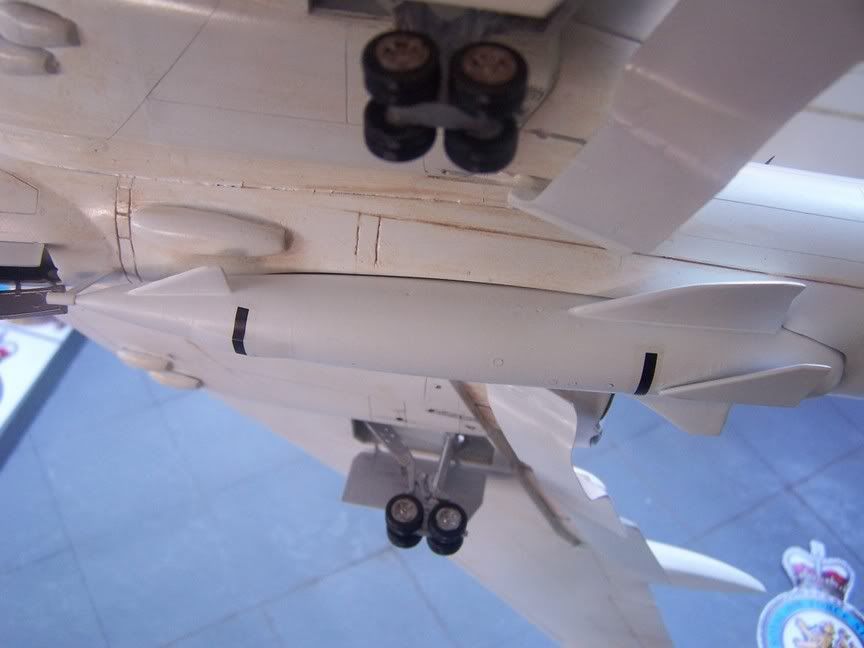

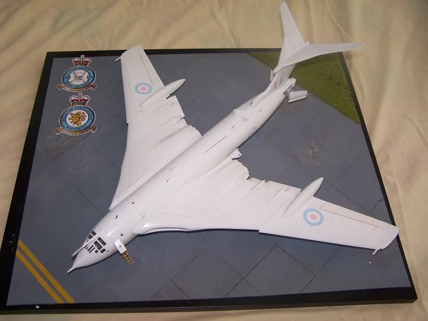

general melchett Posted January 25, 2013 Share Posted January 25, 2013 (edited) Phil, I did the XL163 Victor B2R a while back, though I left the missile off as it's a separate display item, there's a fair bit of work involved in making a decent Blue Steel Victor as I'm sure you're now aware. As already mentioned longer outer wings are needed, the Vulcan Blue Steel insert and missile, (the missile needs to be recessed further into the bay to sit properly), the tail cone needs replacing with Terry's parts which include the ECM warts, outer wings need to be twisted slightly so that the 'carrots' lie horizontal to the fuselage datum line, a new tailplane bullet as the kits one is pants, in fact Terry also does the whole tail plane with the missing fairing and new bullet, a new nose pitot, APU intake/exhaust, Blue Steel cooler fairing,engine intakes, thinned down refueling probe etc, etc, etc..perhaps the hardest thing to fix though is the canopy, the kit's glazing doesn't come down far enough at the sides. I used Terry's vac ones, (it's clear and so you can put the windows in the correct place later in the build). I'm also sorting out new ECM cooling intakes with Terry as the kit's ones are way too small). The Flightpath set is a pretty good route to go down as it includes the resin intakes. I've also got the Ray Rimmel article, a very good guide to go by. Hope this helps and hopefully doesn't put you off, if you want any advice at all, just drop me a PM, only to glad to help,....................now come on Airfix, you know it makes sense !! Melchie... Here's my first one, XL162 of 139 squadron, B2R trials aircraft, Flightpath tailplane bullet and scratch built ECM cooling intakes fitted, ( also moved the main gear back 5mm so that they are central to the doors where they should be), I'm also in the process of building a 543 squadron SR2. with the help of Dennis Robinson, (sloegin1958). These photos show most of the new resin parts in place, (the canopy is the Flightpath one which I've now ditched in favour of the vac one), We at the Bomber Command sig have now built a few Blue Steel Victors with more to follow, here's Terry's Wittering wing XL231 , And Richard Farrar's B2R XL513 in experimental initial camo scheme, Edited January 25, 2013 by general melchett Link to comment Share on other sites More sharing options...
