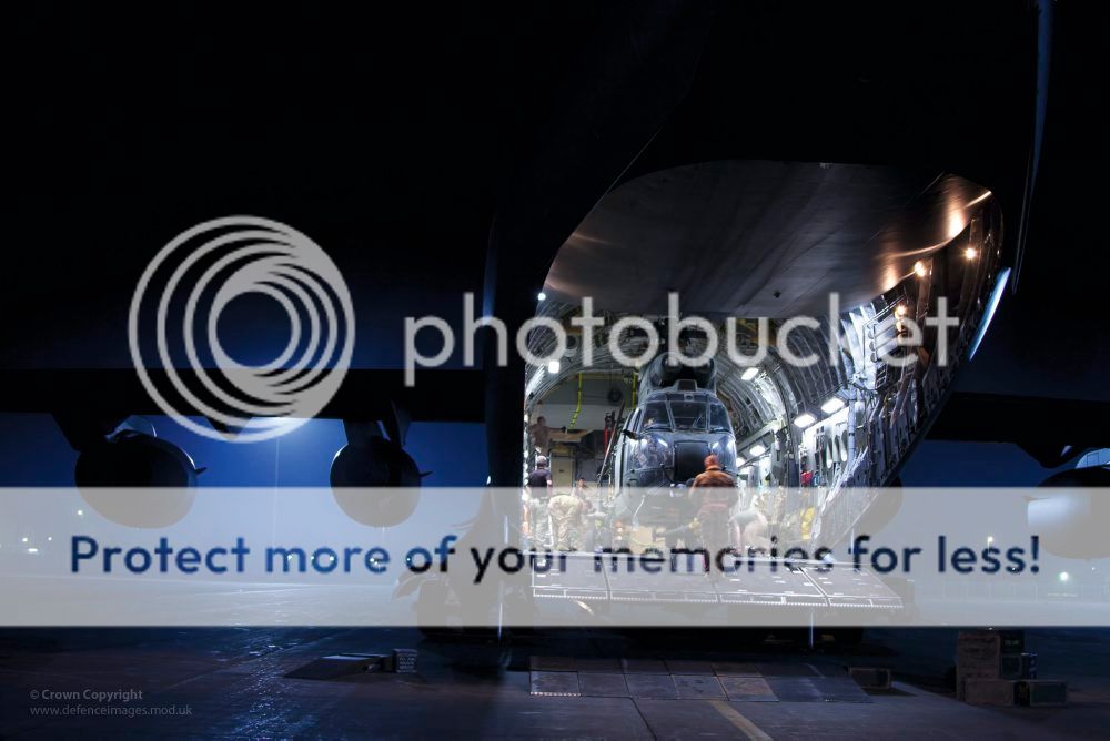

VulcanXH558 Posted December 29, 2012 Share Posted December 29, 2012 (edited) Here's a photograph of an RAF Puma in the back of a C-17, with the rotors removed for transportation: I've come across one or two other photographs of RAF Puma's in storage and being unloaded from ships with the rotors removed aswell: Chris Edited December 29, 2012 by VulcanXH558 Link to comment Share on other sites More sharing options...

TimB Posted December 30, 2012 Share Posted December 30, 2012 I think you might be able to - but you would almost certainly have to disconnect the pitch change links to get the blades to a reasonable angle. I can't see the PCLs on the French photo above, so they may have been disconnected on it. On balance, removing the blades is probably easier. For transport, they were often loaded into the cabin through the rear hatch. Incidentally, operating a Puma from a ship (as opposed to transporting it and flying it from the deck in good weather) is not smart. There is a terrifying video of the French sea trials showing lots of matelots trying to stop the aircraft falling over.... Regards Tim Link to comment Share on other sites More sharing options...
