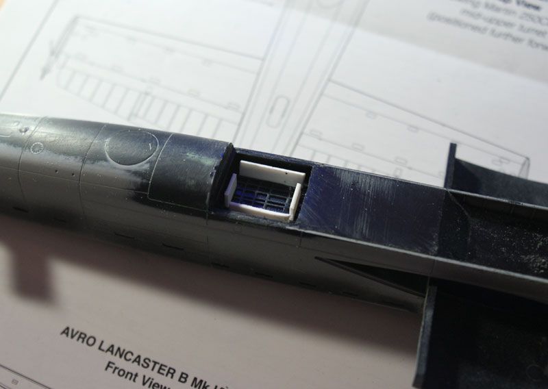

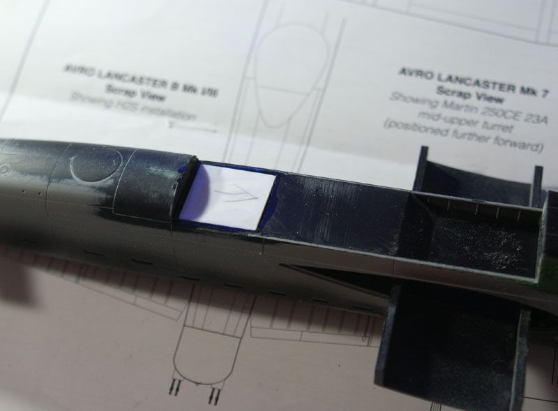

woody37 Posted December 31, 2012 Author Share Posted December 31, 2012 I'm using the drawing Chadders provided on page 3 to build the fairing, this is straight along the sides not rounded like the Airfix kit. How accurate I don't know, but I'm on with it now, sometimes, you just godda go with it !!! Miggers, thanks. The yellow hand rail is no longer yellow, I'll remove that box on a stick, I didn't know it was a H2S box, cheers. Link to comment Share on other sites More sharing options...
chaddy Posted December 31, 2012 Share Posted December 31, 2012 (edited) I'm using the drawing Chadders provided on page 3 to build the fairing, this is straight along the sides not rounded like the Airfix kit. How accurate I don't know, but I'm on with it now, sometimes, you just godda go with it !!! Miggers, thanks. The yellow hand rail is no longer yellow, I'll remove that box on a stick, I didn't know it was a H2S box, cheers. That's as good as anything. Without that AVRO part drawing or photographic evidence the exact shape of the fairing is difficult to ascertain anyway. Cheers Edited December 31, 2012 by chaddy Link to comment Share on other sites More sharing options...

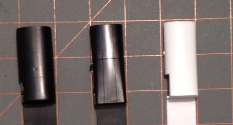

dogsbody Posted December 31, 2012 Share Posted December 31, 2012 I have just taken 2 images comparing 3 Dambuster weapons bays. Left to Right: 1960's Revell; New Revell; Airfix Chris Link to comment Share on other sites More sharing options...
chaddy Posted December 31, 2012 Share Posted December 31, 2012 I have just taken 2 images comparing 3 Dambuster weapons bays. Left to Right: 1960's Revell; New Revell; Airfix Chris Interestingly none of those seem to show the "join" along the centre line of the front fairing. That was closed by four clips. This allowed the front fairing to hinge open like the normal bomb doors, and allow access when loading the mine (if necessary). Cheers Link to comment Share on other sites More sharing options...

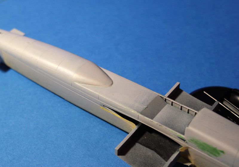

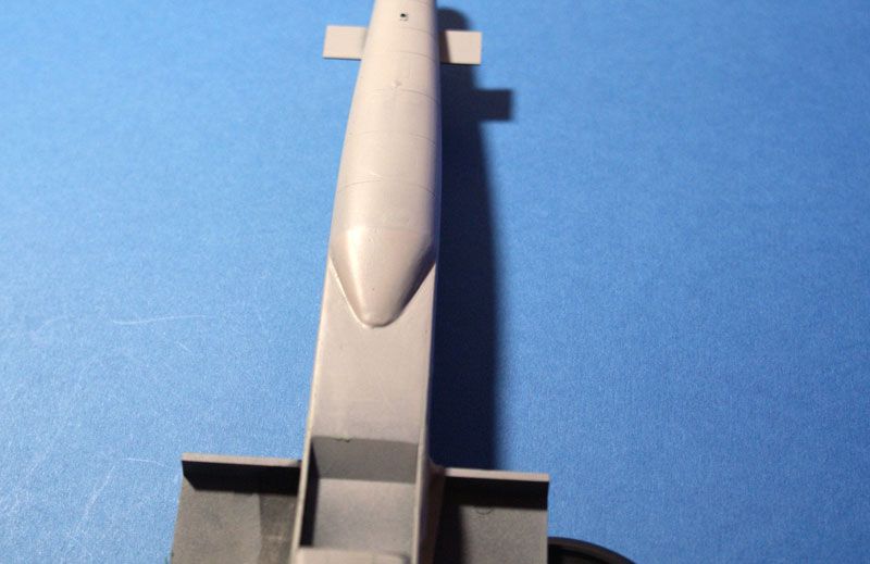

woody37 Posted January 1, 2013 Author Share Posted January 1, 2013 Here's the mods to correct the Revell rear bomb bay. There's still some final tidying up to do, but you get the general idea. I've used the drawing on page 3 that Chaddy posted to get the profile, it's not as rounded as the airfix kit part and I dare say there is some discussion as to what is actually correct, but it's certainly better than it was !!! Step 1 - cut off the offending part: Step 2 - put some packing spacers in. The hole is 5.5mm deep, as I am using 1mm plasticard, I made spacers 4.5mm deep. Step3 - Fill the hole with plasticard and fill gaps with filler Step 4 - make a frame for the filler and mask the area for the profile Step 5 - Fill and sand the profile - I used P38 which dries really quickly, ideal for impatient modellers !!! Some final tidying up of the area needed before moving on to the clear part masking for the overall prime. Cheers Link to comment Share on other sites More sharing options...
Smiffy Posted January 1, 2013 Share Posted January 1, 2013 Blimey. Wish I could work as quick as you. That doesn't look arf bad, does it?. Nice one. Dambusters is on C5 HD at the mo, btw. I have it on in the background. Link to comment Share on other sites More sharing options...
woody37 Posted January 1, 2013 Author Share Posted January 1, 2013 Cheers Paul, Me too, no better way to be cracking on !!!! Link to comment Share on other sites More sharing options...
dogsbody Posted January 1, 2013 Share Posted January 1, 2013 Nice work on that fairing. Looks good. It's kind of amazing that so little is actually known about these mods to the Dambuster Lancs. You'd think that with the fame that came with the success of the raid that more would be known. I guess with everything being kept so secret 'til well after war's end that some of the little details got lost. Chris Link to comment Share on other sites More sharing options...
chaddy Posted January 1, 2013 Share Posted January 1, 2013 Looking good Neil; nice work. There was a nice shot of it in the film earlier. I'm guessing back then details of the fairing were known to the filmakers. Obviously Upkeep was still secret and exagerated for film purposes though. Considering that Airfix, Matchbox Hasegawa and Tamiya were on the right lines I'm amazed that Revell made another mistake! Cheers Link to comment Share on other sites More sharing options...
