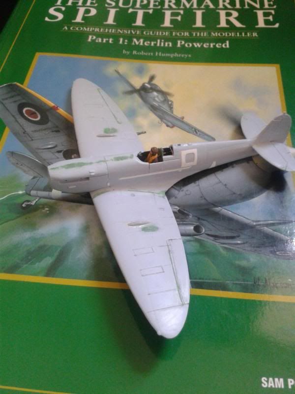

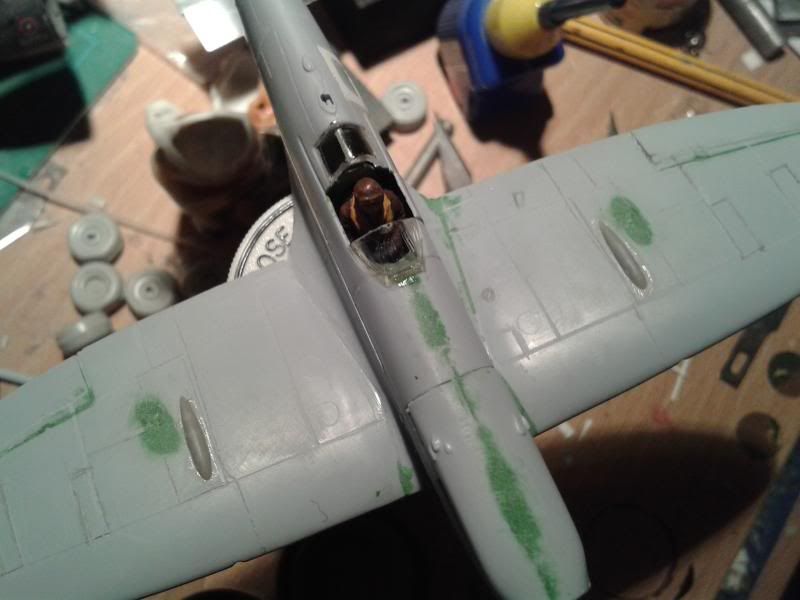

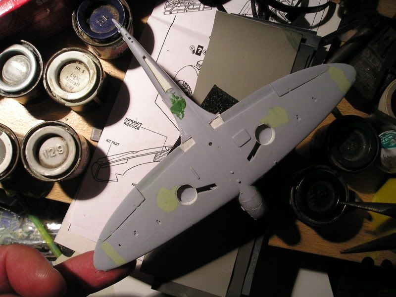

Col. Posted December 4, 2012 Author Share Posted December 4, 2012 You ought to have fitted the upper wing panels to the roots before fitting the lower one piece panel mate. You can fettle and fit to eliminate ALL the gaps without using filler and a difficult sanding job. Did consider that option but it threw everything else out of line such as the ailerons and moved the fit issues toward the thinner outer wing panels. Since all the panel lines are going to be reworked and there's a good bit of mould damage around the wing root anyway I've plenty work to do in that area so may as well get it all done at once in one place Link to comment Share on other sites More sharing options...

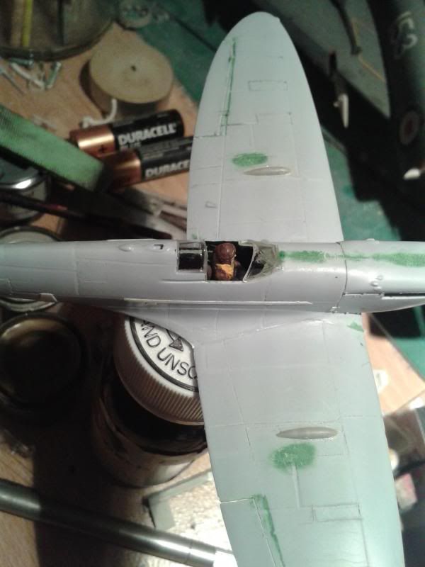

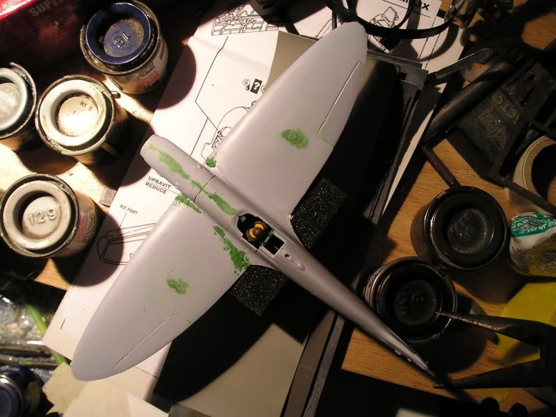

Col. Posted December 6, 2012 Author Share Posted December 6, 2012 Got the wing on after a bit of dry-fitting and modification, plenty glue and a bit of pressure in the right places; Didn't end up being so bad as I anticipated. Once everything is blended in I'll make a start to the panel lines. 1 Link to comment Share on other sites More sharing options...
Giorgio N Posted December 6, 2012 Share Posted December 6, 2012 One thing I totally forgot to mention to you when you started the build: the airfix kit has a wrong depiction of the ailerons: the upper wing line should be further back than the one on the lower wing, while airfix moulded the ailerons with the same chord on both sides. The solution is simply to fill in the upper line and scribe in the correct location... I know, it would have been easier to do it before gluing the wing.. sorry ! Link to comment Share on other sites More sharing options...
Col. Posted December 6, 2012 Author Share Posted December 6, 2012 No worries Giorgio, you mentioned that in good time, only once all the filling and blending is done will I make a start to panel details Link to comment Share on other sites More sharing options...

Col. Posted December 15, 2012 Author Share Posted December 15, 2012 Thank you Roger. The filling & smoothing is done so the scraping and scribing started last night. Think this will take a while... Link to comment Share on other sites More sharing options...

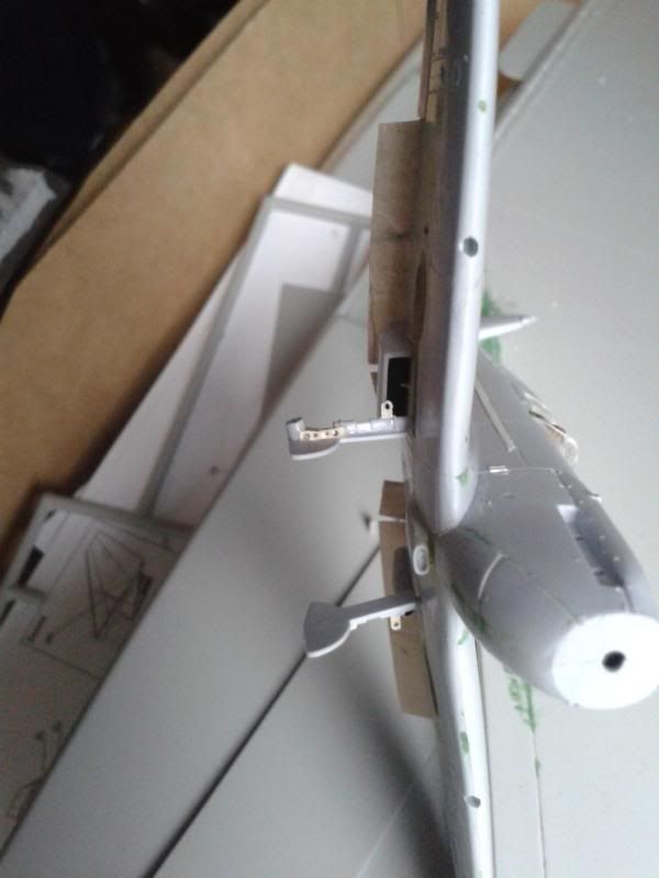

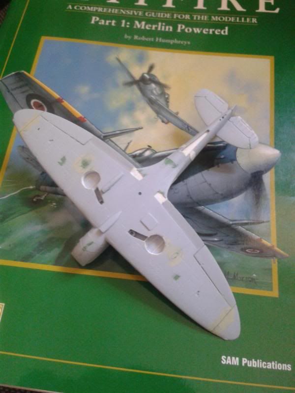

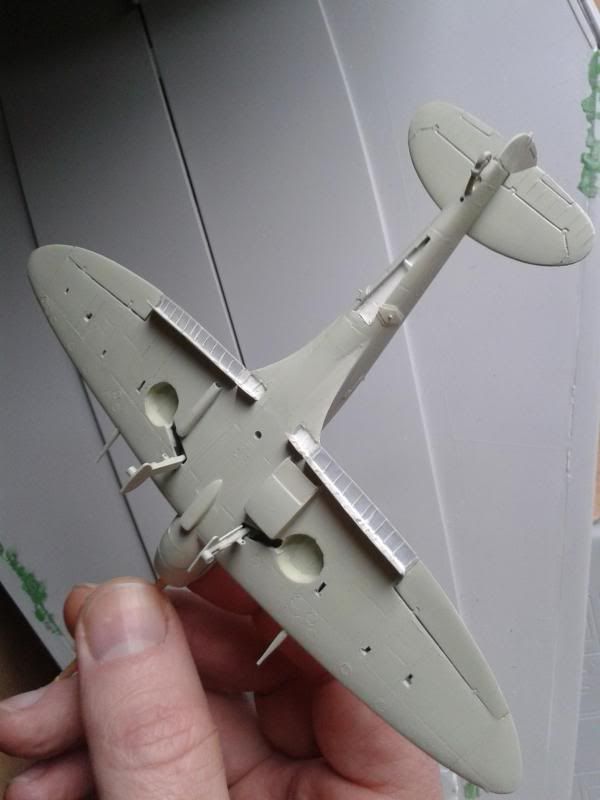

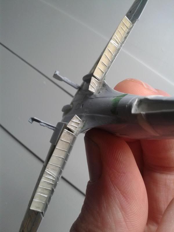

Col. Posted April 10, 2013 Author Share Posted April 10, 2013 Excuse the lack of my presence on the forum gang but a lack of home computer has made participation impossible. Done a bit more to this one at least. Added the fuselage strengthening plates, a windscreen robbed from the KP kit as well as its cannon bulges to the wings then the Airfix carb intake, oil cooler, radiator, tail wheel & u/c legs all slightly modified or detailled to suit then made a start to the flaps. Of course having told you that I now discover I don't know how to add photos via photobucket on this so-called smart phone. Bah. 1 Link to comment Share on other sites More sharing options...
Col. Posted April 11, 2013 Author Share Posted April 11, 2013 Then a bit more done last night; 1 Link to comment Share on other sites More sharing options...

Col. Posted April 13, 2013 Author Share Posted April 13, 2013 Thank you gents. It feels great to be working on it again & making progress. Next task is getting the flaps detailed but think that will take a couple evenings work before I have anything worth showing. Link to comment Share on other sites More sharing options...

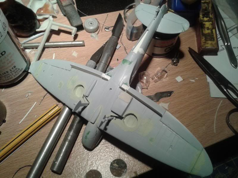

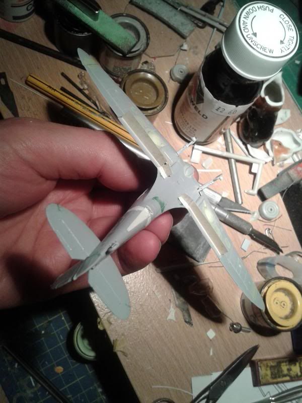

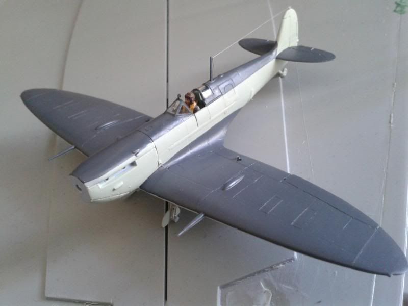

Col. Posted April 23, 2013 Author Share Posted April 23, 2013 Little bit further on; 1 Link to comment Share on other sites More sharing options...
Max Headroom Posted April 23, 2013 Share Posted April 23, 2013 Nice work so far and look forward to further progress. Putting my head over the parapet so to speak, as the III is the equivalent of the Vc (isn't it?) should the undercarriage be raked forward slightly or didn't the Seafires do this? Trevor (possibly talking through my hat) Link to comment Share on other sites More sharing options...
