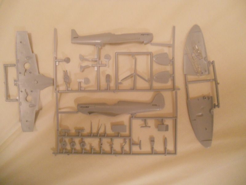

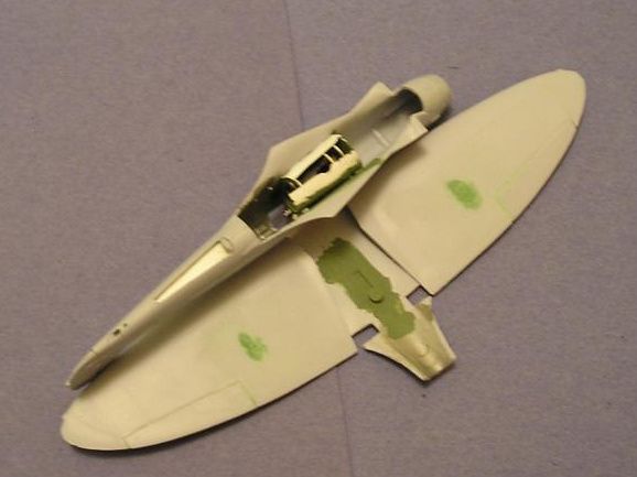

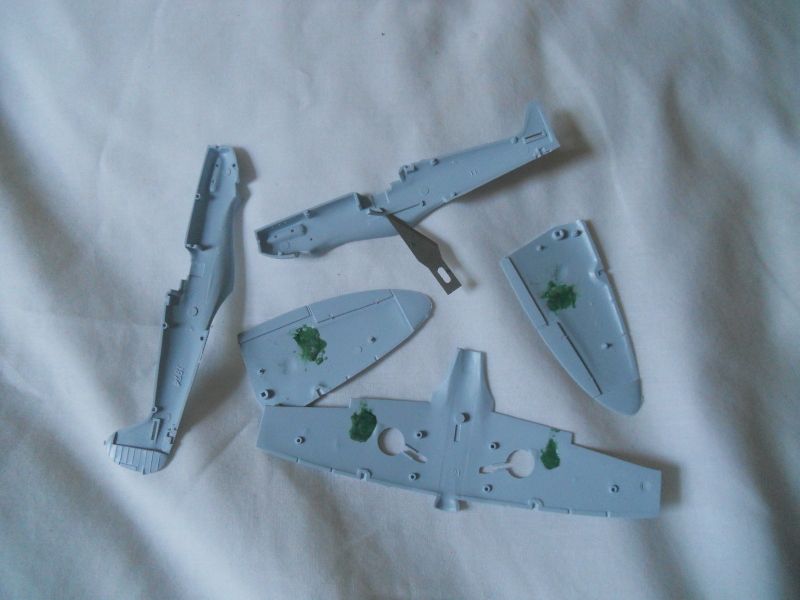

Col. Posted October 17, 2012 Share Posted October 17, 2012 While waiting for paint that has called a halt to another project I started this one to run in conjunction with the Seafire IV being built in the What-if GB. All the references I'm using and most of the modifications required are the same so it seems a good idea. Using the 1974 vintage Airfix kit for this one - its almost as old as me! No box for this one as it came from the BBMF fighters box set, As a Vb there is large bulges on the wing over the cannon loading mechanism not required for the Seafire III so those where filled and cut off. Cockpit is pretty basic with a spurious floor that will need its mounting removed, With that done the sidewalls were thinned down and some detail added. The kit pilot is pretty good so will add him. This means only the seat back can be seen and also helps simplify the number of parts to be made. 2 Link to comment Share on other sites More sharing options...

Giorgio N Posted October 18, 2012 Share Posted October 18, 2012 Great choice, I'll watch with interest. It might be useful to have a Mk.IX kit with you to rob various parts... While you're filling bumps on the wings, the 2 bumps over the wheel well have to go too. Link to comment Share on other sites More sharing options...
Col. Posted October 18, 2012 Author Share Posted October 18, 2012 Funny you should say that Giorgio but it was a Mk.IX kit that started this project. It was reserved for the What-if GB as a Seafire IV but proved so rubbish - think it's an old KP one - I bought the Airfix new tool kit for that task and decided to build a III in parallel. Alas the spare IX is so bad I doubt any of the relevent parts are usable Thanks for pointing out the upper wing bulges. Guess what I'll be doing this evening? Link to comment Share on other sites More sharing options...

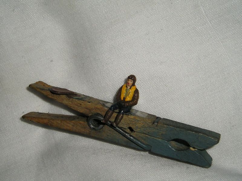

Col. Posted October 27, 2012 Author Share Posted October 27, 2012 Whatcha doing for a prop Col? Got some clear plastic that's going to represent the spinning prop as I want to build this one with everything 'down and dirty' in landing configuration. There is a piece that fits onto the back of the seat that has a small circular head restraint pad on it,that sits taller than the canopy so best not to use it. Don't ask how I know... ;-) With any luck all the scratch-built bits will fit in alright but thanks for the warning. Only kit part in the cockpit is the pilot so if the canopy doesn't go on it's my own fault! Looking good. Where have you got the decals from? Was donated a set for an Aeronavale machine from an Aeromaster by a kind fellow BMer. Been painting the pilot over the last few evenings and he's almost ready to install now. Will try to get a decent photo during daylight tomorrow and let you all see how he looks. Still a bit to do inside the cockpit but enjoying cramming all the parts in. Link to comment Share on other sites More sharing options...
Col. Posted October 28, 2012 Author Share Posted October 28, 2012 This will be the pilot, who has been taking up my attention for the last few days, not so glossy in reality, Back to working on the cockpit for him to sit in now... Link to comment Share on other sites More sharing options...

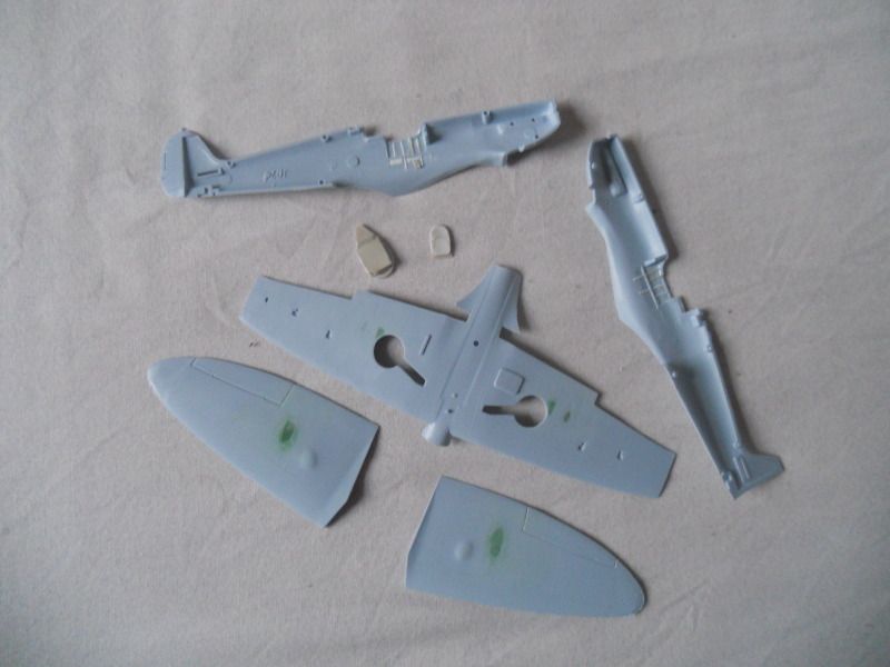

Col. Posted December 4, 2012 Author Share Posted December 4, 2012 Minor progress. Got the fuselage halves together and cut out the hook section then backed with plasticard; Link to comment Share on other sites More sharing options...
Miggers Posted December 4, 2012 Share Posted December 4, 2012 You ought to have fitted the upper wing panels to the roots before fitting the lower one piece panel mate. You can fettle and fit to eliminate ALL the gaps without using filler and a difficult sanding job. Link to comment Share on other sites More sharing options...
