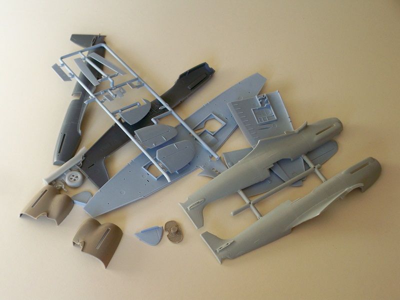

Anyroads... here is what I will be using for this build. Basically a load of spare bits...
Wings from an Airfix Spitfire Mk24, modified back to the classic planform using tips from an Airfix Seafire 17. Fusealge from the Aeroclub Spitfire XII conversion kit, rendered redundant by the Airfix kit. The tail will be from the Airfix Spitfire 24 - but a different kit from the wings. I have lots of Mk24 bits lying around. The remainder of that fuselage will be used to covert a Hasegawa IX into an FR.XIV. Given the promise of a new accurate IX from Eduard, it seems that all the Hasegawa IXs in The Stash will now be converted to Griffon Spits. A pure flight of fancy, because as we all know the Griffon was cancelled before it got off the drawing board. :tease:
The engine is from the Eduard Tempest. I cut this off when I built a Tempest II for the Close Air Support GB. I couldn't bear to get rid of the offcuts, which is what led to this Whif. The wheels are from the Alley Cat Tempest correction set.
And there will be all sorts of other scrap bits involved, as and when I decide to use them. I reserve the right to bung anything in there that I want! :lol:

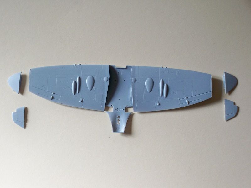

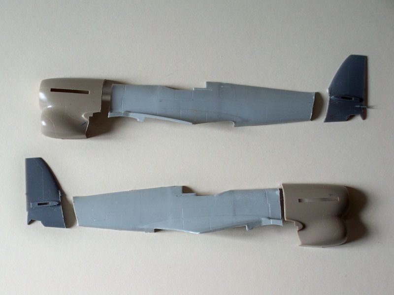

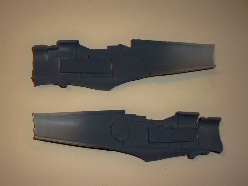

Not much movement on this one. I'm concentrating on getting my Starfighters sorted by the end of the GB.
However, I did saw off the tips of the Mk24 wings. I had always been under the impression that the wing planform of the later Spitfires was totally different to the classic elliptical shape. . But it turns out that it is identical. It is just the shape of the wingtips which is different. If you saw the wingtips off a Mk24 wing, the original tips fit perfectly.
What is different is that the later wingtips are an integral part of the wing. The ailerons extend into the wingtips, unlike on earlier wings, but that shouldn't make much difference to the model.

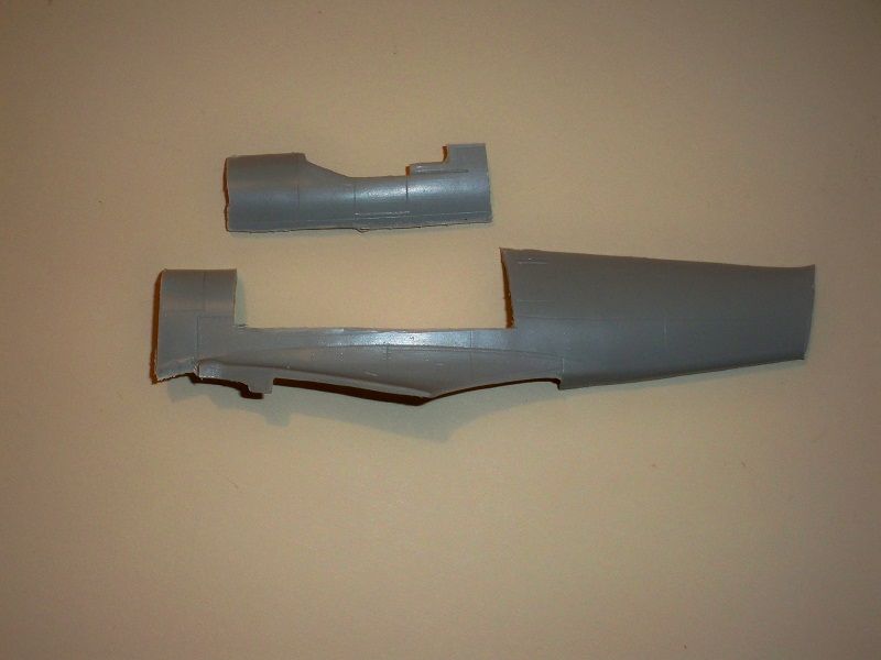

I have also sawn the fuselage and tail bits off. Here is what the fuselage should look like. At the moment it looks suspiciously like a Merlin Spitfire with a Vokes fiter, but I'm hoping that the raised cockpit and large fin and rudder will make it look somewhat different.

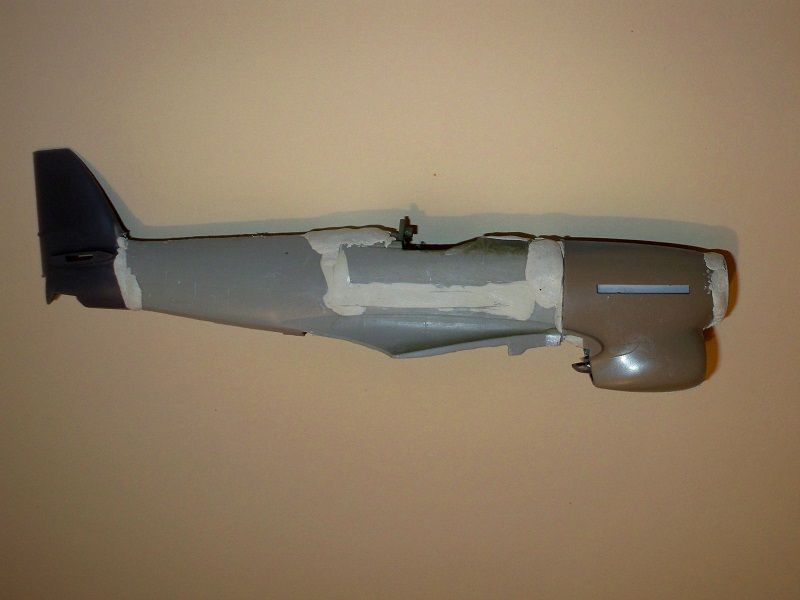

Slow progress on this one. Basically I've wreaked a little more destruction. :D
What is different is that the later wingtips are an integral part of the wing. The ailerons extend into the wingtips...
Right you are. The Mk.21 wing initially used the extended tip, which allowed the aileron to grow (though they had to "crank" the rear spar to do this). Then they clipped it back to about the same span as the "classic" Spit.

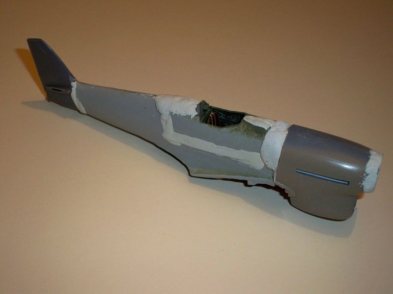

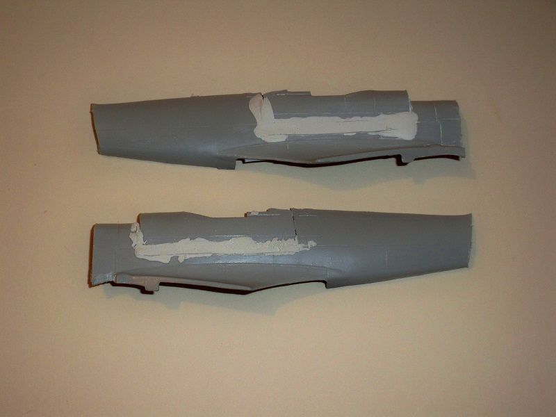

Still slow going on this one.
I have raised the cockpit. It looks like a total dog's breakfast at the moment, but bear with me... It will look better soon. At least, that's the plan! :lol:
The fuselage sides have been reinforced by using the cockpit walls from an Eduard Tempest and huge wodges of milliput!

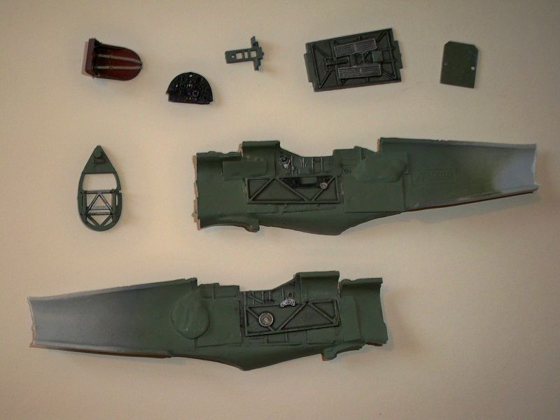

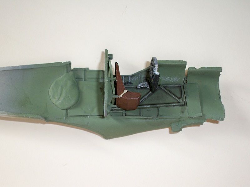

The cockpit parts painted and ready for installation
And installed...

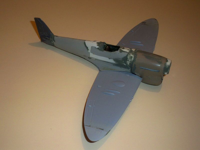

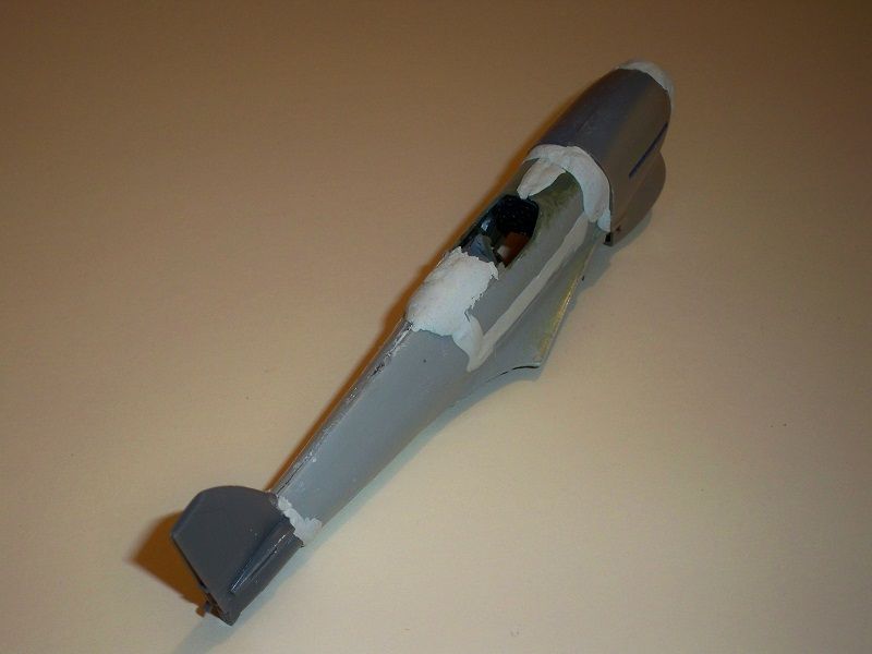

Time to break out the Milliput!
The Tempest nose is considerably wider than the Spitfire fuselage, so I used Milliput as an adhesive to bridge the gap between the two sections. I also rolled a tube of Milliput to reinforce the join between the tail and the fuselage.
I have extended the nose slightly. I want to use the Spitfire 24 five-bladed spinner with Tempest blades. The Spitfire spinner is much narrower than the Tempest one hence the extended nose. Hopefully it should serve to make the nose a little more shark-like.

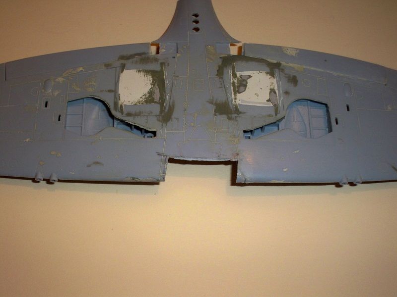

The wing assembly needed a section cut out to allow it to fit around the Tempest radiator.

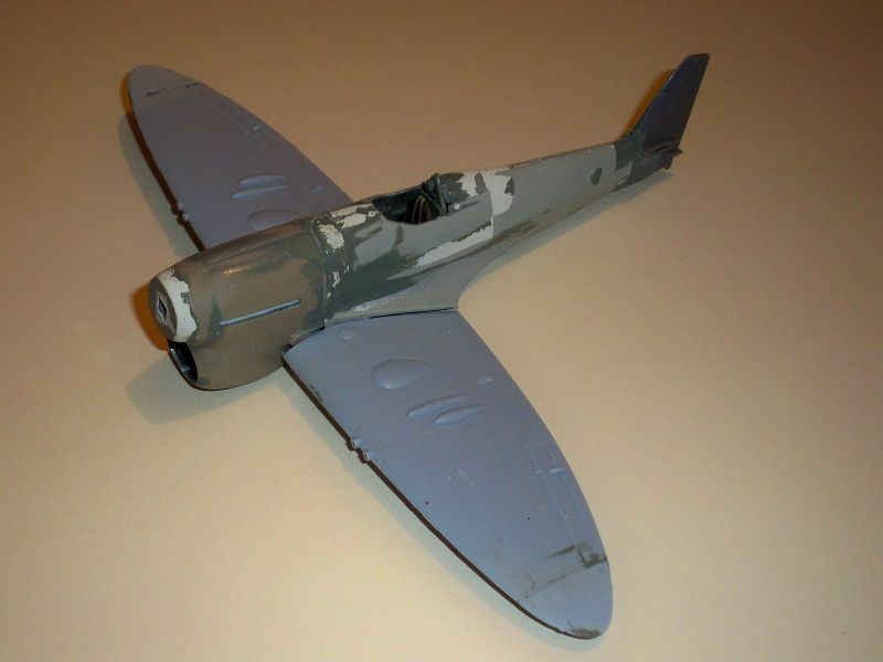

Finally, here is the wing test fitted to the fuselage. I'm going to need a lot more Milliput to fair everything in nicely... :D
