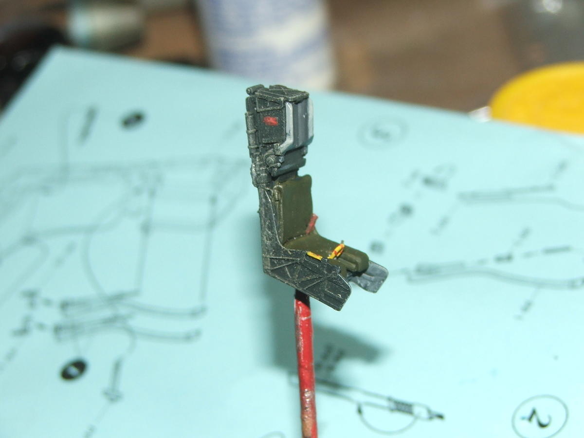

Anyway bits of progress, starting with the Aries cockpit and here is the bang seat:
Now this is an American seat and I'm sure that the powers that be - ie the rip-off merchants in BAe would prefer replace this with a Martin Baker seat just so that they could overcharge the MoD for the changes! However unlikely as it seems, the MOD resisted this blatant attempt at pocket lining and insisted that if the ejector seats were good enough for the US Navy, they were good enough for the Royal Navy!
Still need to put the belts on the seat though, just need to work up enough enthusiasm to mess about with more tiny bits of PE!

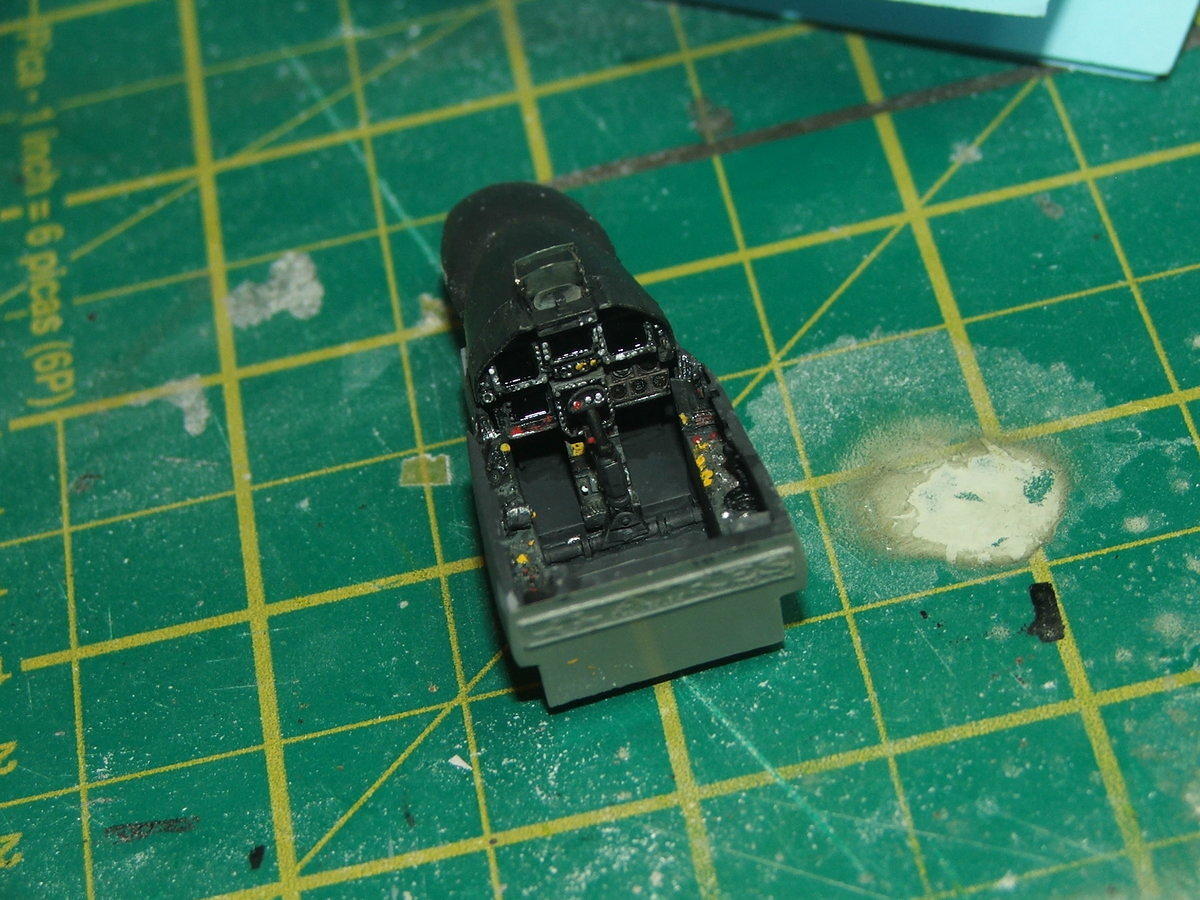

Now for the cockpit itself:

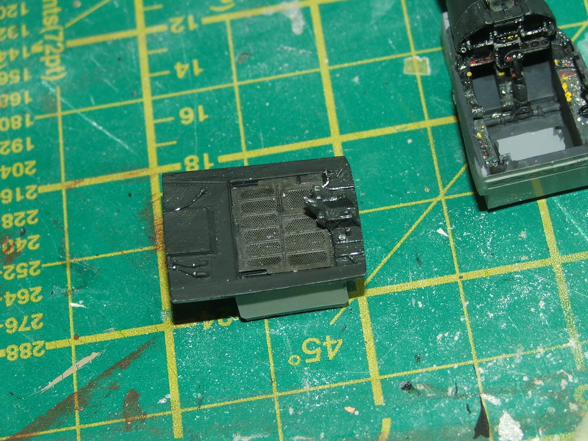

This is being represented with the power off so no displays on the consoles. Next the bit that fits behind the cockpit under the canopy:

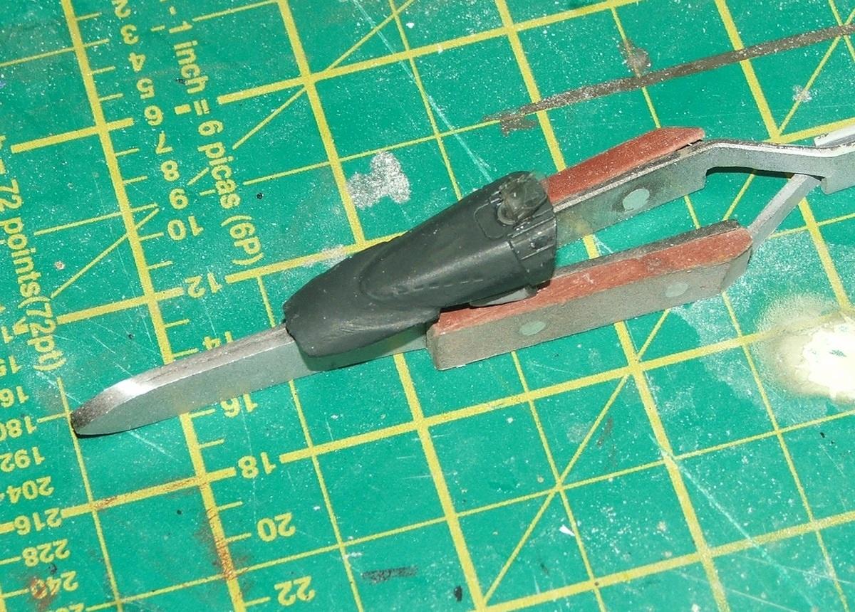

There is a resin insert under the PE grill which is just about visible through the PE and is black with silver highlights. Finally for the cockpit, the canopy surround PE - this still needs a bit of drybrushing and was a complete bu**er to assemble!

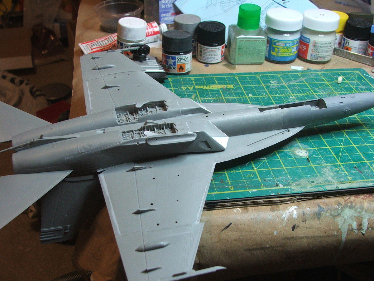

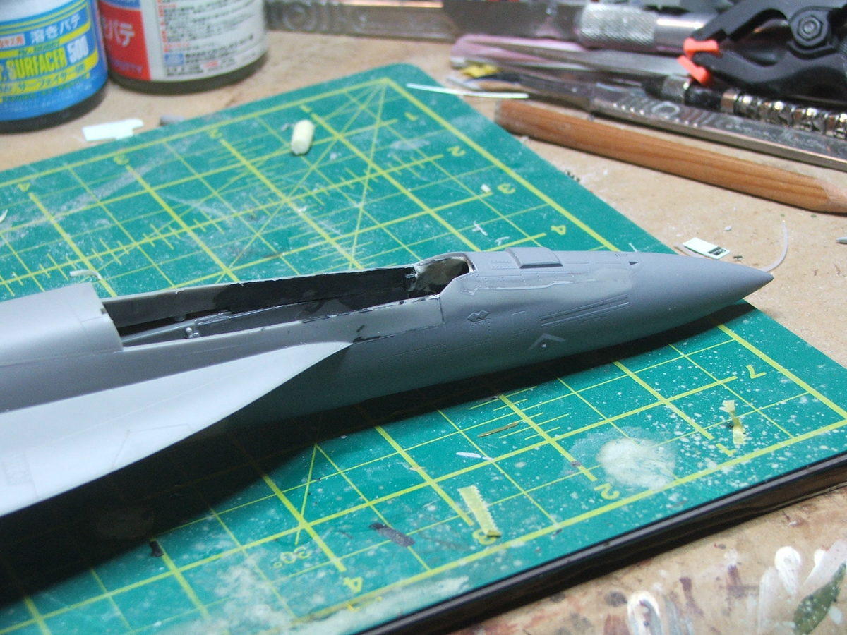

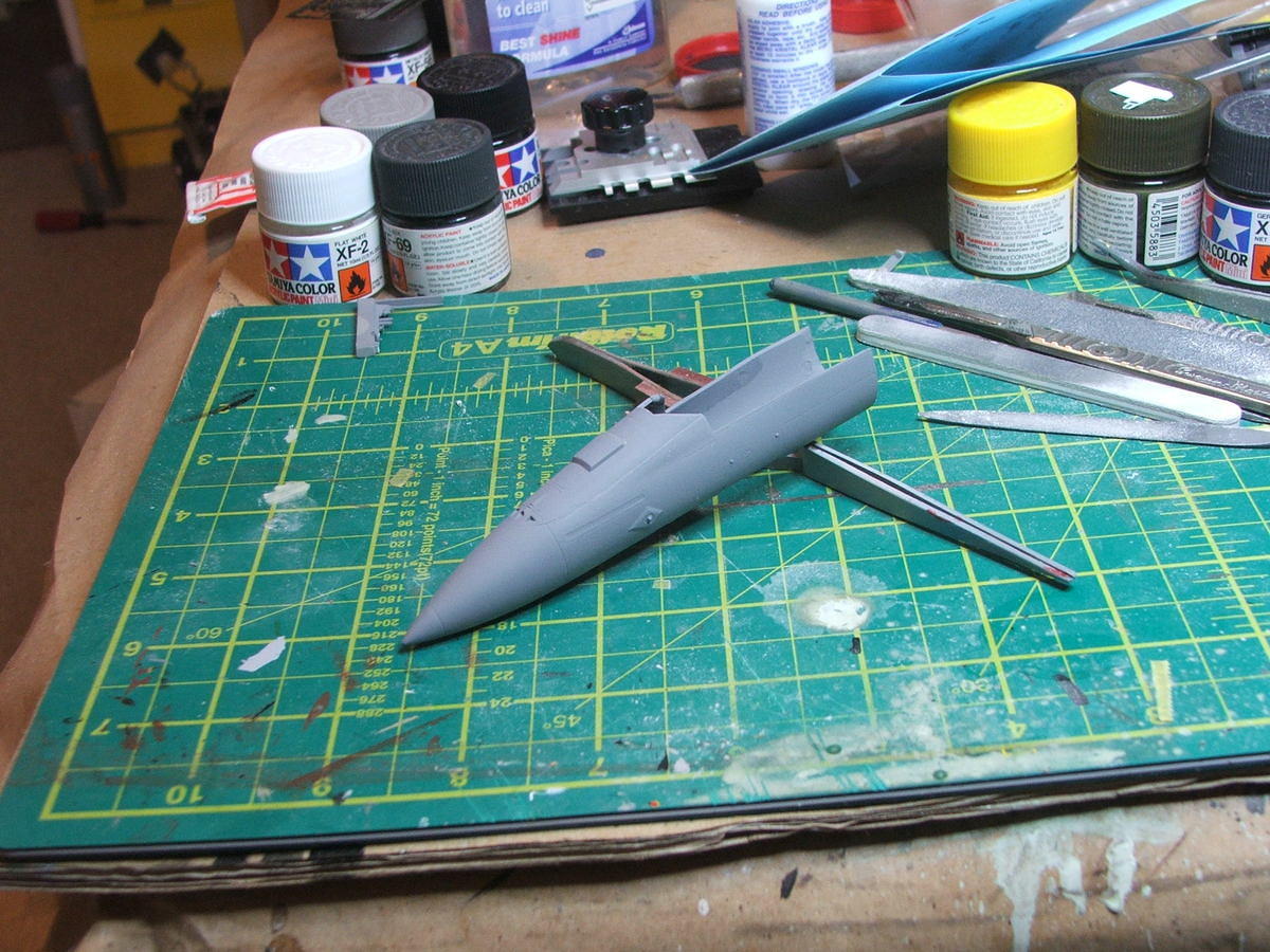

Next the nose has been assembled and primed to check for gaps where the upper and lower panels are fitted. These don't fit very well but a bit of Mr Disolved Putty and some very careful sanding to avoid removing too much rivet detail sorts that out.
The Resin cockpit requires you to remove the moulded fascia in front of the cockpit, but the replacement part which contains the front console doesn't fit the gap left so there had to be some very delicate surgery to merge the kit part into the resin part
Next, the upper and lower fuselage sections have been joined. You can see the gap at the front where the fascia has been removed!

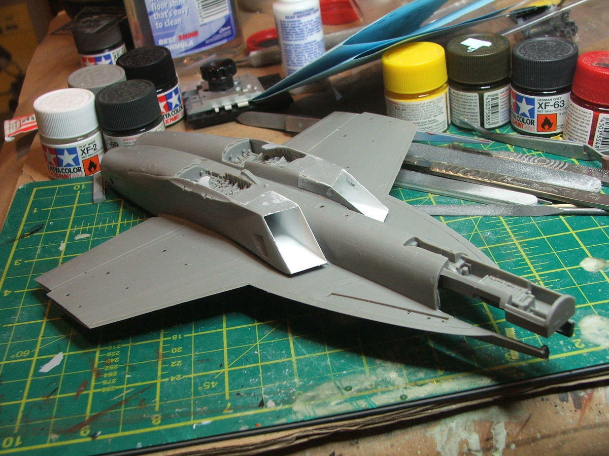

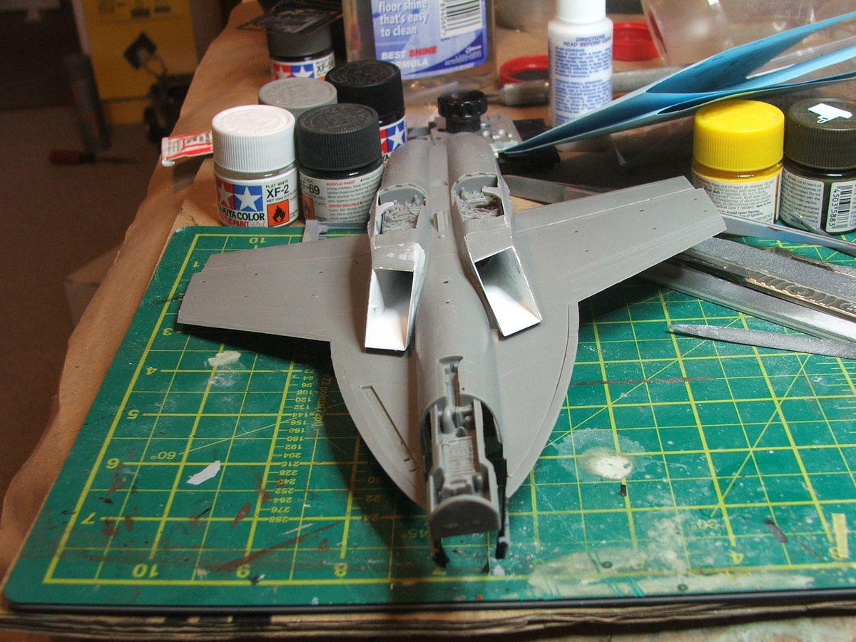

Finally the intakes have been assembled and put in their correct places. This is a bit tricky as the fit of some of the parts isn't all the great. There is still soem work to do to blend the intakes into the fuselage, but fingers crossed that will work well.
The second photo shows how the side panel needs some attention to blend it in with the fuselage along its lower joint. This will need careful work to avoid loosing too much engraved detail. I'm not great at scribing, so I'd rather avoid doing that if I can :)

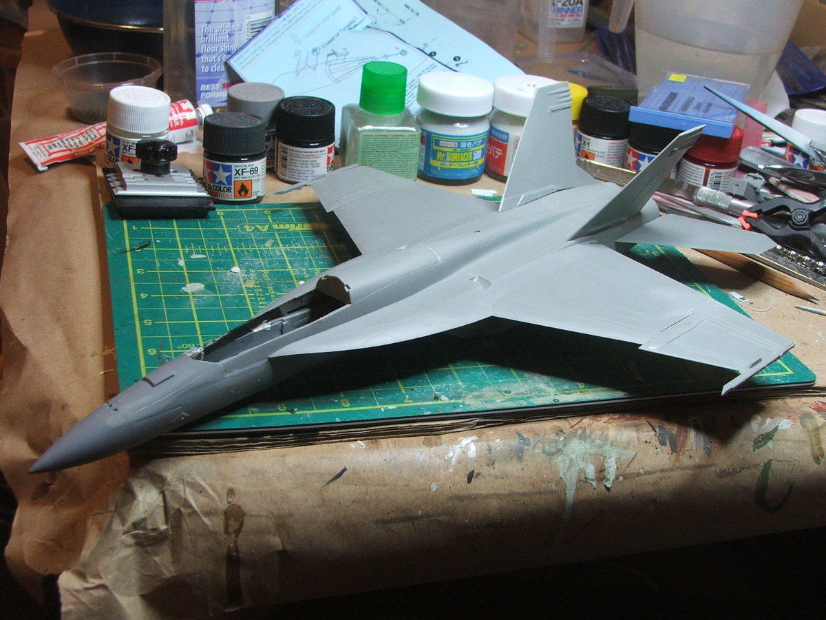

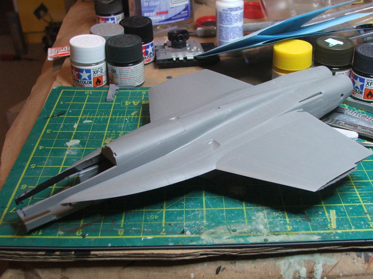

Nose is on, wingtips attached, twin tails attached (although some more filling will be required at the joint) and elevators fitted:
There has been a certain amount of filling and sanding required but I've been able to preserve 95% of the engraved detail. I mostly used Mt Surfacer 500 plus some Mr Dissolved putty for the larger areas such as the front part of the cockpit:
Underneath, the fit was reasonable and I've added the bracket for the TIALD unit.

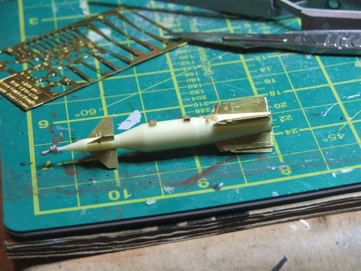

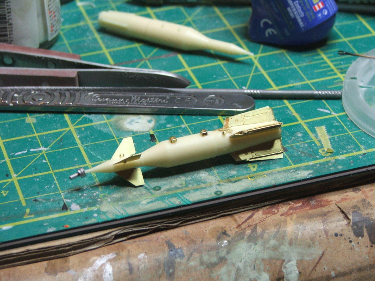

While filler etc has been drying, been building the ordnance to put under the wings:
This is one of the Flightpath Paveway II bombs. You get two in the pack and they are construction projects in their own right! This one took most of yesterday evening to complete!

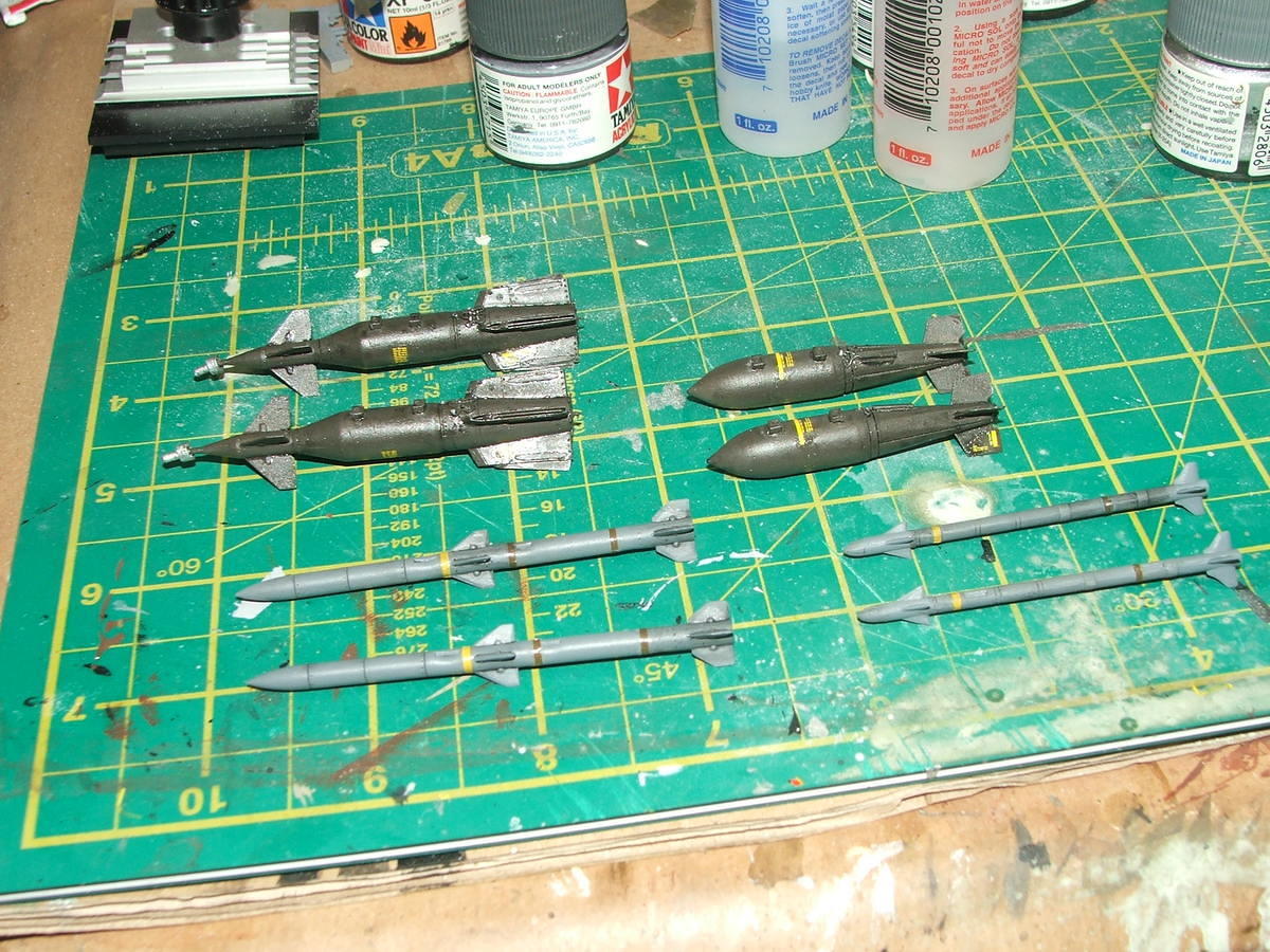

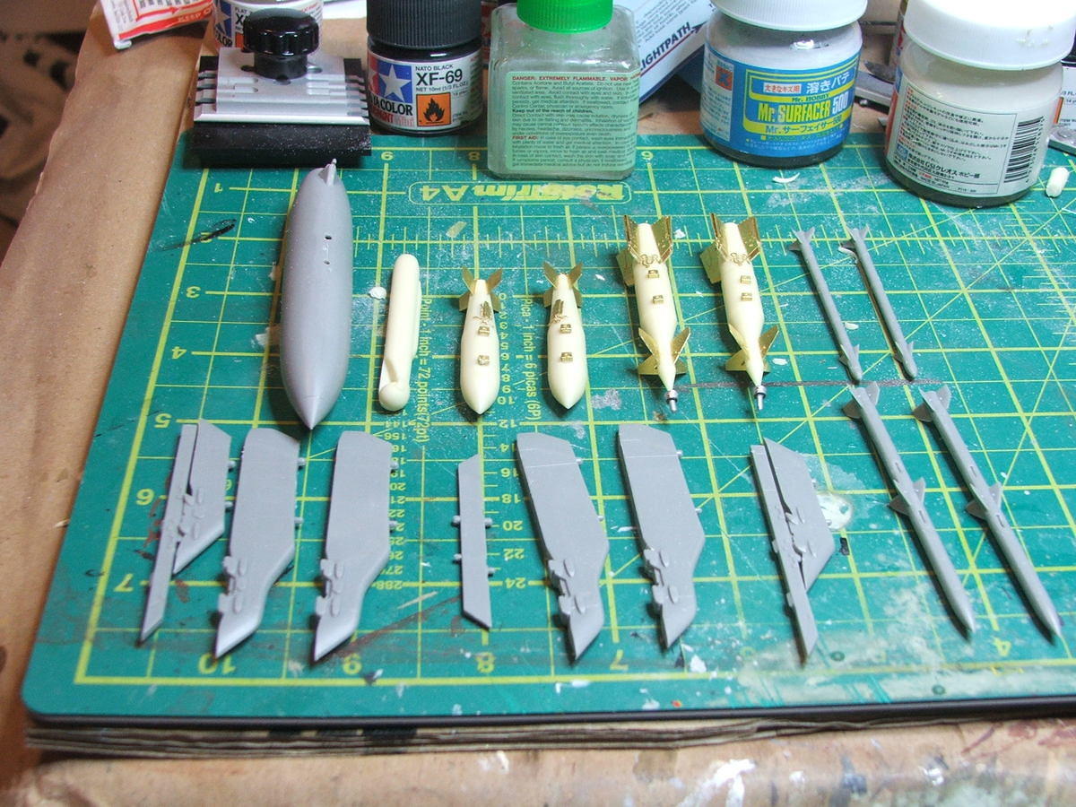

The rest of the stores are shown here:
I've decided to mount
2 AIM 9X (from kit) on wingtips
2 AIM 120 (from kit) outer wing pylons
2 1000 lb bombs (Flightpath) middle wing pylons
2 Paveway II (flightpath) inner wing pylons
TIALD Starboard under fuselage
Still need to put something on the Port under Fuselage mounting point. Was thinking of a ECM pod or similar, but can't find anything suitable in aftermarket stuff. I'm almost tempted to raid something out of the Hasegawa Weapon set B I have in the stash - an ALQ-131 or ALQ-119 ECM pod but that would be quite old so I doubt it would be really suitable. Not sure I can be bothered to scratch something up from nothing!

I've ordered the Hasegawa Set E from Hannants - 1/3rd off the price at the moment!
So here are the rest of the weapons fully painted and decaled although they do need a final coat of matt varnish to take away the shine form the Klear:
