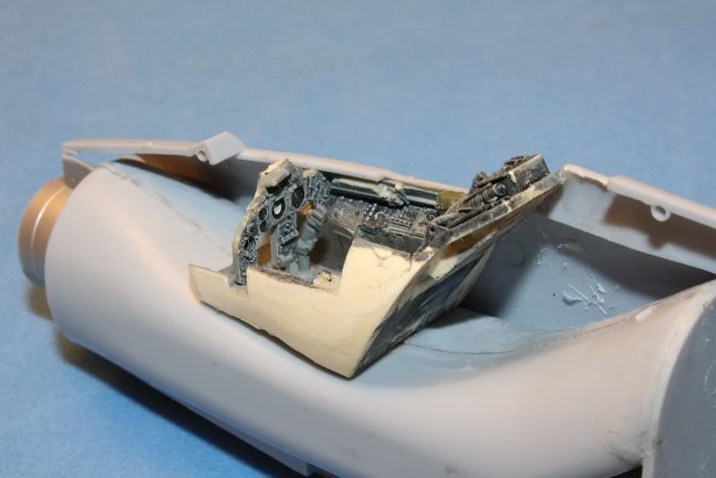

SaintsPhil Posted September 20, 2012 Author Share Posted September 20, 2012 How does the pit fit? You hear bad things, but the only one I've ever used (Harrier GR7) actually fitted like a glove! Link to comment Share on other sites More sharing options...
noeyedears Posted September 20, 2012 Share Posted September 20, 2012 took a bit of fiddling, thinning the walls of the kit and resin pit, and a lot of sanding on the bottom of the resin tub so it sits correct on the intake tube but not bad really. now the wheel weels are a different matter, they plainly just do not fit at all. DSC01752 by omgpainful, on Flickr DSC01749 by omgpainful, on Flickr these were taken before the fuse was glued up and show the best fit i could get. IMG_0912 by omgpainful, on Flickr IMG_0910 by omgpainful, on Flickr these two i just took show where i had to fill (sorry bad quality pics) Link to comment Share on other sites More sharing options...
SaintsPhil Posted September 20, 2012 Author Share Posted September 20, 2012 Thanks that's very useful! Food for thought! Link to comment Share on other sites More sharing options...
