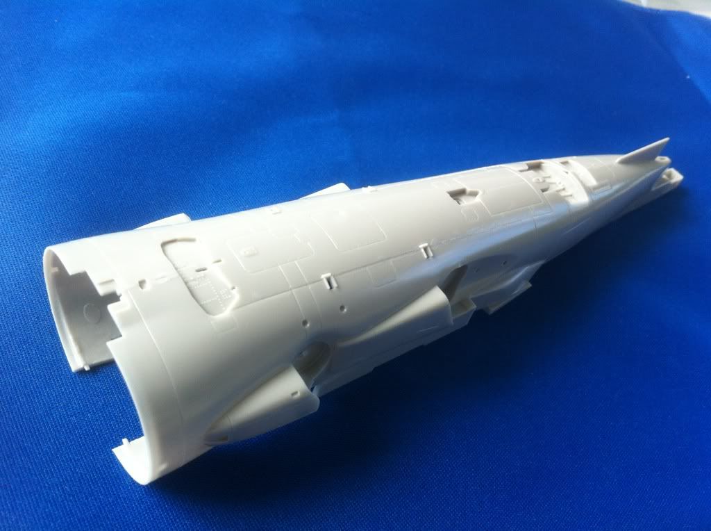

SaintsPhil Posted September 5, 2012 Share Posted September 5, 2012 (edited) Afternoon everyone, It's been a while since I've posted a WIP, outside of GB, so here's one. I'm actually building this for a GB elsewhere (all my kits on the go are for GB!!). Anyway we have a lot of harrier fans here and a few continental visitors so hopefully this will prove interesting to someone... Plenty written about this kit, a few pit falls but many good builds about so I'm going to try and follow some, if not all of the suggested fixes. Started with the main fuselage Blocked in gaps behind nozzles, to avoid see through fuselage Cut out holes in rear deck (cable conduits I believe...) And the corresponding cut out in front fuselage halves While I was cutting holes I removed front U/C doors to take Pavla wheel well, perfect fit! Ignore the gaps, that's just me holding it one handed while taking a pic!! I finally added some plasticard to the fan part, to overcome a large gap that will be otherwise left when installed I may yet add FOD covers anyway, a bit like this http://www.airplane-pictures.net/images/uploaded-images/2009-6/14/49721.jpg Aside from the Pavla nose bay I'm also planning on using some of the Eduard Zoom set plus an Eduard canopy masks, I hate masking canopies so these are worth their weight in gold to me! Feel free to chip in with any advice, thanks for looking Phil Edited September 5, 2012 by SaintsPhil Link to comment Share on other sites More sharing options...

colihamp Posted September 6, 2012 Share Posted September 6, 2012 I'm building the GR7 at the moment; had a nightmare fitting the wing (because I followed the instructions, i.e. fit the lower and upper wing sections, then fit to fuselage), this looks like it could be better? Quick question; what is the rectangular hole on the underside of the nose? There doesn't appear to be any kit part for this? Do I need to fill it? Colin. Link to comment Share on other sites More sharing options...
SaintsPhil Posted September 6, 2012 Author Share Posted September 6, 2012 Colin, The hole is the nose RCV (Reaction Control Vent). It's pretty poor for a kit of this standard that it's just a hole! I've not taken a pic yet but when I closed the nose up last night I backed it with plasticard to give me a backing to scratch build a nozzle. Basically it should look similar to the one under the rear tail part, just before the ECM lump! Phil Link to comment Share on other sites More sharing options...
