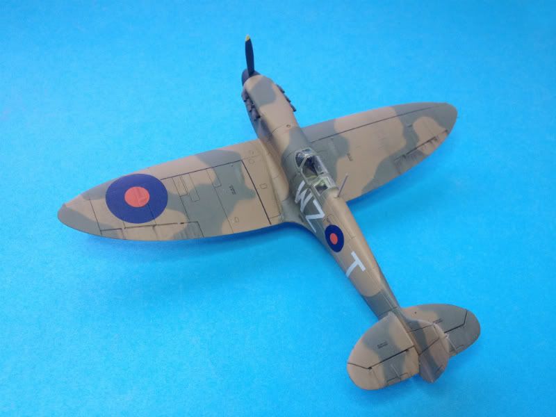

thx6667 Posted August 21, 2012 Share Posted August 21, 2012 Here's one I made earlier: IIRC the colours were Vallejo Air 024 Khaki Brown and 012 Dark Green, cut back with a little white to add "scale effect", final finish being Humbrol's new matt acrylics sprays. On my next model I may try something different, but I do think lightening the colours does stop swamping smaller scales like 1/72 even if the final mixes are a tad off from my MAP swatches. 1 Link to comment Share on other sites More sharing options...
Don McIntyre Posted August 21, 2012 Share Posted August 21, 2012 With the variable quality of Humbrol paints, I'd skip that and go directly for Xtracolour. It should be easy enough to get (I assume you're in the UK), either through your LHS or mail order. You'll be a lot happier, I think. That being said, Jonathan's Spitfire above looks very nice. Link to comment Share on other sites More sharing options...

Col. Posted August 22, 2012 Author Share Posted August 22, 2012 Here's one I made earlier: IIRC the colours were Vallejo Air 024 Khaki Brown and 012 Dark Green, cut back with a little white to add "scale effect", final finish being Humbrol's new matt acrylics sprays. On my next model I may try something different, but I do think lightening the colours does stop swamping smaller scales like 1/72 even if the final mixes are a tad off from my MAP swatches. That's very nicely done Jonathan. New Airfix 72nd kit? If I get a finish like that in 48th I'll be delighted. The non-standard roundels are very attractive as well. With the variable quality of Humbrol paints, I'd skip that and go directly for Xtracolour. It should be easy enough to get (I assume you're in the UK), either through your LHS or mail order. You'll be a lot happier, I think. That being said, Jonathan's Spitfire above looks very nice. Not come across much issues with the Humbrol enamels yet but perhaps a combination of luck and plenty old paint stocks Don Been thinking about trying the Xtraclour range for a while but don't think my LMS can get it in. On the subject of non-standard roundels and paint colours; can you chaps recommend any enamels to use for the red and blue of the roundels around mid to late 1939? The photo I've found to work from shows what I interpret to be LO * B with small diameter Type B upper wing roundels with a smaller than standard red center and Type A fuselage roundels overlapping the codes. While the latter I have the former match nothing I can find so will have to mask and spray them. While I'm at it is there a good match for the Sky(?) code letters as well? Think these are my last daft questions on the subject. Link to comment Share on other sites More sharing options...
