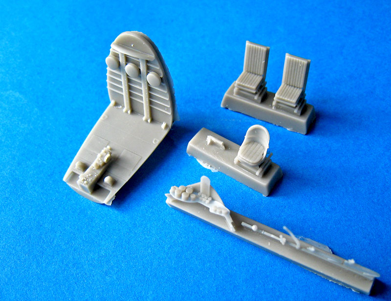

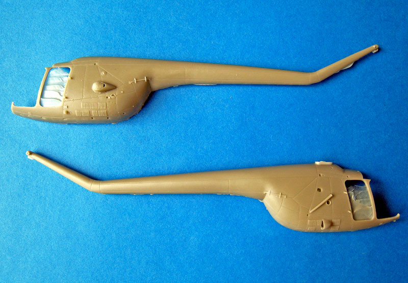

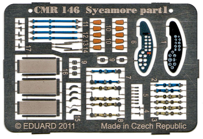

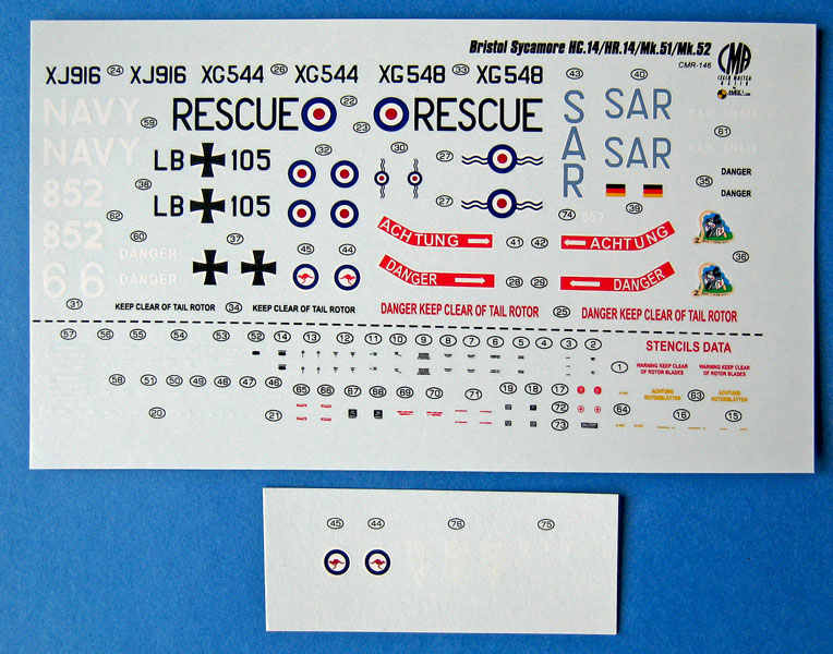

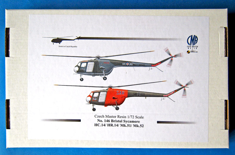

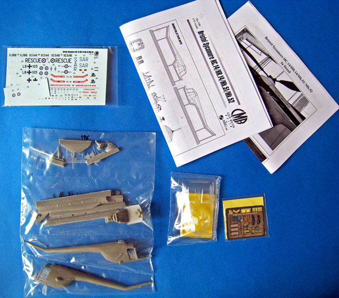

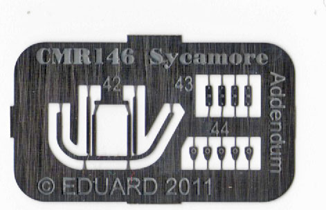

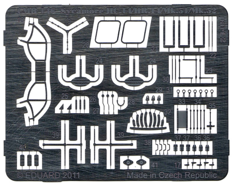

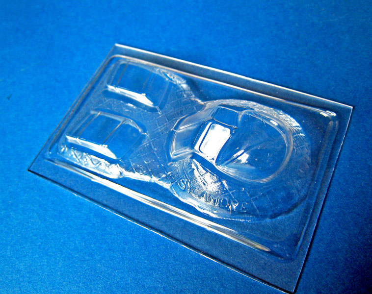

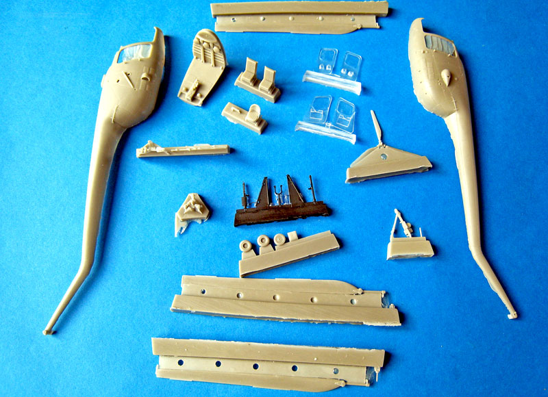

woody37 Posted July 28, 2012 Share Posted July 28, 2012 Bristol Sycamore HC.14/HR.14/Mk.51/Mk.52 CMR / Mark I 1:72 Design of the Sycamore started way back in 1944 with the first flight in 1947. Early development focused on making mechanical components durable such was the early evolution of rotary aircraft. The civilian version was known as the Bristol 171, the military versions using the more commonly known name Sycamore. The HR 14 entered service with the RAF in 1953 following a series of evaluation aircraft. As well as it's role as a Rescue aircraft, it got it's 'hands dirty' in the Malayan Emergency where it was used to get troop patrols in and out of the jungle. During it's time, the Sycamore flew with the British, German, Belgian and Australian forces. The kit If you're familiar with CMR kits, you will know that these kits some jammed packed with detail and this one follows that format. The box is a sturdy top opening design to protect the delicate contents. Within the kit you will find: Resin fuselage and main detail - packed into a bag with sectioned compartments to further protect the parts from each other 3 etch frets of which one is pre-coloured for the interior 2 x vac formed canopies in case you make a mistake....and I did, phew !! Paint masks for the windows Decals for no less than 5 aircraft Instructions & several pages of pictures showing good close up references to help with the build Building the kit starts with the cockpit interior. Care needs to be taken removing the cockpit from the base and a razor saw is vital for this task. Getting the cockpit resin parts together was quite straight forwards. Once the resin parts were assembled, the next task is to fit the etch rear seats. These were fitted minus the coloured seatbelts then the assembly was primed and painted. I used dark grey for this. Once the base colour was on, the rear seatbelts were painted reddy-brown and the seatbelts fitted to the seats. This is a delicate operation and a good set of tweezers will be a godsend. With the detail on, a wash of black was used to enhance the detail More on the next post... 7 Link to comment Share on other sites More sharing options...

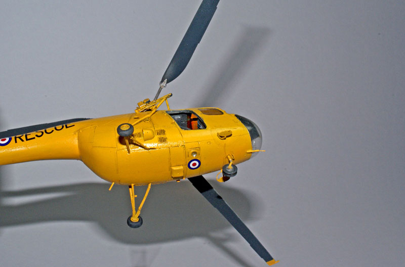

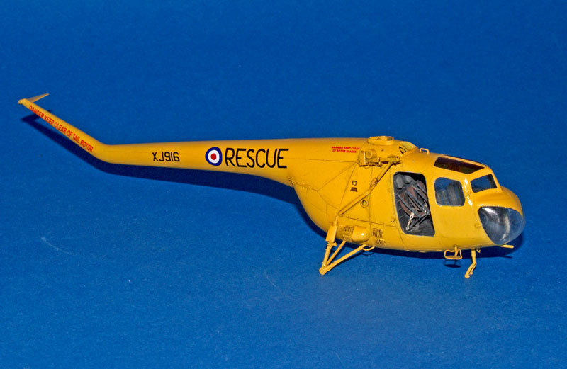

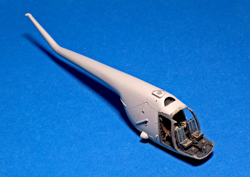

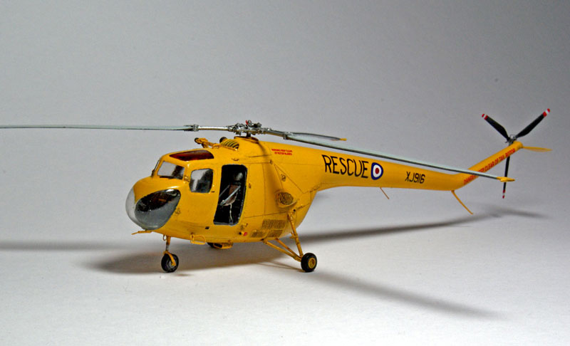

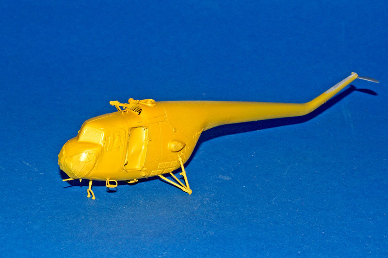

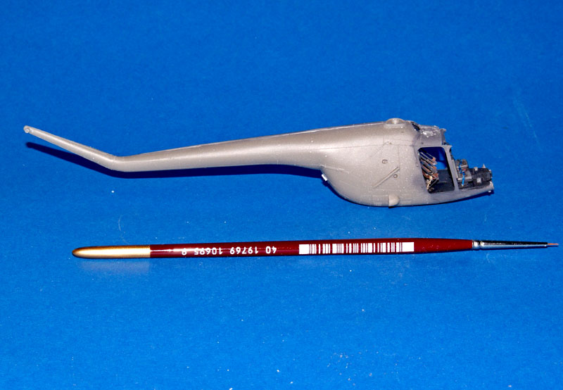

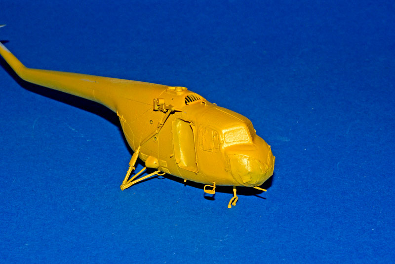

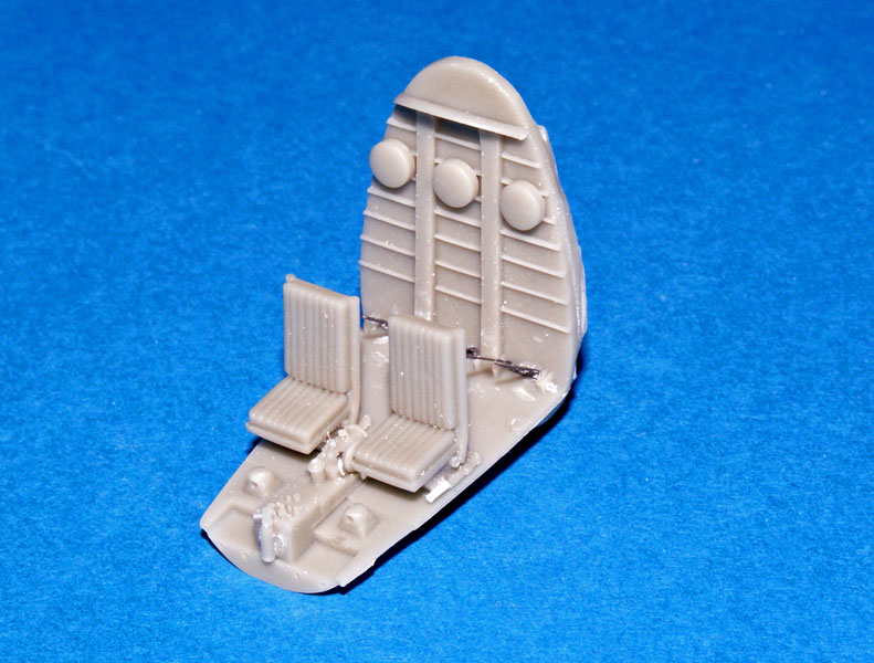

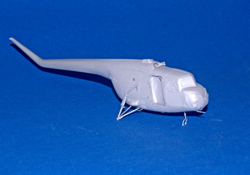

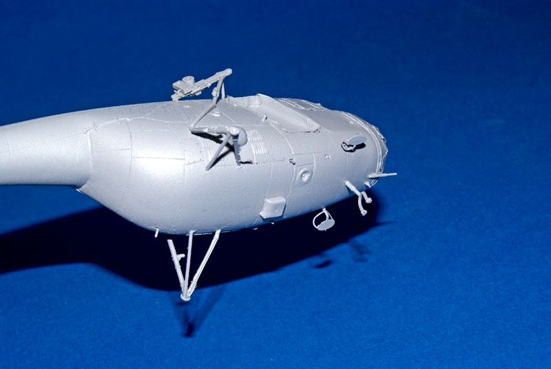

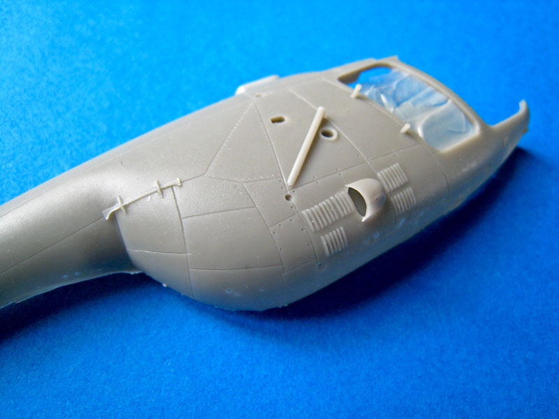

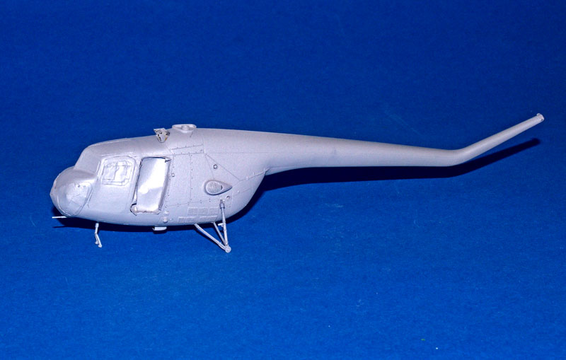

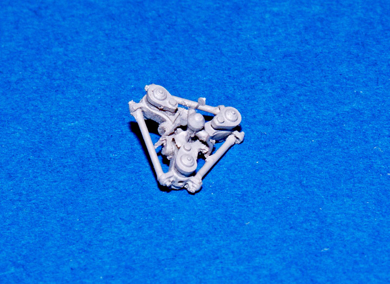

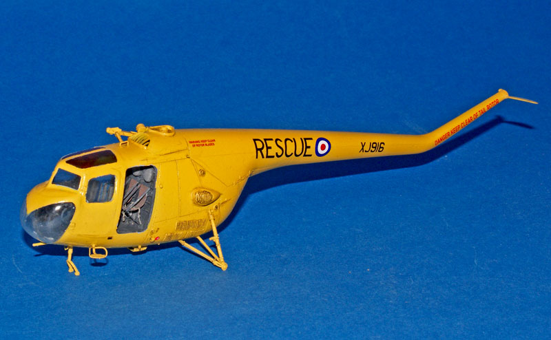

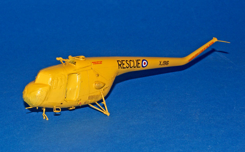

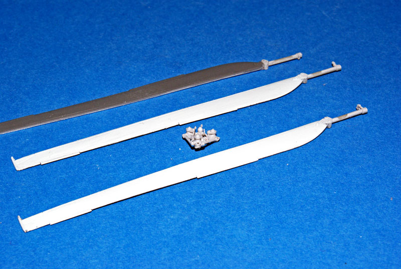

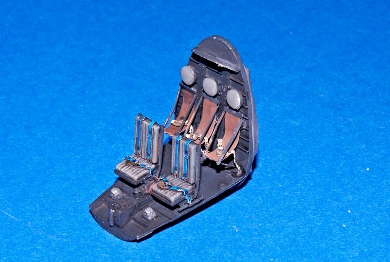

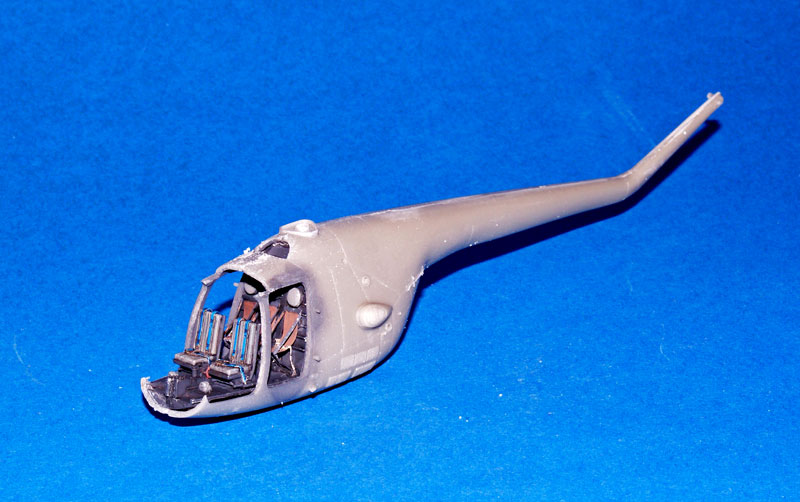

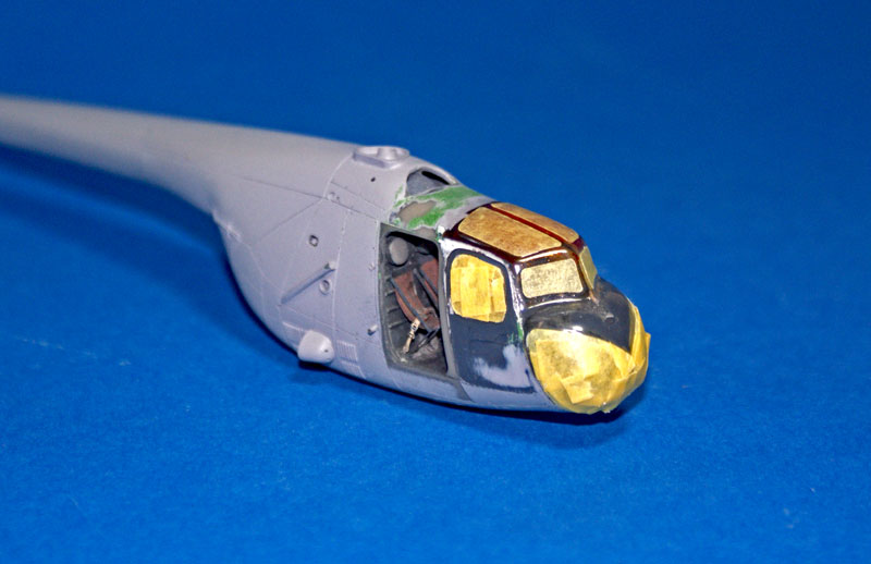

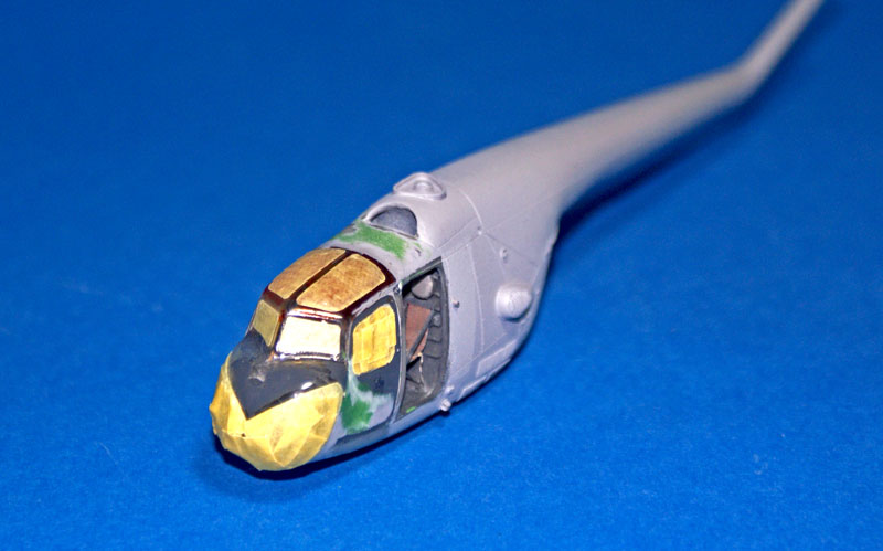

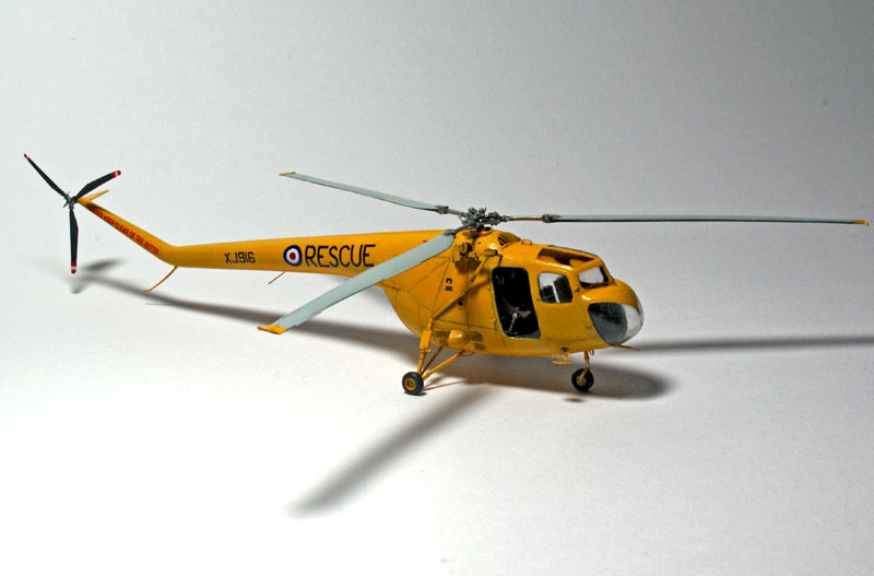

woody37 Posted July 28, 2012 Author Share Posted July 28, 2012 To take a break from the interior, I next did the rotor. The blades are very flexible and as such, much stronger and less prone to breaking than they might appear. The hub is made up of several resin and etch parts. With the cockpit completed, next step was to fit it into the fuselage. The angle of the rear bulkhead on the interior didn't quite align correctly, however gluing it into the fuselage corrected this to a large degree. As the kit has no locating pins, the fuselage was masked together using thin strips of masking tape, then super glued to hold it together. This left some large joins that needed to be filled, in part probably by my preparation of the mating surfaces when I cleaned them up. Some rescribing had to be done after filling the gaps to restore the panel lines that are beautifully moulded in. After filling the joins: With the fuselage together, the front doors were fitted followed by the vac canopy over the top. This was the most challenging part of the build as everything had to line up. Some bending of the doors and lots of dry fitting was necessary before I went to work with the glue. You can't rush this part even if you try. I found in the end that I had to fill, sand and polish the edges of the vac canopy to improve the joins, so micromesh was a Saviour at this point as well as some foam sanding sticks to do the initial sanding With several days of prepping and fitting, the holes were masked up, the undercarriage fitted and it was primed. Fitting the undercarriage is fairly straight forwards with good alignment, however these parts are delicate, so go easy if you have sausage fingers ! Some of the larger etch details were fitted during the priming stage, the foot steps being quite prominent and adding lots of character to the profile. With the priming done, next up was the colour. I'd decided to do it in the Rescue scheme, so Xtracrylic Trainer Yellow was used. The engine intake was masked prior to painting as this was to be black. A nice etch grill is provided to fit over the intake, the ribs being twisted through 90 degrees prior to fitting. A bit of scratch plasticard was used to fill the edges around the etch at the base to hide the gap, then filled and delicately sanded before touching up with some yellow Decals next, one of my favourite bits ! On the whole, these went on OK, however for some reason the tail rotor warning decals fought me, folding over in the application, so I used a scalpel to eventually rescue them, winning in the end. Whilst I decided to do the scheme in the RAF Rescue Scheme, there are also four other schemes that may take your fancy: XG548 - Joint Helicopter Unit, HMS Ocean, Suez Crisis 1956 XG544 - 118 Sqn, RAF Aldergrove, Northern Ireland 1962 XN448 - 852 Sqn HMAS Melbourne, Royal Australian Navy 1964/5 LB+105 - 2 Luftrettungs - und Verbindungsstaffel, 2nd SAR Unit, Luftwaffe, West Germany 1962 Masks removed. There was some further work required to tidy up the mask lines and a further application of Kleer was applied after giving the windows a wash with Windscreen washer fluid and a cotton wool bud. On the final straight, the rotor and tail rotor was completed and various aerials fitted. The rotor wanted to sit at an angle, so I overcome this by gluing a rod to the shaft that reached to the bottom of the inside fuselage. This then used friction to hold the rotor level. Conclusion I hope you agree that this is a beautiful little kit. The only competition is the old Glencoe kit from years back, and it shows its age in comparison. This isn't a kit for beginners, far from it. Fitting the canopy was challenging, mainly because you also have to fit the doors as well. To get round this issue, having the front doors open is an option, particularly as the hinges are etch parts that would give genuine fixing points to locate them. With so much juicy detail inside, having the front doors open is a pretty good option to consider. The quality of the kit is excellent, the research that has gone into it is demonstrated in the detail and options. It's great to see these rarer but historically important aircraft not only being modelled, but being modelled in such exquisite detail Review sample courtesy of 25 Link to comment Share on other sites More sharing options...

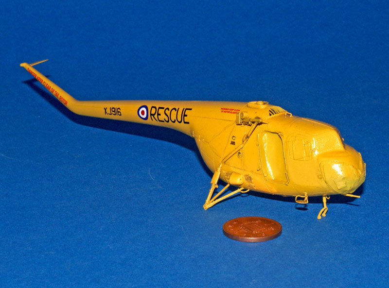

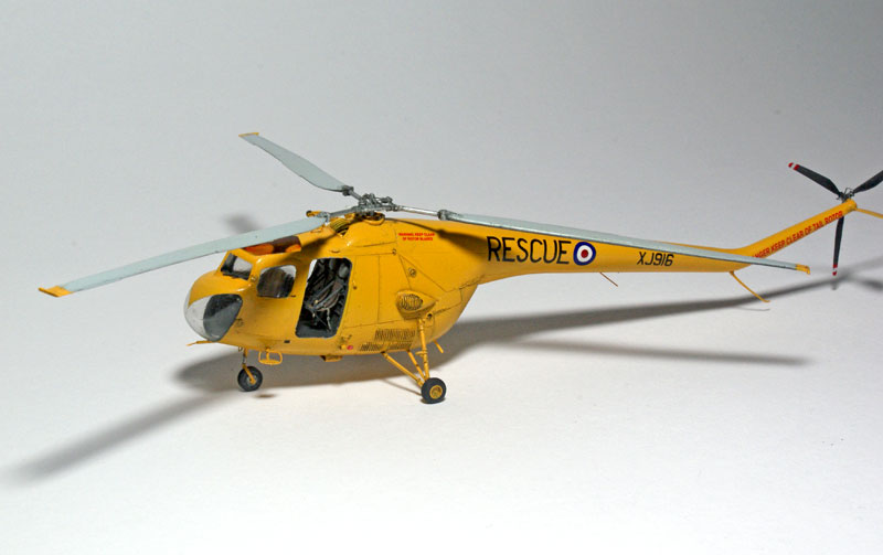

Julien Posted August 2, 2012 Share Posted August 2, 2012 I have looked at this a few times now. Cant get over how good it is and how small it is. Top class Julien Link to comment Share on other sites More sharing options...
woody37 Posted August 9, 2012 Author Share Posted August 9, 2012 Thanks mate. I'm scared of touching it now incase I break it ! Link to comment Share on other sites More sharing options...
Norman Posted August 9, 2012 Share Posted August 9, 2012 Mate !!!! that is stunning great build of a wonderful subject really well done I dream of one in 1/48 or 1/32 Ahhhhhhhhhhh Anyway Cheers Link to comment Share on other sites More sharing options...
heloman1 Posted August 10, 2012 Share Posted August 10, 2012 That looks very good one of the neglected helicopters, which deserved to have been treated better. Now we have what will probably be the last and best Sycamore kit. I flew in one of the Aldergrove aircraft whilst on summer camp with the ATC. If memory serves me they were airframe silver with self adhesive dayglo patches. Colin on the Africa Station Link to comment Share on other sites More sharing options...
marty_hopkirk Posted August 16, 2012 Share Posted August 16, 2012 Great build. I have two but going to build in the the red/white and white grey BEA liveries. Marty... Link to comment Share on other sites More sharing options...
Glen T Posted August 22, 2012 Share Posted August 22, 2012 Great model and build, i too didn't realise how small it was until I saw the 2p piece next to it. Link to comment Share on other sites More sharing options...
woody37 Posted September 1, 2012 Author Share Posted September 1, 2012 Great build. I have two but going to build in the the red/white and white grey BEA liveries. Marty... Now they will look pretty cool, hope to see some pictures Marty Great model and build, i too didn't realise how small it was until I saw the 2p piece next to it. That's a 1p ! Cheers Link to comment Share on other sites More sharing options...
pbaudru Posted October 2, 2012 Share Posted October 2, 2012 Great job, very nice cockpit ! Cheers Pierre. Link to comment Share on other sites More sharing options...

TheBaron Posted February 7, 2017 Share Posted February 7, 2017 I've only just found this little jewel Woody. Superb work. The cockpit interior is exceptional. Tony 1 Link to comment Share on other sites More sharing options...
Nigel Heath Posted March 22, 2017 Share Posted March 22, 2017 Fantastic build, a real jem! 1 Link to comment Share on other sites More sharing options...
Hobby Paul Posted June 28, 2017 Share Posted June 28, 2017 Very nice job... really like the RAF rescue helicopters. 1 Link to comment Share on other sites More sharing options...
sandokan Posted August 9, 2017 Share Posted August 9, 2017 Absolutely superbe!!!!!!!!! This is one of the building I dreaming in 32!!! Very congrats for fine building! Great. 1 Link to comment Share on other sites More sharing options...
robgizlu Posted January 7, 2018 Share Posted January 7, 2018 What a Fab little build! Rob Link to comment Share on other sites More sharing options...
redleader Posted February 9, 2018 Share Posted February 9, 2018 Sycamore! What a cool name for a helicopter. And what a kit – packed full of character and personality! Great job, looks like you had fun Link to comment Share on other sites More sharing options...
tonyot Posted July 11, 2021 Share Posted July 11, 2021 Just stumbled across this one Neil,..... what a little corker mate,.... love the scheme! Cheers Tony Link to comment Share on other sites More sharing options...
Terry1954 Posted July 13, 2021 Share Posted July 13, 2021 Like Tony, I have just found this one. What an absolutely superb build of relatively significant British helicopter. Well done! Terry Link to comment Share on other sites More sharing options...
Ed Russell Posted July 25, 2021 Share Posted July 25, 2021 On 7/13/2021 at 10:21 PM, Terry1954 said: Like Tony, I have just found this one. Me too - What a beauty, Having seen a few CMR and S+M kits built, the CMR one is better. Link to comment Share on other sites More sharing options...
Maginot Posted August 17, 2021 Share Posted August 17, 2021 Good modelling, nice kit, lovely result. I can only remember seeing one Sycamore up close. That is A91-1 that arrived at the Australian Aircraft Restoration Group sometime in the mid 60s, where it is preserved to this day. The Sycamore must have been one of those choppers that you had to duck under the rotating rotor blades when approaching or departing, as I was told that A91-1 had decapitated a policeman up on the Murray River. As an impressionable 13-year-old volunteer, I was profoundly unimpressed and have never liked helicopters nor approached one without ducking, ever since. Link to comment Share on other sites More sharing options...
roginoz Posted August 17, 2021 Share Posted August 17, 2021 Recently completed AMPs Sycamore in 1/48 and I hate to think how fiddly a 1/72 version would be. Both kits seem to share the common challenge, that of building up the clear parts which form the cockpit, not helped in AMPs case with overscale thick transparencies. It helps to be as digitally gifted as @Martian to wrangle each piece to its companion while all the others flip 'n' flop about. This is a gorgeous model @woody37 and the more so for being built in a scale that I can only just decypher ! Kudos in Spades !! Rog 1 Link to comment Share on other sites More sharing options...
